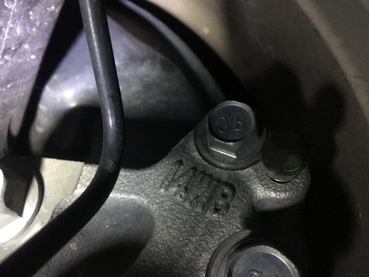

    If anybody tries the 5th gen 4runner calipers and rotors, you want 2010-2015 14WA calipers, the 2016 and up have the 14WB calipers. There's a thread about this here.

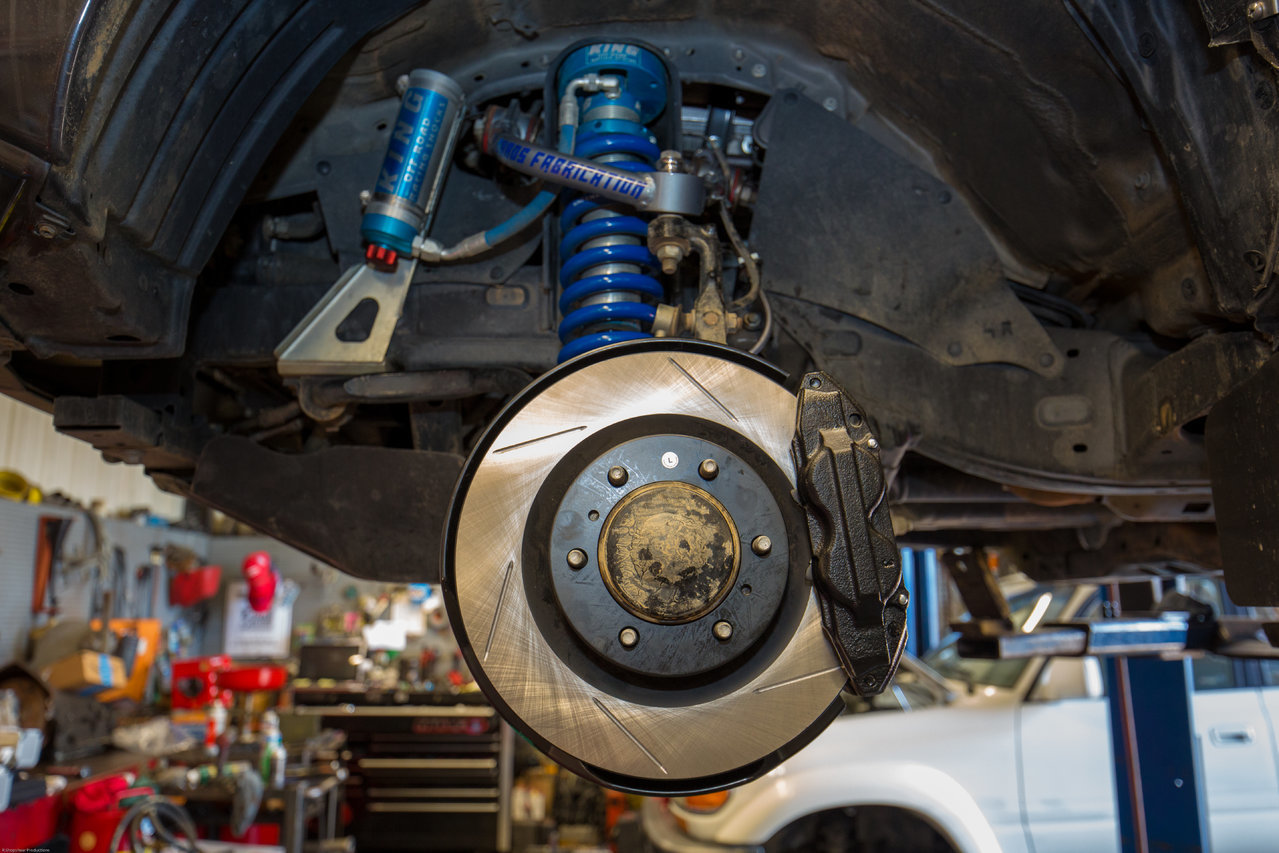

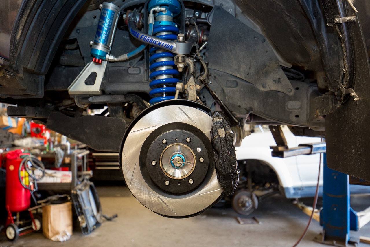

    Its not on there yet. I installed the kit I got from them as test to make sure it worked. I am finishing up the write up. The kit they plan to offer would include everything you need to install. I do not recall needing any brake shim to complete it. Rotors, Calipers, Pads, Backing Plate then also installed stainless lines F/R and swapped for a Race Brake Fluid. I will try to comment here with the details soon. Wife is having a baby so been delayed on getting this typed up. I have pictures and some video before and after the setup.

    Indeed, the 14WA Caliper fits perfectly. It was an improvement not insane but you will notice it. Roughly 8-10% improvement.

    A bit overdue but just typed up my review/experience with the 4th Gen 4 runner swap that I test fit for @Low Range Off-Road. Check it out.
    Nice upgrade for about 8-10% improvement with stock pads and affordable for everyone as it is only a bit more than replacing your stock rotors and pads, including stainless lines.
    4th Gen 4 Runner Brake Swap on 2nd Gen Tacoma
