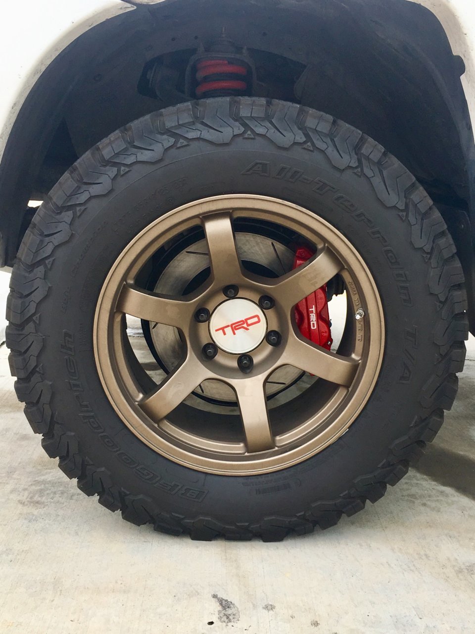

    I used remanufactured 14WA Brake calipers for 2010-2014 4Runners that I picked up from O’Reily’s. I had to disassemble them i.e. remove the pistons, to have them powder coated red. I then purchased an OEM Rebuild kit from Toyota.
    Here’s the completed project:
