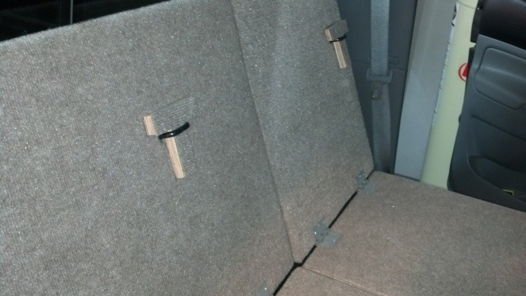

    OK, so, I was WAY overthinking how to keep the backs from falling...
    I used some scrap 3/4" plywood for the T's. That, and the carpet on both sides, made them just the right width to slide in easily while still being thick enough to keep the back panels from rattling.

    That's what I was going to recommend. Something like a tent spike or T. Looks great!

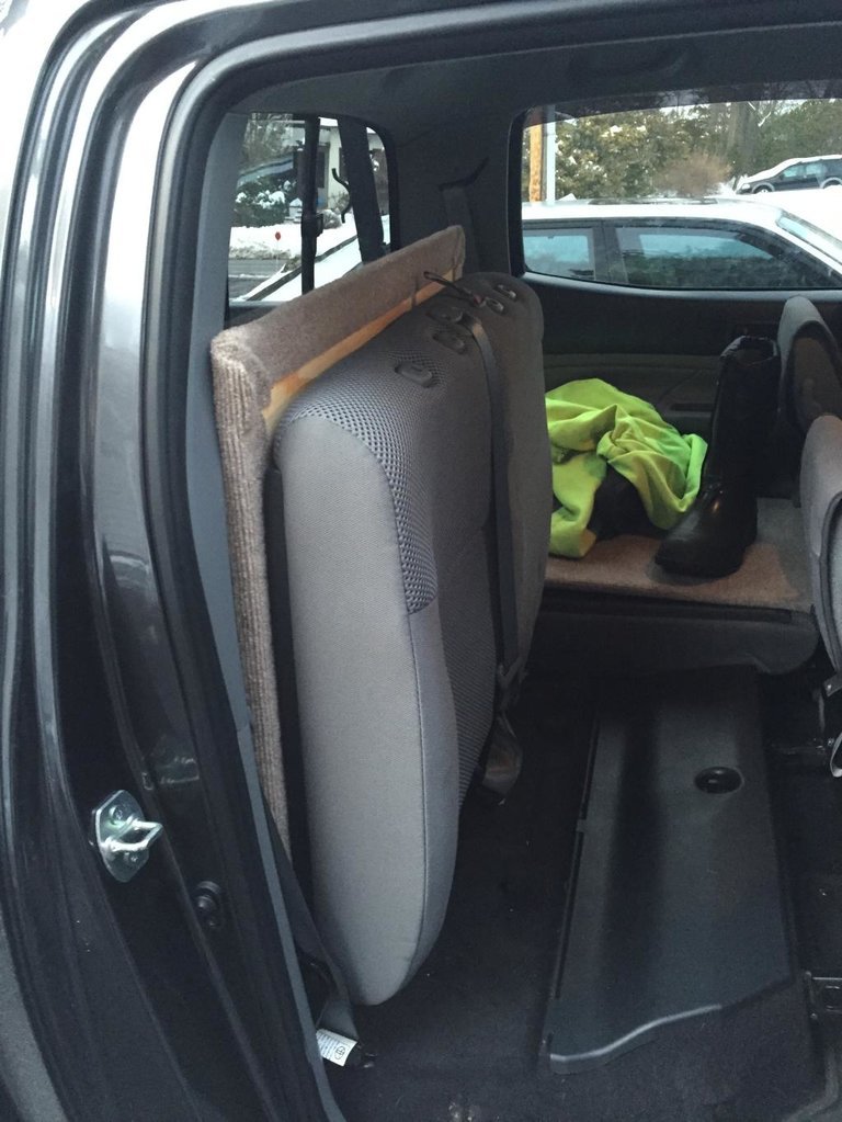

    So are y'all folding up behind the seat or just pull it out when not in use?

    I pull it out. I did see somewhere that one guy extended his seat anchors so he could leave it in.
    Mine usually just in place. I have the pup back there more than people.

    I take it out and put it in the bed under the tonneau and I just installed the pl5300 tailgate lock

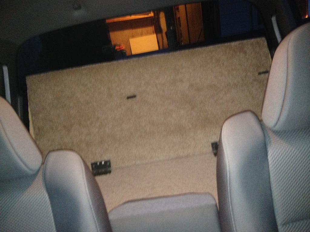

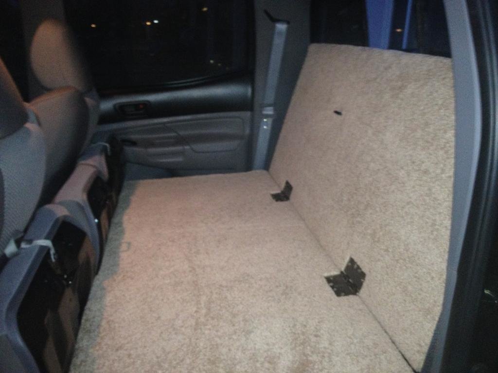

    Just finished making mine, looks great! Thanks for the write-up, I used the provided measurements. I trimmed a couple inches off of the tops of each side onthe back piece to make it fit a little easier (see 2nd pic). I also just cut slits in the carpet at the anchor points, which I think will keep it from falling. I used some regular house carpet that I had laying around.
    My German Shepherd/Blue Heeler mix is going to love it!!
