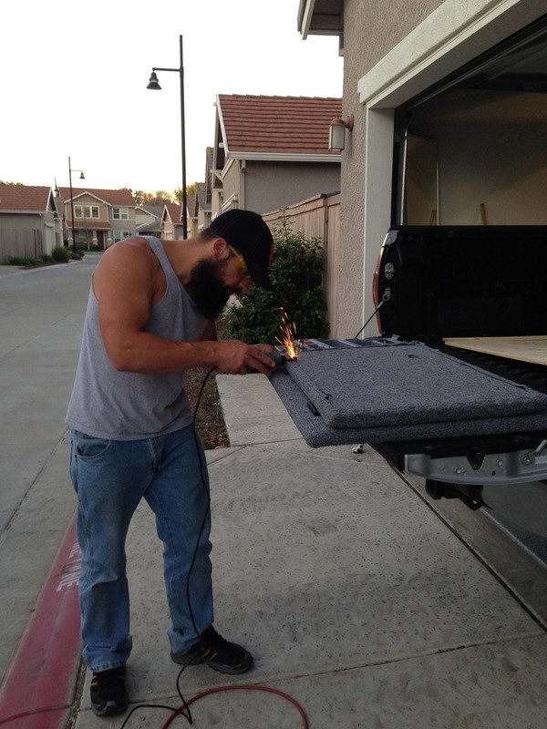

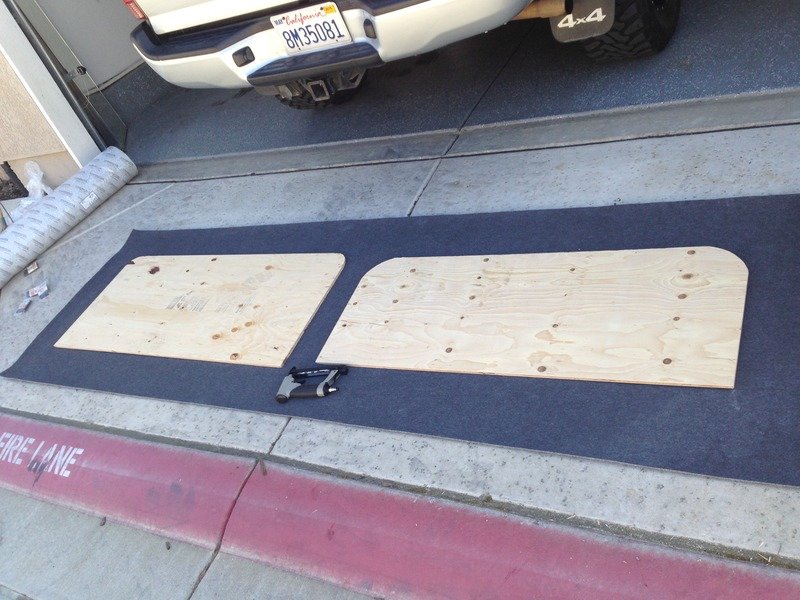

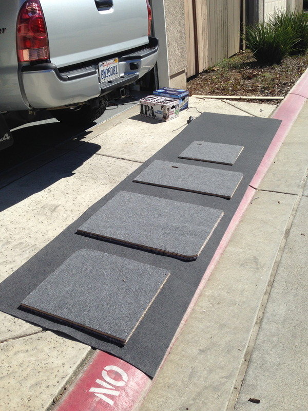

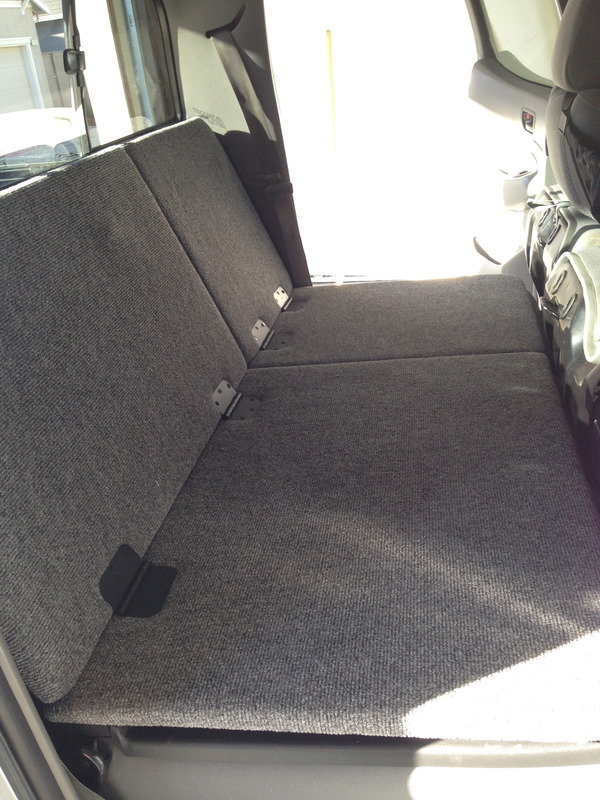

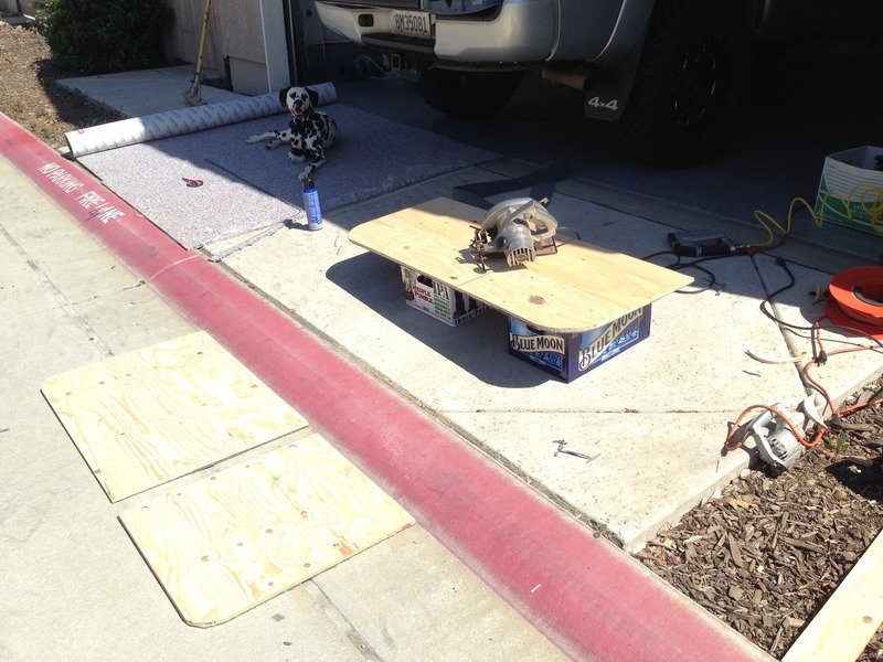

    Did this project today. I used to do automotive upholstery so this was easy and only took a few hours.
    Just some plywood, nylon carpet, 1/2" carpet foam padding, screws, hinges, and staples! I also did the backside and underside of the cushion and backrest.
    I'll be adding more trim to it for a "factory look" and dog needed accessories as time goes. I was even maybe thinking of putting this into production for those who don't have the time nor resources...

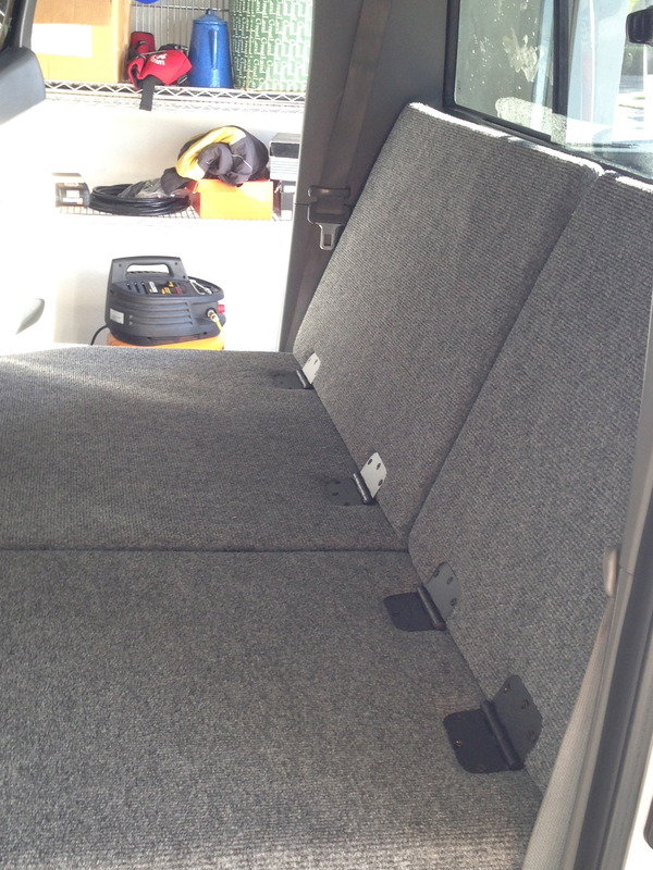

    Finally got around to completing this project. I should have done it sooner as it took less than on hour to complete. Much better than the dogs destroying my interior! Thanks OP
