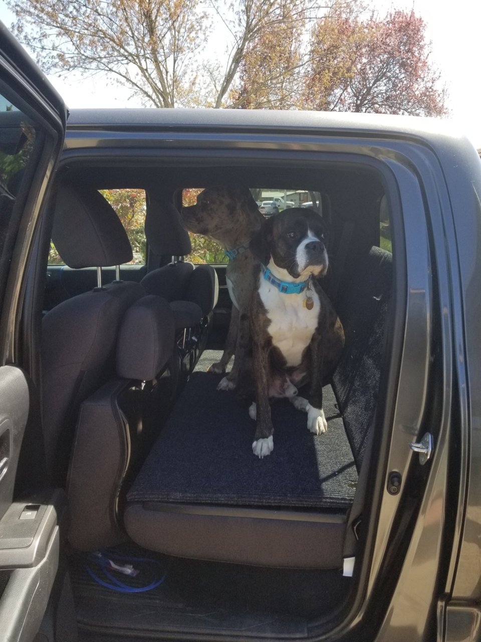

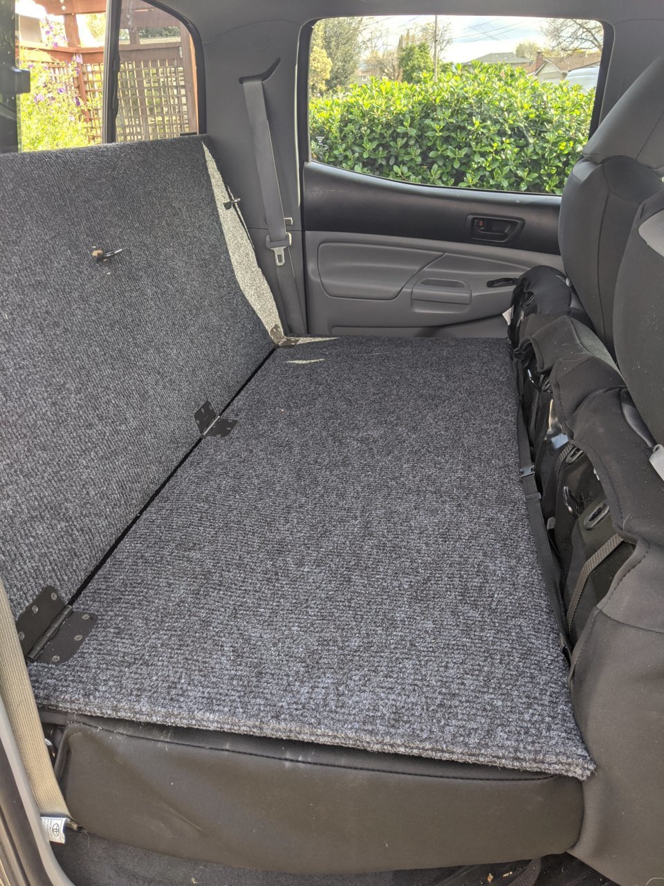

    Built mine last week for my new 2020.
    I ended up doing the split design. My dimensions were 31 x 23.5, 31 x 20, 21 x 23.5, 21 x 20 (inches) using 3/4 inch plywood. I used gate hardware on the back to latch on to the strikers on the back wall. Thanks for the idea, @Fixedwing.
    One thing to remember if you guys do this design: use a few strips of electrical tape to keep the gate hardware from rattling.
    Also, I wouldn't go any wider than 52 inches. I originally tried 54.5 as stated earlier, but it did not fit.

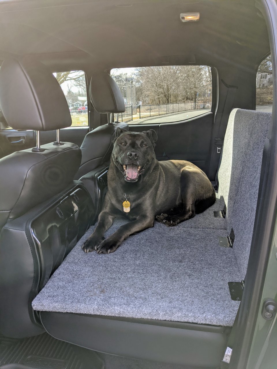

    Update pic with dog. He loves it.
    I have a few custom cushions on order from foamorder.com. Was able to choose the exact size, type of foam, thickness, and material.
    Ended up going with 2 inches thick, and sunbrella for the fabric. I had one cushion made for the the entire back seat row, and one that'll accommodate the 2-seat section for my split design platform. Should be nice. Hopefully no delays with the current state of events.

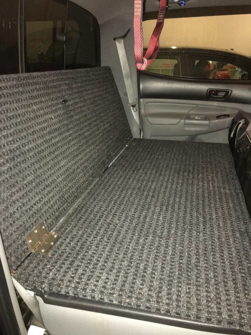

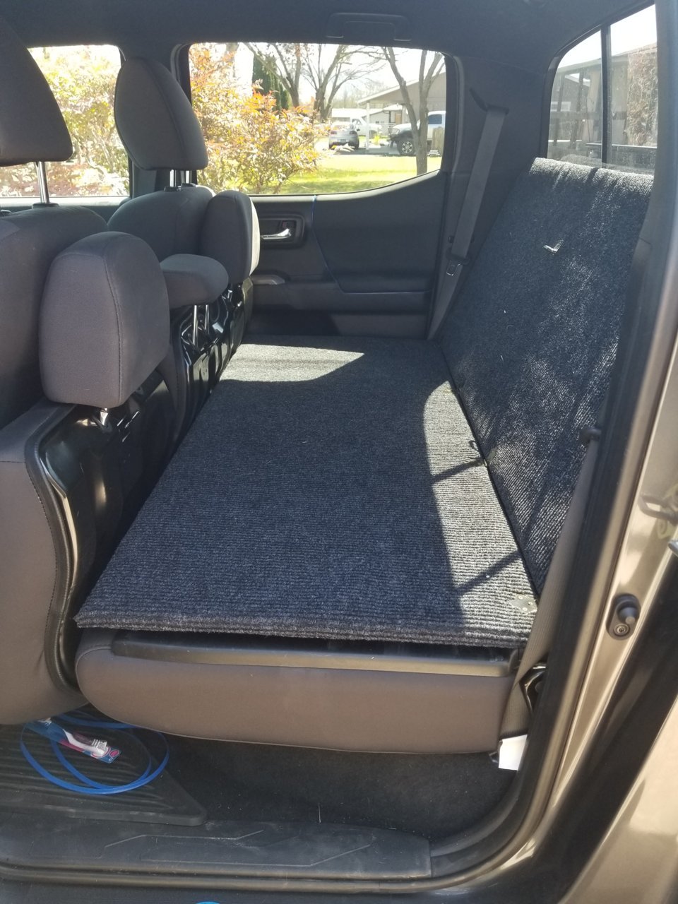

    Stumbled on this thread and have been thinking of doing something similar for a while. Followed the original plans and it came it out great!

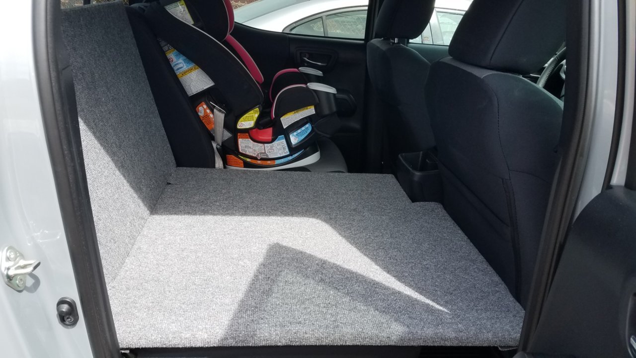

    Built mine today. Dimensions were great. Thanks for the idea

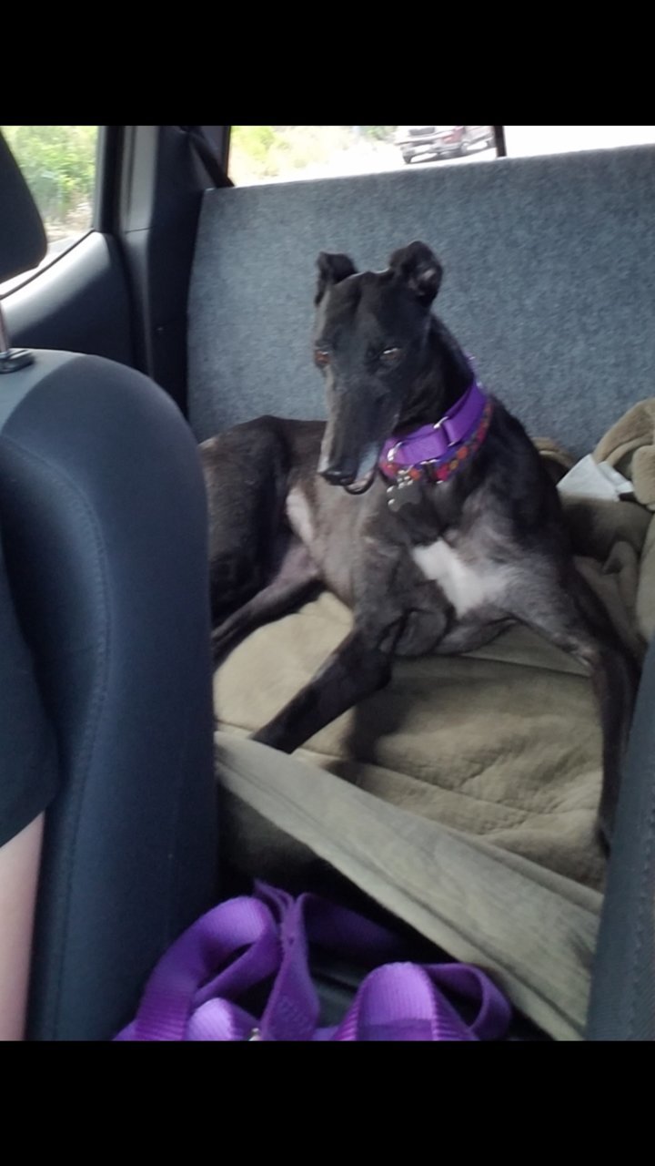

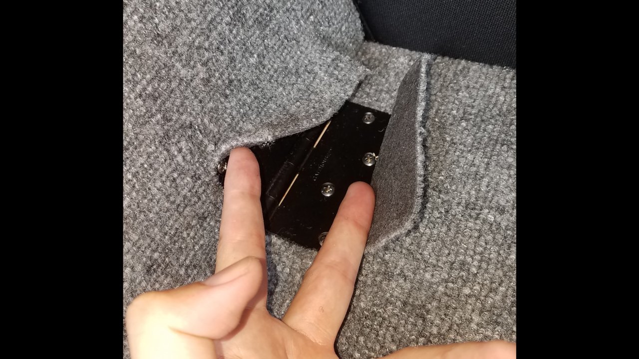

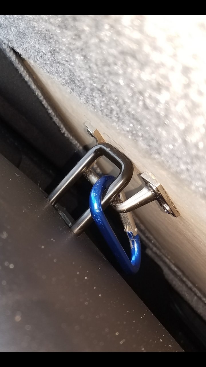

    Made a variation of the platform for my 2020. I removed the seat bottom (2 bolts) as I needed more room for a full sized greyhound (65 lbs, 26" at the shoulder). This gives you ~10" more platform space, front to back. I tried the original plans but there wasn't enough leg room for a hound laying down.
    I also used a window sash handle installed on the back of the plywood under the seat strike to prevent the the dog's weight from levering the front of the base. Used a clip to lock it in place. Everything was made to fit tightly and is solid under her weight.
    3/4" plywood for the base, 1/2" for the back.
    Also cut the carpeting to be able to install the hinges and keep them somewhat covered. threw a blanket on top and called it good.

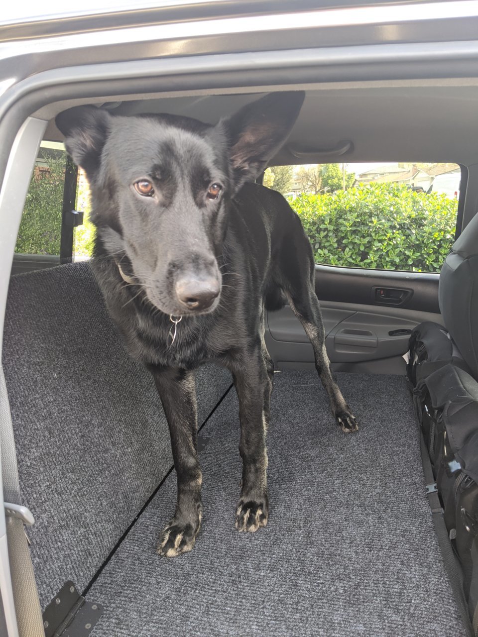

    Your dog will love it! Here's a few additions I've done to the platform:
    - Dog Ramp https://www.amazon.com/gp/product/B0014AOC68/ref=ppx_yo_dt_b_asin_title_o02_s00?ie=UTF8&psc=1
    - Custom fit memory foam / sunbrella fabric pad
    edit: I now use the ramp just up to the floor, rather than straight to the platform. Less steep for the dog, and works just as well
