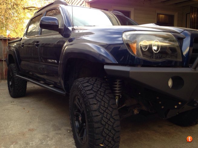

    Wrecked!
    285/70/17 duratracs 5100s @ .85 /toytec springs and 3/8" top plates and allpro expos in the rear.
    Measures 23" hub to fender in the front and 23 3/4" in the rear.
    Also removed the swaybar
    And with the added weight of the bumpers it rides better then before the extra weight.only dropped about 1/4" after bumper but i haven't measured in a while.looks like its dropped more.now that i look back at this pic.

    New measurements needed :)

    Rechecked measurements today.
    Not the best as my drive way is not level but its not to far off.
    Dr side frt 23" hub to fender
    Pas sd frt 23 1/4"
    Dr rear 25"
    Pas rear. 25 3/4"
    I have no weight in the bed right now as i just cleaned the mud out.also the first post was typo should of said 24 3/4" in the rear as that is were it sits with the normal stuff i carry ( tools spare tire ect.)

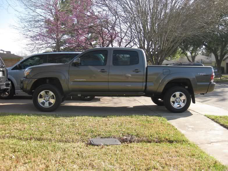

    My very first setup. I changed since then. Sorry, no measurements.
    5100s set at .85 and 2" aal
    BEFORE
    Afta
