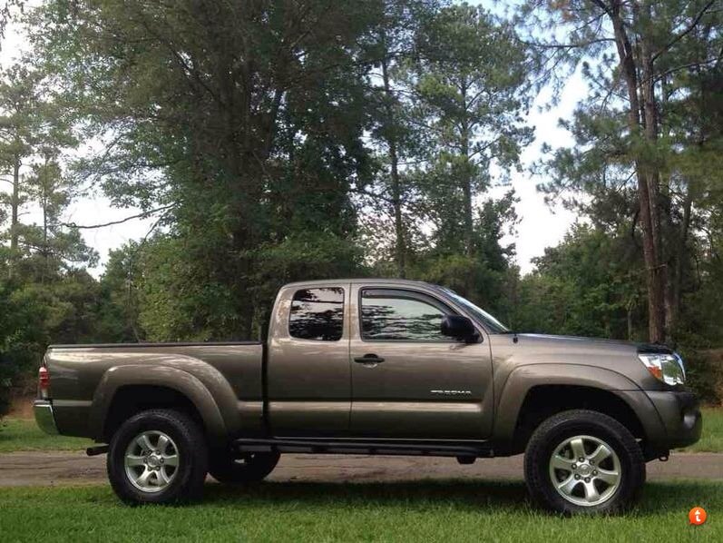

    ive had billies and eibach before the truck hit 1k miles off the lot. Good stuff.
    323538_10150423753900516_544844074_o_zps_845352b9ef98b7c86e549df6f45450188365bf35.jpg

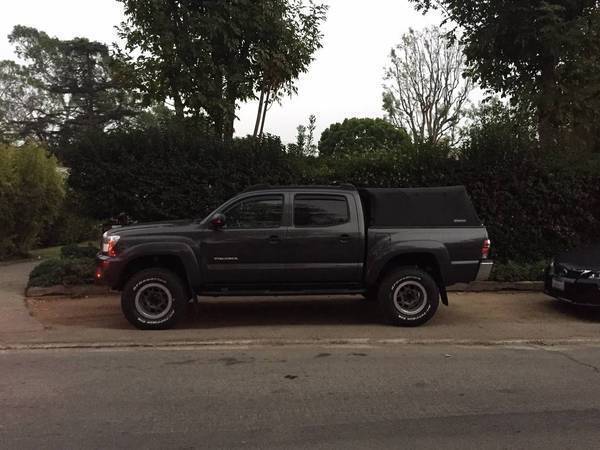

    5100's set at .85. Rear AAL
    With stock wheels
