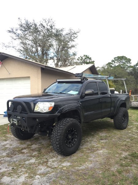

    275/70/17 then on 5100s at 1.75, 620# eibach, camburg/moog ball joint UCAs, 1.5 toytec AAL. No lean spacer and I came out pretty even. front at 22 and rear 23. I previousley had the eibachs with .5 spacer and AAL and just added the bilys and UCAs. Rides great on and off road.

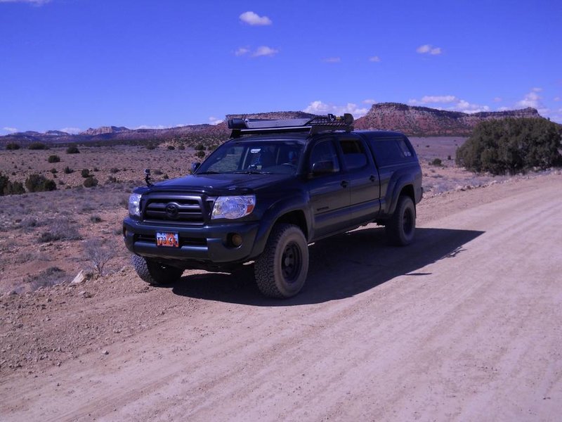

    Love the Eibach/Billie set up and some great looking trucks on here for sure!
    Running 5100's all around (fronts set to 0"), Eibach 1.6" coils, and wheelers 1.5" HD 3 leaf aal in back. Going to raise the fronts to .85" and add Dakar's in back in about 2 weeks. Will post pics when it's done..

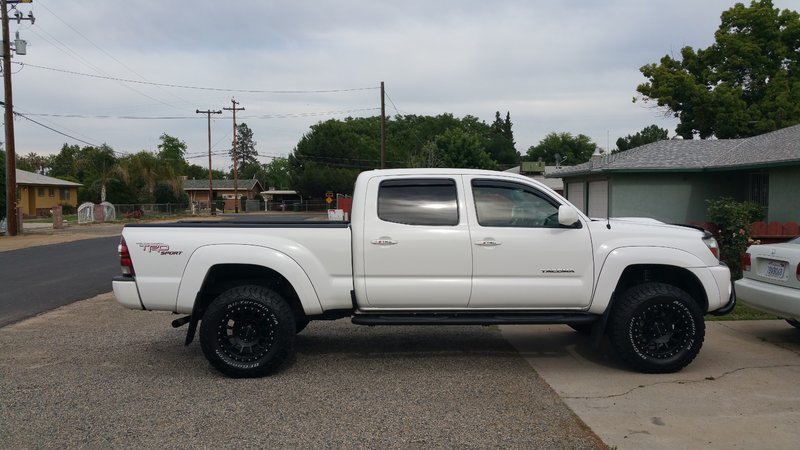

    5100's with toytec/eibachs @ .85 with .5 inch top plate spacer on drivers side and .25 inch spacer on passenger side to compensate for the driver lean. 1.5" AAL in rear....just installed around a week ago. 20160504_164329.jpg

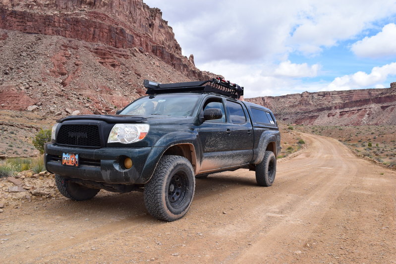

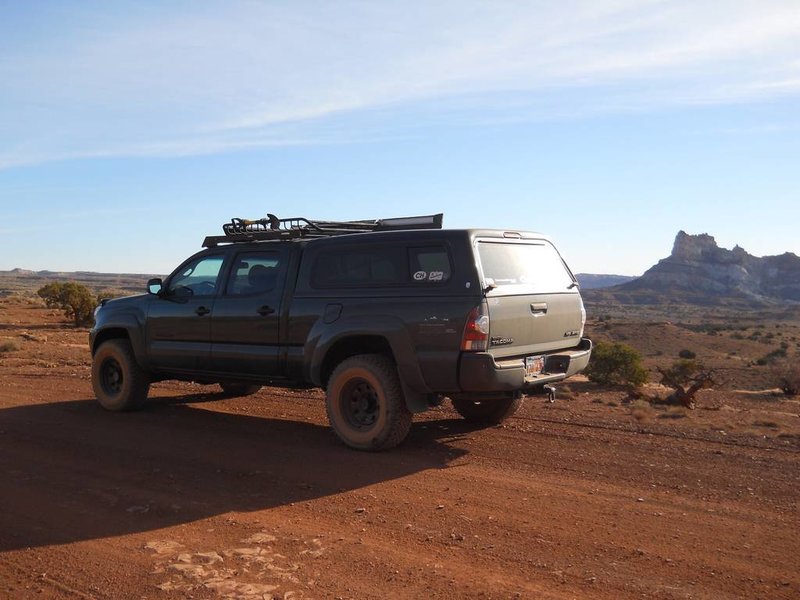

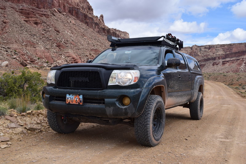

    Here are some updated pics - raised fronts to .85" (w/ eibachs) and added dakars in rear.

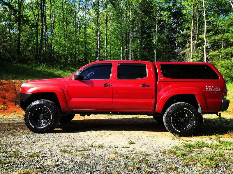

    Got mine installed yesterday also lifted the rear abit to even it out. Had 0 alignment issues and much happier now.

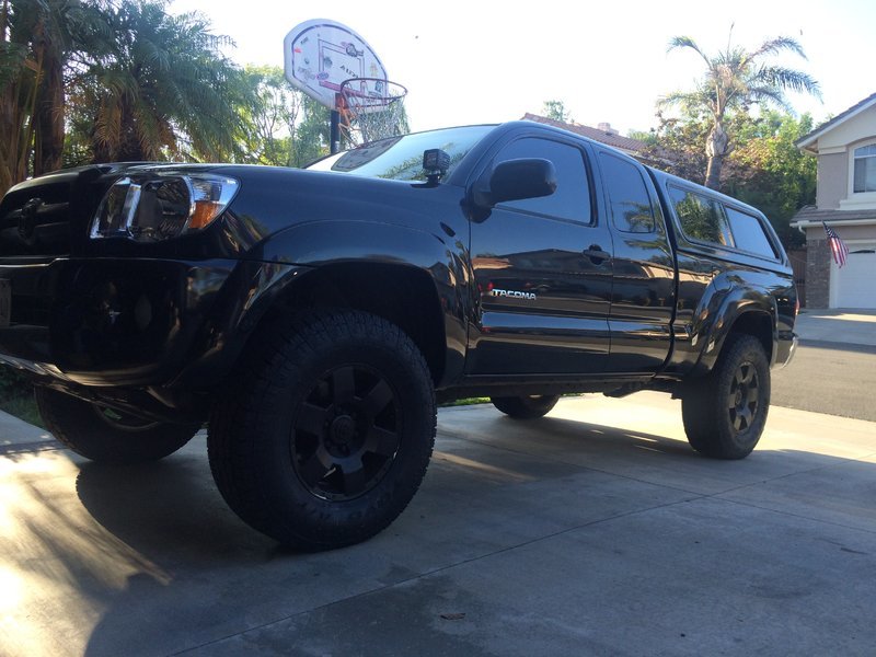

    Anyone have trouble fitting 33's with the billy's set to .85 and eibachs? Currently have them set to 2.5 with stock coils and no rubbing but want to switch to the eibachs.IMG_1622.jpg

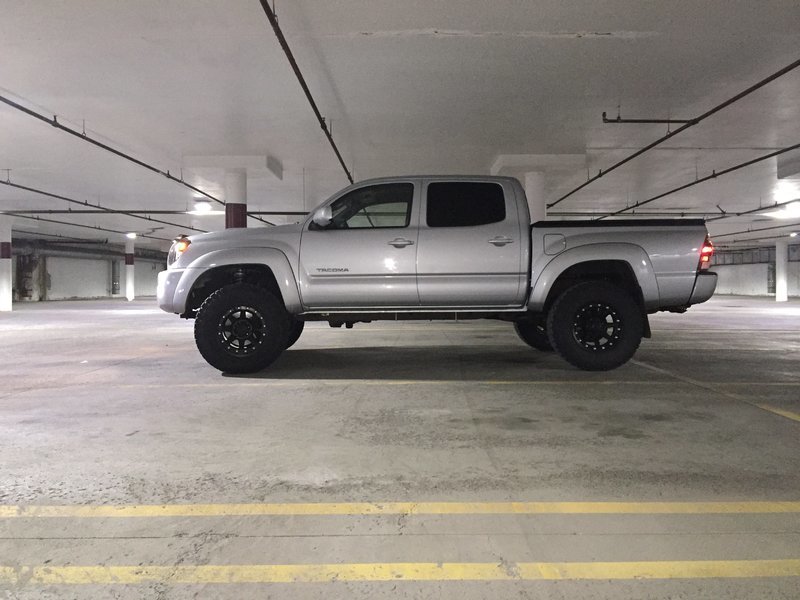

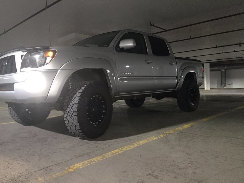

    Update I got them all installed tonight so far very happy with them... it looked like the front was sitting a little bit higher but it was dark. I'm going in on Saturday to get my Leaf spring recall done and having them but my new add a leaf in at the same time.. perfect timing as well, I noticed that on the passanger side one of the leaf spring was cracked, I think it was the add a leaf I had from any older spacer lift I had on at one point, which I took off to put a Pro Crap coil over lift on 3 years ago. 4 wheel parts left the AAL on and put a block on with it. I'm going to say it was the pressure from the block spacer but it is hard to tell.
    Sitting at 23.5 all four corners

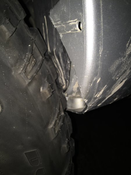

    have not had a alignment done yet but right now I'm getting major rub. hope the alignment will pull the caster forward enough to get rid of the rub, that is not even full lock

    Did you replace the UCAs with this lift as well?

    No. I know with some lift you need to do UCAs and some you dont. Waiting to see what happens with the alignment tomorrow

    Right on, good luck! Hopefully they can get it close enough. If you can get a little positive caster, it should move the wheels off the back of the wheel well for ya. The LightRacing UCAs are adjustable and will definitely solve the problem if they aren't able to get a good alignment with the factory UCAs.

    So toyota said that my LCA bushing and adjustment bolt's need to be replaced even thought i just replaced them 3 years ago after 4wheel parts said that it needed it as they were installing my old pro crap lift that i took off to put on the 5100's. So they said that the only adjusted the toe and could not do anything with the camber or the caster. i guess i will need new LCA's plus some UCA's. Here is what they alignment came out to with out doing the caster
