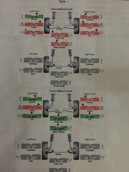

    Where are you taking it for an alignment?

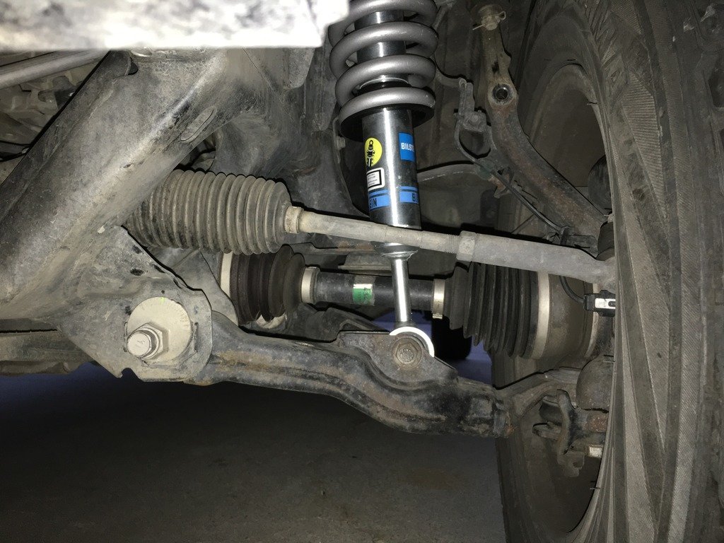

    I suspect it is due to your cam tabs seizing. I am pretty sure I am in the same boat. But plan to soak mine with penetrating fluid for a few days before I install my coils to see if they will break loose when I take it for an alignment.

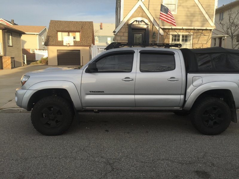

    That doesn't look like a lean at all! But obviously you see it more than anyone else does. I think I'm going to pull the trigger and put the clip at .85, with the factory 4 leaf pack in the back

    Mark Miller Toyota, they were doing to leaf spring recall at the same time so was going to have them do it at the same time. 4wheel part wanted 130.

    4wp is expensive, but one of the best alignments I have had on my truck...
    My leaf springs are on order at MMT. Should be getting the call any day now. Makes sense though to kill two birds with one stone. Try soaking your cam tabs with penetrating oil and see if you can break them loose.

    5100s front and back. Front set to .85 with eibachs. 1/4 spacer for driver side and AAL in rear. Non TSB. Had light racing UCA installed also.
