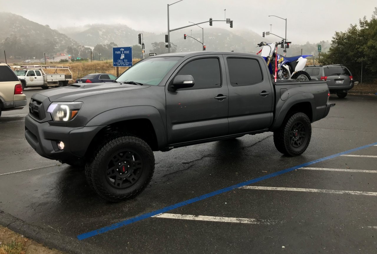

    5100's at zero setting with Eibach Pro Lift springs. 2.25" of lift running 265/70-17's. Got the lift and look I wanted and the truck drives super smooth. Alignment was perfect too. Glad I went with this set up.

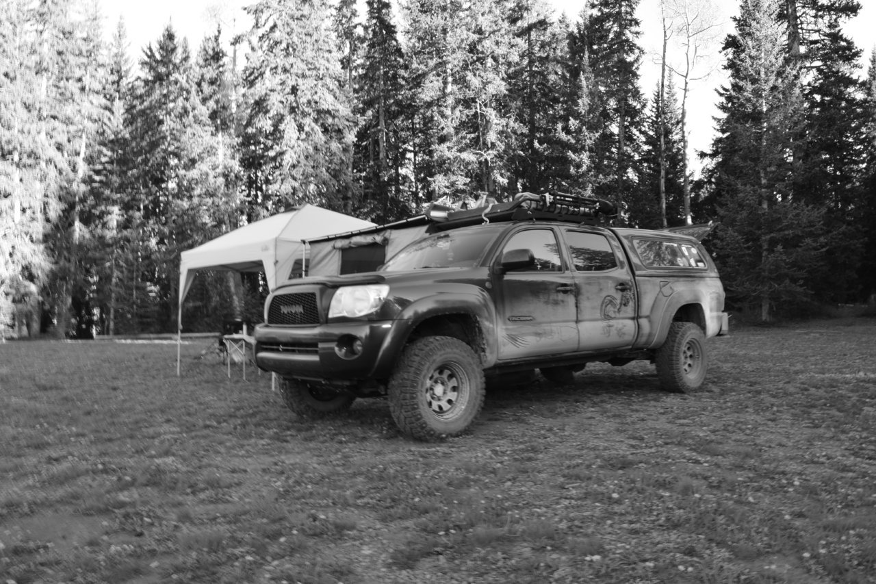

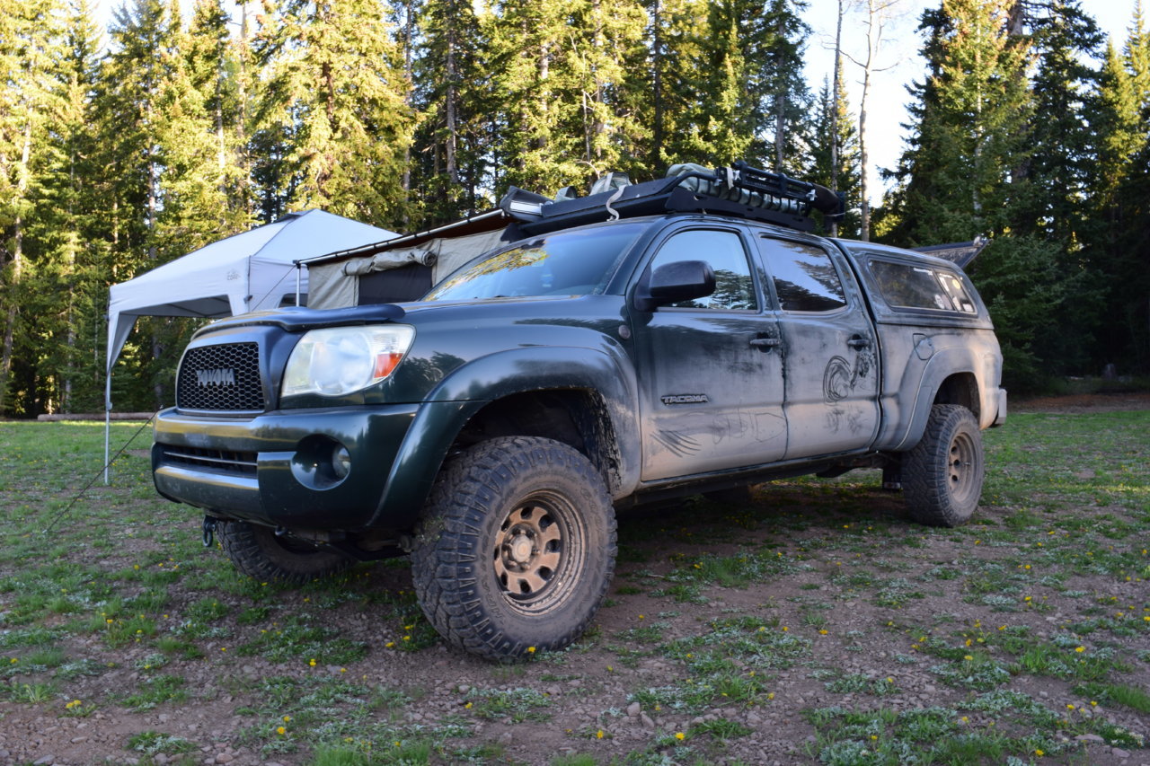

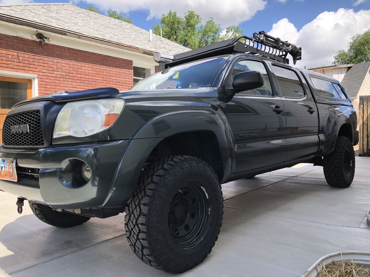

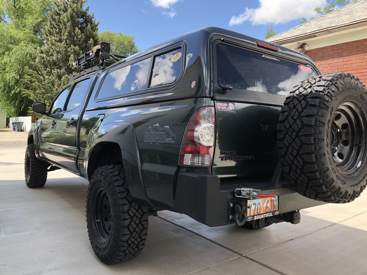

    Here are a few pics with the 2.5” Eibach’s, 1/4” plate spacers and 5100’s set to 0”. I’m pretty close to 3” I think and leveled it out nice with the Dakars in back. Great ride and love them so far..

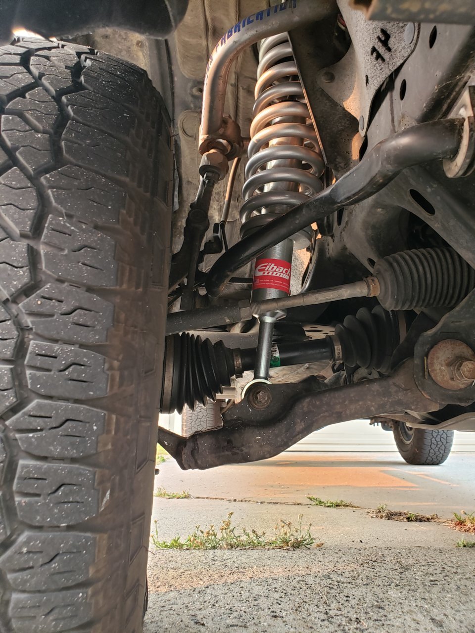

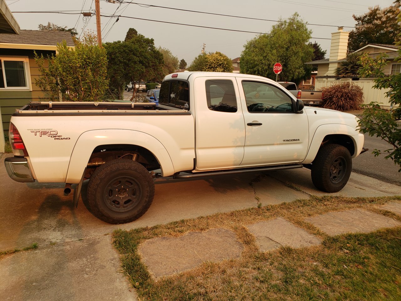

    Handles on the road way better. Definitely stiff but I like em. Had older icons in the front that came with the truck. Started leaking AFTER a rebuild and couldn't justify getting kings or fox. Ill be happy as long as these don't leak for a while 20200819_081652.jpg 20200819_081635.jpg
