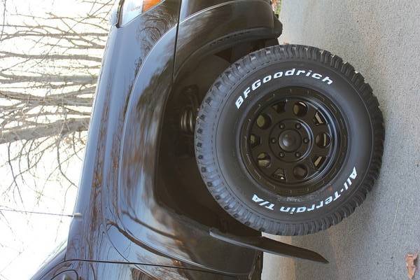

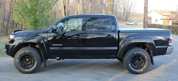

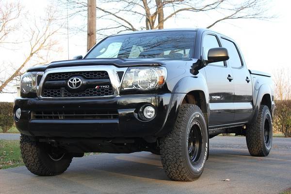

    I'll get some nicer pictures next week, but here's my newly installed Eibach coils w/ 4x 5100's @ 0" up front...
    Note that none of these are really on level ground, but to give you an idea, the Eibach's gave right around the advertised 1.6" of lift which put the truck only ~0.5" higher in the back with the TSB springs only. So it sits just about level. Love the ride.

    Looks very nice! This is exactly the look that I want. Did it firm the ride up a little bit? I guess mine would be different anyway because I have an SR5 and you have trd offroad but mine feels a little bit to soft for me right now. I would like a little firmer ride than what it has now.

    Thanks! Ride definitely feels more stable and what I would call more "solid".

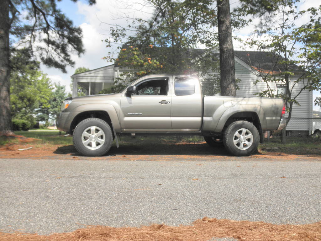

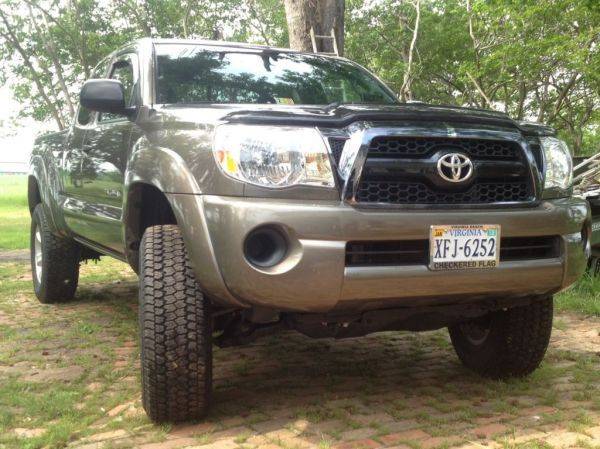

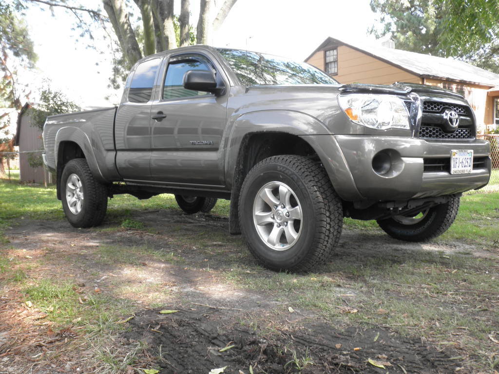

    before lifting
    After
    5100@0 w/eibachs
    toytec .75" lift spacers
    tsb leafs w/toytec 1" lift blocks(will be adding progressive aal and u bolt flip)
    Goodyear at/s 275/70/17=32.4"
    prior to adding 1" blocks
