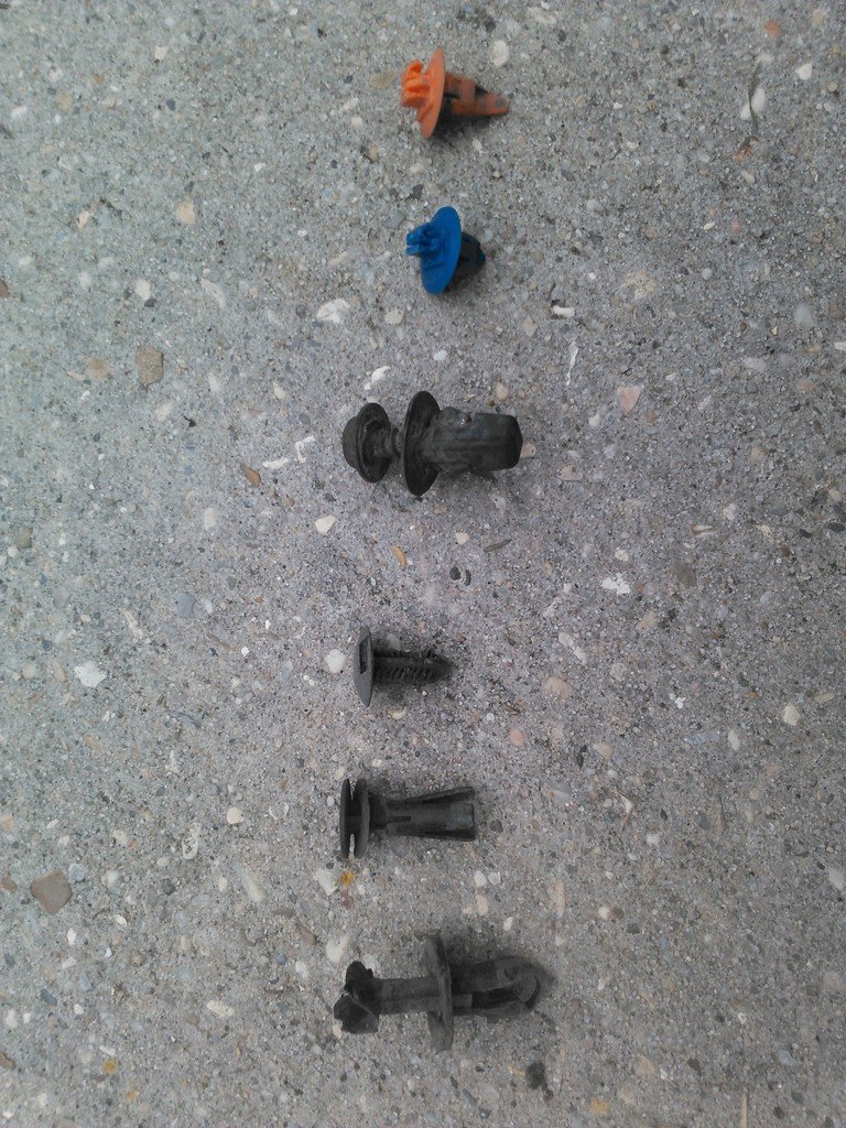

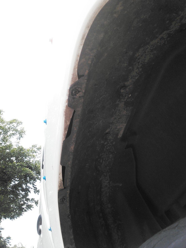

    My wheel wells were held in with the same clips as the flares all together.
    So there wasn't a way to reach behind them.
    I found the pop in center clips, that I will be using to put it all back. That way it won't be a pita if I have to disassemble again for some reason.

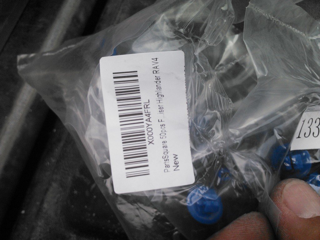

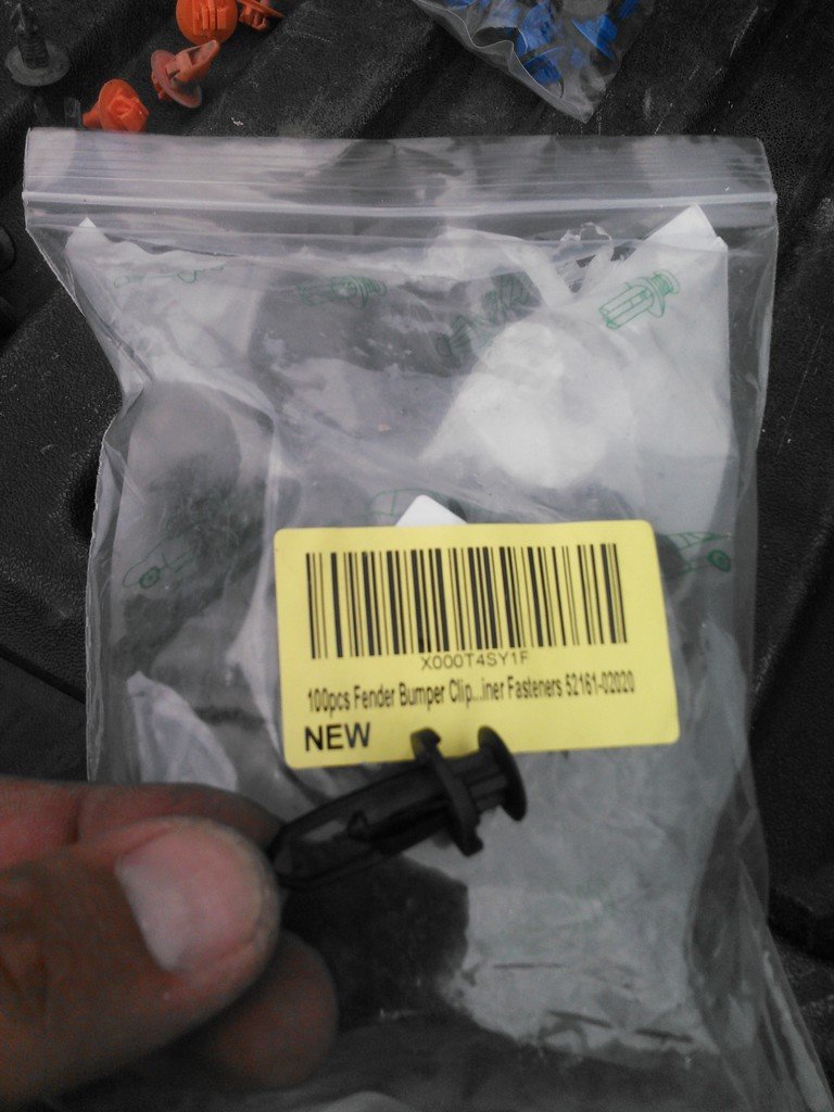

    Here are the proper fasteners
    Amazon had them
    These can be removed without Reaching behind

    The bottom clip and the third one up look like the kind that could be removed with the pull out tab but they had one way clips on the inside.
