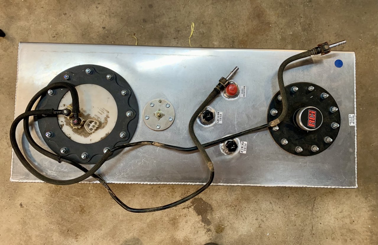

    I didn't see a lot of consolidated info on adding a fuel cell, so I thought I'd share what I did to make it work. We don't have state inspections here, but I didn't want a CEL. That's why I wanted to keep the canister. I also kept the stock sender just to make things easier. There may be more affordable fittings and easier ways to do this, so please add to the conversation if you can.
    Parts Used
    1. RCI 2191A 19 Gallon Fuel Cell
    2. Motobilt FUEL CELL MOUNT FOR 30 X 12 X 12 CELL
    3. Motobilt TJ Fuel Pump clamping ring MB5007
    4. Qty. (2) EVIL ENERGY AN8 Flare Cap Tube Fitting Hex Head Port Fitting Adapter 2PCS Aluminum
    5. I just used the hose and clamps from this Qty. (2) IZOKEE 5/16 " Inch ID Fuel Line Set - 2 Meter / 6-Foot 5/16" Inch Fuel Line + 2 Pcs 5/16 Inch Fuel Filters + 10 Pcs 2/5" ID Hose Clamps for Kawasaki Kohler Briggs & Stratton Small Engine
    6. Qty. (2) ICT Billet Quick Connect Male 5/16 Fuel Rail Hose to 5/16 Barb Adapter Fitting LS1 LM7 LR4 LQ4 LS6 L59 LQ9 LM4 L33 GM Oring Seal Billet Aluminum Natural Finish AN817-01-05BA
    7. Qty. (2) Dorman 800-080 Fuel Line Quick Connector That Adapts 5/16 In. Steel To 5/16 In. Nylon Tubing, 2 Pack These require the hardlines under the cab to be cut down about 1/8"
    8. Qty. (1) EVIL ENERGY 10AN Female to 10AN Female 90 Degree Swivel Coupler Fitting Adapter Union Aluminium Anodized Black
    9. Qty. (1) ICT Billet -10AN Flare to 3/4" (.75) Hose Barb Adapter Fitting Aluminum Flare Connector Fluid Designed & Manufactured in the USA Bare Aluminum F10AN750BA-A
    10. Qty. (1) Vibrant Performance Filter w/ Chrome Cap -3/4-19mm"Inlet ID 2164
    11. 3/4" hose clamps

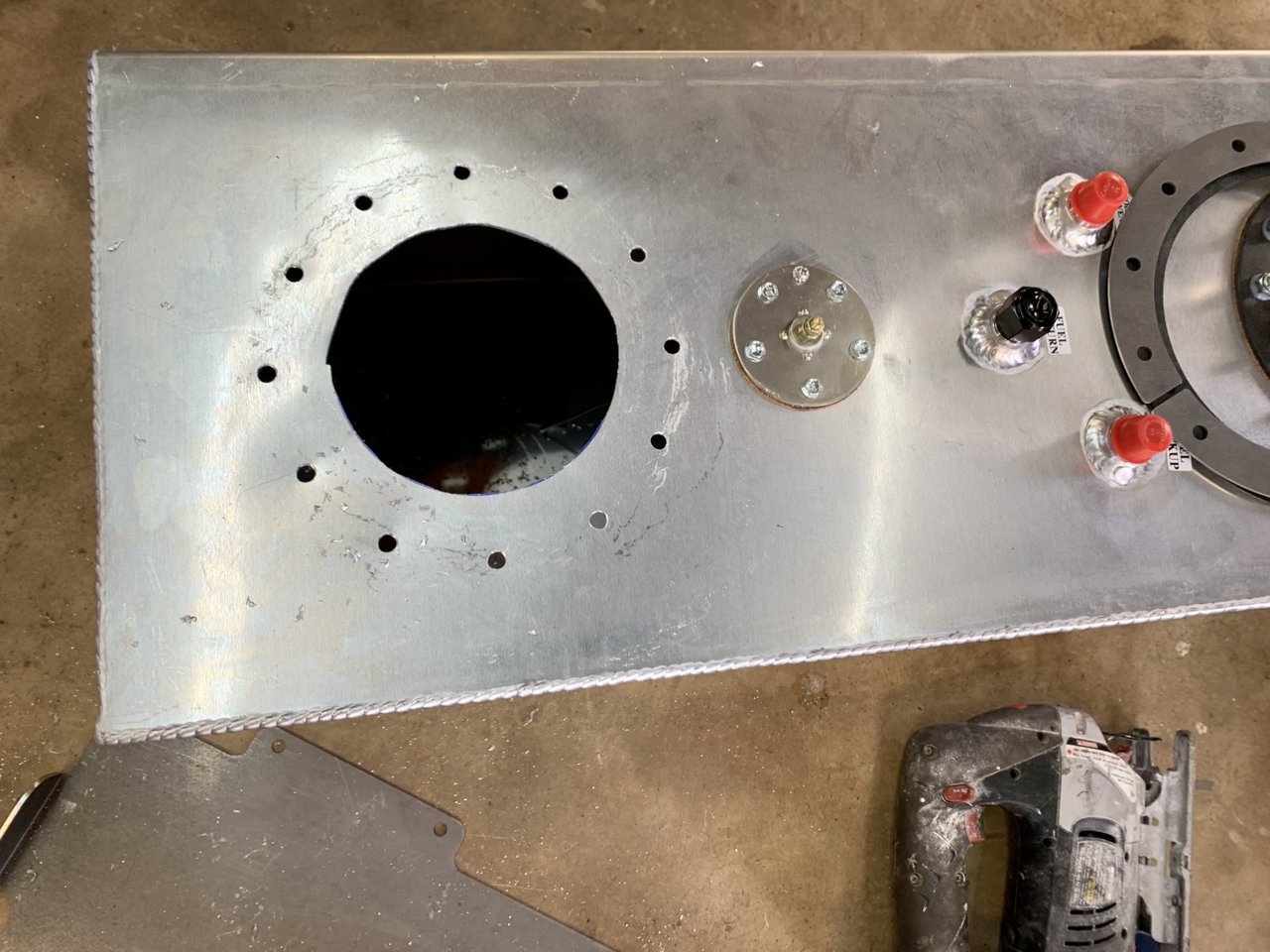

    I went with an RCI 2191A 19 Gallon Cell, but I would highly recommend purchasing Motobilt's 19 gallon package deal. It will include the ring, cell and bracket that all works together. I already had the RCI before I knew this so I just went with it. I purchased a clamp ring and mounting brackets from Motobilt. I had to drill a hole for the stock sender in the RCI cell. The stock sender must be ground down a bit to fit in the ring. I used the round rubber ring from the stock pump as well to ensure a tight seal-
    Fuel Lines
    I had to trim about 1/8" off of the hardlines under the cab to get the quick disconnects (#7) to fully seat. Make sure to round off the edges and the plastic coating so the o-ring doesn't get punctured. This will allow the fuel lines to be easily extended to the pump. You can see in the picture above that the bundy connectors (#6) connect directly to the factory pump. From there it's just cut your hose and slide on the barb ends and clamp.
    EVAP Lines
    There's a lot of crap coming off the canister. Take good pictures and forget what goes to the OEM filler neck. I sealed of the two pickup and return lines on the cell with 8AN caps (#4). The rollover vent on the cell I used for connecting the 3/4" on the canister. I needed to adapt 8AN to 3/4" barb. There may be an easier cheaper solution, but I used parts #6, 8, 9, 11 to do this. I used a 3/4" filter (#10) on the end of the small box connected to the big canister. I will add better pictures of this later.
