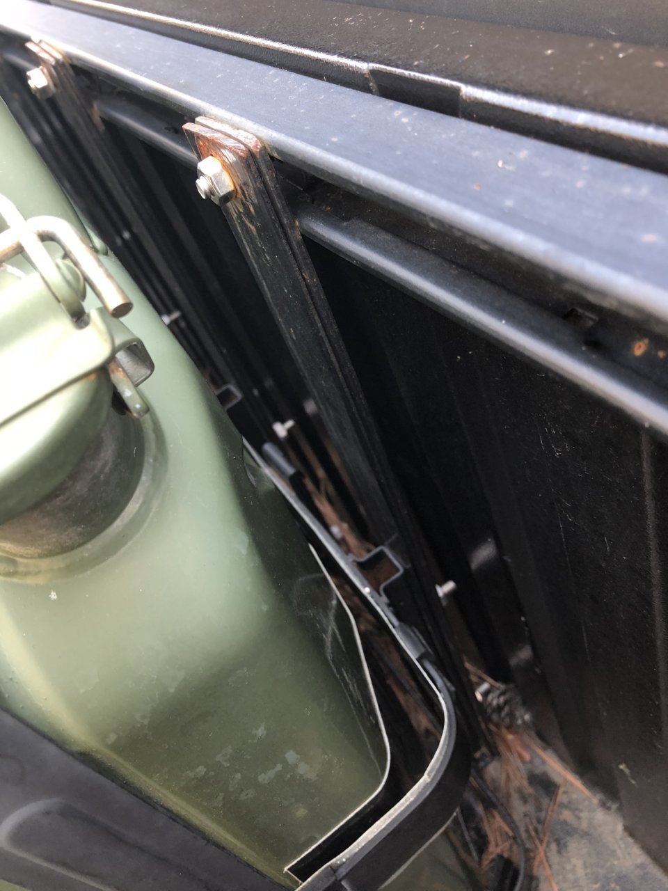

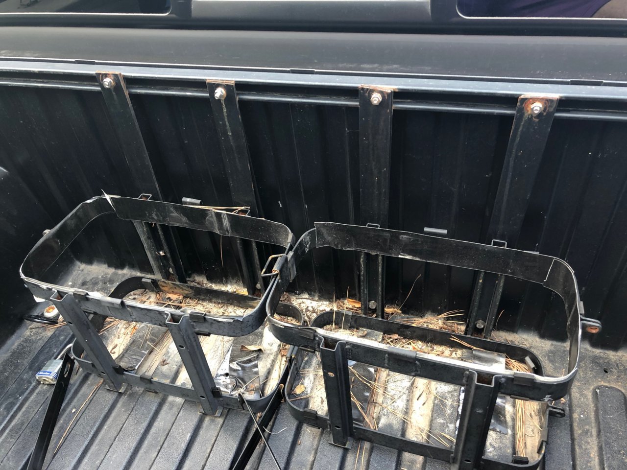

    I have two wavian cans with two of these https://www.amazon.com/Smittybilt-2...1-spell&keywords=smitty+bilt+jerry+can+holder. I cut some pieces of steel, drilled holes and then used bolts and washers to attach to the bed rail.
    Only comments would be that after a few years they start to get scratched (painted metal on painted metal contact) So I used gorilla duct tape to "protect" from that. I also hit them with some clear coat every now and again. Sun in Houston is pretty harsh. If you got black you could do it easier. They also lock if you have locks.
    Oh they also collect leaves and pine needles and stuff. So get used to taking them out and cleaning that area or not caring. Of course you can also take them out when not needed I suppose.

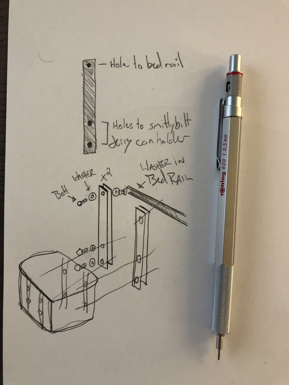

    Description of process is per one can/cage. I got two 48” long pieces of flat iron about 2in wide, 1/8th of an inch thick and cut to about 18in or 17.5 (can’t remember) Basically to top of bed rail from bottom of bed. Drilled three holes in each. One at top for bolt to go into bed rail, and then two at bottom to connect flat iron to can holder. Then I doubled them up. So two slats on each side for a total of 4 slats. Painted black and used washers to connect to rail. Here’s a quick sketch. I think it was like $30 total in materials. Been rock solid with empty and full tanks.
    I’ll try and take a photo tonight for ya.

    Hope that kinda helps. Forgot to take it last night and just got all cleaned up for work. I’ll probably empty the gas into the truck since I’m close to empty so I can take another later. One thing I don’t like, since I live where there are a lot of pine trees, I get leaves and pine needles and stuff back behind the cans. When I wash the truck I have to go in the bed and empty it.

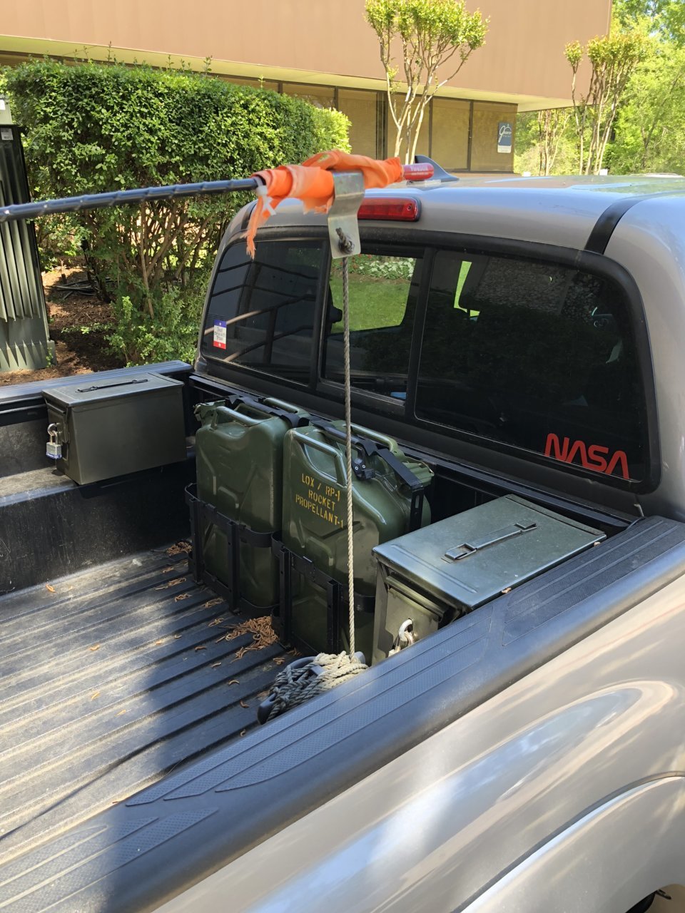

    One more for good measure
