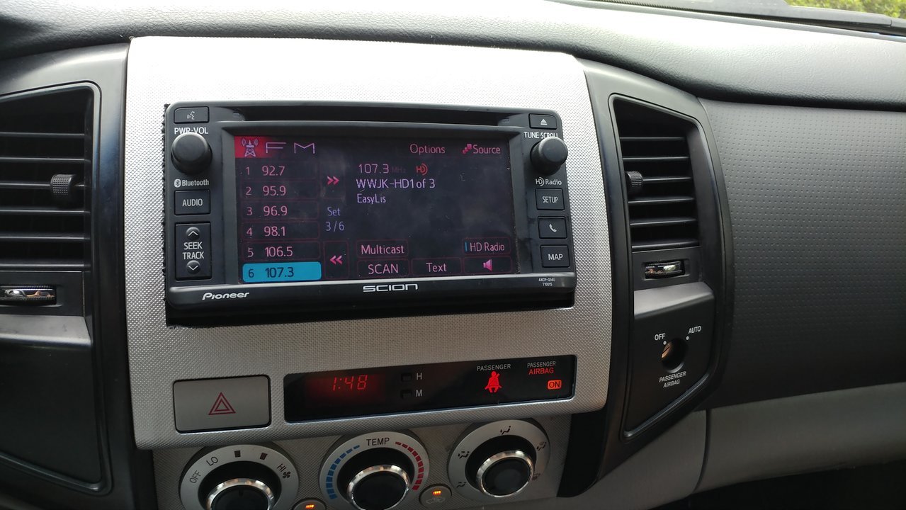

    Depending on your trucks year it will probably be plug and play.. And it sounds fantastic.. And probably no one will be interested in stealing it.

    Yeah my setup is kinda rough. I have a black scosche adapter waiting for me to get a dremel and do it right. The scion radio is slightly wider that normal so I had to improvise. I had a Dual radio and it only lasted about 6 months. That's why I decided on this one, its pioneer and its oem quality so it should be of better quality. Like I said the sound is great and its not a $600 device. I work in IT and because of this I dont want my truck to be smart, Ill eventually get the nav module and nothing should need to connect to the internet. For this setup steering controls worked fine, bluetooth connects fine, the usb feature. Trying to find a microphone, camera and nav module to complete setup.

    What year is that scion radio? Are there different types or just the 1 type? And it was completely plug and play, no harness needed?

    The radio came from a second gen tc. The model is t10015. For this to work I bought:
    PT546-00120-CH this is a 28 pin connector adapter.
    One of these
    https://m.ebay.com/itm/For-Toyota-C...-Cable-Adapter-/172131065934?fits=Make:Toyota
    The basic power and speaker connectors plugged in fine. For the power steering and microphone to work you need the pt546-00120-ch adapter. Using that your power steering controls work perfectly.
    For the usb functionality you use the adapter on the link I included. So far I'm missing the microphone which is part number pt546-74120-mc.
    I have to note I upgraded the door speakers with pioneer 6x9s already. The sound is great.
