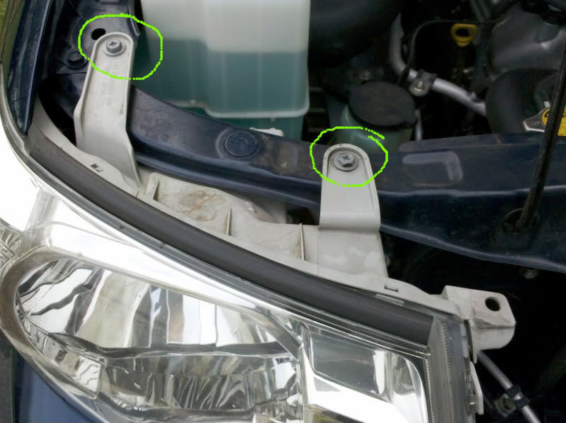

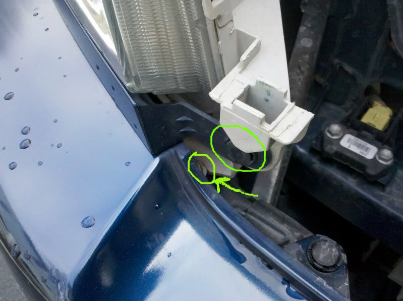

    Heres the first few things that need to be removed. Obviously, this is from the point of the grille being removed.
    If you didnt know that these two screws are holding the headlight down, stop any further work on your truck ;)

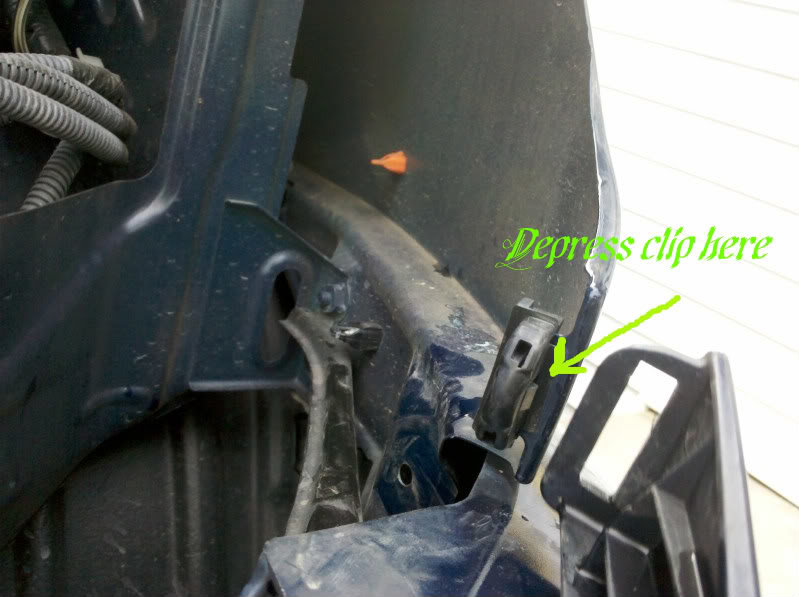

    Theres also another one tucked down in the bottom. I pulled the bumper forward a little and its enough to get it out of there. Also, get that push pin out.
    I now removed the lower trim piece under the headlight. The inner end of the piece should already be loose from undoing the push pin. Now just use a flat head screwdriver to depress the clip and pull the trim piece towards the center of the vehicle to remove it.

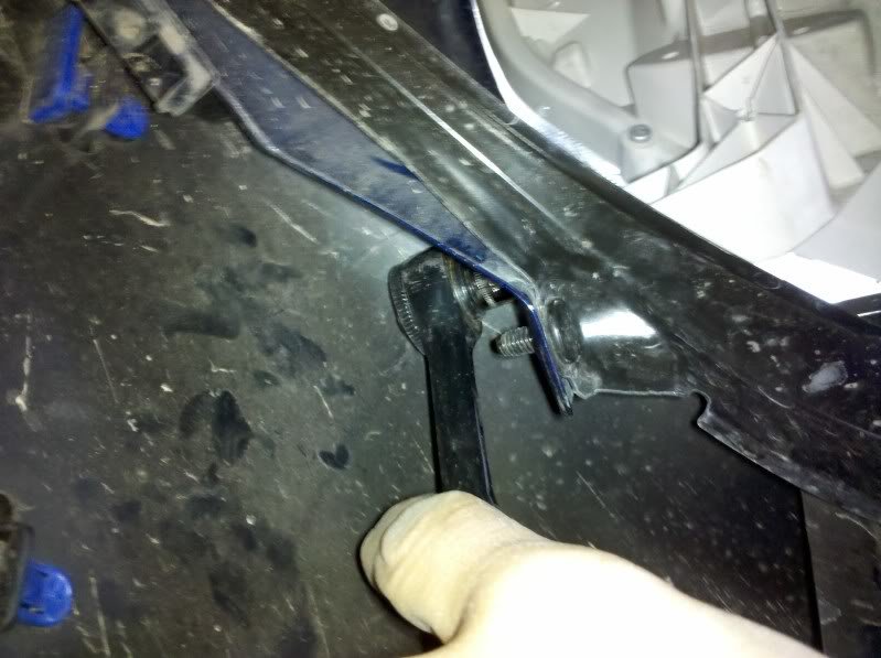

    Now for the harder part. To make things really easy, remove the two 10mm/phillips screws that hold the lower portion of the fender liner in place. I bent the plastic liner up out of my way. Once I removed the headlight, I simply put this back in place. The two screws are at the bottom of the fender. Very easy to find. No pic necessary.

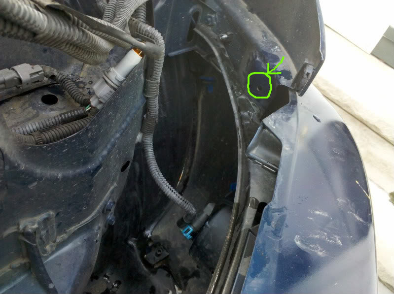

    Grab your 1/4" drive and a 10mm socket. Although you wont be able to see the screw, its directly above the visible bolt that holds the panels in place. The socket is placed on the headlight screw in this picture.
    For reference, another angle w/ the headlight out. Pretty sure this is the hole that it came from
    And thats it! Remove the bulb/harnesses and just wiggle that headlight out. As others have said, its optional to put this back in place when you reinstall the headlight. The other screws are enough to hold it in place and not putting this back will only make future removals 5 or 10 minutes quicker.

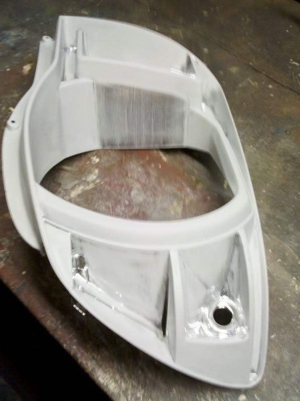

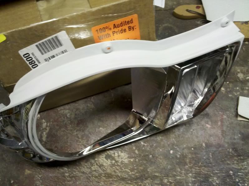

    mcleod90; I was going to take more pics, but honestly, I think every pic thats been posted so far pretty much covers what you'll need to see or know. Its much more intimidating than it is when it comes down to it. You'll see, its easy to do.
    On a side note, I've decided against just spraying on FUSION satin black paint. I think I'm going to color match mine, and I'm going to do the same process as I did w/ my grille. Sand>Adhesion Promoter>Primer>Paint. I'll allow it to cure before re-joining the lens and housing.
    Here we go! Remember,......Its all about the prep work!!!
    The top portion is after sanding. I'll update as I go along. Right now, my big decision is whether to keep the headlights off the truck and order up some Retros or just stick these back in :boink:

    Btw, this is using 100 grit paper. ^^^

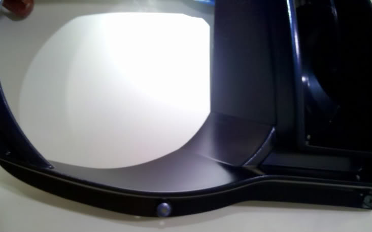

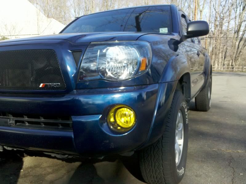

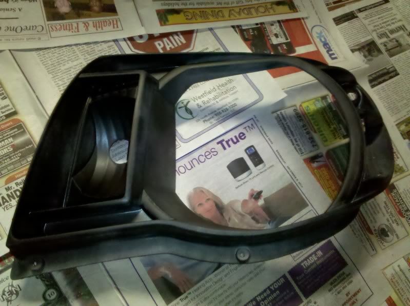

    Heres a brief follow up too.
    About 97% sanded:
    After a coat of primer:
    Here it is after paint. I did 2 coats AP, 2 coats Primer and 3 coats Base w/ a 1500g wetsand after the 2nd.

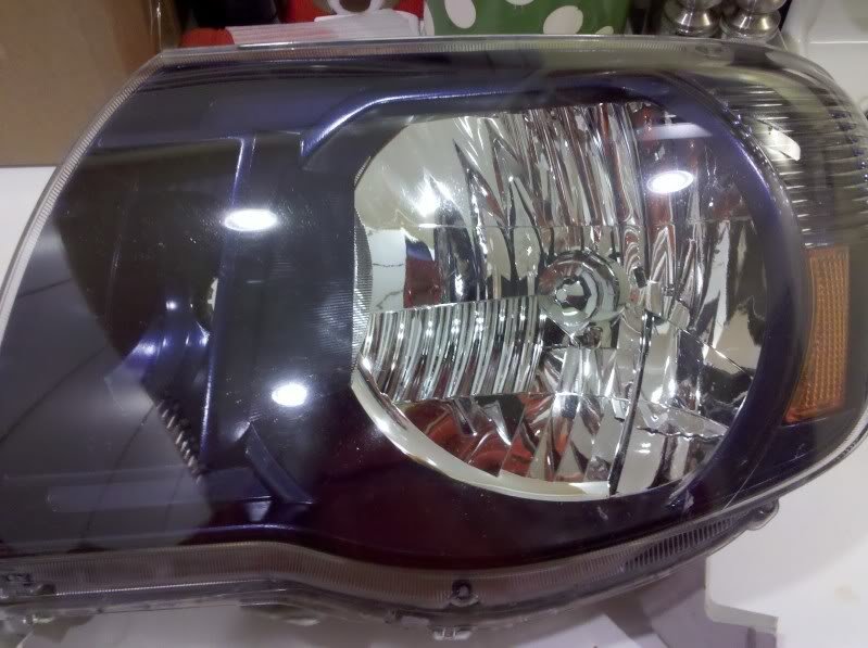

    After the Indigo Ink Paint:
    And back on the truck:
