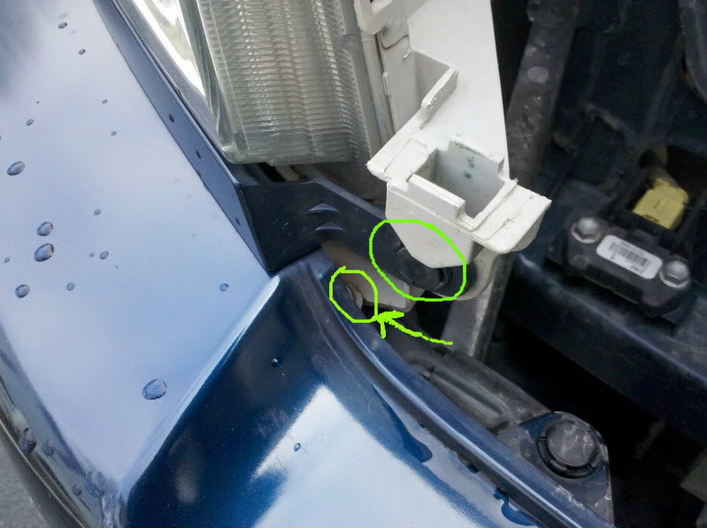

    The bolt underneath was probably the hardest to do... Took me like 10 minutes to get the first one. There's two bolts under there, it's the one on the top.

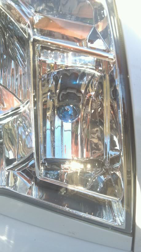

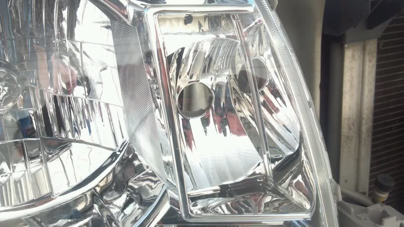

    I used this thread to install my new clear headlights. Thank you!! Awesome thread!!
    Then these piece of shit cheap headlights fell apart...blinker lenses "fell" out!!!!
    So with the help and advice from TOYOTA TECH31 I took headlights back out, shook them until the lens was at the headlight hole and used tin snips to cut the bastards up. Then I painted the ends of the blinker wire plug white because these will be exposed now. Then put em back in the truck.
    Not a big fan of the exposed blinker light but i had no other choice really. I wasn't going to bake them!!!

    Personally i think they look better now than they did before, but i am kinda partial to not having the lense there.:rolleyes:

    Actually.....the more I go outside and look at it.....I do like it better. Those lenses gave the bulbs a wierd look or some shit. :cool: i just wanna see what they look like at night without the lens. I'm assuming it will still reflect just fine.

    maybe im a dumbass i dont know. but im trying to remove the piece under the headlight. and i cant see the clip. i mean my dam headlight is in the way. how am i supposed to release the clip if the headlight is in the way? lol

    Have you removed your grille yet? If so, the clip is fully visible like in this pic from the OP:

    It was the clip inside. I finally realized that I'd have to wiggle the headlight out of the way then pop the clip on the inside. Bhlm was the scariest thing I've ever done and ill never do it again lol

    Guys maybe im blind or something but i cant find the 4th bolt!

    I removed the lower wheel well liner, below the headlight, and it made the removal quite easy.
