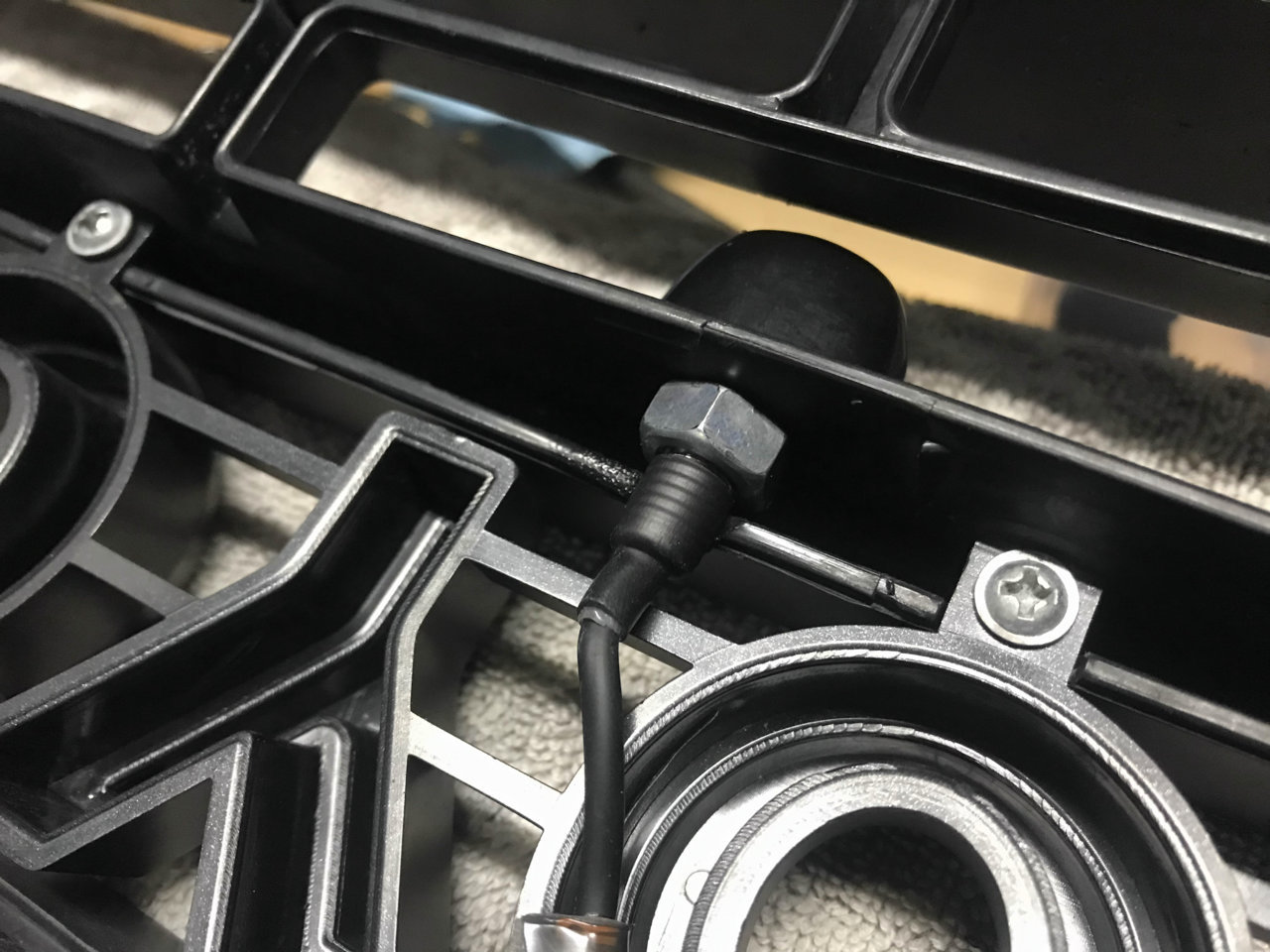

    I have mine in a similar place, but clipped to the headliner, pointed at me. I'm assuming the two holes in the upper left corner of my display is the mic. I have my wired mic running in some loom with the external gps antenna (mounted in the upper left of my windshield until my factory antenna adapter arrives). Wonder if the GPS wire is causing any interference on the mic wire since they're so close together.

    Oct 2, 2016
    #198816
    1,966
    Aurora, CO
    What's the link for the factory gps connector?? I need that.

    AdrenaliNate Call me Nate
    Jul 7, 2008
    #7799
    146
    Simi Valley, CA
    13 DCLB TRD Sport
    ICON Stage 3, 275/65-18 BFG T/A KO2, 18" KMC Monsters with custom caps, Access Lorado tonneau, Wet Okoles, AMP Research Powersteps, LED bed/hood/steplights, Fuseblock, ABS kill switch, Banks Pedal Monster
    scootter82[QUOTED] likes this.

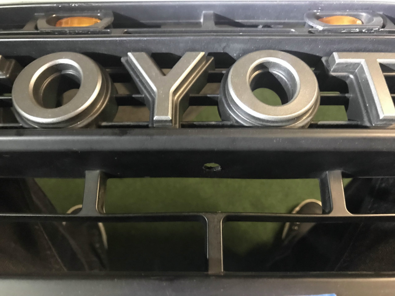

    Problem solved. Matte black vinyl FTW. Tested today. Almost looks factory with other matte parts in the interior IMG_4258.HEIC.jpg IMG_4259.HEIC.jpg
    I actually tried this last night and caller on the other end said it was a tad clearer, but still too quiet and with a lot of "road noise" between talking.

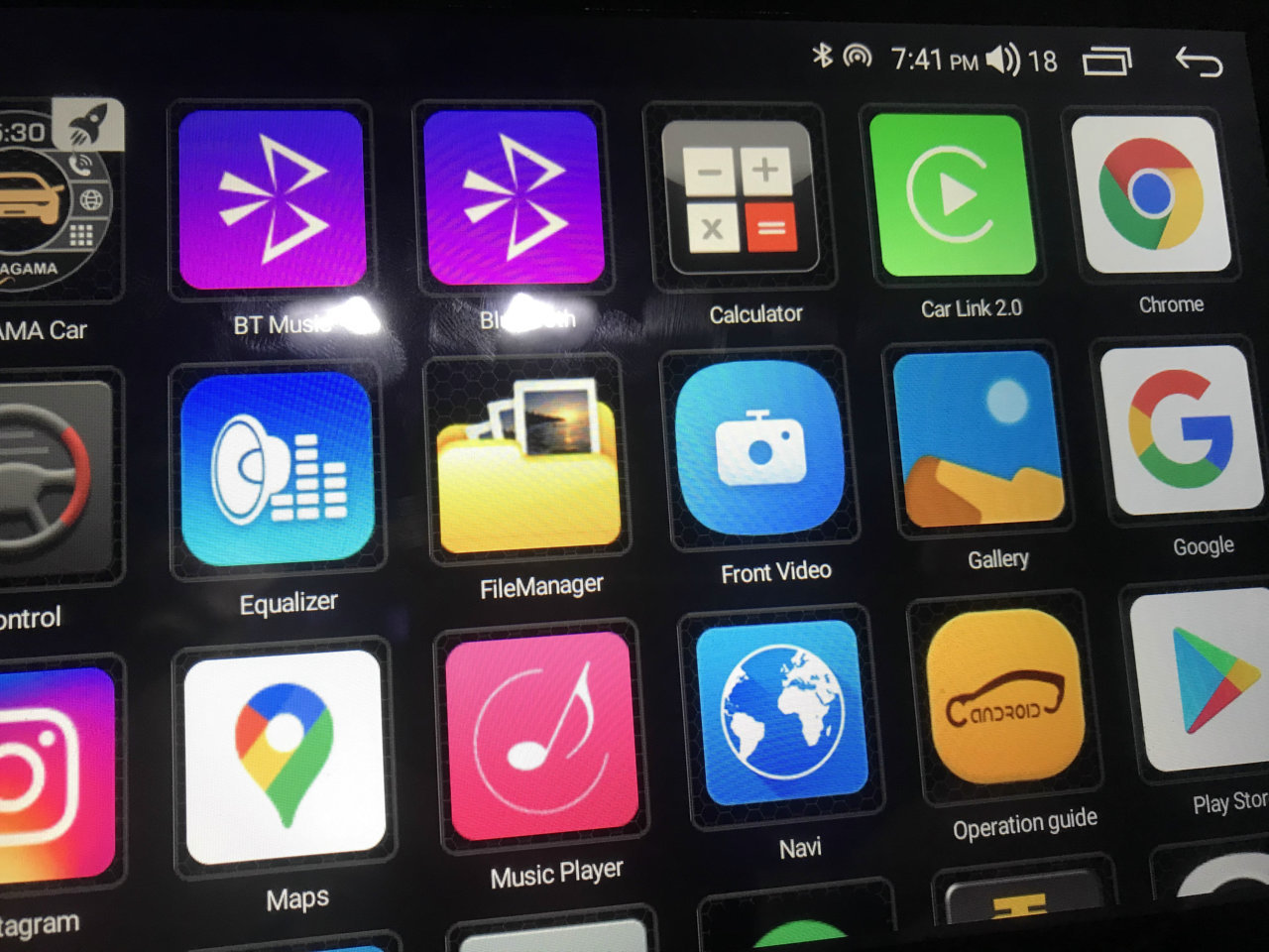

    This is the info I needed to hear. I'm definitely looking to add a front facing camera.
    What's the RMS output on this headunit? 50w?
    Is there a difference when selecting the years on the website?

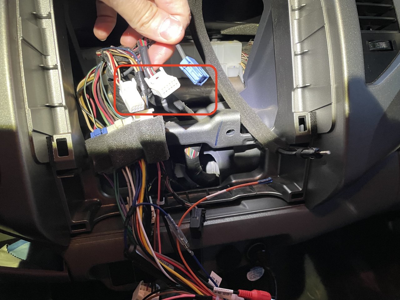

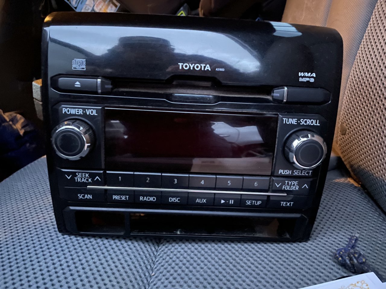

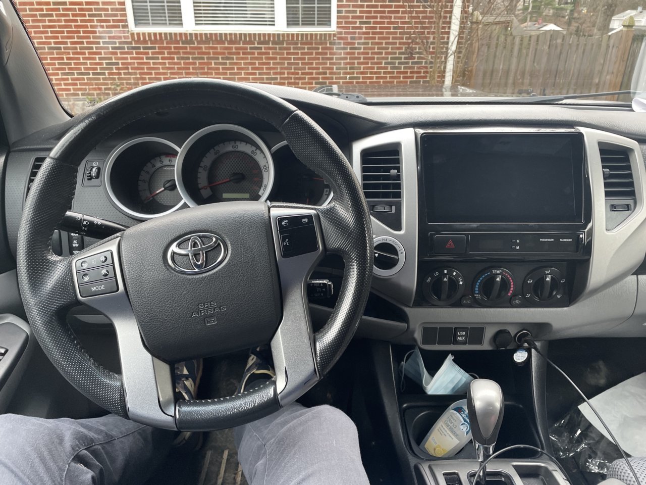

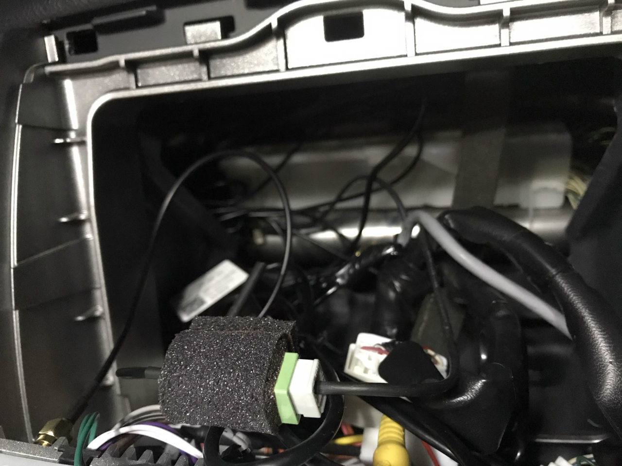

    Just installed the 9” in my 2012 with the non-JBL stereo in the pic.
    As an FYI for anyone with the same stereo, two of the five plugs from the original head unit don’t connect to the Joying harness (small blue plug is the aux usb).
    Also the USB retention cable mentioned throughout this thread doesn’t work (specifically in a 2012 with this radio). It is literally the only year Tacoma that uses this one ->
    Metra AX-TOYUSB-2 2010-Up Toyota USB Adaptor.
    And the usb Adaptor doesn’t attach to the blue plug that hooks into the stock headunit but instead plugs into another plug that’s under/behind the glovebox as shown in THIS thread (post #13)

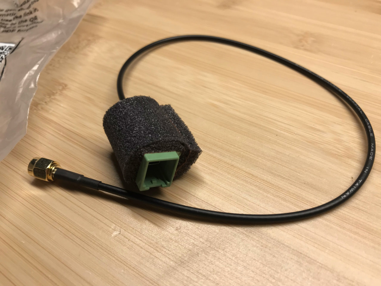

    Got my GPS adapter today and confirmed it works! Also seemed to be picking up both extra GPS and GLONASS satellites compared to the Joying. Tested them a few minutes apart, but I have no idea how often/much they fluctuate. Now I can remove the Joying module from my windshield :thumbsup:
    For those interested...https://www.discountcarstereo.com/HFC-SMA.html?category_id=262

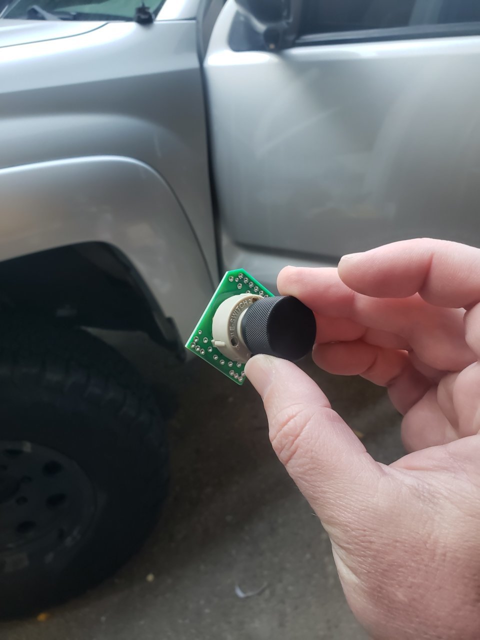

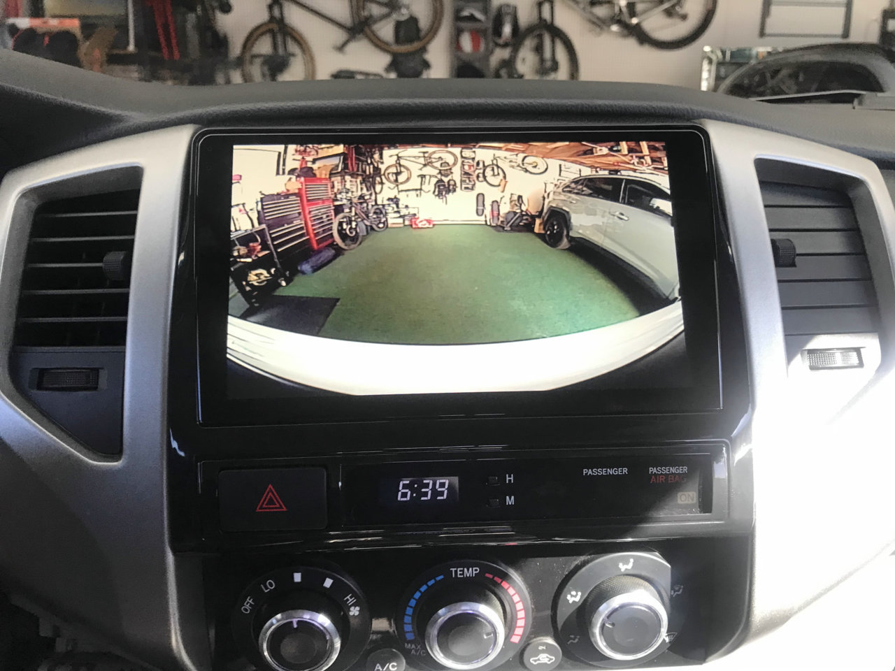

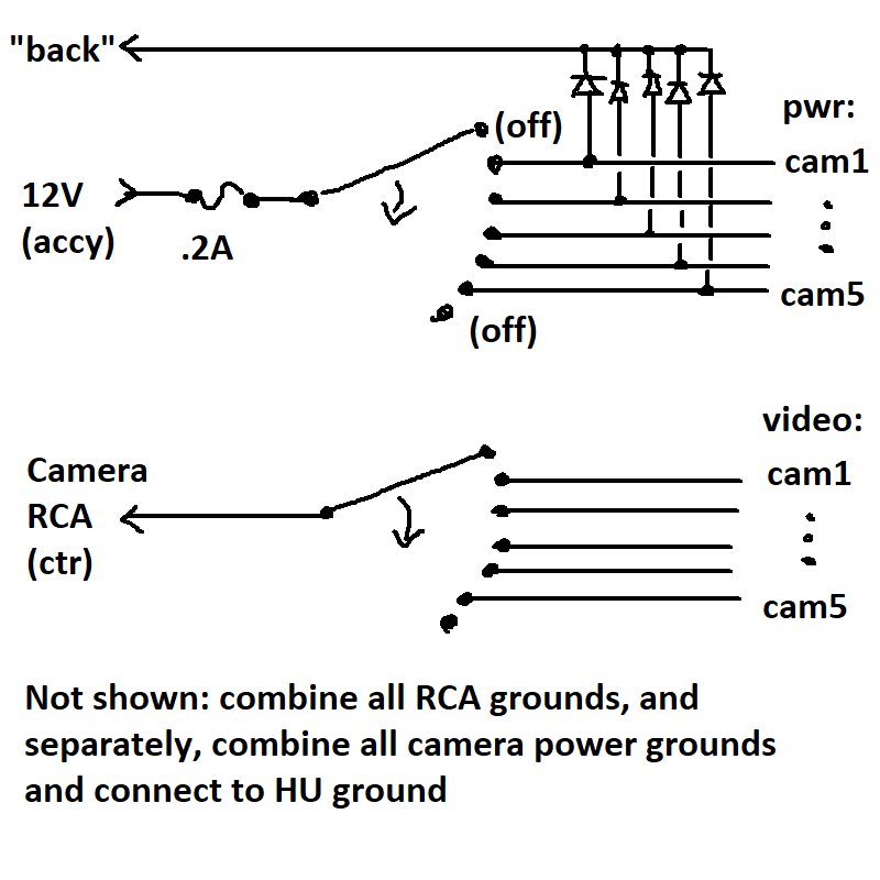

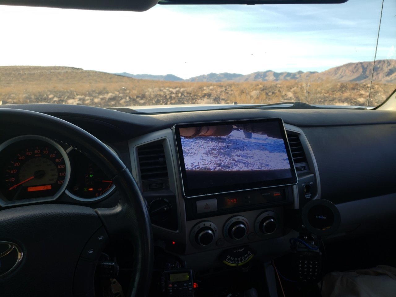

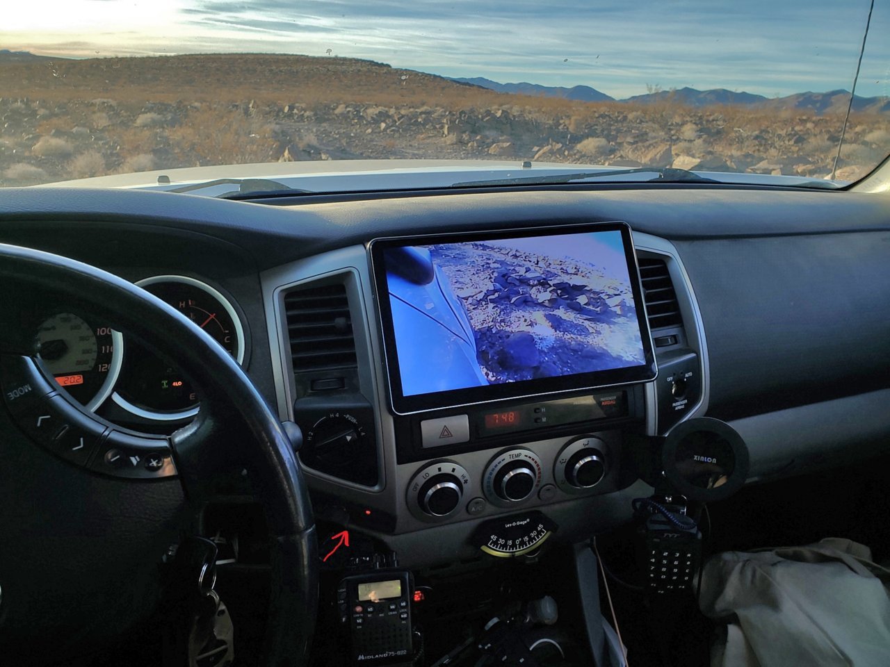

    Wanted to follow up on the camera issue. I'm mostly done with the upgrade and have been out on a few trips. The cameras are working quite nicely. I wish they were clearer, but they seem to provide just enough detail to help me place the tires. Here is the little knob circuit I made, before I soldered on all the connectors:
    I didn't get any photos showing the completed PCB, or of the cameras being used in actual demanding situations, such as "how many more inches to the cliff edge?" But they were indeed useful in such situations, and I at least remembered to stop at one point and snap a photo or two:
    This camera is in the passenger mirror, looking out over the tire. It's hard to see in the photo, so I added a red arrow to the camera selector knob. There's a little red LED next to it that turns on when the cameras are on.
    This is the "hey what's under my truck?" cam, mounted on the rear axle looking forward. I need to move it a few inches to the side to better see past the muffler. This one gets killed once a year or so due to driving fast on gravel roads:
    Dead camera, killed by gravel last year...
    But the cameras are only like $20, and sometimes they are pretty damn useful. A spotter would be better, but I am typically out there alone.
    Anyway the camera circuit is stupid simple. Just a two-pole rotary switch. One pole distributes power to the cameras, the other selects the video signal. There are diodes for combining the power to provide the "trigger" or "back" signal to the head unit. Here's a little schematic I drew in Paint:
    Wish I had taken a photo of the completed PCB. There were a lot of connectors to cram back into the dash there, but I got it to fit. Currently have 4 functional cameras, the fifth is planned to go in a rear bumper if I ever manage to install that.
    Hope this helps!

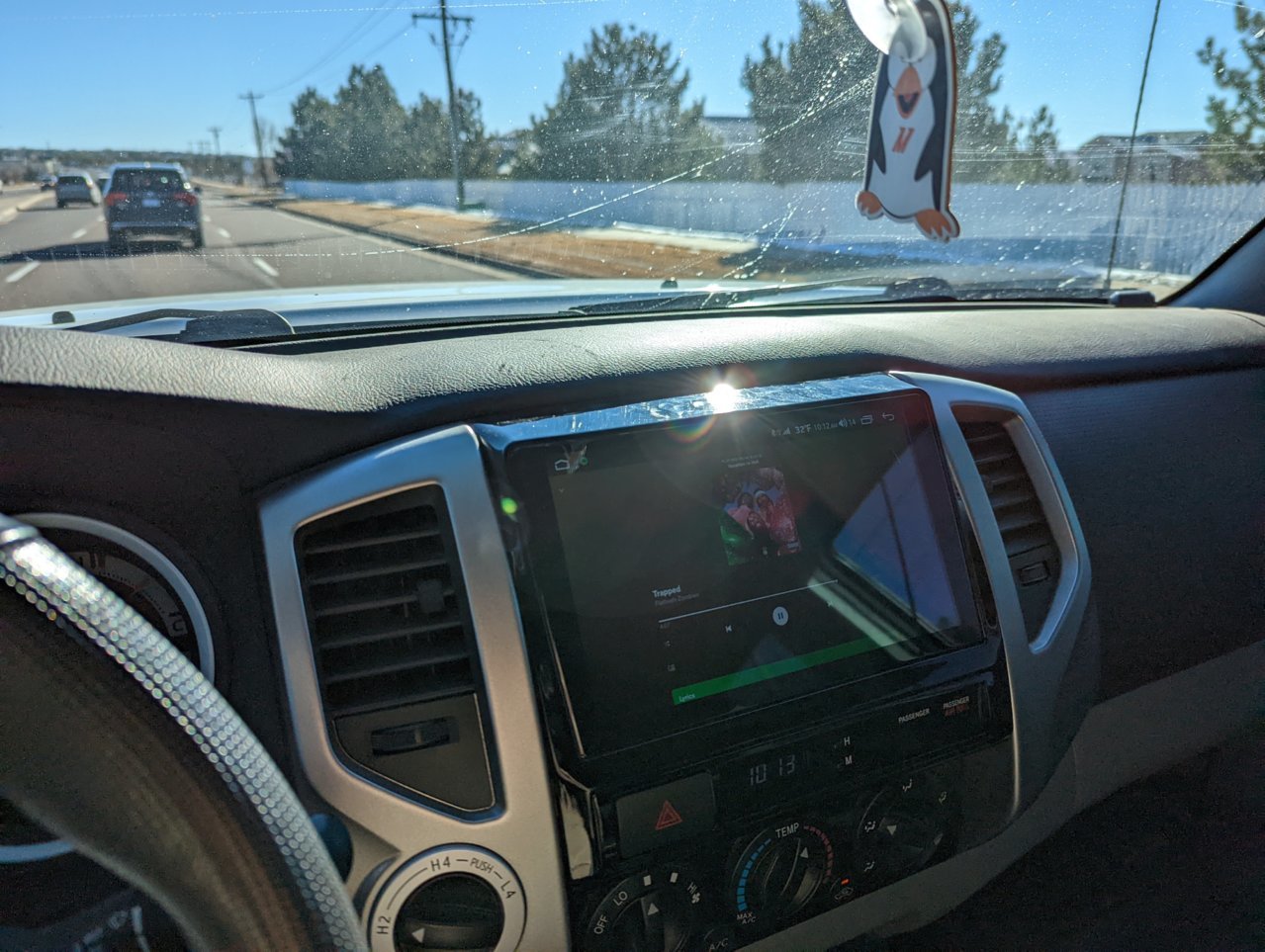

    No, like half radio/audio and half map/nav

    Probably need to look into custom car launchers in the app store
    Thanks, ordered!
