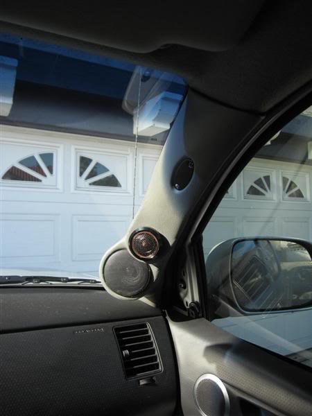

    Your a-pillars look great. Do you have pictures of them installed? The setup that you have is one that I considered with L3's and the L1 ProSE. I haven't heard them myself but the L1 ProSE's have been getting a lot of praise from many people. Too bad they're a limited edition... I can easily see these becoming a production model.
    One of my concerns with going the a-pillar route was having them be too bright. I'm curious to know if you put a blanket or something soft over your dash (not permanent of course) if it makes the sound any softer. If so, putting a dash mat down may help... although some people don't like the look of having dash mat. Another way (I'm told) is to have your tweeters 'tuned' so that they are less bright... I'm not exactly sure how this is done, but worth looking into.
    If you plan on trying the L4's in the kicks, you may want to 'consider' moving the tweeter down there as well. I'm no audio expert by any means, but I've read/been told that keeping your tweeters and midrange together is the "ideal" way to go. Although ultimately it's what sounds best to you.

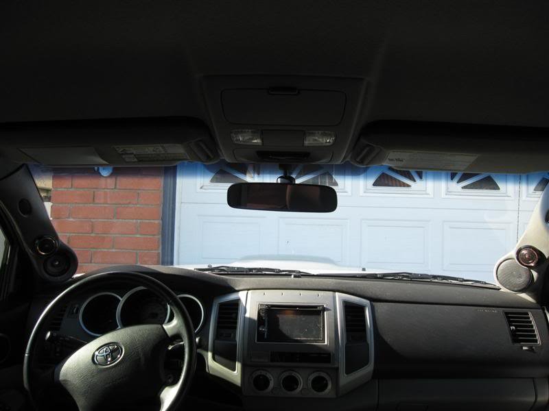

    Here they are installed. It's not quite cleaned up yet...sail panels off and missing one grill, etc.
    I had to re-work them to support a 3" mounted from behind. While I'm running the TB Bamboos for now, I used a blown L3 as a basis for the mounts. My thought was that if this ends up being the best setup, I can use the upcoming L3Pros as drop in replacements. :)
    As for reducing the brightness, I still have a lot of experimenting to do. I'm using a BitOne to control everything, so I can easily tone them down by levels and EQing. I just haven't spent enough time on it. In any case, the system does sound far better than it ever has just the way it sits now. The details in the highs and stage height are excellent.
    Nevertheless, I still have to know how a set of L4s in the kicks and the L1ProSEs either next to them or in sail panels, etc would compare before I'm done. Too bad you're not located closer so we could compare.
