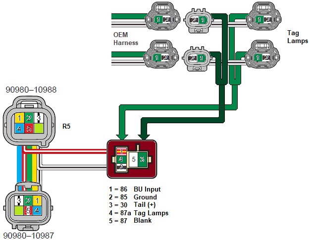

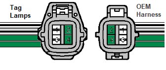

    This harness disables the license plate lights in a 2nd gen Tacoma provided it is equipped with a license plate light intercept. I do not own a 2nd gen so I do not know which models this harness will work for. You should confirm a matching connector exists on your truck and that unplugging it disables your license plate lights. The license plate intercept is the 4 position connector (green and white/black) on the left side of the photo. The taillight T harness is the 6 position connector at the bottom of the image.
    The purpose of the harness is to turn off the license plate lights while in reverse so they do not affect your rear facing camera. Since I don't own a 2nd gen Tacoma, I don't know which years or models have a backup camera. I assume you know if your truck has a backup camera.

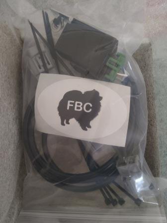

    Got a care package today:
    :thumbsup::bikewheelie2::proposetoast::drunk:
    Edit: It's a 3rd Gen version :burp:...

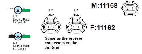

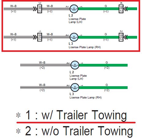

    Look under the bumper, verify if you have a connector (BE2) between the wire to the tag lamps (towing). If not, it not for you.

    All of these “DIR” designs merely snoop off the reverse taillight signal, as opposed to any camera signals. I believe Caribe mentioned the camera is 6V. If the camera is only on during reverse then we could have potentially used that signal to the relay coil. We chose the more obvious option instead. Also because the relay mounting spot in the taillight cavity seems ideal to me.
    The DIR harness doesn’t interact with the factory camera in any way, so you’re OK on that point.

    Dave, you making a DIR for non-tow 2nd Gen Tacoma? 'cause there's no BE2 connector for the non-tow. Or are you going to intercept at the lamp connector?

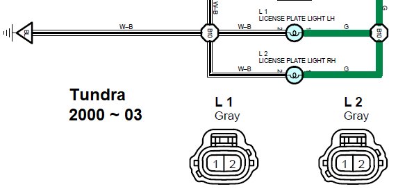

    Tundra 2003 same as 2nd Gen on most parts.

    The Tundra intercept connectors, relay mounting and wire gauge are different. The reverse T is more like 3rd gen and I believe is a match to 3rd gen TRD turn connector. Lengths also different.
    For Tacoma, 2nd gen is different enough that it can’t share parts other than license intercept connectors and the relay.
    Neither 2nd Gen Tacoma nor Tundra is as clean as the 3rd gen Tacoma design-wise. We 3rd Gen guys got very lucky on that.
