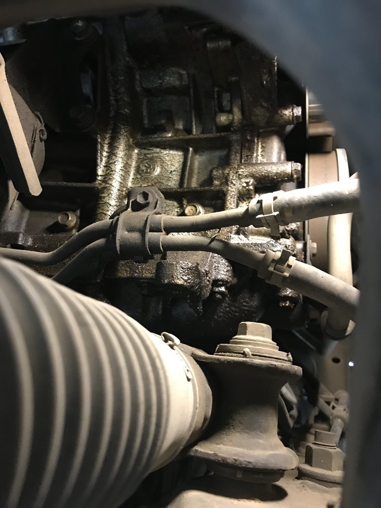

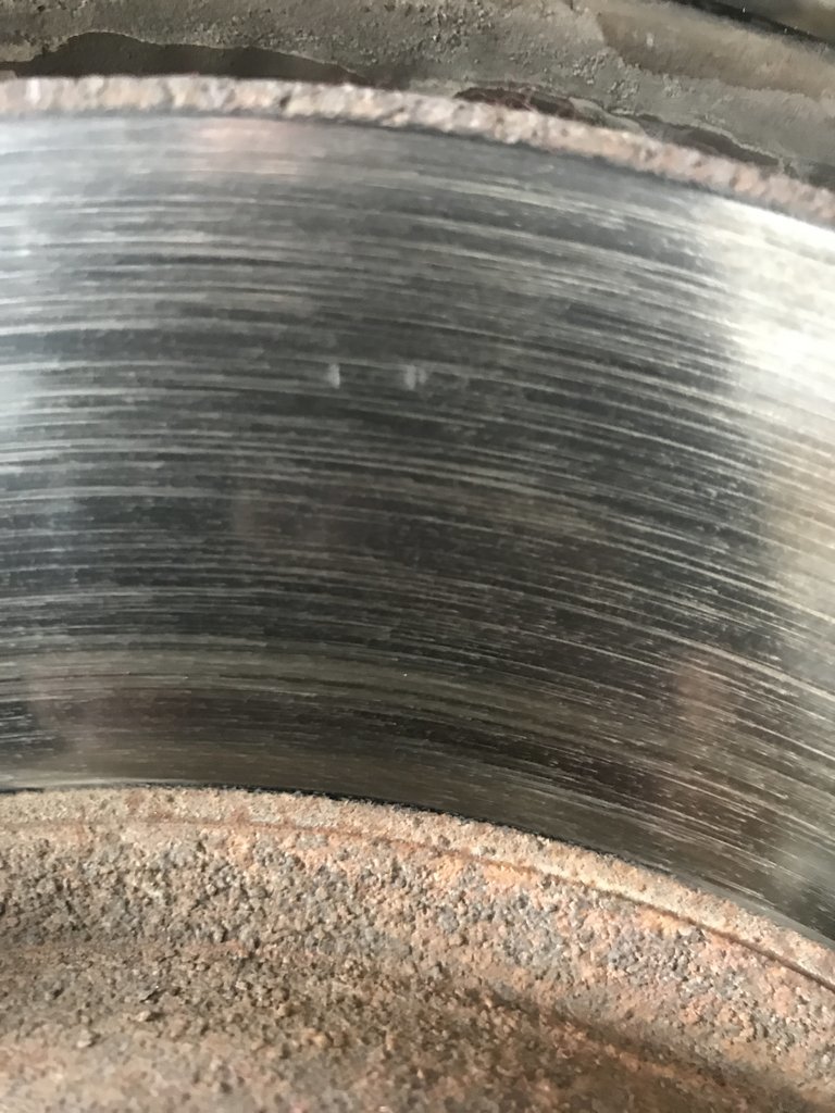

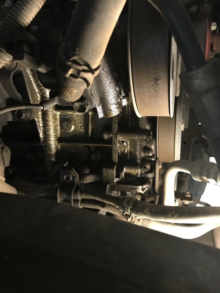

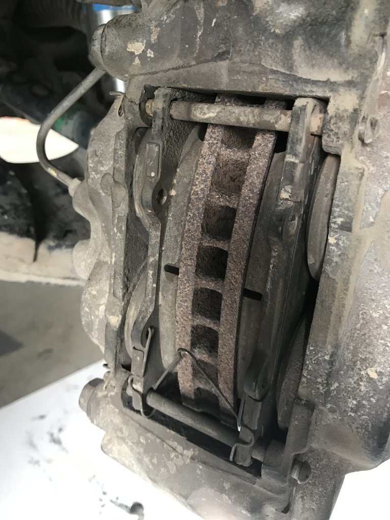

    Hey guys,
    Noticed a few things today when I was replacing my uni balls in my UCAs today. First of all, I noticed that the front passenger side of my engine was pretty grimey. I am a little concerned that there is an oil leak? (Pictures to follow). Is this normal? Also, I noticed that there were two tiny little dings in my brake disk. Ive had real noisy brakes lately so I wonder if this is the cause? The parts that dont come in contact with the pads are also pretty dam rusty, when should you replace rotors? Finally, is there any way to easily (well.. more easily) degrease the engine? Tips, tricks, etc.
    Thanks to whoever can answer some of my questions!

    I'm going to guess you timing chain cover is leaking. If most of the oil and grime were down low I'd say your crankshaft seal is leaking, although that's still a possibility.
    Clean it all up with engine degreaser (and hot water preferably), then you can see a little better where it's coming from.

    Gothchya. Its hard to tell where its been coming from since its been like that for a while. I will degrease and see if I can see where its happening. I know it IS a problem, but how bad of a problem would either of those be? I am sure they would both be pretty costly to fix...

    Definitely replace your serpentine belt as well! :) I doubt the nicks in the rotor are causing the noise, but new rotors and pads are cheap insurance...

    That looks like my engine before I had the dealer suggest to replace the timing cover rtv gasket. Had them do it (we bought a warranty with the truck through our credit union) 114,528 miles on truck. Coverage and cost of warranty 5 years or 50,000 miles $2,000, total cost of repair from dealer $1,658.xx, only paid $30 for "fluids" as warranty doesn't cover that. Also, might be having a head gasket replaced soon as I can hear bubbling when I first start the truck, my truck sucks fluid from the coolant reservoir, no coolant leaks anywhere around the truck, also have an intermittent misfire on the code reader for cylinder 6, and it's a known issue for the '05 and '06 years between cylinders 5 and 6.

    Yup got rid of the oil leak and they told me it's an issue with a lot of trucks cause the gasket wasn't applied properly at the factory in the left lower corner of the cover, not sure how true that is.

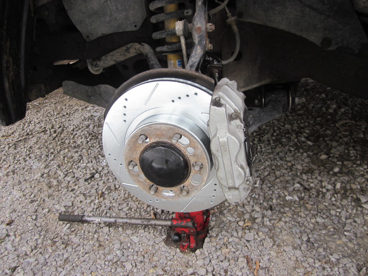

    IF you decide to do the brakes, a lot of guys seem to like the Powerstop Discs and pads set.

    Those the ones that come in a set from Amazon for like $150. I don't know much about brands for brakes so I just want to make the right choice when I do get them. They pretty easy to do?

    Dam that's too bad. Seems Toyota has too many problems at the factory that start wreaking havoc later on down the road. Sucks to have to worry about this kind of stuff. I'll get my OBD codes read soon and see what I can find out. Till then I'll degrease the engine and see where the leak is coming from. How long can these leaks go without causing much bigger problems?

    As long as you check the oil level and it's not gushing out like crazy you should be good. If you do a weekly check/PMCS or if you check stuff coming off the trail add it to the list.

    Very simple. Full instructions are also included on how to break them in properly.

    I had a slight leak around my timing cover (which is common on these trucks) that lasted from about 20k till 80-90k. It never showed on the dipstick, and then dried up completely.

    I got a pair them off Rock Auto for $84. Open up a paypal credit account, add something to get it over $100 and you get 6 months to pay it off with no interest.
    *EDIT*
    JBR1121XPR
    http://www.rockauto.com/?carcode=3310144&parttype=1896
    A little more expensive now, $92 for the pair.
