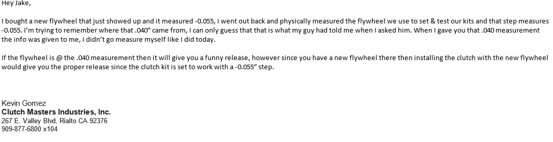

    Well, if anyone is following what is beginning to look like a CM clutch odyssey, here’s the email I sent them this morning.

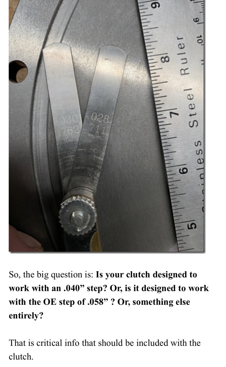

    The 1GR flywheel step is indeed intended to be 1.5mm. Less than that and it would be difficult to release.

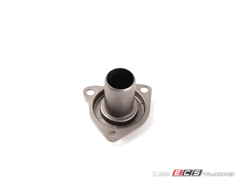

    I feel like it would be cheaper to source an entire used transmission and swap it in
    Curious to know if the 3rd gen Tacoma fits/could be swapped into a 2nd gen. I hear they shift smoother.
    There are some other cases on different cars/transmissions where such interchangeability is possible.
    I hear a clutch kit for a 1st gen Taco is cheaper, like $300 all said and done for the whole job.
    This reminds me. On Audi it's called a throwout bearing guide sleeve, and it's cheap and replaceable.

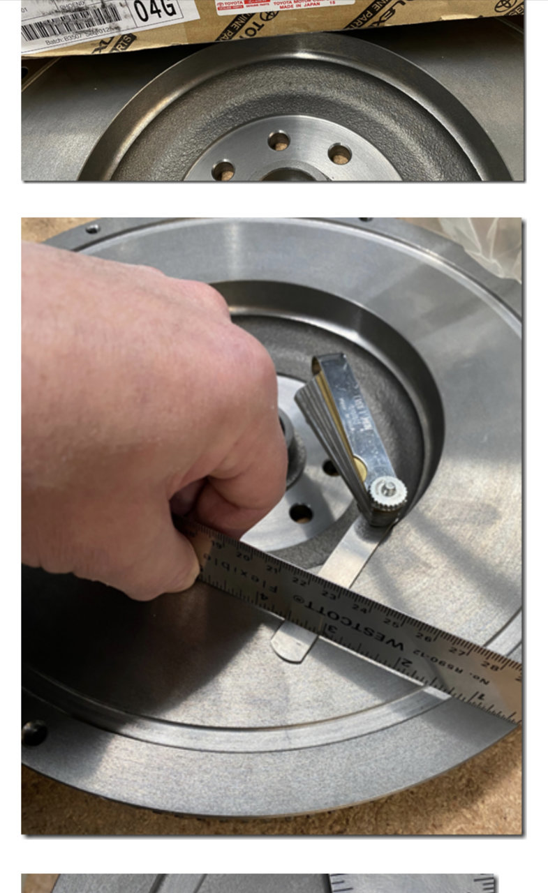

    They did. I'm still pretty pissed about the situation. Looks like he ordered a new flywheel to measure as well. Gets similar numbers to what I measured.
    Now, I have no intention of using this very expensive new flywheel. I simply wanted to measure it. I'll get mine cut to the correct step.
    I'm just imagining if I were in a different situation and was paying a shop to do this work.

    @ClutchMasters, how about stepping up and shipping Jake a new flywheel along with a will call tag for him to send you the one that was cut to the dimensions you gave him?
