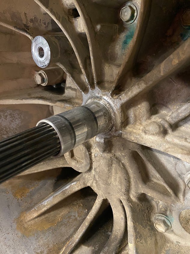

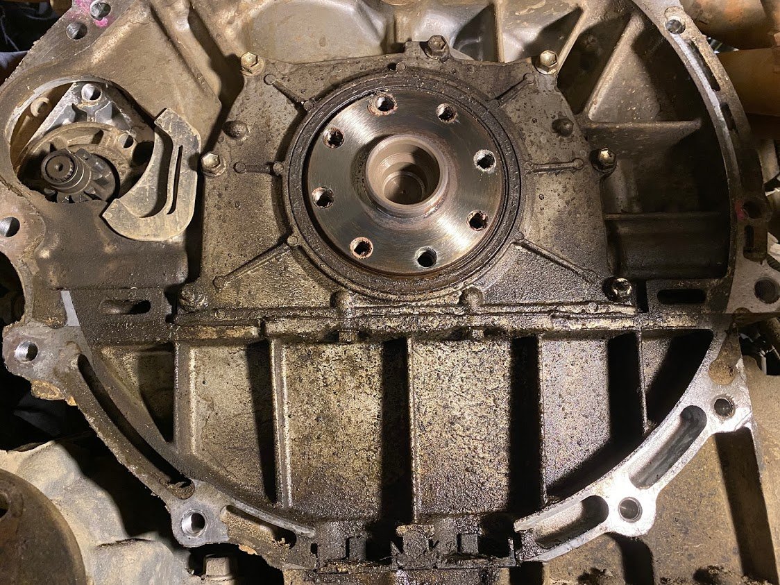

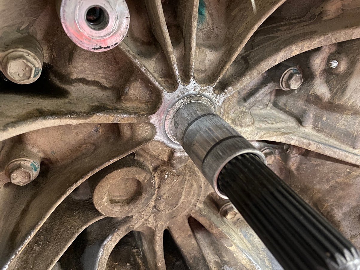

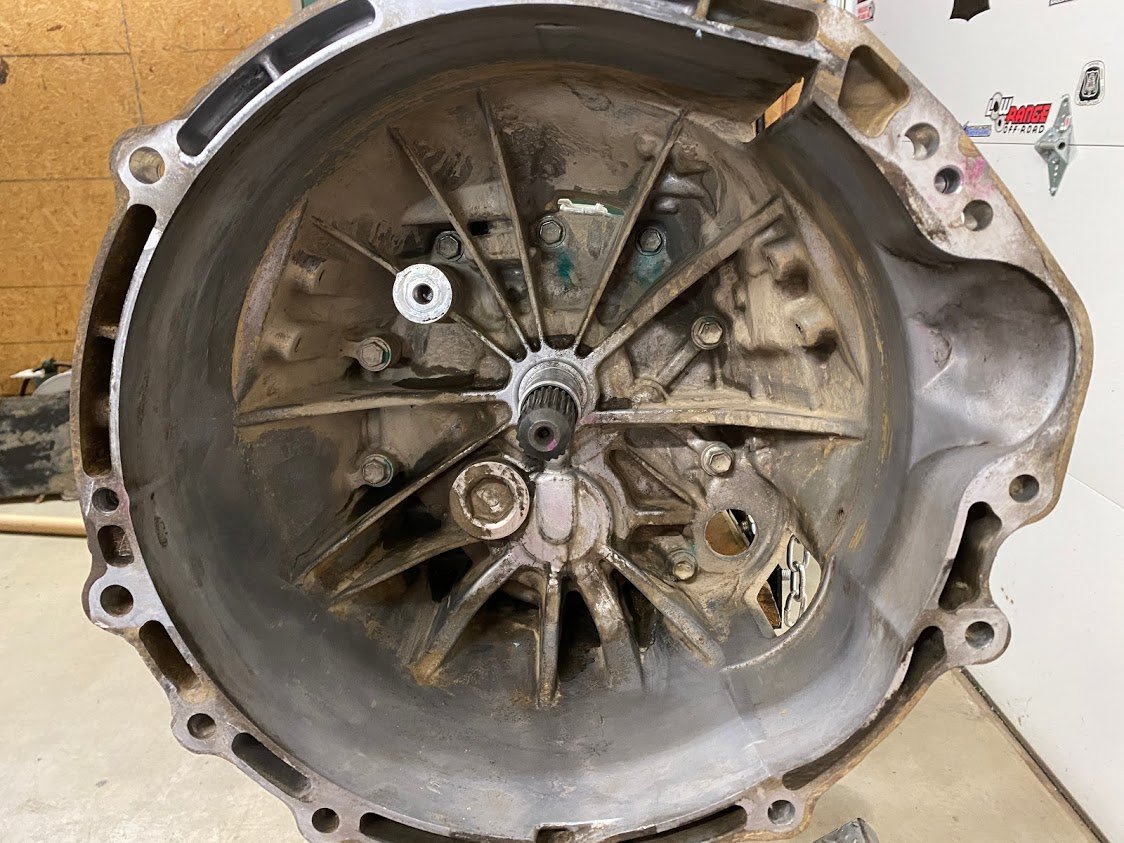

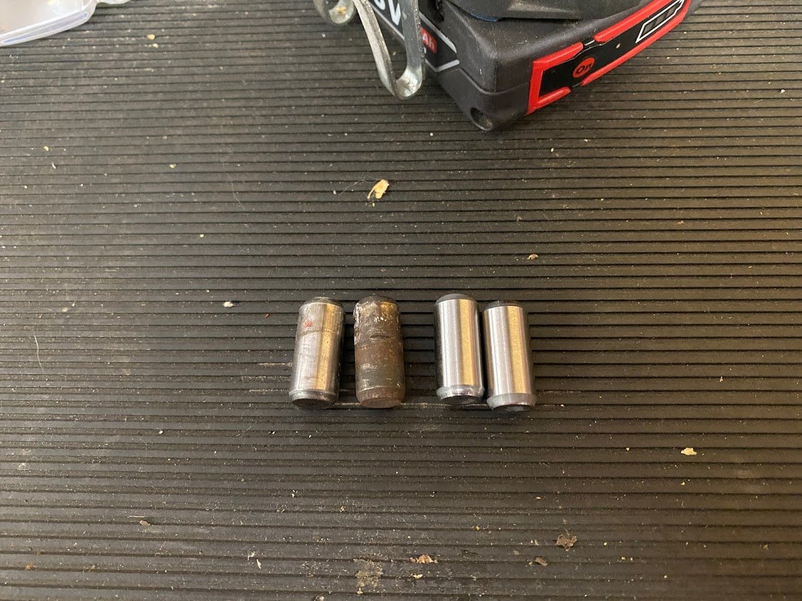

    Made some progress, hopefully putting the drivetrain back together and connecting the clutch lines this week. I had some slight wear on the quill shaft, but nothing to be overly concerned about. Also got 2 new dowel pins in the back of the engine block and removed the stuck ones from the transmission bell housing using a torch and vice grips.
    Still unsure where to tap into the OEM clutch line for the feed; I'm thinking where the rubber line turns to a hard line at the top of the engine bay.

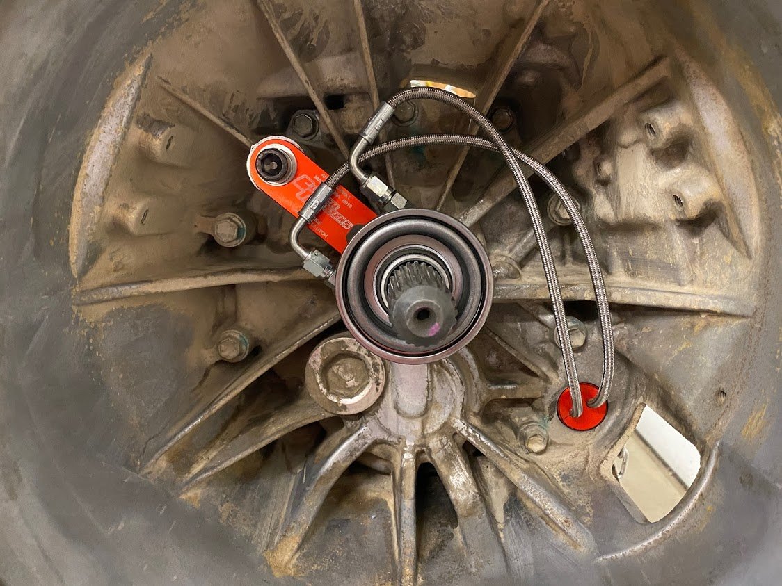

    My truck has ~55k miles on it, although I broght it back in way back in 2011 time frame for the "TSB throwout bearing" fix. That fix lasted for about a year before the squeal was back again.

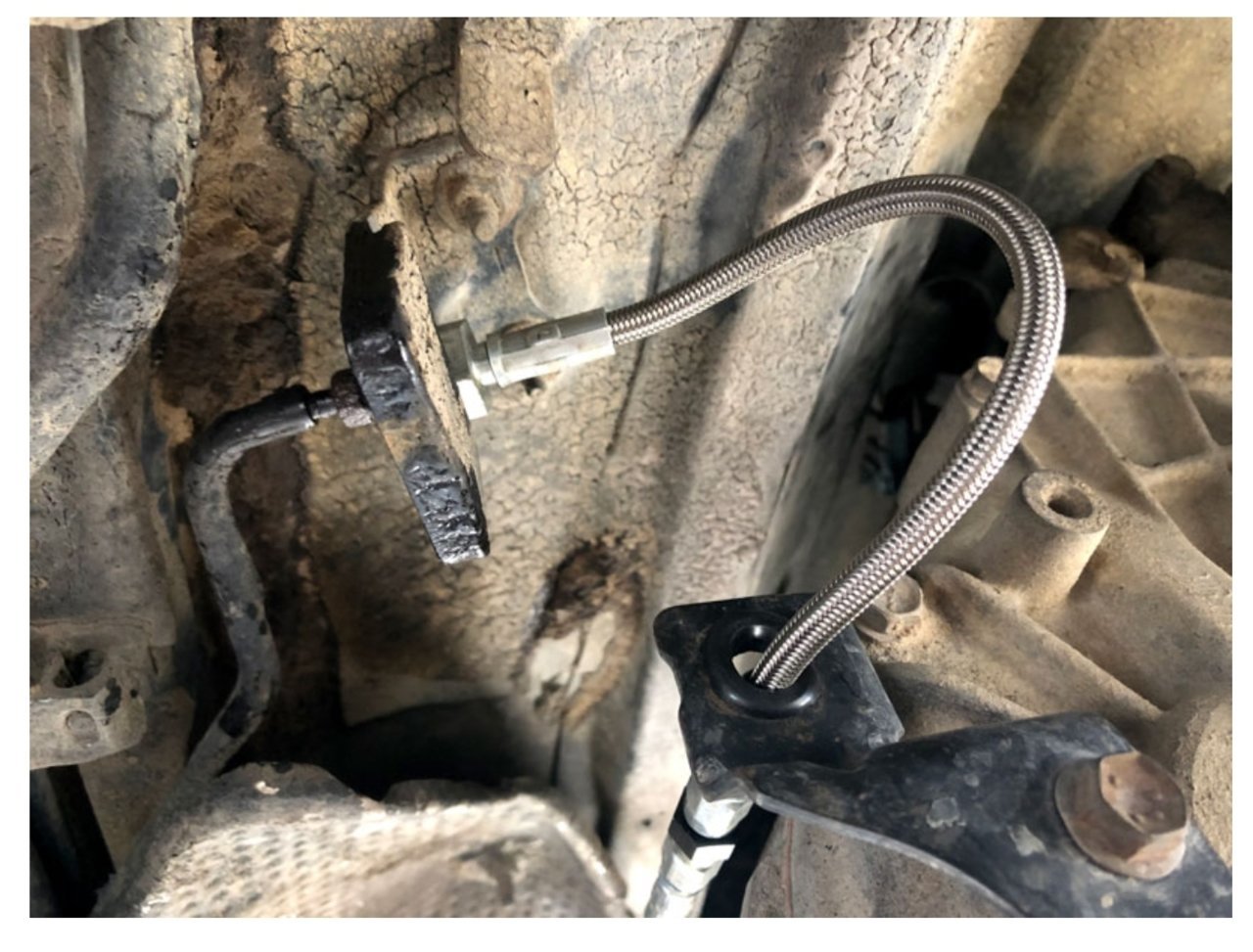

    Thanks for the link, i had read through that before, all I see for the tacoma is "The Tacoma clutch feed line does not go to the back of the transmission, instead it goes straight up the firewall. The feed line we send will work for both applications". Did not see a picture of where folks were tapping into, there are 2 spots I see that could be used. I wanted to eliminate the soft line and connect right at the brake booster if possible. Reading through here it seems that is possible, just wanted to make sure the thread types are all the same throughout the transition from the brake booster to the stock slave cylinder.

    Actually, after going back several pages and searching for "accumulator", somebody uploaded this pic. I modified it with where I think it should connect to. This would eliminate the rubber hose as well as the accumulator.

    Yes, sorry, I thought there was a picture of this on the truck in that installation guide
    Edit: this photo

    i connected mine above the accumulator. i had removed the accumulator with the URD Twin disc clutch. it had the parts to remove it. i looked up top and couldnt find a good spot to connect but didnt spend the time to look since i wanted the shit done.

    That's the FJ cruiser at the back of the transfer case
    You have alot of extra slack connecting it there versus up at the firewall?

    oh yeah, got a lot of slack. it reaches all the way up, but like i said, didn't feel like searching for the right line. dark ass garage and i was already on day 2 of this shit getting installed cuz of the transmission not wanting to mate up. so said fuck it, i know it plugs in there. got it bled with no issues and adjusted the pedal with no issues either

    mine had enough slack that i ended up running the braided line all the way to the clutch master cylinder

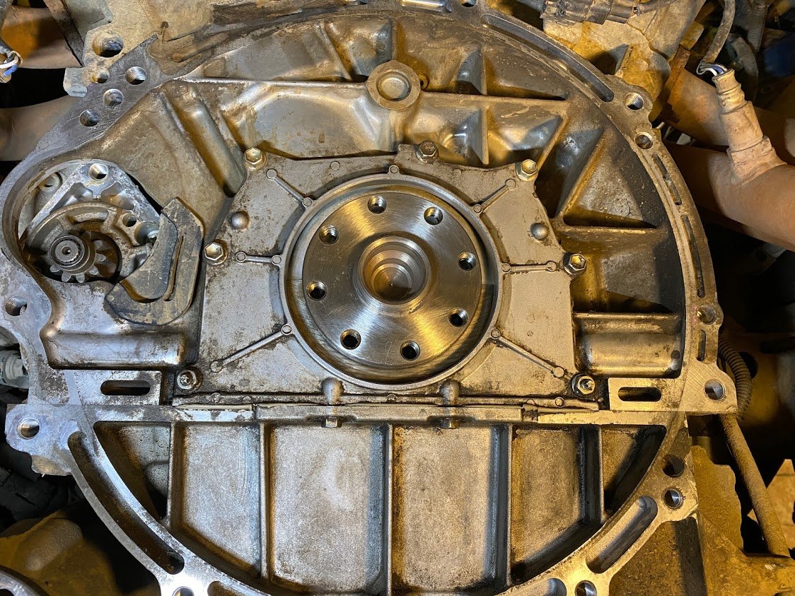

    To all the people changing the flywheel. What about changing out the rear main seal behind the flywheel? Does this seal start leaking at a certain mileage on our tacomas?

    I'd say if you have over 100k to just change it while it's out. Mine had 55k and was leaking, so I'm changing it out.
