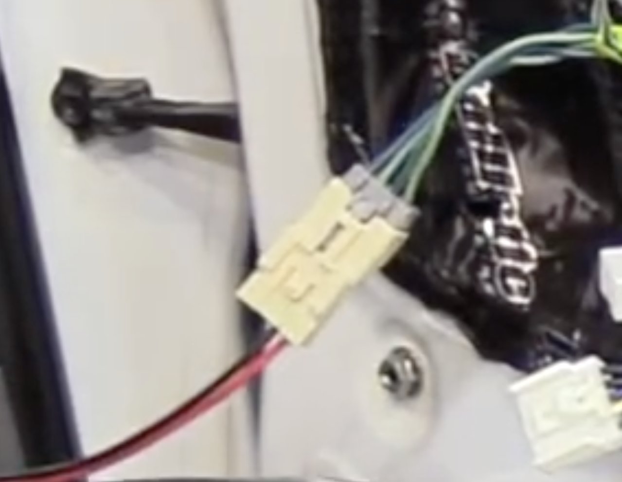

    I'm going to preface all of this by saying you probably actually don't need the wire adapters with the CS components. They have all the wires already built in to the crossovers unlike most other speakers. Better to have the adapters just in case, but as I walk through this process in my head, I don't think the harnesses will be needed. However, there WILL be some cutting and splicing. If you don't have a soldering iron or a pair of crimpers and some butt connectors, head to home depot or wherever and pick up one or there other, or both. If you go the crimp route, grab a bag of red butt connectors as well (at least 20 because it's nice to have extras)
    Start by removing the door panel. Lots of videos on this
    Then, find a good place to mount the crossover. Strong double sided tape works fine.
    At the tweeter connector, you will need to cut two of the wires. If you're looking at the connector with the clip facing up, it will be pins 3 and 4. Here is a very blurry picture of the wires you'll need. Note that the outer-most wire is our positive, and the inner wire is our negative
    These two wires will be spliced onto the input wires of the crossover
    That was the hard part.
    The two sets of output wires from the crossover already have connectors on them so you can simply plug in the tweeter and the woofer.
    Another tricky part can be mounting the tweeter. I have had good luck a few ways. You can make a bracket out of ABS plastic to attach it to the metal mount. You can use a piece of backstrap to attach it. You can hot glue it to the actual door panel (just be sure to not let glue get in the speaker grill.) I have done all of these things and they all work well. Just do whatever works best for the tools and materials you have available. Doesn't have to be fancy, just has to hold it secure.
    Also, another tip. If you're OCD and want the woofer facing up, put the bracket on the door panel to make sure you know which direction it will be facing. It IS directional so it has to be mounted a certain way. Once you know which way it goes, then you can attach the speaker
