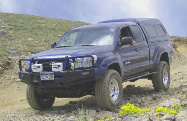

    Onlyontwo,
    With the mods plans you have, you'll love the truck. My '08 is similarly set up: ARB front bumper, complete All Pro armor + a custom skid pan under the fuel tank, 2 1/2" lift from OME suspension front & rear, ARB rock sliders, a Ramsey REP 8000 winch on a hitch mount, and a Snug Top topper. No weight problems with all that on the OME. I carry the winch in the bed in the recovery box and the ARB bumper has a receiver in it so the winch can go on either front or rear, depending on need. It also keeps that extra 75# off the front bumper for normal roading. With the lift and a bit of trimming I'm running 285X75X16 Michelin LTX AT2 tires on Centerline rims with a 4 1/2" backset. As was stated above, the 285 spare will fit up underneath just fine with a little tweaking. Enough words. Look here.
