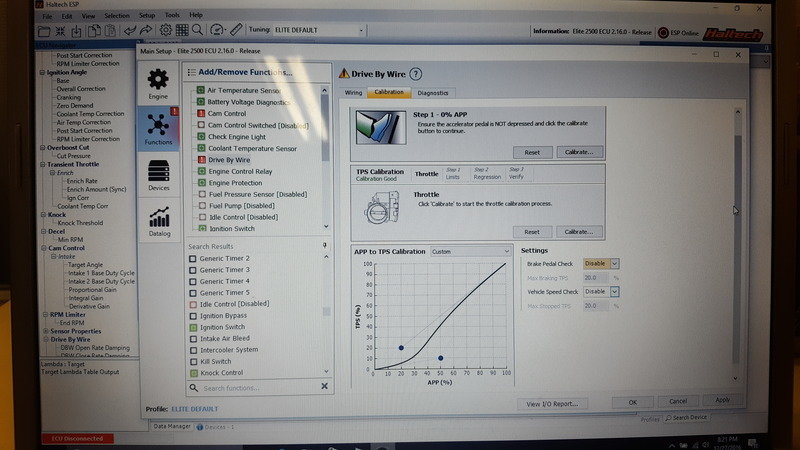

    This isn't entirely correct. The "lag" of the normal throttle curve, is due to the throttle valve bowing negatively, in respect to a linear line. Where pedal pressure equals throttle open position.
    By now with what you've seen and fiddled with on the HP Tuner, I am pretty positive that your comment would change if you responded today.
    A pedal commander changes that curve to near linear, linear, or above linear. From initial pedal pressure to somewhere up the graph where it merges back into linear.
    Thus having the throttle open more at initial pedal input, means the engine will get more air & fuel, thus more allowed power sooner. Translating into quicker acceleration off of the line. Compared to the stock throttle mapped curve.
    Here is a picture from my Haltech, for reference of the curve versus linear travel.

    I am going to have to respectfully disagree, the pedal commander simply goes inline with the throttle pedal simulating different (greater) throttle pedal inputs vs what you are doing. The ECU sees nothing more than the same accelerator pedal % as before and it is not changing the throttle pedal to throttle plate mapping within the ecu like you describe.
    The pedal commander will definitely open the throttle plate more at less of an actual input at the physical pedal, BUT that is only due to it amplifying the signal to the ecu simulating a larger accelerator pedal % thus moving you further up the stock ecu's accelerator pedal to throttle plate graph. Its absolutely not the same as changing that table within the ecu to be more aggressive and open the throttle plate more at the same pedal % input to the ecu.

    You said it yourself. ;) It doesn't matter what strategy they use to get more open position from 0% APP on. Only that the device does.

    But answer me this! does the stock accelerator pedal map change at all in the ECU with this device? No... the device only simulates you pushing on the pedal more, the ecu knows no different between stock or with the device inline.

    Doesn't matter. Not the point either. Only that the throttle opens more at an earlier pedal percent, which then allows quicker acceleration off of the line, than a non modified pedal input.

    but to the ECU its not an early pedal %
