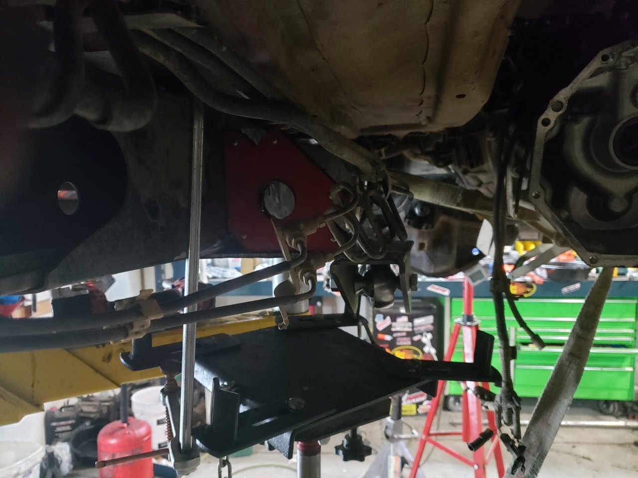

    The oil pan is my problem at the moment. The axle right now is in a great spot for the tire size. Ill send some pics

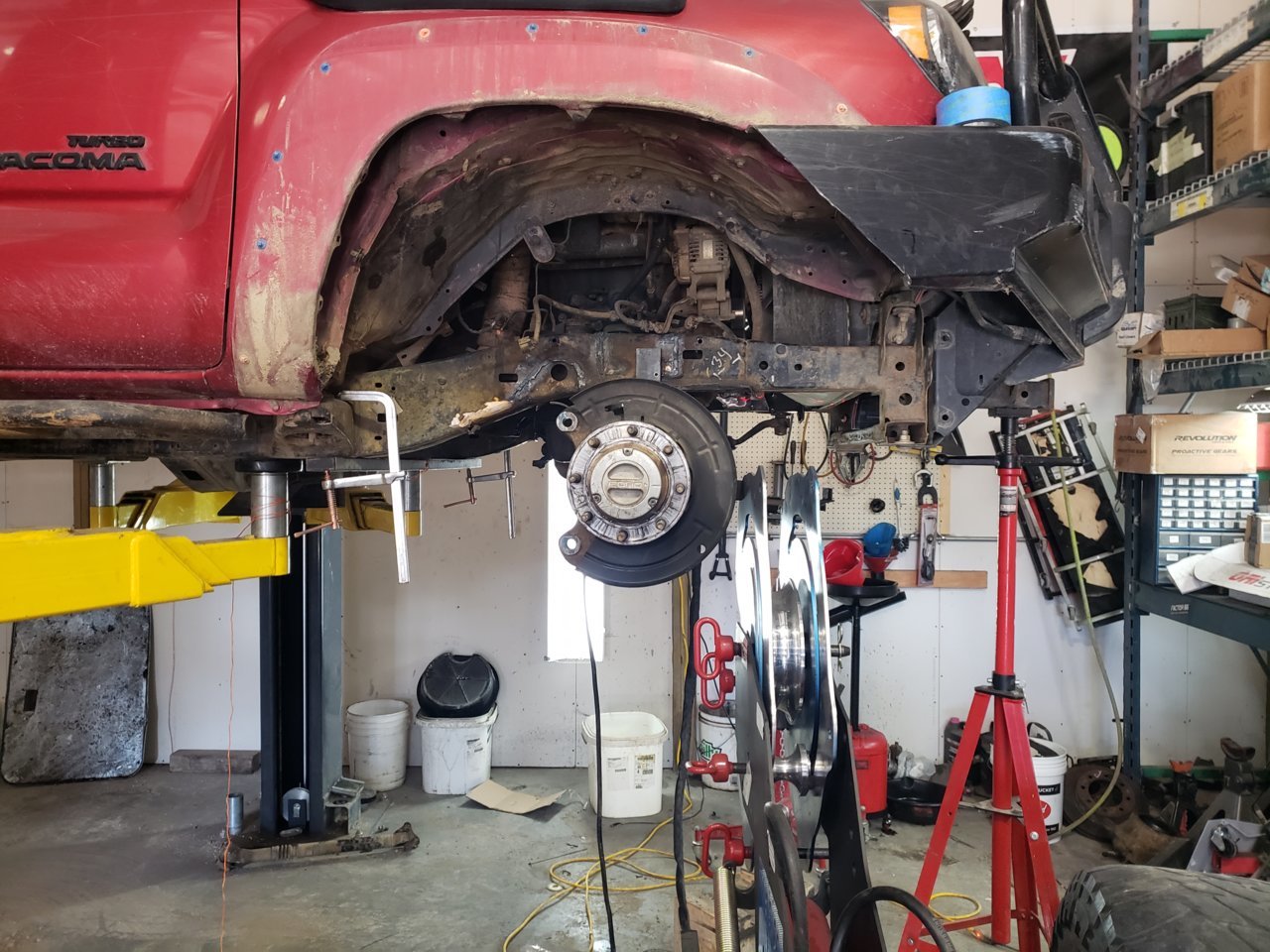

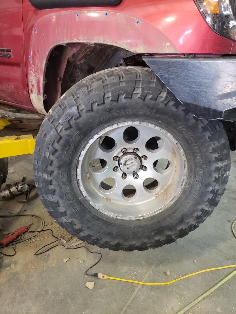

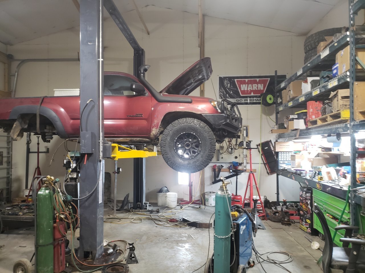

    Thats what i was looking for. Wheel base was 109" but through that bitch out the window. Until i get the front done ill decide on the rear. What it looks like now it 25" frame height with 4" up travel. Thats whats nice about oris i can change it on the fly(somewhat). To move the axle forward 6 inches to get it 3 inches lower will cause a month or more of headache, cutting, welding, etc..... figure i can run like this and move if need be. If i hadnt use that truss maybe gain 2", but im not taking it off nope not happening.

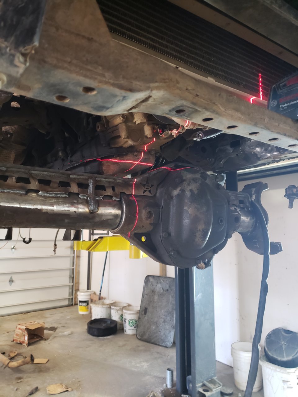

    Current up date got the axle welded in at full stuff to get my links figured out
    Passenger side is cleared for left and right turn to lock with 40's
    Bottom links tacked in.
    The woman is slowing me down due to me installing a lift on her new jk.

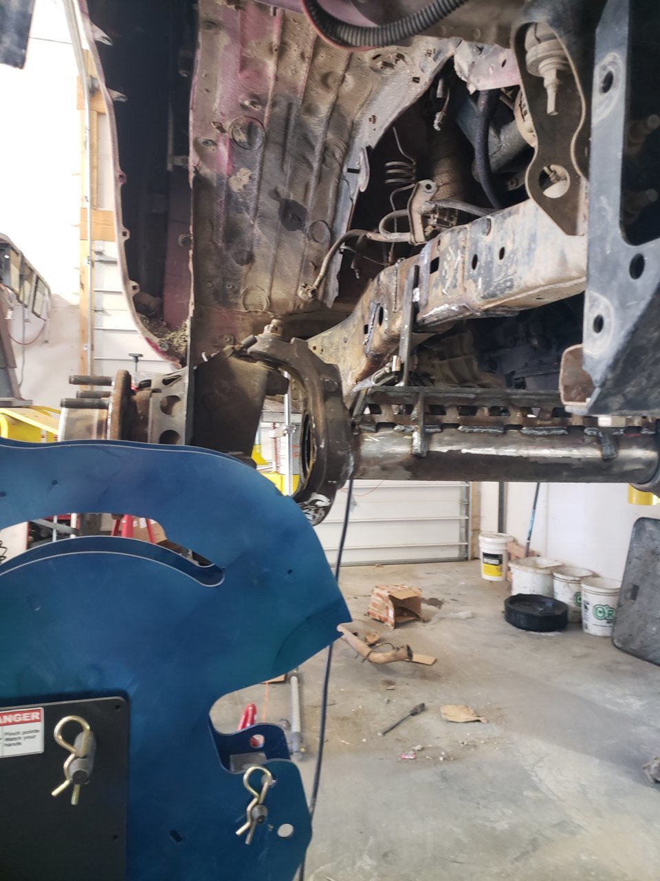

    Got the passenger side lower link in, its taking a bit to get everything perfect.
    Looks like my lowers are going to be arpund 35 inches hope thats good.
    Everything in the 3 link calculator says its good but we'll see

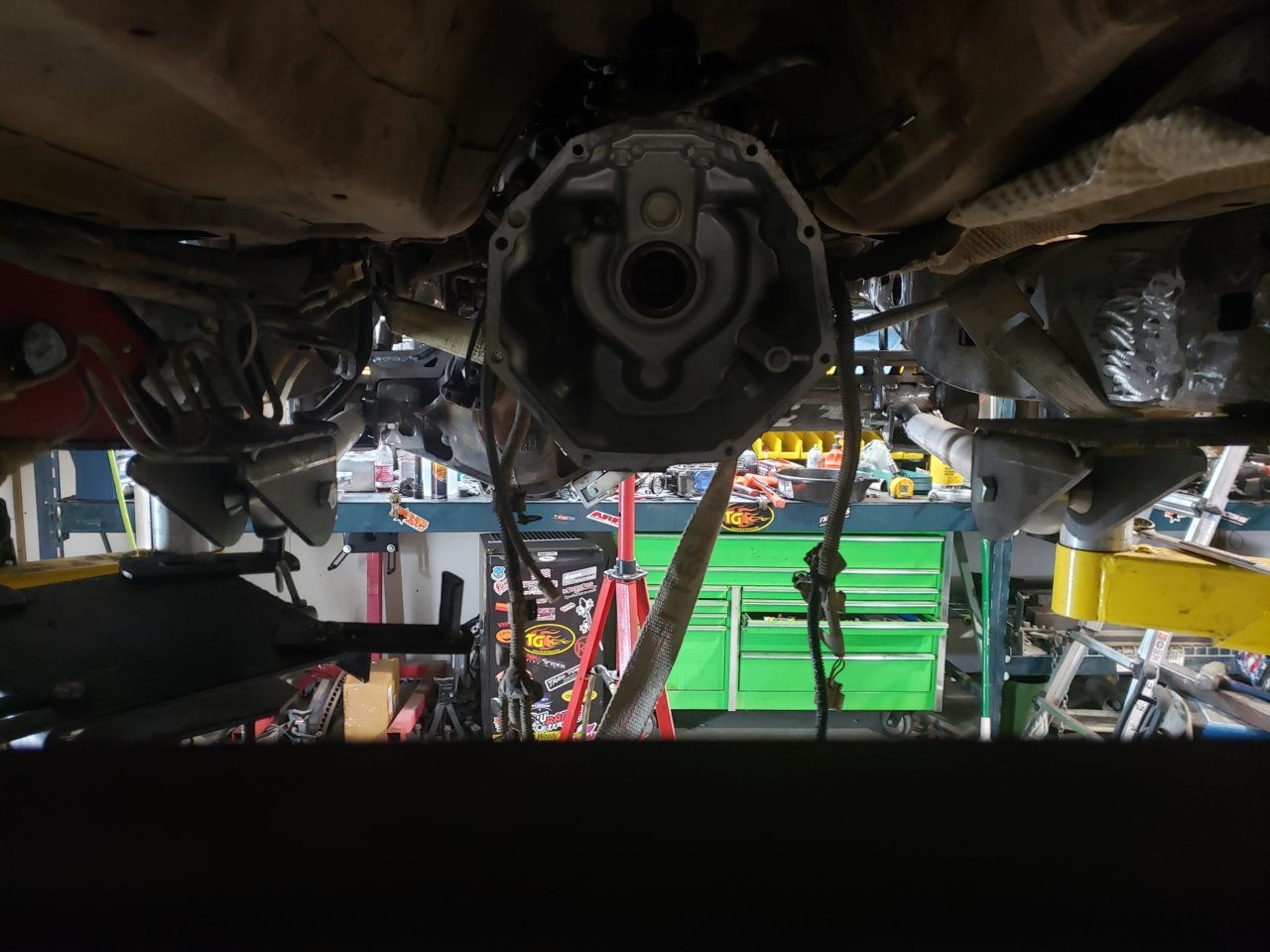

    Thanks im at crossroad now. My lower links are straight right now but narrowing the front axle caused them to be mounted inboard roughly 6.25 inches from the edge of the frame to center of joint. Ill post some pics
    I dont want to bend them to clear the tires so we will see.
  15. Mar 21, 2021 at 11:21 AM
    #35
    Team_Jake
    Team_Jake Well-Known Member
    Jun 18, 2018
    #256764
    135
    '99 4Runner Limited '01 Tacoma Xtracab
    It's good to get some triangulation on the lower links, it reduces flex steer and takes some load away from the panhard bar. As long as you have the clearance, I recommend going that route. If you need to bend your lower links, I suggest getting self centering joints like the Metalcloak Duroflex joints so the link doesn't try to rotate.

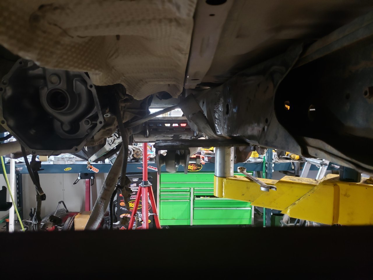

    Yeah bending them is the last resort. I got both mocked up and looks good. I might put a longer plate in to go along the frame. The drive shaft cleared just fine. I took the tcase out to get the crawl box installed to verify drive shaft clearance
