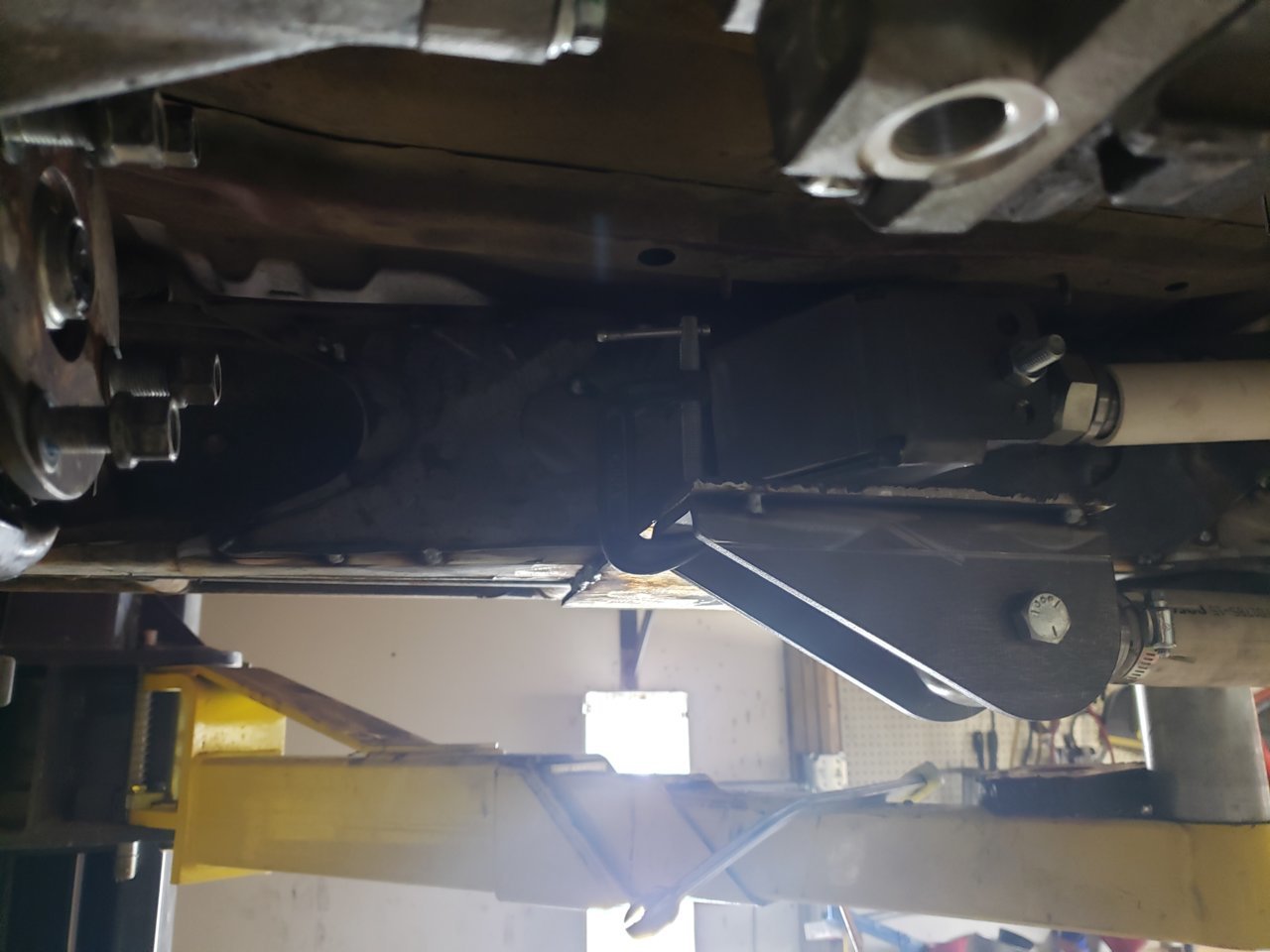

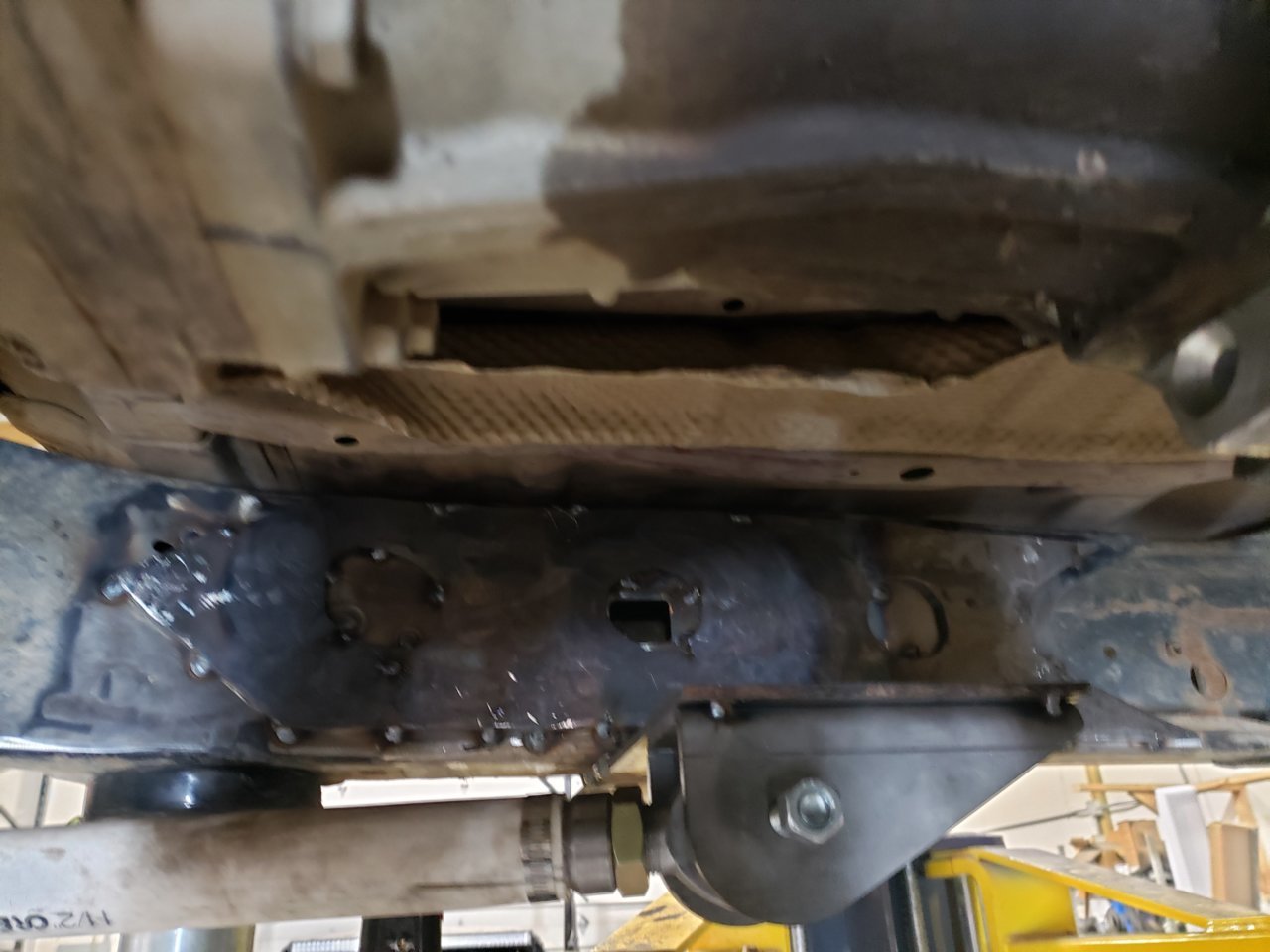

    Got the frame stiffeners and backing plates up with the lower links just trying to get my upper link set right.

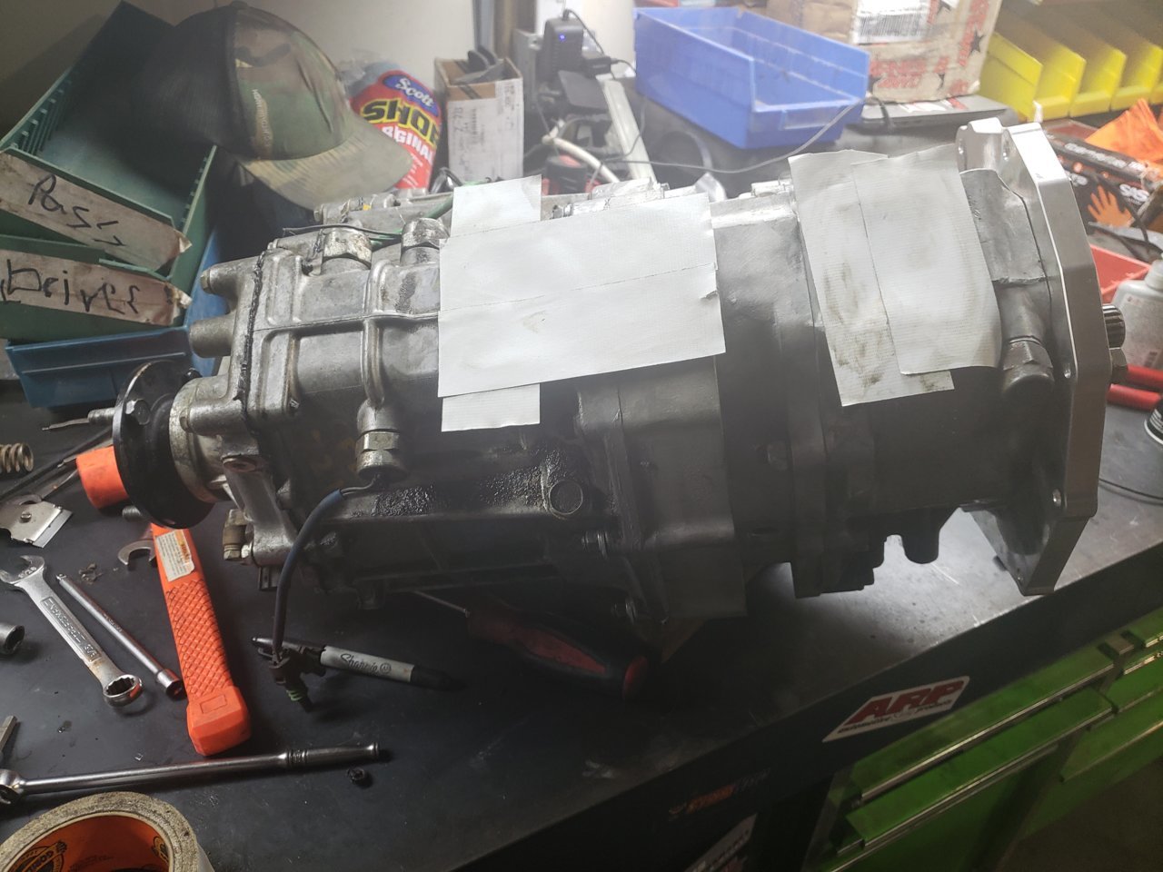

    Got my crawl box put together and tcase installed. Not surpised trail gear shorted me some bolts

    Don't weld your upper link mount in until you flip that bolt... :)
    malburg114 likes this.

    Ha ha i was waiting for someone to catch that. Yeah it was there to hold while i tacked it and did a bunch of measuring. I actually flipped it to the passenger side.
    Im at a crossroad right now cause the lowers either need to go farther down or the axle needs to move farther forward. Kindve a bastard
    The roll axis angle is at a +5°which causes oversteer
    Ariyan[QUOTED] and malburg114 like this.

    I would agree with an axle shaft but not a ring and pinion. The tcase is an fj cruiser cause they have a manual shift where the stock tacoma uses an electronic shift. I never wheel alone. The tcases are cheaper then doing a ring and pinion.
    The tcase is chain the crawl box is gear box.
    Ha ha yeah did they use a chevy dana 44 pass drop?
    Fj chain drive with a toyota gear for crawl box
    With trail gear adapter

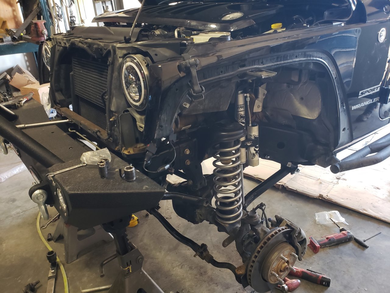

    Had to change it up due to orders from the old lady. Had to make her jeep presentable.
