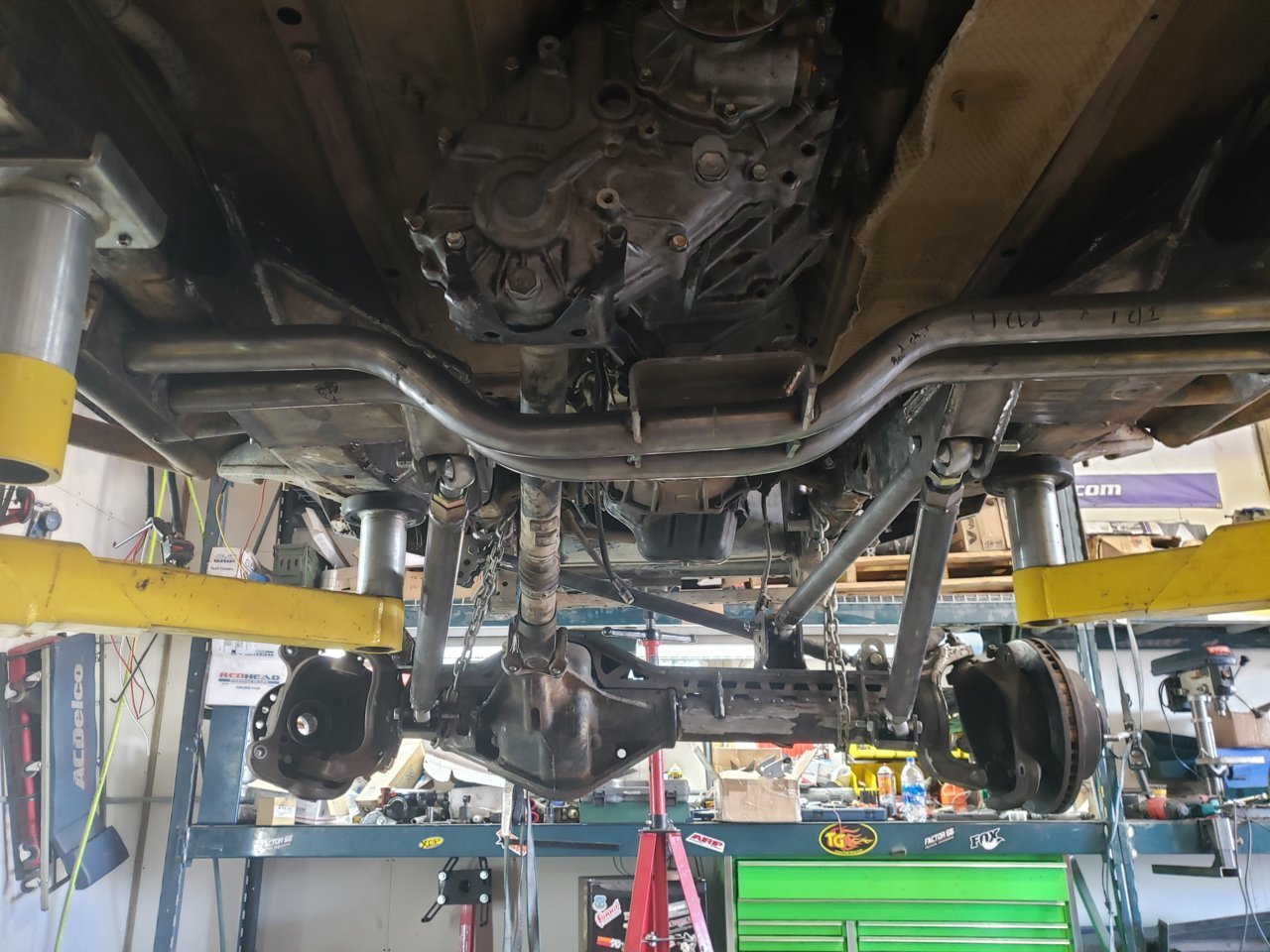

    Well got the jeep done last week and finished up heads on a 6.0l.

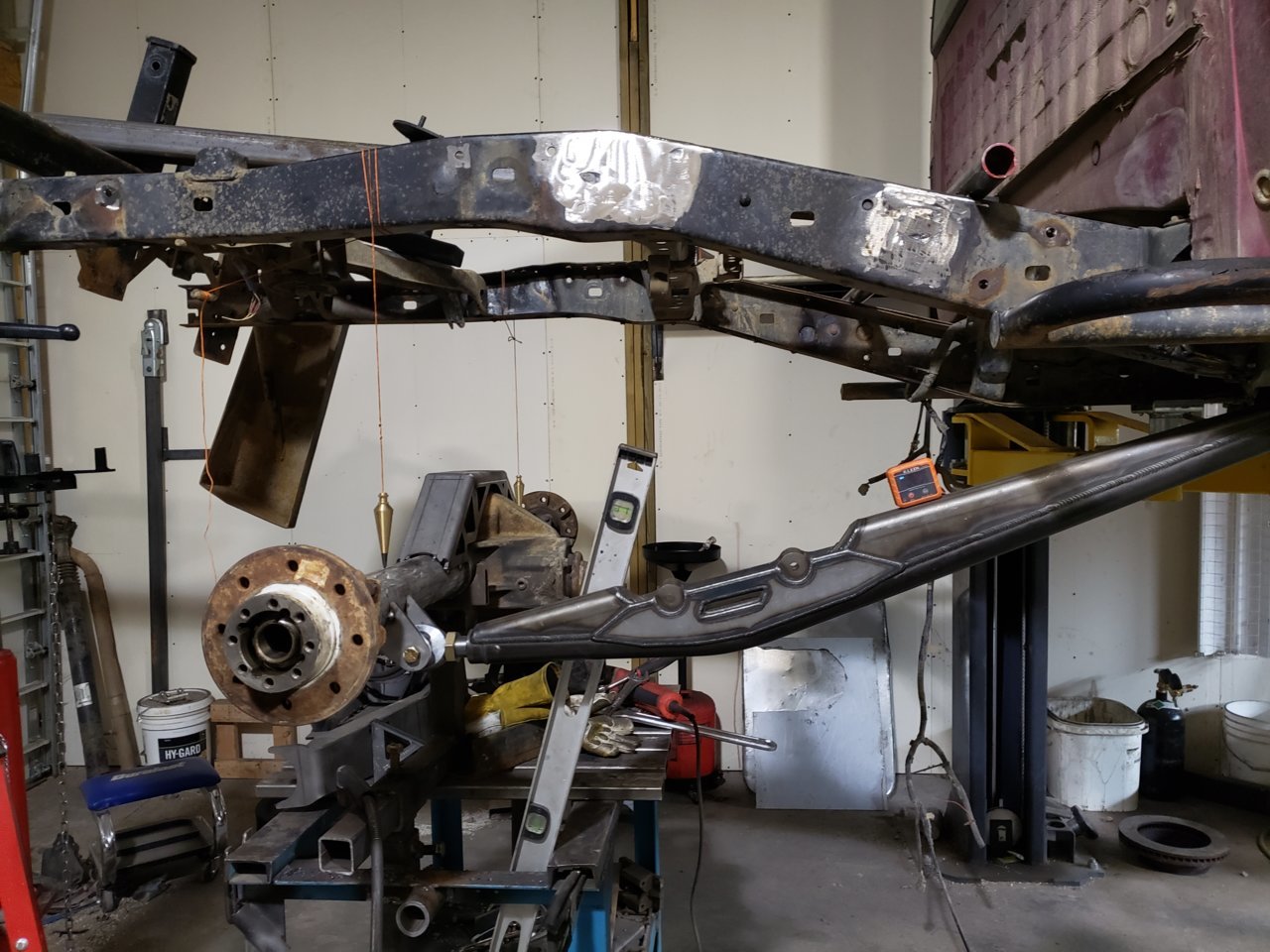

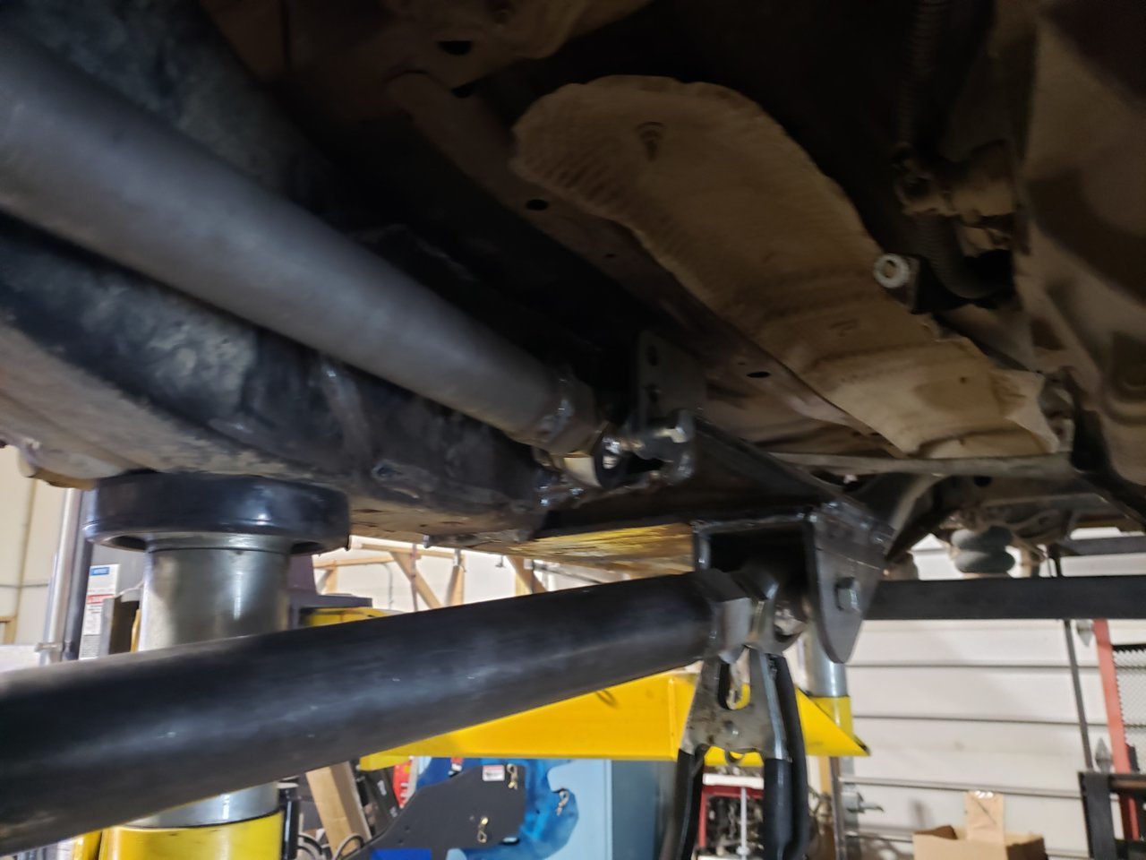

    Got my gearbox drilled and installed.
    Cut and tacked my links in
    Got the highsteer tacked up and steering wrapped up.
    All thats left is the panhard, and shocks.
    Finish welding everything up and move to the back.

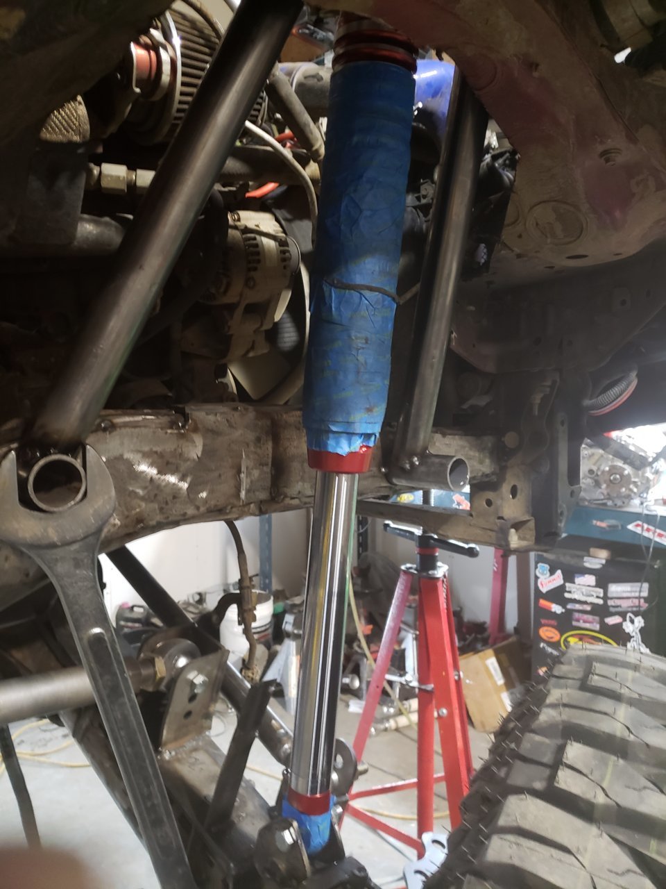

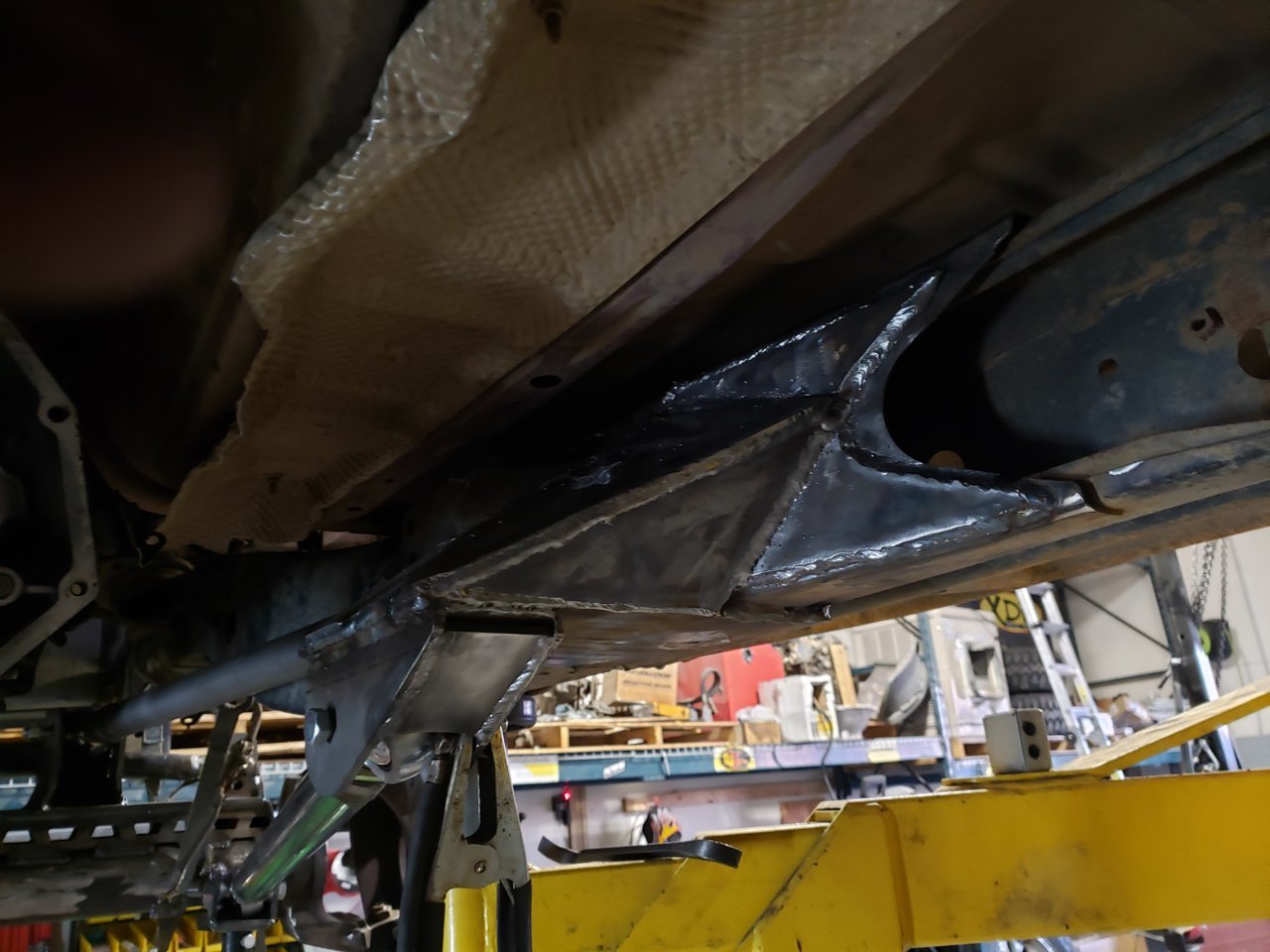

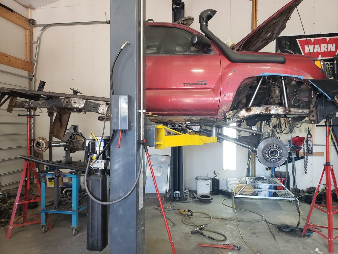

    Well finished up the passenger side inboard lower link mount. Lots of steel reinforcement
    All the dom is cut and welded.
    Steering gear is drilled and bushings installed
    The driver side lower link is 3/4 of the way done
    Next is struts and boom front is most of the way done, then on the way to the back end

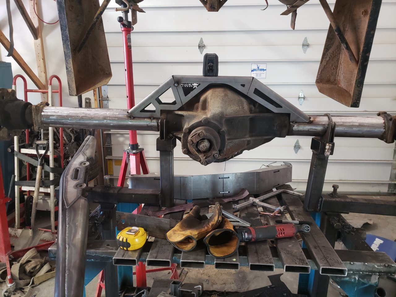

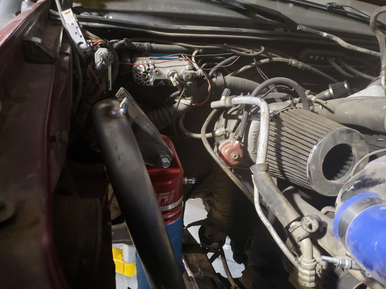

    Well let me summarize where i am at.

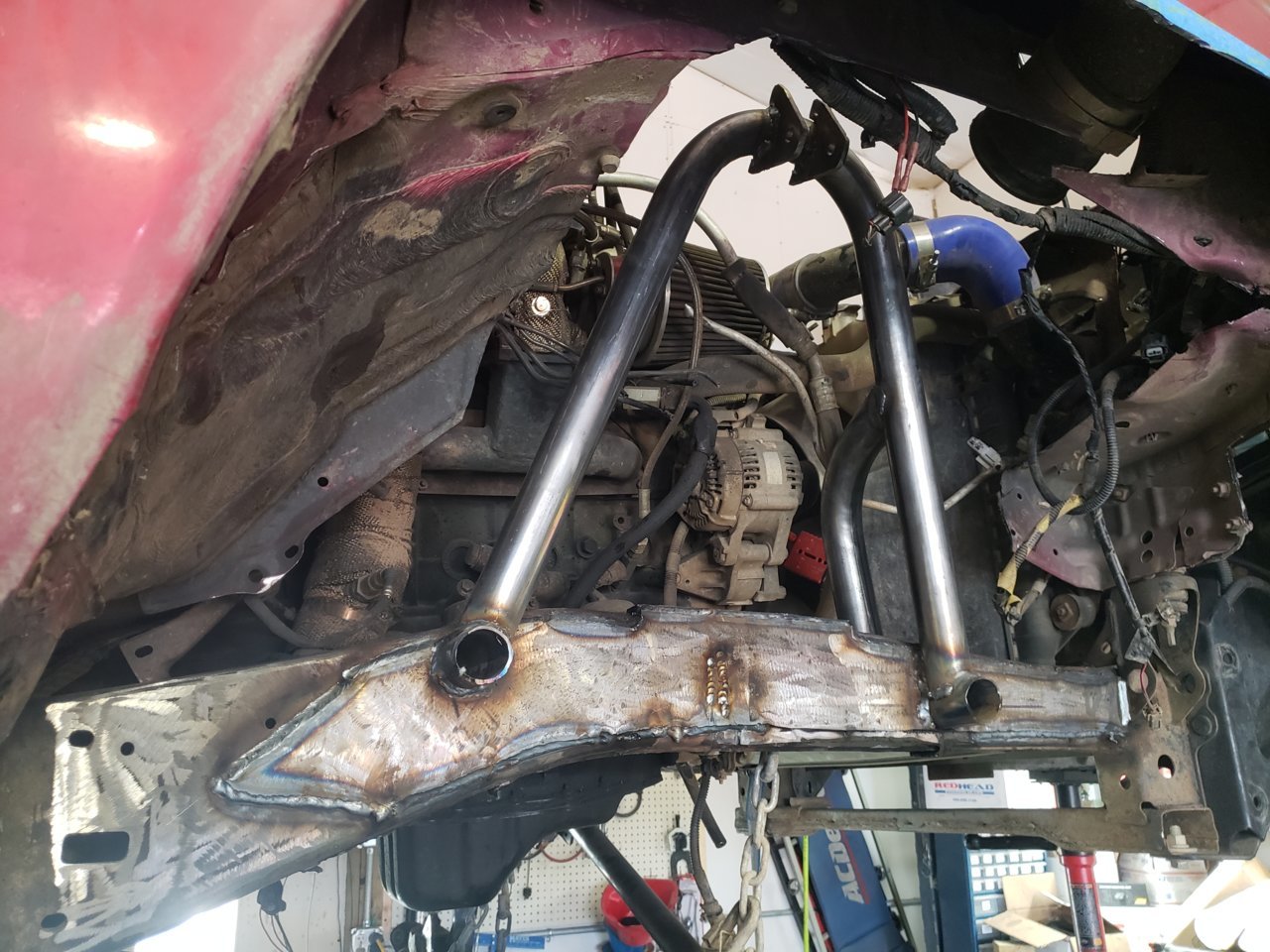

    The tcase is still out i need to rebuild it and then put it back in. Once thats complete then i need to build a crossmember for it.
    The front is almost complete
    I had to basically cut the inner fenders out. Bent the hoops and had to push them out pretty far to allow room to be able to get out the master cylinder. I need to figure out where to put the fuse box.
    Next is to Figure out the steering, this may be a little cumbersome.
    But this is where i am now.

    Ill take some pics this week but i got the fenders and everything trimmed from full stuff and droop. I have to redo the passenger side cause it rubs when the tire is turned passenger at full stuff. It rubs on the driver side but with how tall the hoops and struts are and how close they are to the master cylinder im out of options.
    Im great at very little things, cutting inner fenders isnt one of them.
    Looks like hellen keller took a sawzall to them.
    Im probably going to make newinner fenders that bolt on.
    Two problems well three left
    1. The driver side hoop is in the way to the point where i might have to extend my main harness to get the fuse box over and mounted( ill take a pic), or put it in the cab.
    2. Steering is dumb. With rack and pinion that bitch nearly goes straight down. I havent found a good solution yet. The guy on here with the eyelet bolt keeping steering shaft from acting like a jump rope is fucken mint though.
    3 and........ im trying to remember what the third one was..........

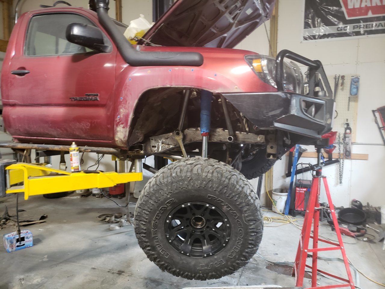

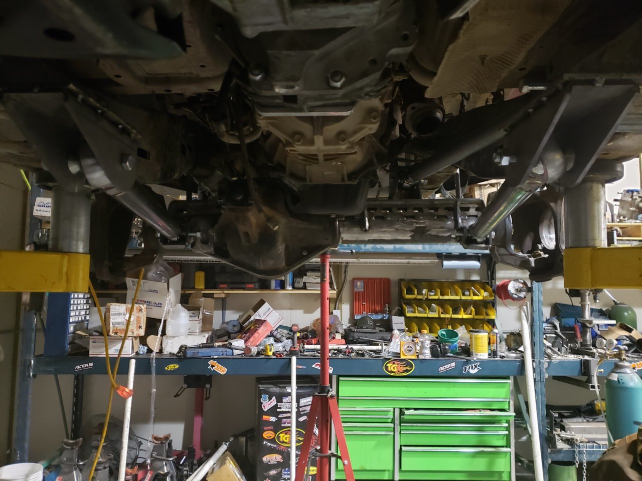

    Well got a lot of progress done.
    Still didnt hit my dealine
    Tcase crossmember done front is about finished
    Rear should be done this week

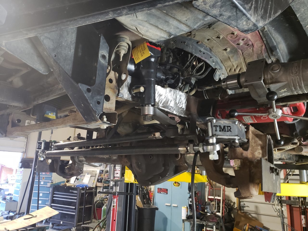

    Got one lower link in today

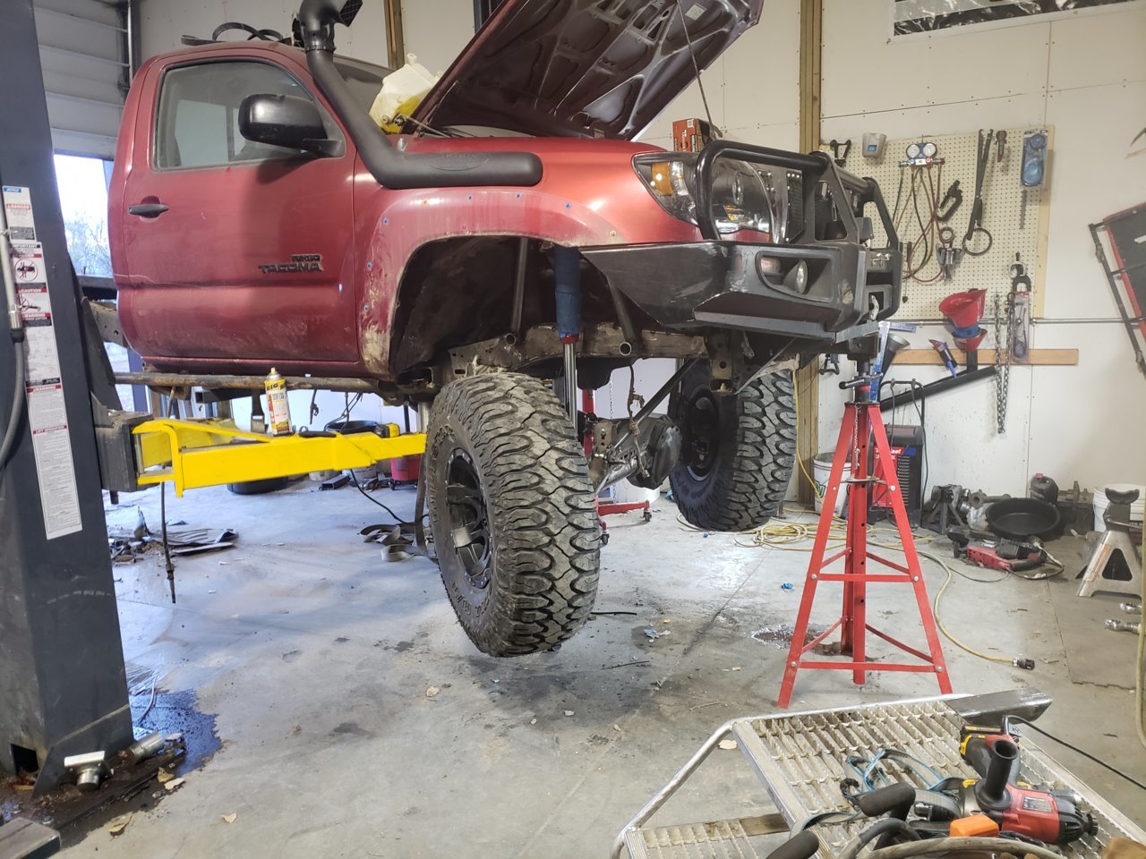

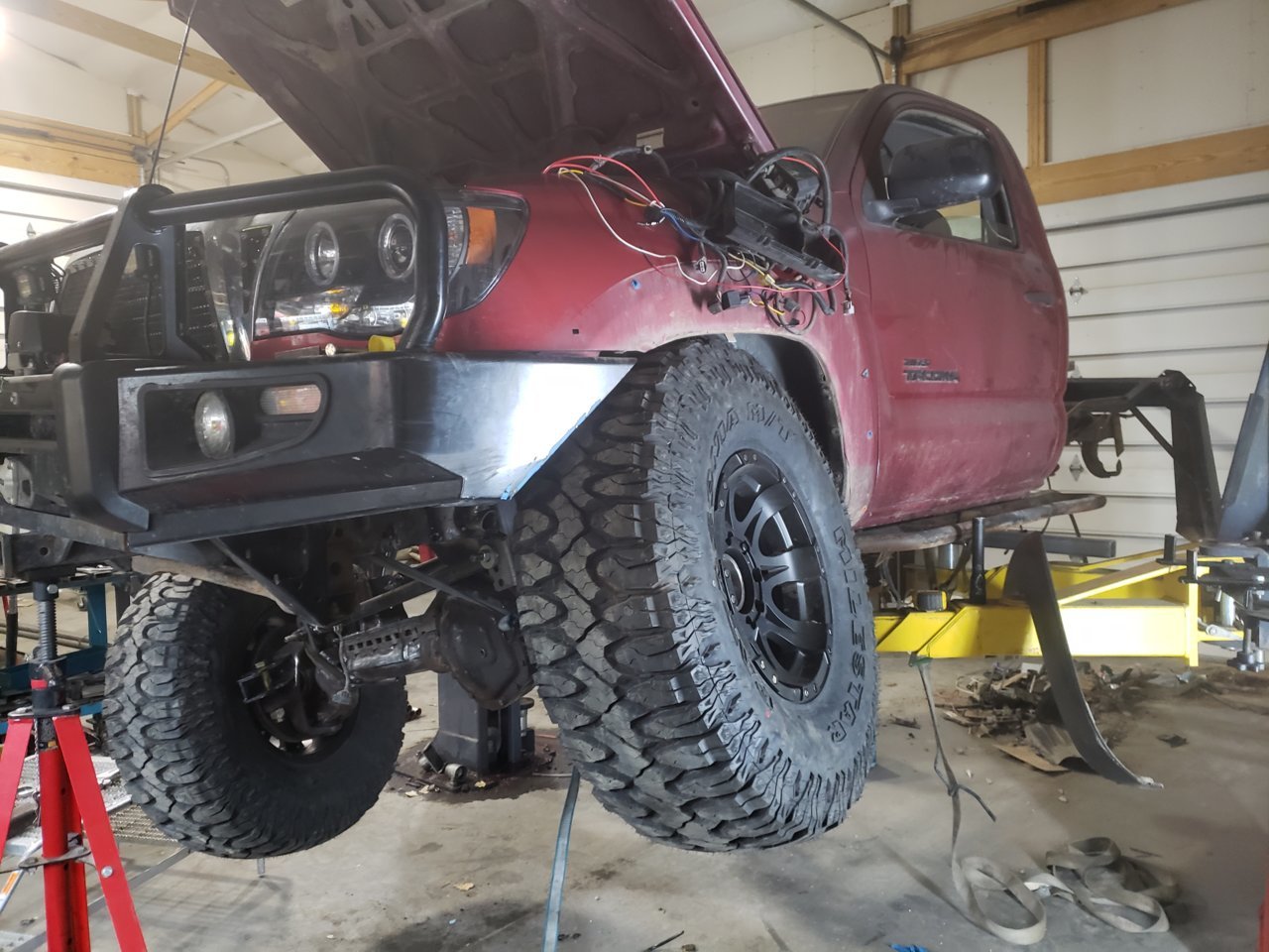

    Well this is what she looks like on 38s at ride height i just cant get the roll center axis down though.
