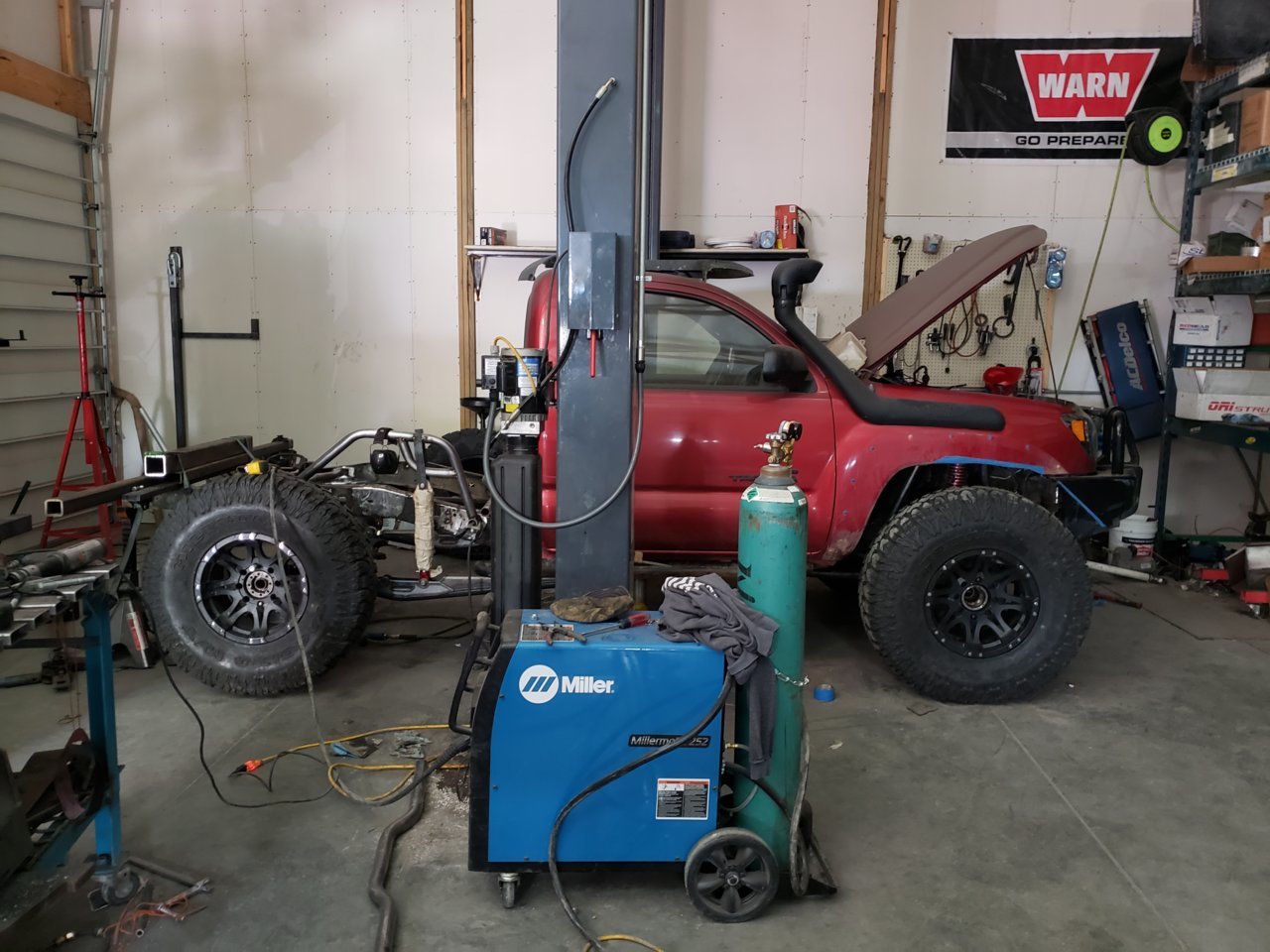

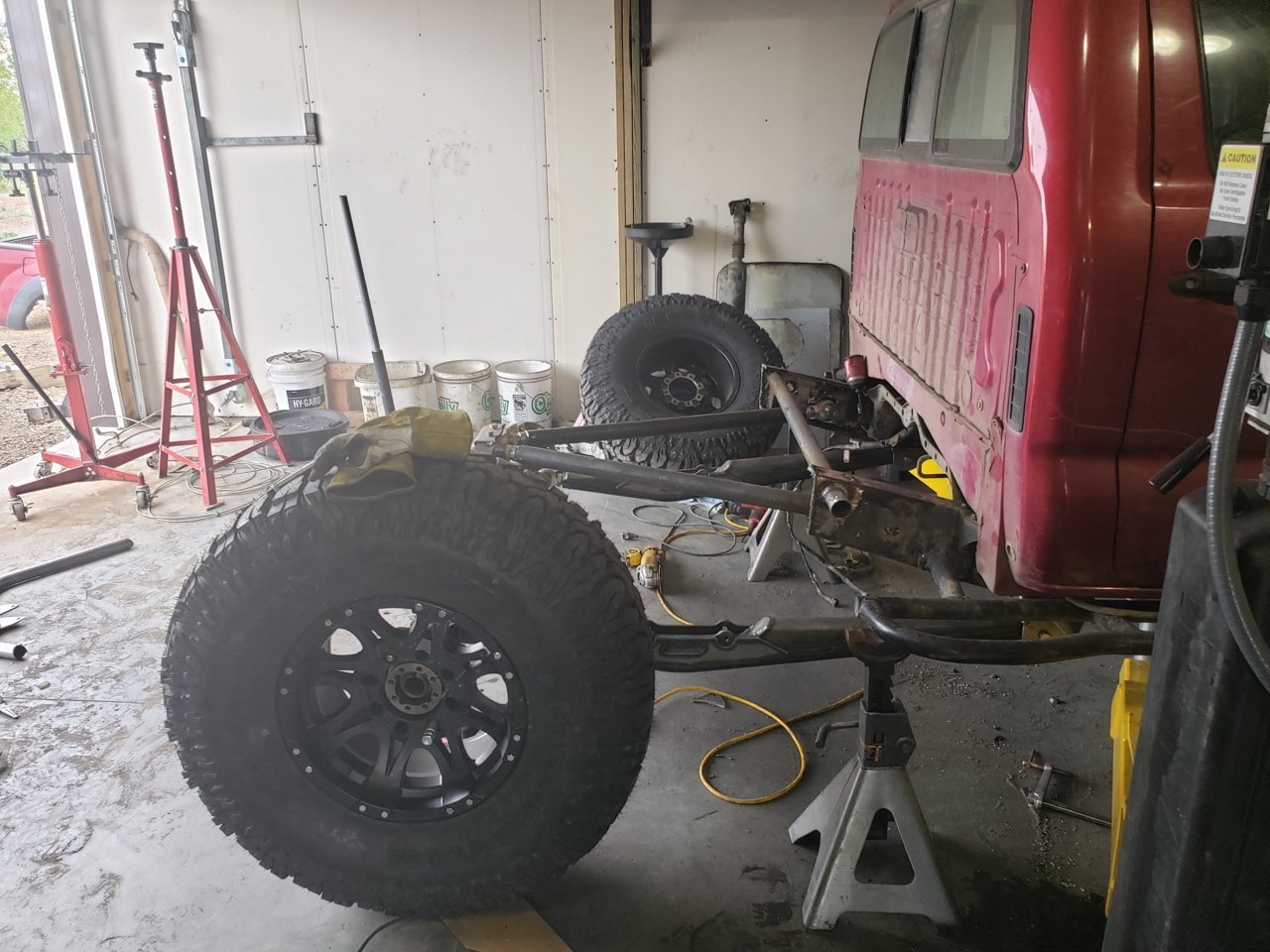

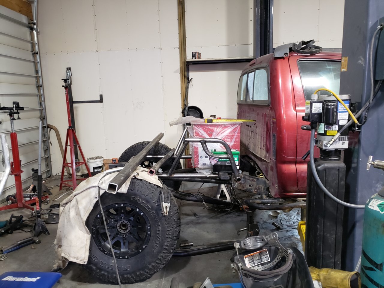

    Well got the rear tacked in and somewhat set
    Built the shock hoops and set the strut at full bump.
    I measured its around 22inches of travel in the rear.
    The pic is the truck at full bump front and rear

    Yeah its only a 10". Thats a lkng story but one reason i went with trailing arms was cause of that reason more wheel travel with shorter shock plus trailing arms are badass.
    I measure it once its done for an accurate measurement but at least 20 inches of wheel travel is enough for me

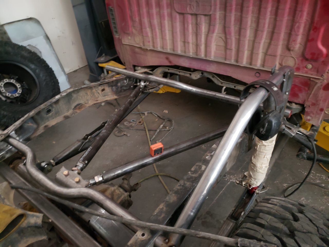

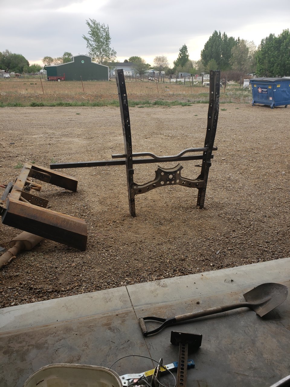

    Well got put on quarantine from work so i got 14 days of truck work.
    - got all the shock hoops and mounts all good to go, mounted the strut and started to flex it and got about 2/3 of down travel with passenger stuffed to check flex and bam strut hit frame(very slow no damage). Well long story short i got pissed, and this was the result
    Broke Okie Ty and malburg114 like this.
  13. May 14, 2021 at 11:10 PM
    #93
    Bloodytaco208
    Bloodytaco208 [OP] Well-Known Member
    Apr 6, 2019
    #289329
    439
    208
    Twisted steel sex appeal reg cab tacoma
    Bunch of built and bought mods
    So i have this for sale, no low ballers, i know what i have and its worth it-$2000

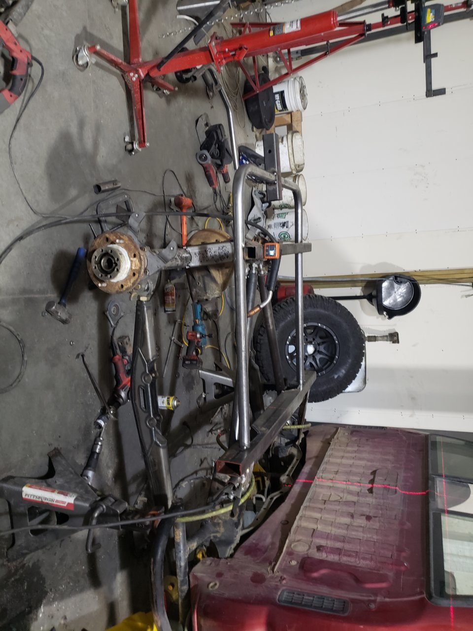

    Well got most of the rear welded. Seems like i have become a slave to my toyota. I can see the light though
    Tomorrows plan:
    Measure for rear and front driveline
    Get tank mounted
    Mount battery box
    Finish the welding the rear
    Strengthen the bed
    Weld the rest of the front up
  18. May 17, 2021 at 12:43 AM

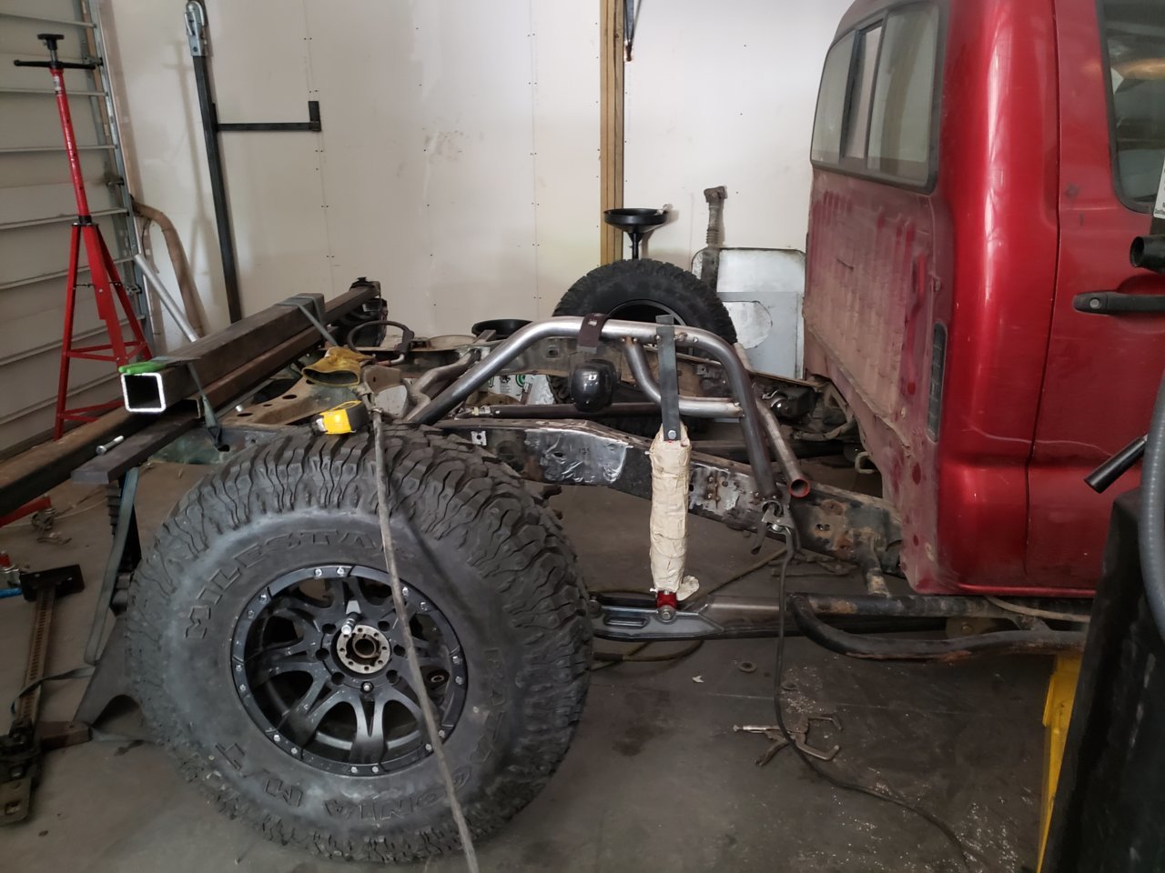

    So i measured it out on the rear, i have about 18 inches of travel which i was hoping for and what i calculated. Ill see how it does if i need to go bigger thats why i built the hoops the way they are so itll be easy to change if needed. I put a space for 14 inch bypasses for later.
