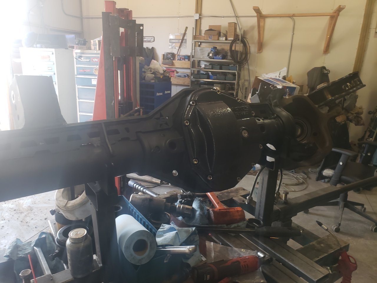

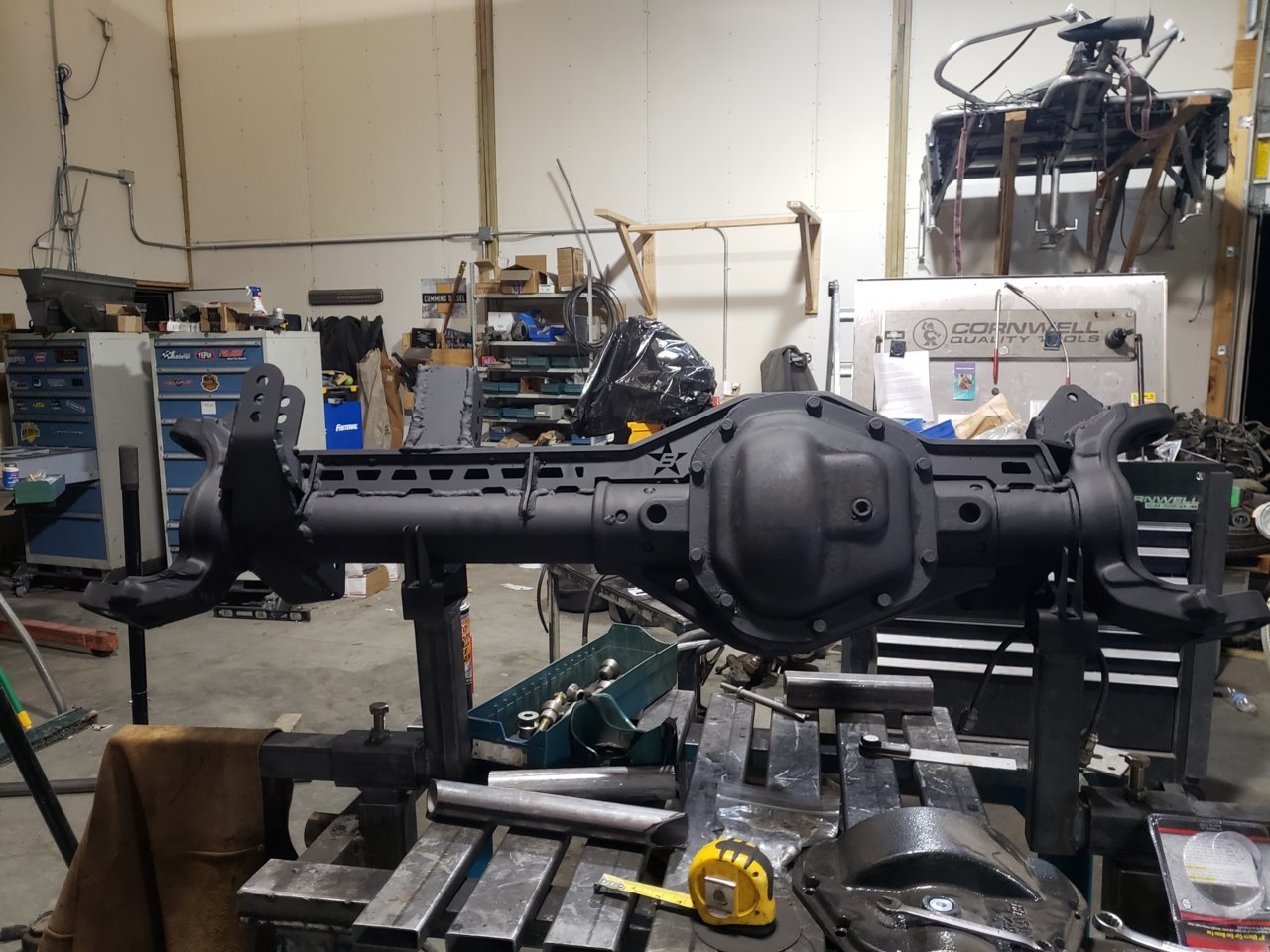

    Got the rear end cleaned up and rebuilt. Took a week and half off of work to push and get the yota done.

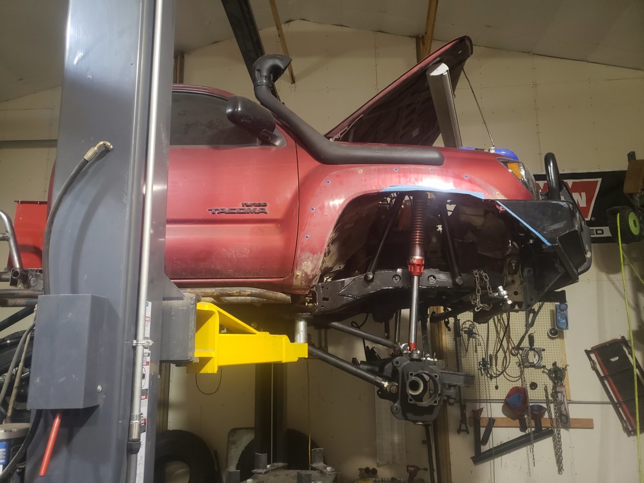

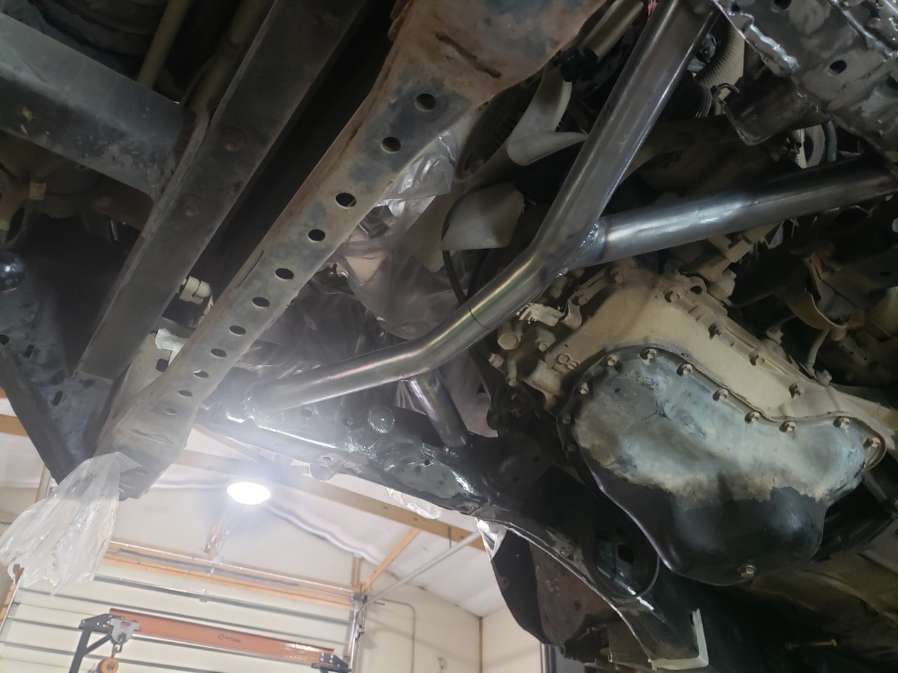

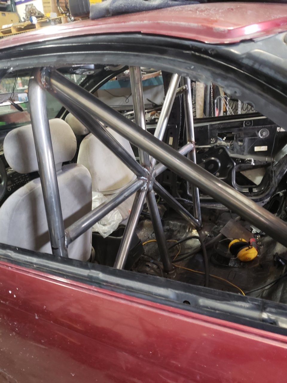

    Well got some shit done on the truck. Its hotter then satans taint here and trying to get my race car done.
    Got the front painted up
    Got the front crossmember installed and welded

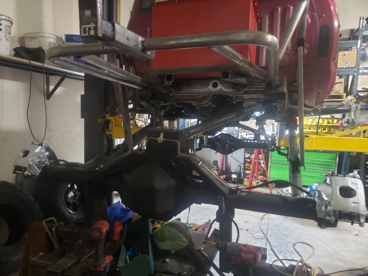

    Havent posted in a while due to not working on it very much. Its been stupid hot here and im lazy. Got the rear brakes wrapped up. I hate doing brake lines.

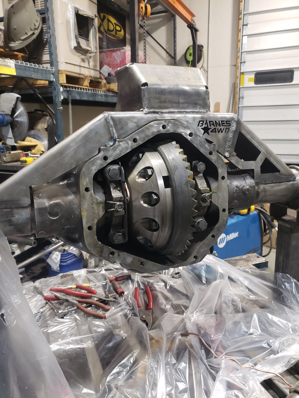

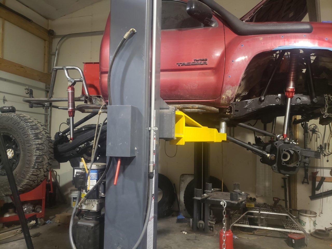

    Well got a bunch done. Last 10% takes for ever. Im.getting it ready for the alignment shop tomorrow. Got the new driveline in. I finally regeared and installed the locker in the front axle. Dana axles piss me off but theyre great so its a love hate relationship. This truck is going to be one bad bitch.

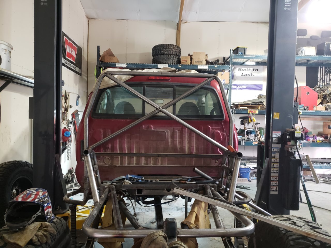

    Got the headache rack done

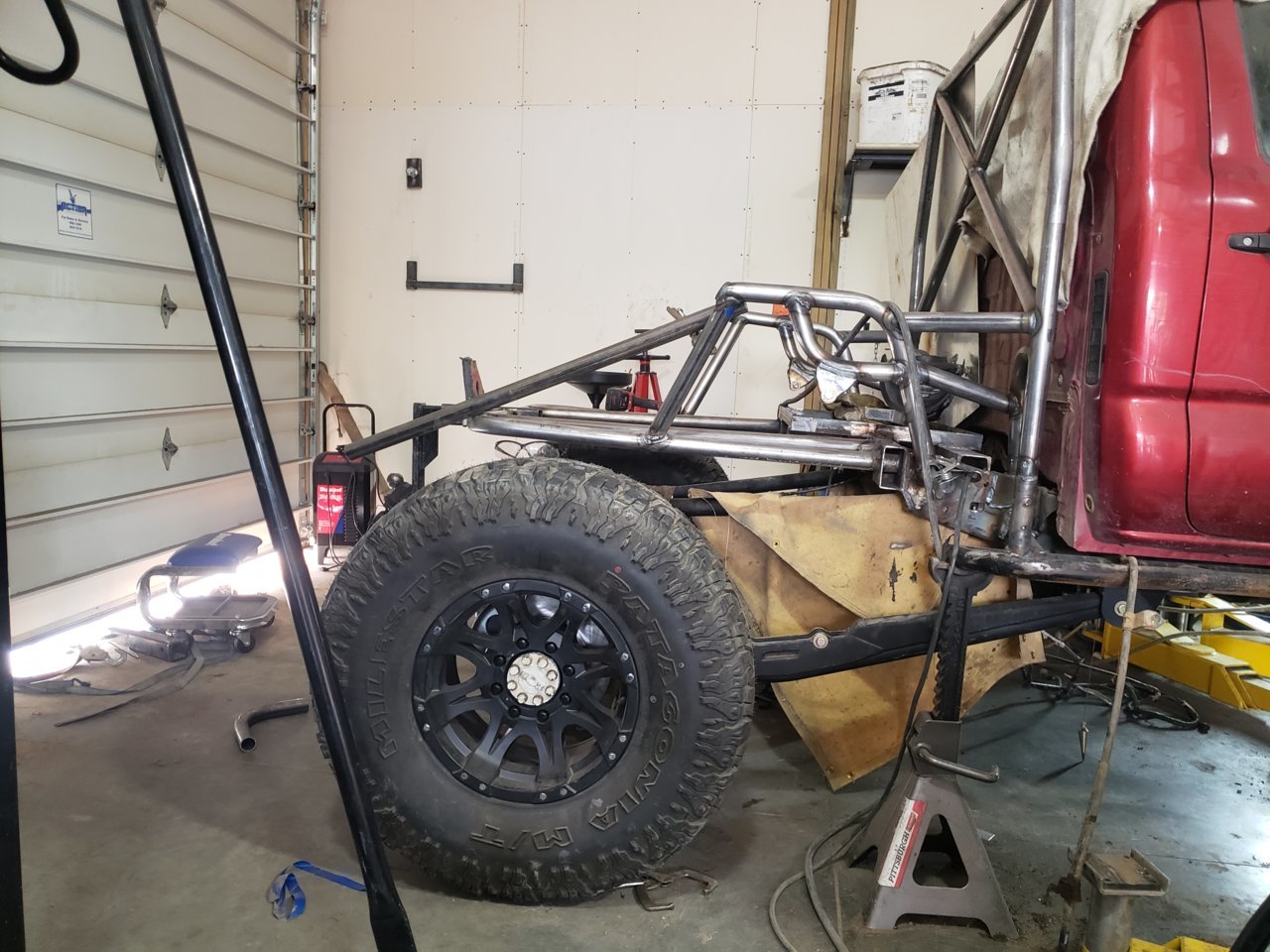

    I realized after building the cab bar, i hate my shock hoops in the rear. They're in the way and i dont like the bend. For the past few months i have been debating whether a internal or exo cage. Ive decided to go exo cage. To make a cage strong, the more tie in points to the frame the stronger itll be and the higher chance of survival in the case of a rollover. So the hoops must go due to their lack of stability and strength.
    Im doing a flatbed but im not doing a truggy. I hate how they look for one and two i need the ergonomics of a flatbed. This will be a jeep killer on the trails but i chase coyotes, shoot elk, and carry duck dogs so i need the bed space. At this time i have to leave them just to get the damn truck off my lift. But hopefully in a month or so ill be cutting them off and redoing it.

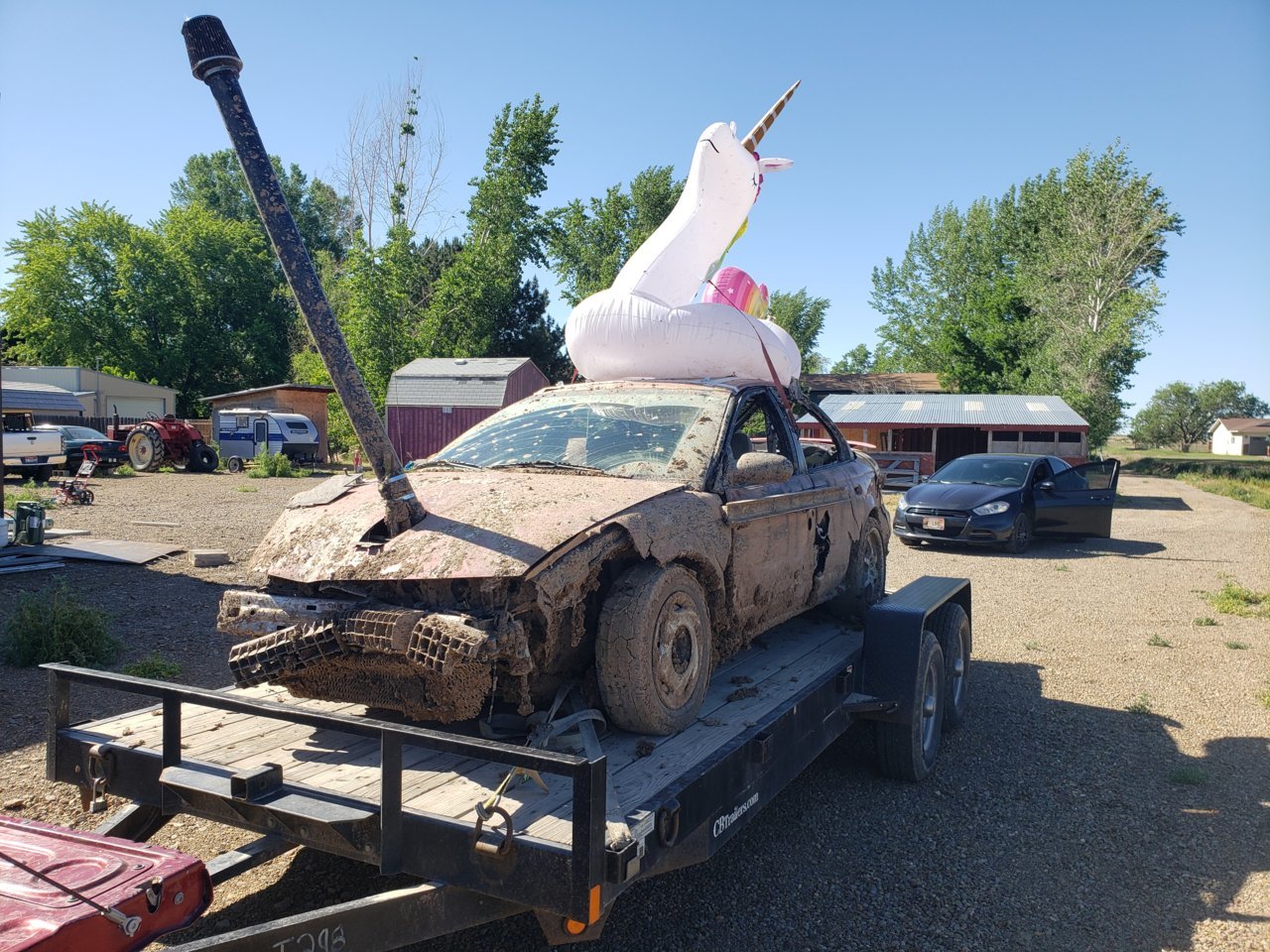

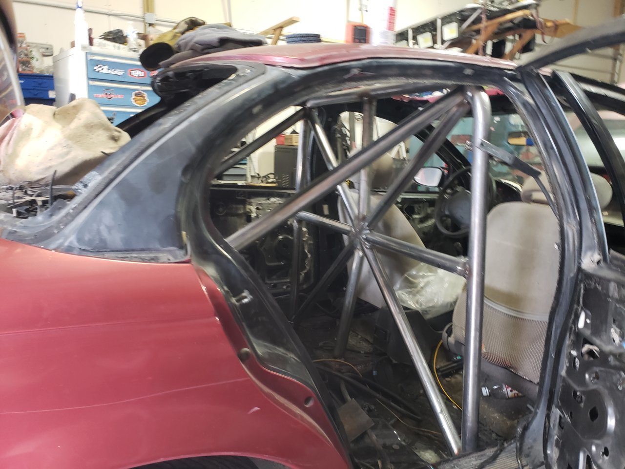

    Video or more pics of whatever the fuck you did to that poor car?
    Sharpish likes this.
  16. Sep 8, 2021 at 5:59 PM
    #116
    Bloodytaco208
    Bloodytaco208 [OP] Well-Known Member
    Apr 6, 2019
    #289329
    439
    208
    Twisted steel sex appeal reg cab tacoma
    Bunch of built and bought mods
    Thats whats left of the car

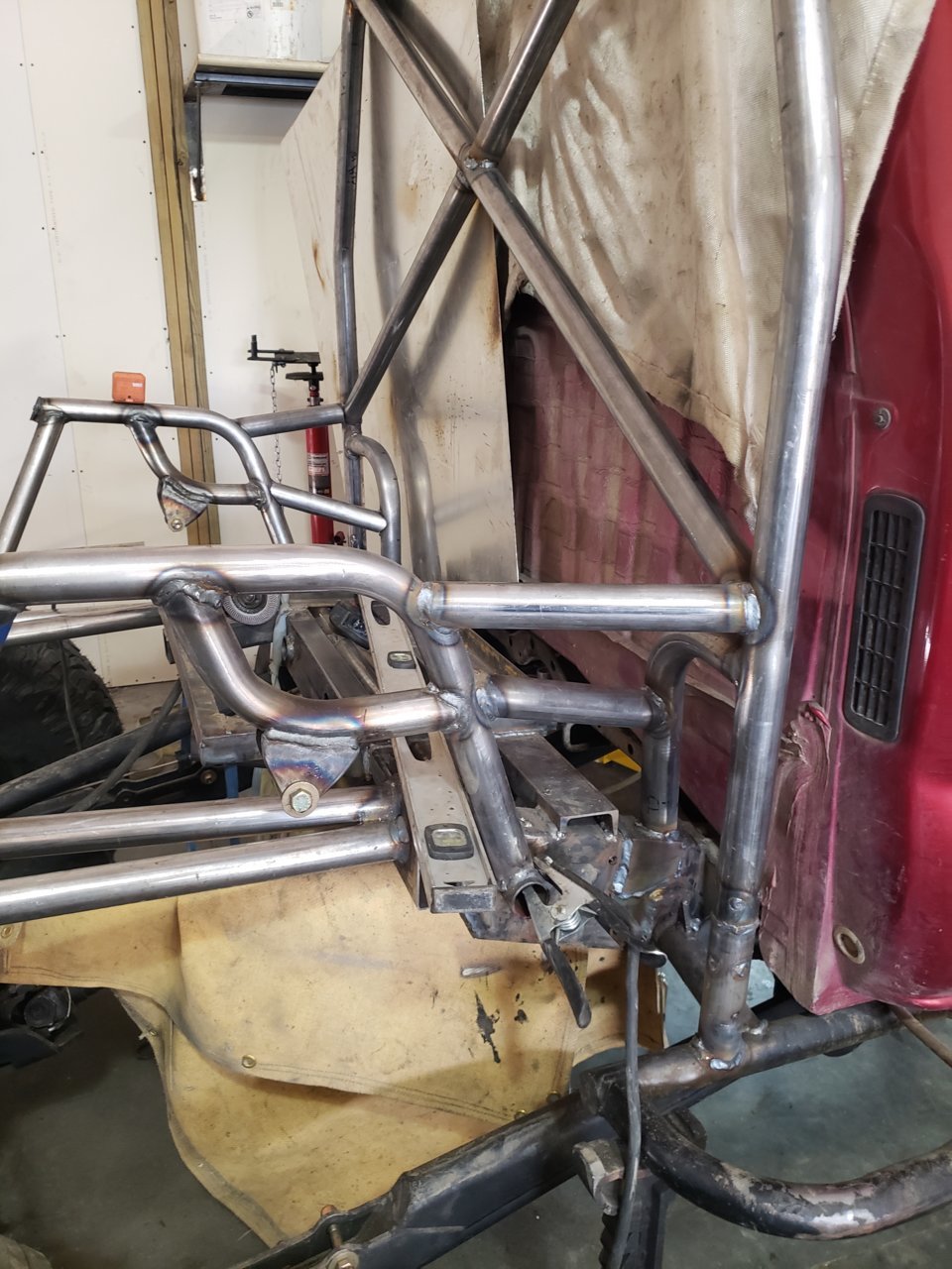

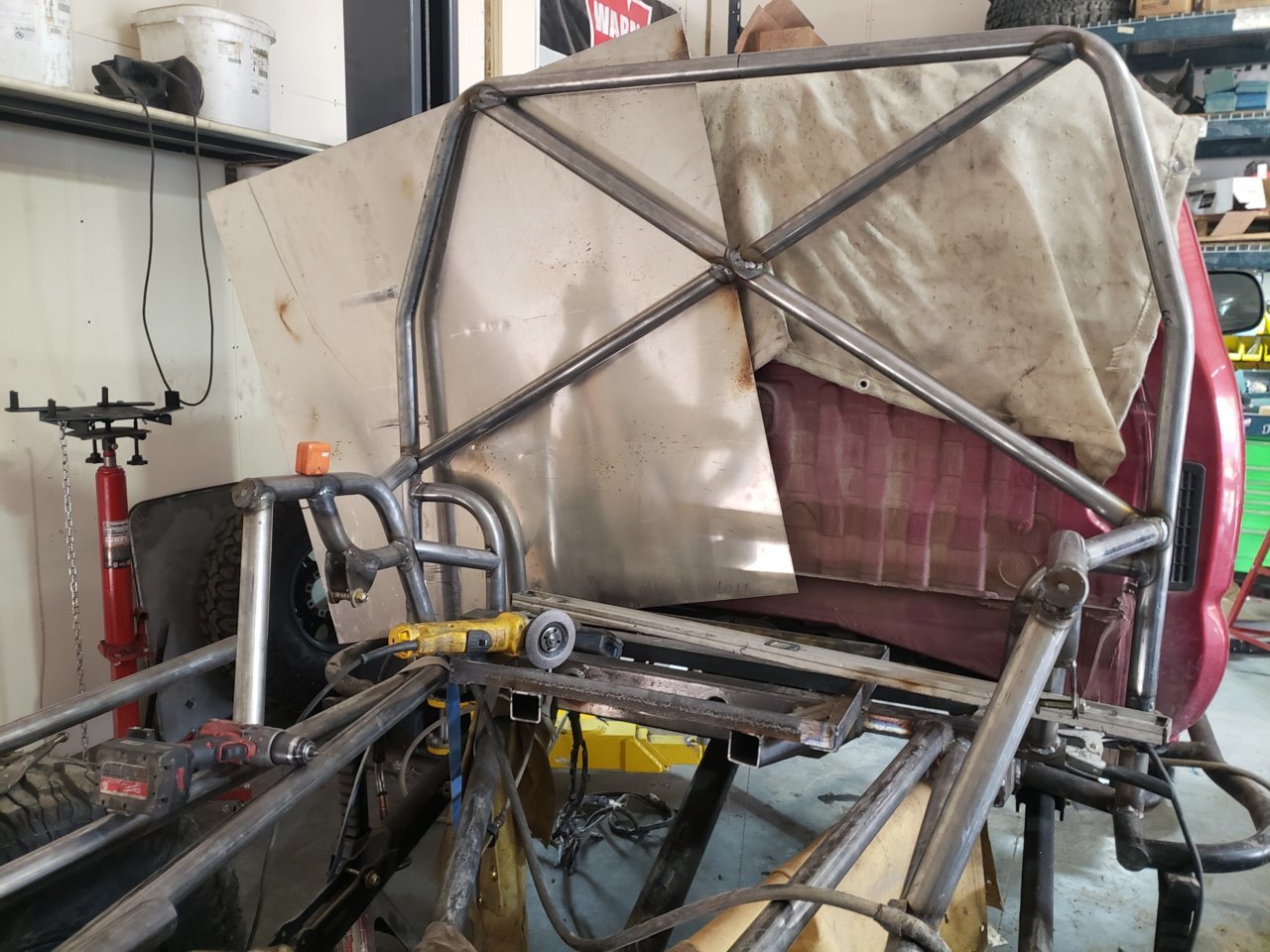

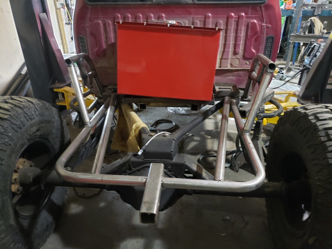

    Yeah thats what i have been doing. I wanted to get the back of the truck somewhat welded up to get the fuel tank, battery, air tank, and compressor mounted. I dont have much left to do heres the list
    Build and route front brake lines
    Finish running fuel lines
    Run locker air lines
    Drill rotors
    Fix tie rod
    Mount fuel regulator
    Tied the hoop into the chassis

    1999RegCab
    1999RegCab Well-Known Member
    Apr 4, 2014
    #127007
    1,522
    Cacti Land, AZ
    1999 Reg Cab, 2.7, 5 speed
    3-link SAS
    Good tube work!
    Big project you got going there. And of course I am biased towards reg cabs. That rig is bad ass!
    And I just noticed you are using trailing arms. Missed that in earlier pics. Trailing arms are beef!!

    The trailing arms are from ruff stuff and they're harder then the back of my head. Worth every penny.
