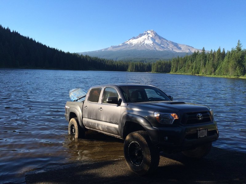

    I have a 2014 Tacoma TRD Sport 4.0L V6 manual, and I'm getting ready to do my first oil change since my toyota care ended. I plan on changing my oil every 5k Miles just to stay on the safe side and so I can feel a bit more confident when I find myself in the higher RPM's.IMG_0387.jpg I've noticed a lot of you prefer Mobil 1 syn for your oil, but haven't heard much in the way of oil filters? I've always used fram and that's probly what I'll stick with but any feedback would be appreciated.

    Thomas Jefferson Keyboard Warrior

    #107851
    1,291

    This right here... but you may as well run 0W-30 mobile 1 full syn.... better start up protection and gets to operating thickness quicker.
    Stay away from the dealer oil changes....
    Also.... you need to do the diff breather mod if you are having fun in water like that.... hell at this point you should look into replacing your rear diff fluid.

    Is that Mt. Hood?

    yeah and also get used to dropping the rear wheels and inspecting for leaks
    dipping the rear in water looks cool and all but that requires extra maintenance on everything between the
    lugnuts on the rear end

    There's a similar thread that shows locating it behind the rear taillight. I followed that one and never looked back. No drilling, it doesn't get in the way when filling up with gas, and it's completely protected from water.
