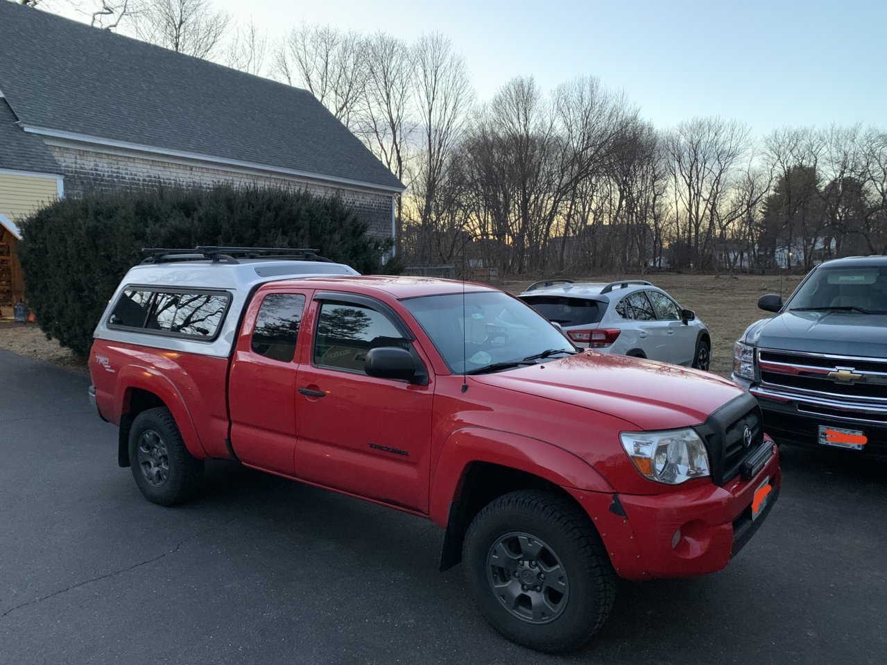

    ive got an 06 2nd gen offroad with 3rd gen sport front coilovers and stock rear susp right now. Looking to beef up the rear suspension a little but not over do it. Ive got a cap on it that will be on and off, but going cross country in june with lots of gear.
    My thought is doing a headstrong 3 leaf pregressive aal in the rear with the extended bilstein 5100.
    I may eventually do the front coilovers but dont mind a little rake. would that be absurd to have the progressive aal with the stock 3rd gen sport shocks up front?
    Any better options? I want it to last, so ive looked at new leaf packs but theyre pricey.
    I would be adding the aal to a take off tsb leaf pack that i have laying around, not my current leafs.
    Thanks!

    That sounds like it will work. Are you almost level now, with the 3rd gen fronts?
    The 3-leaf AAL will give you some rake, and when you load up it will prevent you from squatting.
    But how much is lots of gear? You might want to consider a new load bearing leaf pack, or possibly airbags if you are heavy loading the bed regularly.

    usually not super heavy in the bed. i do electrical but usually just toss tools in cab. the current susp is fine for what i do 80% of the time but would be nice to beef up just a little. lots of gear is for a month long road trip. will have backpacking gear, kitchen equipment, surfboards, wetsuits, and other stuff. should be pretty full. have a thule up top for tarps and folding chairs and other stuff we wont use often. I do haul heavy trailers occasionally and work the truck pretty hard, but ive lived with the stock tsb pack (only bottoming out a couple times:anonymous:) so i dont think i need dakars. not running armor/skids and i dont want a rough ride.
    edit: and yes i am pretty much level, with and without cap. doesnt make a big difference. havent measured it but it visually looks nice and level. hate when the trucks are nose high, but rake doesnt bother me as much.
