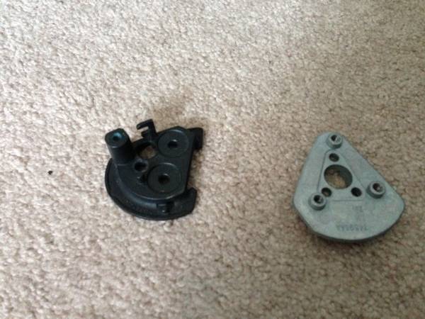

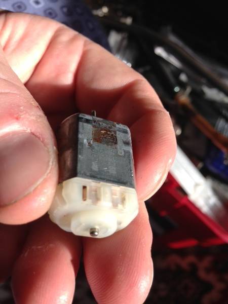

    Is anyone working on the power folding sienna limited mirrors? So far what I've found is the 2011+ mirrors are almost identical to the 2012+ Tacoma mirrors dimensionally. The limited came with the power folding mirror option, so the power connector is different. Also, the mounting base bracket is different, but I think this could be modified to bolt up - I have a side by side of the Tacoma/highlander bracket (left) next to the sienna bracket (right). After finding the motor wasn't working in the ebay mirror I bought, I stripped it down to see what kind of motor they are using - This looks durable enough for outdoor use, right?
