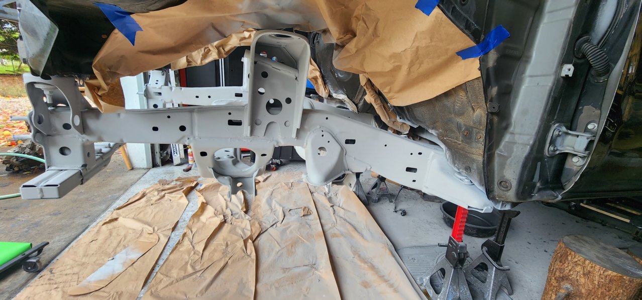

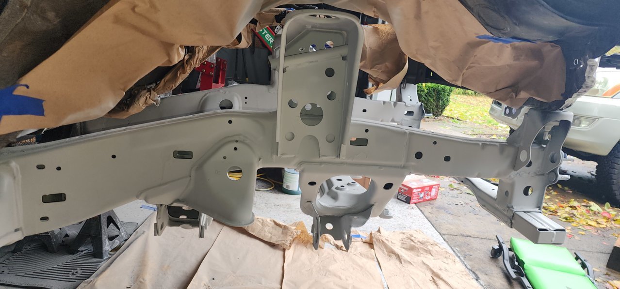

    More wire wheeling, I sprayed a phosphoric acid product called ospho to convert rust into iron phosphate and turns it black. This weekend I will spray it with a 2 part epoxy primer from Spray Maxx. 20221103_122034.jpg 20221103_122355.jpg

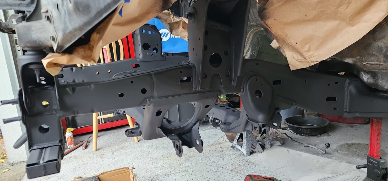

    Spray Max 3680033 2 part epoxy primer in a can works great. I made sure to degrease very well. I used 3M undercoating and eastwood's interal frame coating kit. I will post pics of that tomorrow.20221105_151051.jpg 20221105_151122.jpg 20221105_151141.jpg

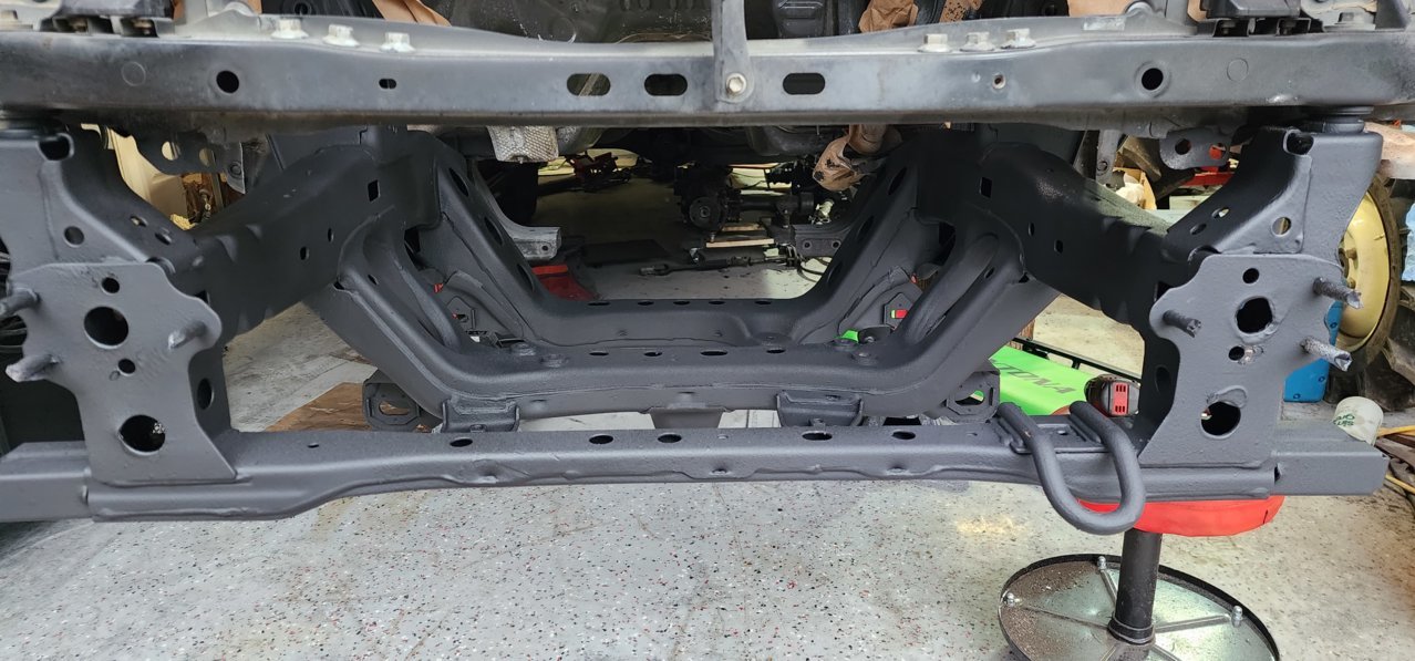

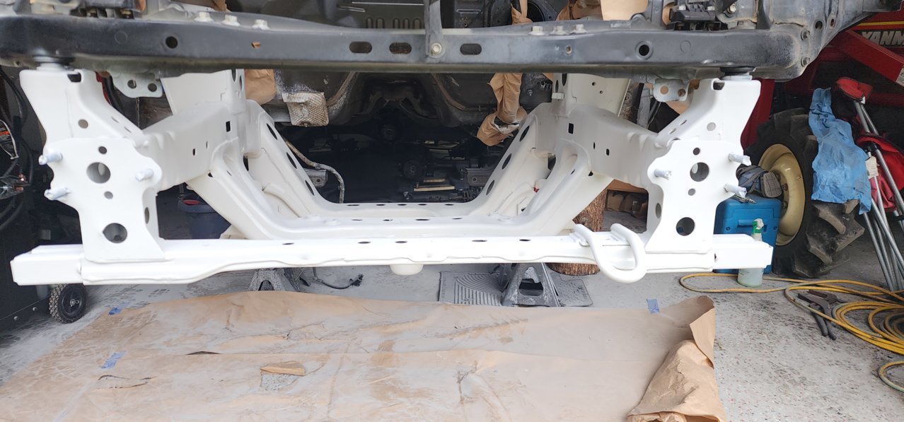

    Heres what the 3m undercoating turned out like, not perfect but good enough. Also I was really impressed with Eastwood's internal frame coating kit.20221106_083427.jpg 20221106_083334.jpg 20221106_083322.jpg

  14. Nov 6, 2022 at 3:25 PM
    #194
    skeletron
    skeletron Disgraced Member
    Dec 2, 2020
    #348476
    2,180
    Clark
    Sakerlina
    2020 TRD Broh
    Specifically what about the Eastwood kit did you like?
  15. Nov 6, 2022 at 3:57 PM
    #195
    dpanibratets
    dpanibratets [OP] Well-Known Member
    Sep 18, 2013
    #112778
    565
    Denis
    Vancouver, WA
    2005 DCSB soon to be with V8 1UR-FE
    The paint is not very viscous and the plastic straw with the nozzle on the end shoots in every direction. It got the job done.
