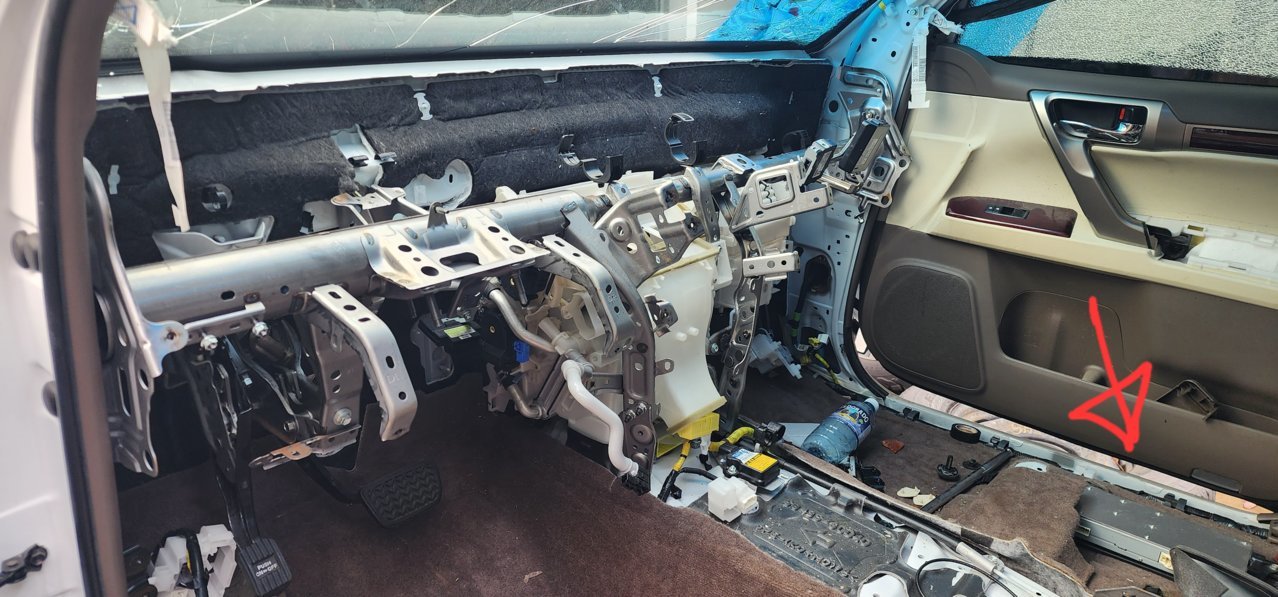

    I got all the wiring off of the dash. Also I discovered that all of the speaker wires run to this amp that is under the passenger seat. I ordered a 5 channel amp which I will mount under the passenger seat in the tacoma. This will be ever convenient to wire all the door speakers and one 12 inch sub. I will just have to find a positive power wire that powered the LCD screen on the lexus to power the stereo.

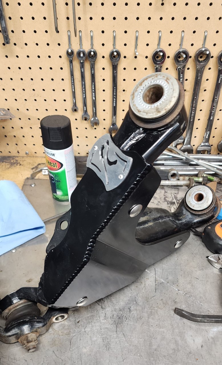

    I am pretty impressed with the quality of these raptor series lower skids although they didn't come with any hardware. The skids bolt on through existing holes with the exception of one hole that needs to be drilled out to a 3/8" size. Also I decided to use the GX lowers, they do have bigger camber bolts so I don't recommend doing this unless you are going to change/upgrade your alignment tabs. I am using my gx arms because the bushings/ball joints are in good shape. These skids have a tab for mounting the secondary shock on them. I will also fabricate the other side that is welded on to the arm. I am still waiting on the firewall insulator part for about 2 months now. Toyota said it should be shipping soon. In the meantime I decided to work on putting together the front suspension. I will update you guys tomorrow.

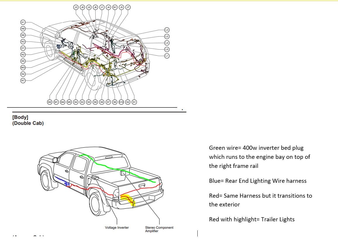

    Also I have been thinking that the pink and yellow harness will need to go through the bottom of the cab after the rear doors because they wire up the rear doors. On the GX it appears these two harnesses run on the inside of the cab. The gx is wired for door step lights which is cool, I will definitely wire those up. There is a fuel pump ECU adjacent to the fuel tank, that will be critical to wire up.

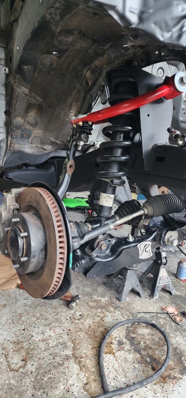

    Looking a bit more civilized now that the front suspension is on, those are JBA tacoma arms but everything else is Lexus. The lexus shocks are just temporary, I need to repark the truck.
