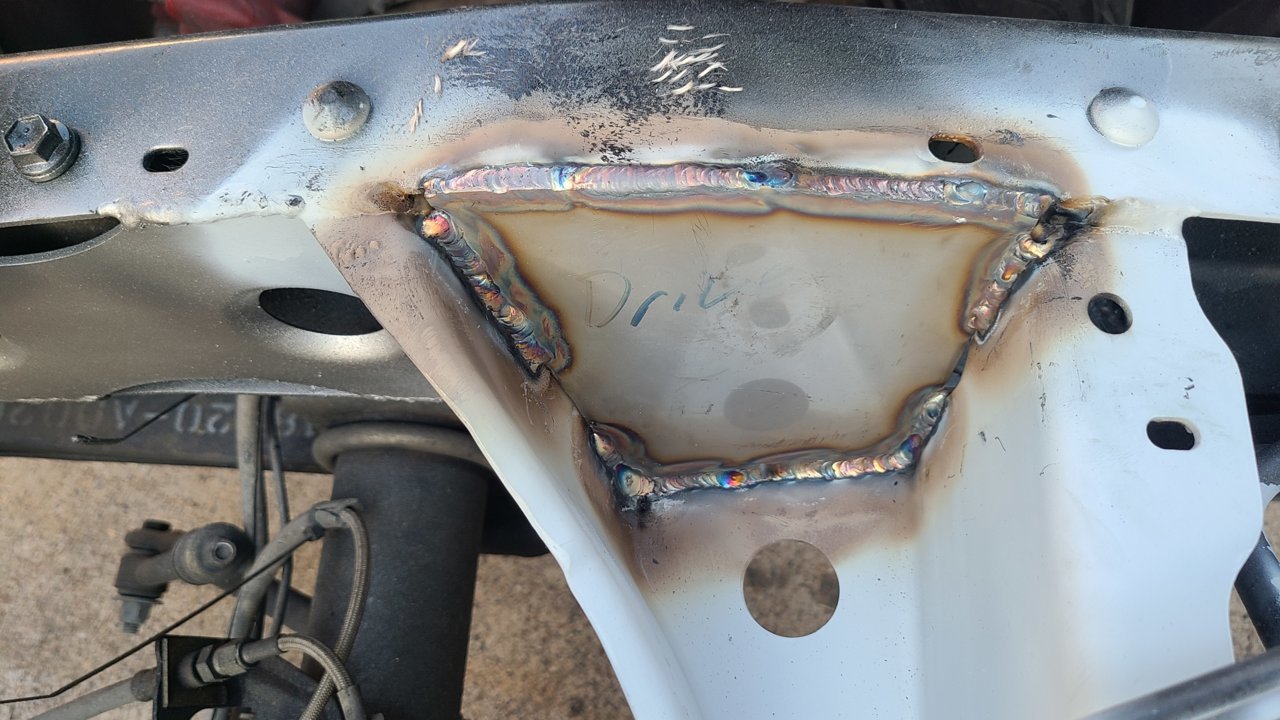

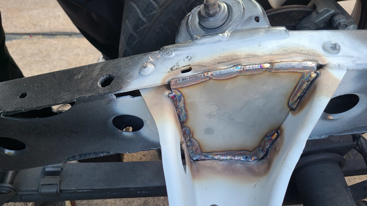

    I test fit the steering column bracket today and welded it in once I was sure that it cleared everything.

    Damn. I can't even tell where the new welds are versus the OEM.

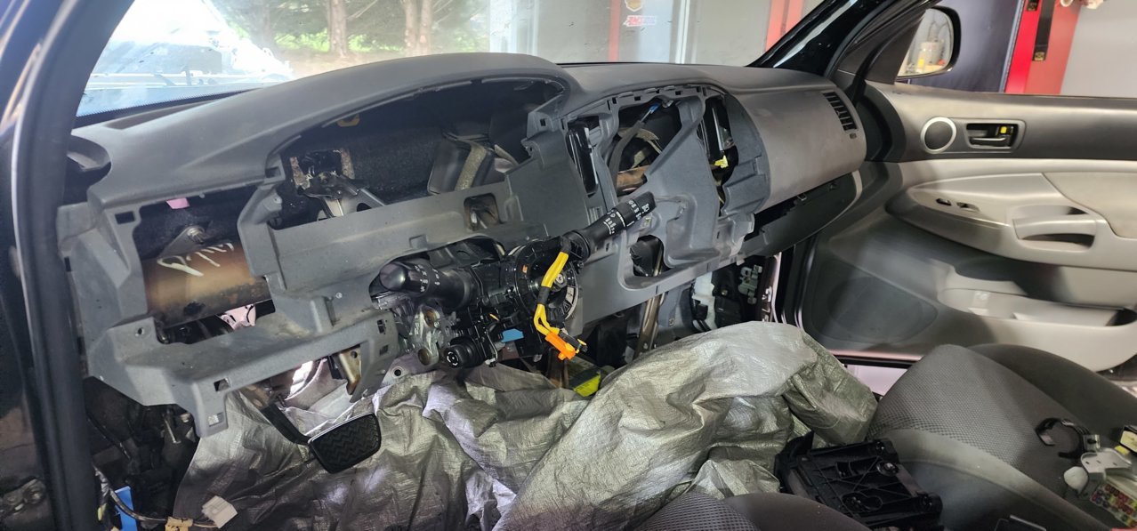

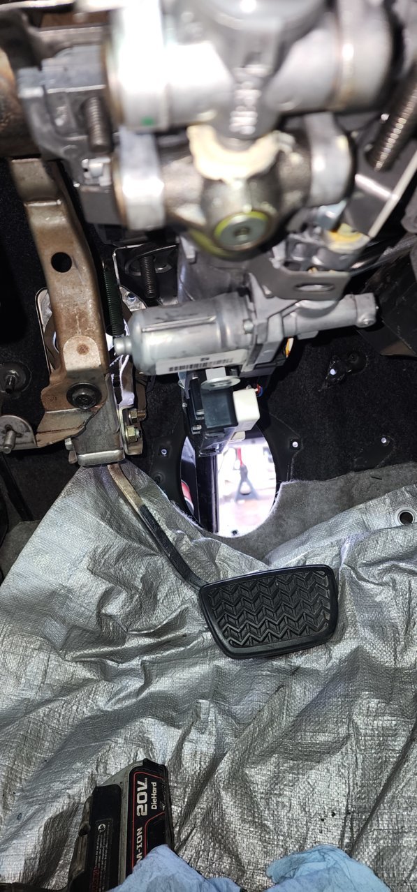

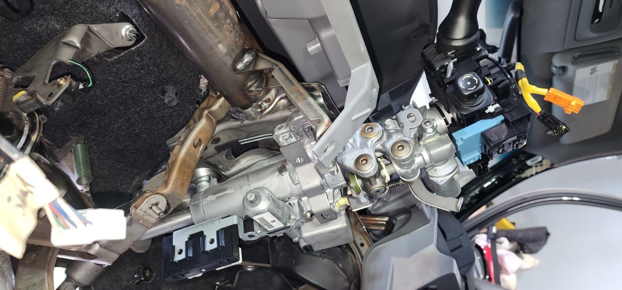

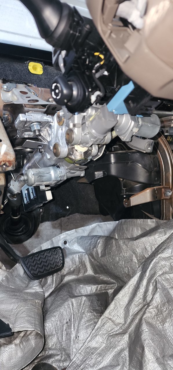

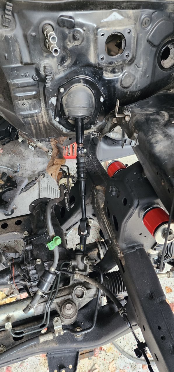

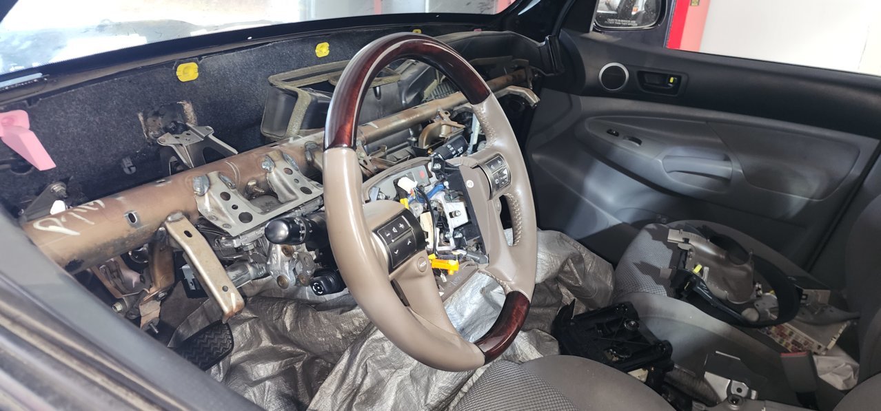

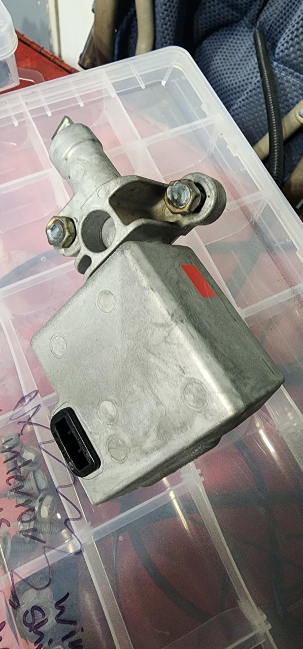

    I took the steering wheel lock off today. They are pretty clever at the factory, they use torque off heads on the bolts that hold the lock to the steering column. Luckily the column/lock housing is made of aluminum so I was able to weld on some 13mm nuts on to the torque off bolts with worrying about welding to the housing. They came right out and so did the lock. I need to steer the truck to wheel it out and take off the bed. Also I had to drill a new bolt pattern to use the lexus steering column boot. The diameter of the shafts is different, no big deal. The column is fully bolted in and the truck steers now. I put in the beige steering wheel for now because I don't want to accidentally damage my black leather with no wood grain (which is pretty hard to find). 20221208_131922.jpg 20221208_131916.jpg 20221208_131804.jpg 20221208_131847.jpg 20221208_131753.jpg

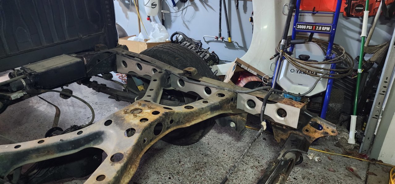

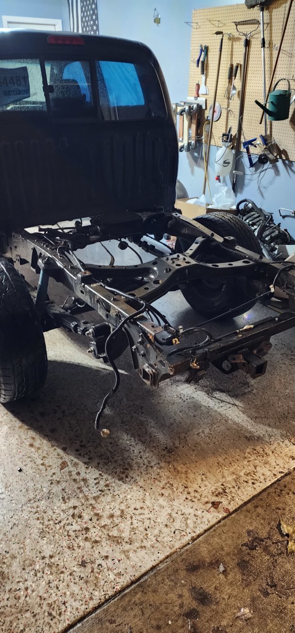

    Truck is reparked and ready for rear section restoring/reinforcement.

    DMZ Fabrication box in kit rocks!

    Due to my brake lines, on the driver side, there were some modifications requires for those plates. A few others needed slight notching or cutting. Nothing major. Otherwise, a great add in.

    As the cross member, I also added in some cardboard CAD plates. Since that section was left out. These might be a worthy addition for you two @nudavinci64 and @dpanibratets

    I think you could probably weld in the plates without removing the bed but I am trying to restore the frame and prevent future rust. I am going to give it a good wire wheeling before any fabrication occurs.
