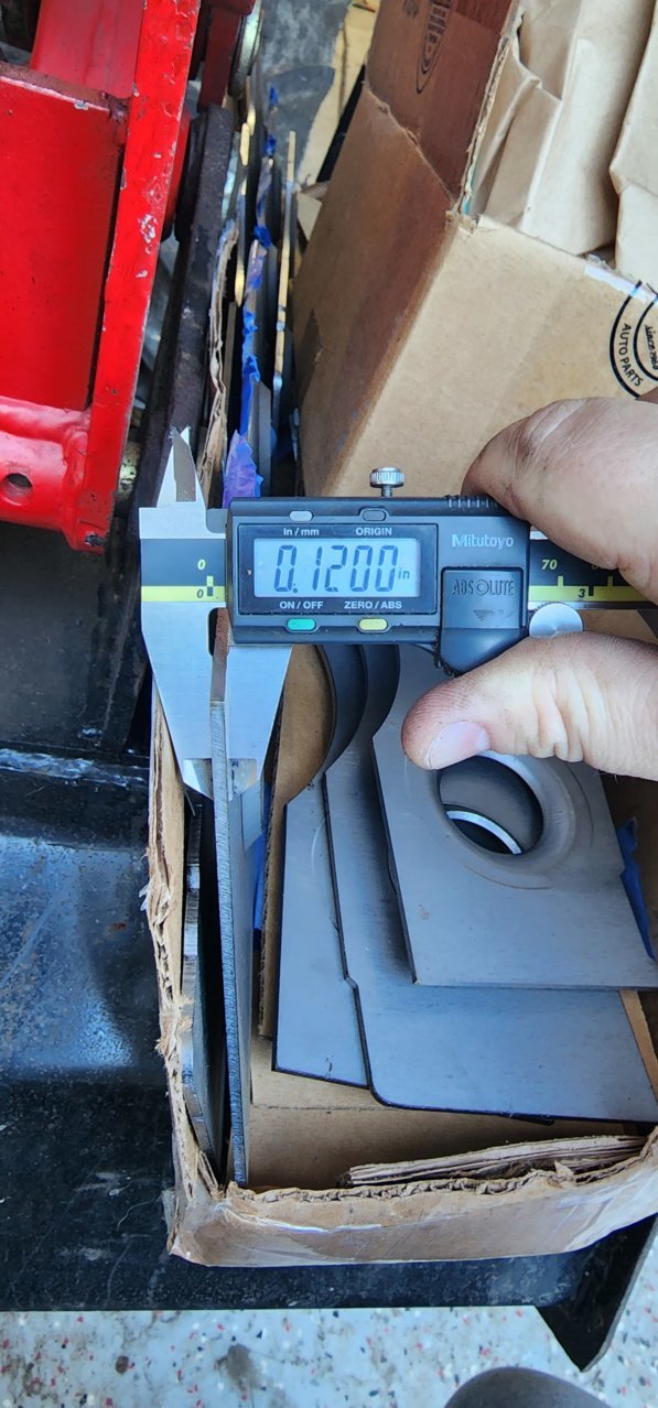

    .120” thick?

    I didn't measure but it looked like 1/8 thick

    Thanks dude I got some 1/8” laying around so things will get boxed eventually. Cheers!

    I think it was between 11 gauge and 1/8". 11 gauge keeps coming to mind for some reason.

    My machinist fingers didn't pick up an .005 difference on this one.

    Lol!!! I think I used a gauge to test its thickness before setting up my welder. Foggy though due to the severe dehydration I dealt with at the time.

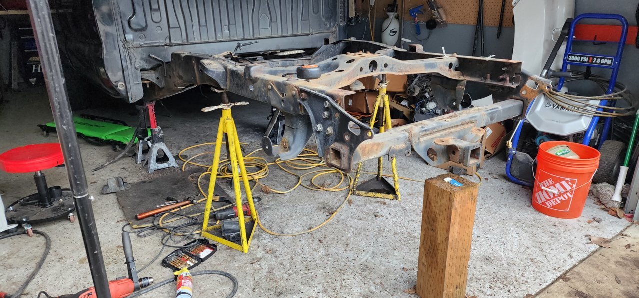

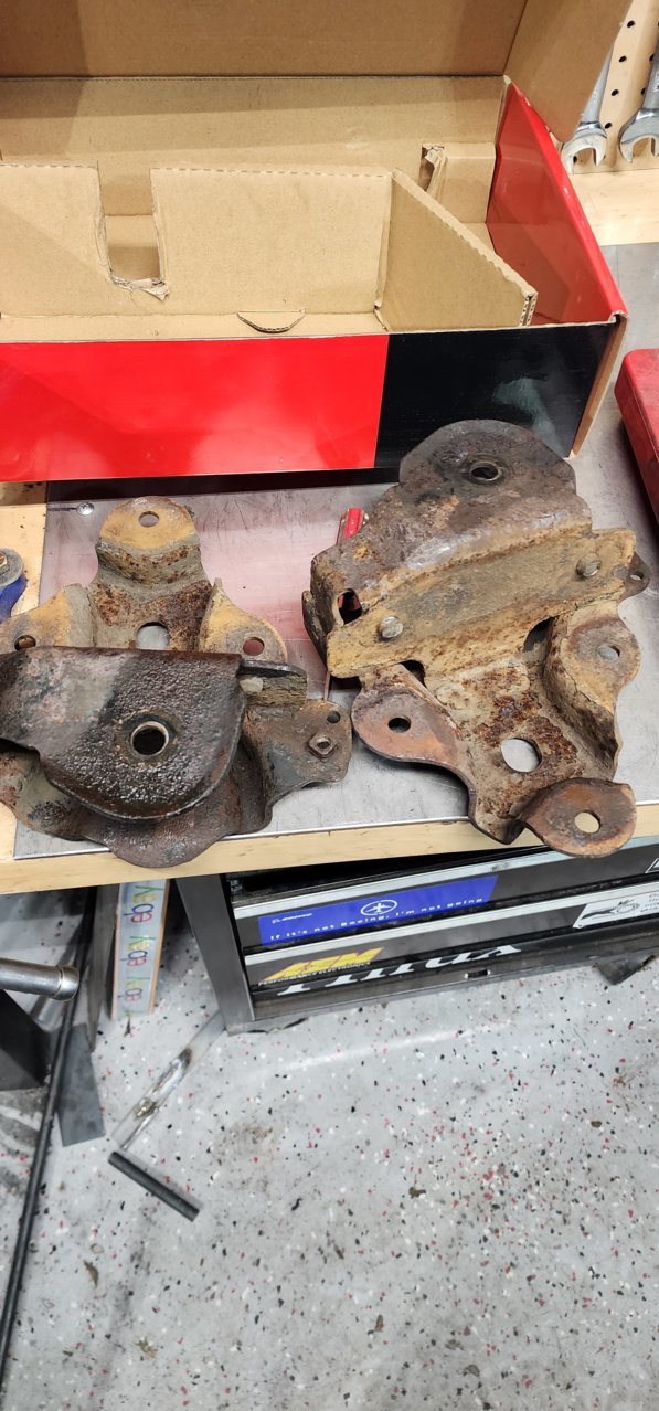

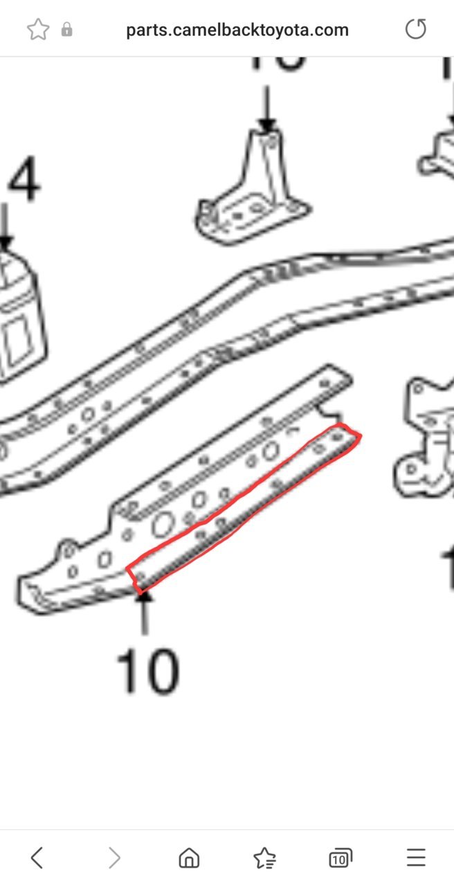

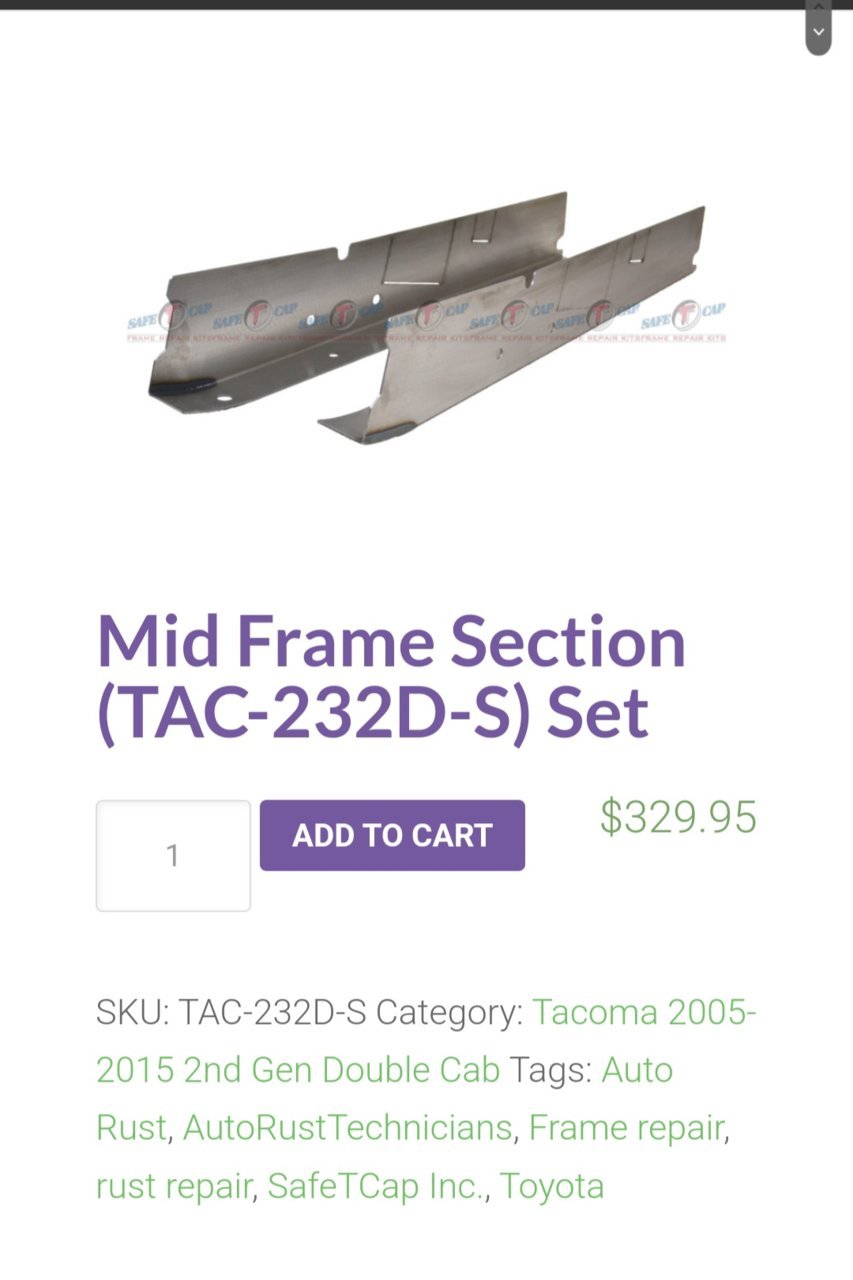

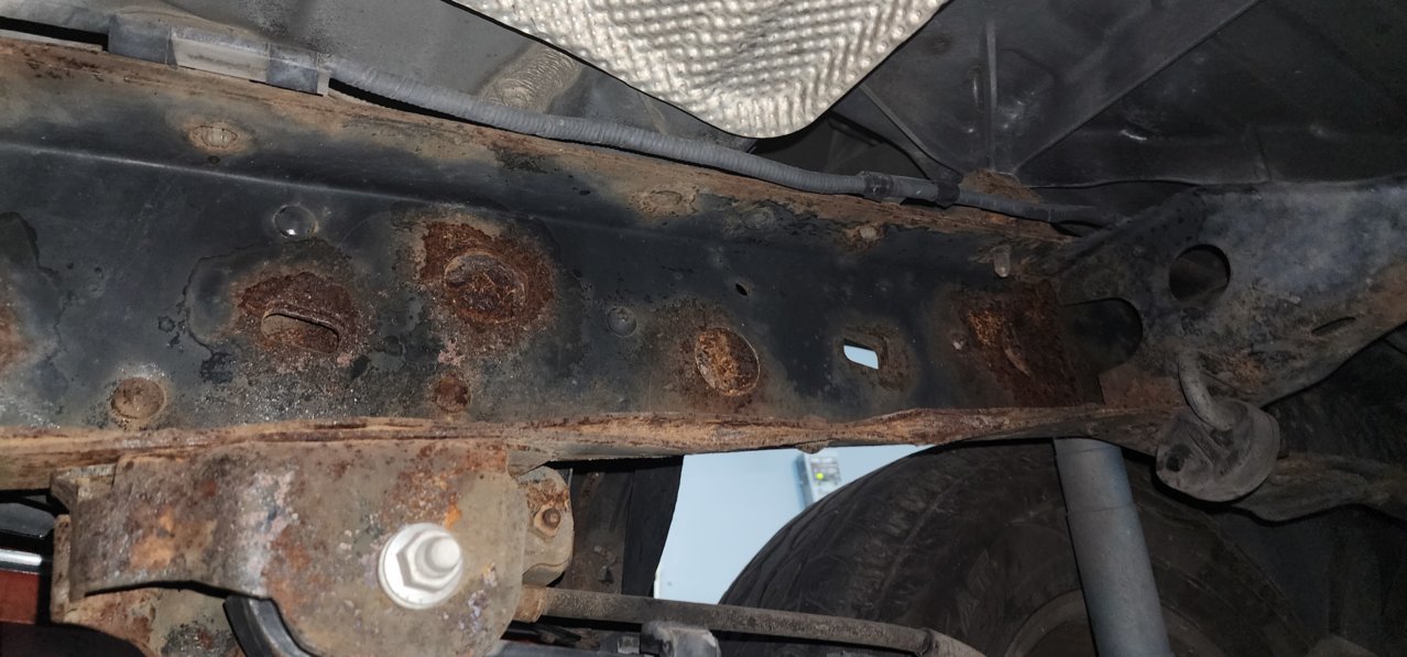

    I got the rear end torn down pretty good over the weekend. The front leaf hangers are a bit crusty but structurally fine. Toyota doesn't want to sell me replacements even though they have a part number, they recently deemed them as non serviceable LOL. Whatever, I will sand blast these and paint them. They also don't want to sell me this inner reinforcement piece when they definitely have a part number designated for it. I plan on cutting the section in red off to weld on A36 1/8 plate. Once I fix the walls on the frame I will install this reinforcement piece I found from autorust.com. Additionally I plan on painting and applying 3m burshable seam sealer in between all metal pieces. The rust repair is slowing me down but she's coming along.

    It's the front, static leaf hanger he's talking about. Not the rear hanger that has the shackle (which would be replaced by HH)
