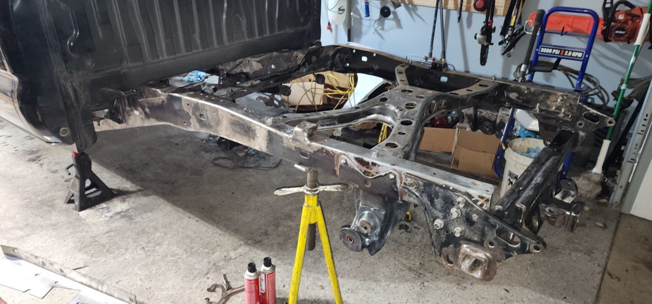

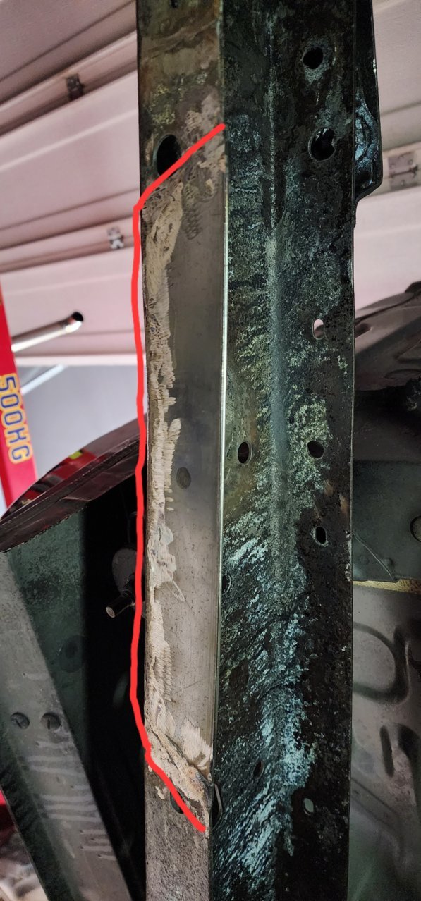

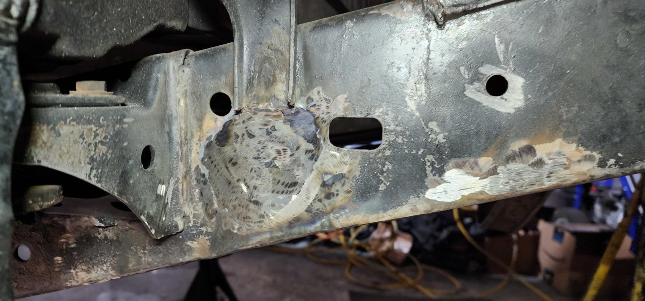

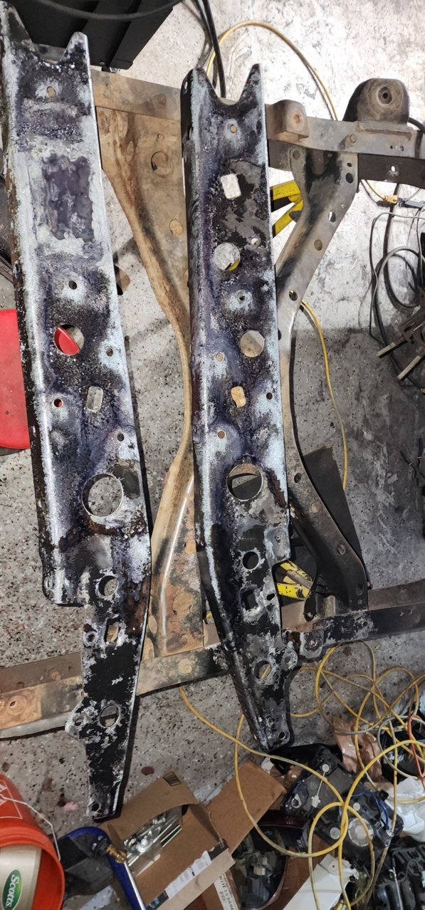

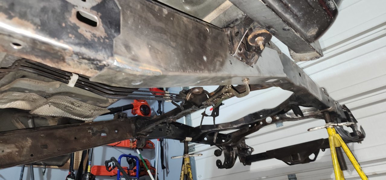

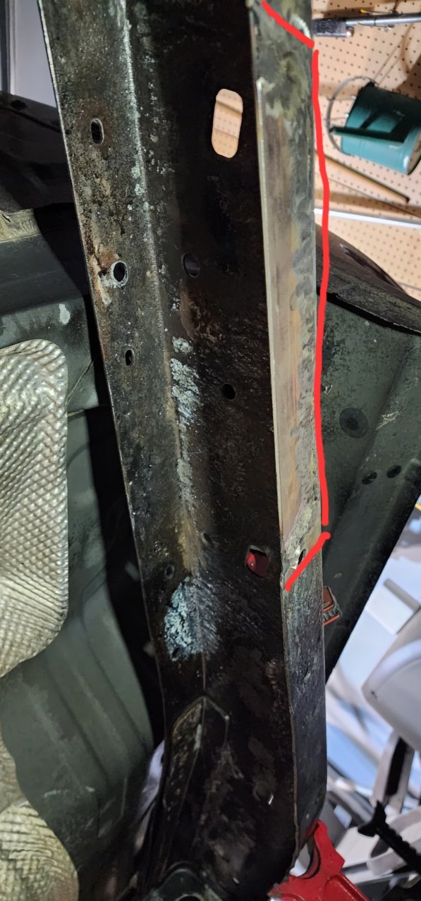

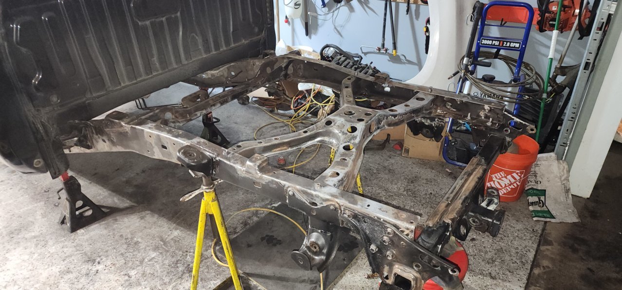

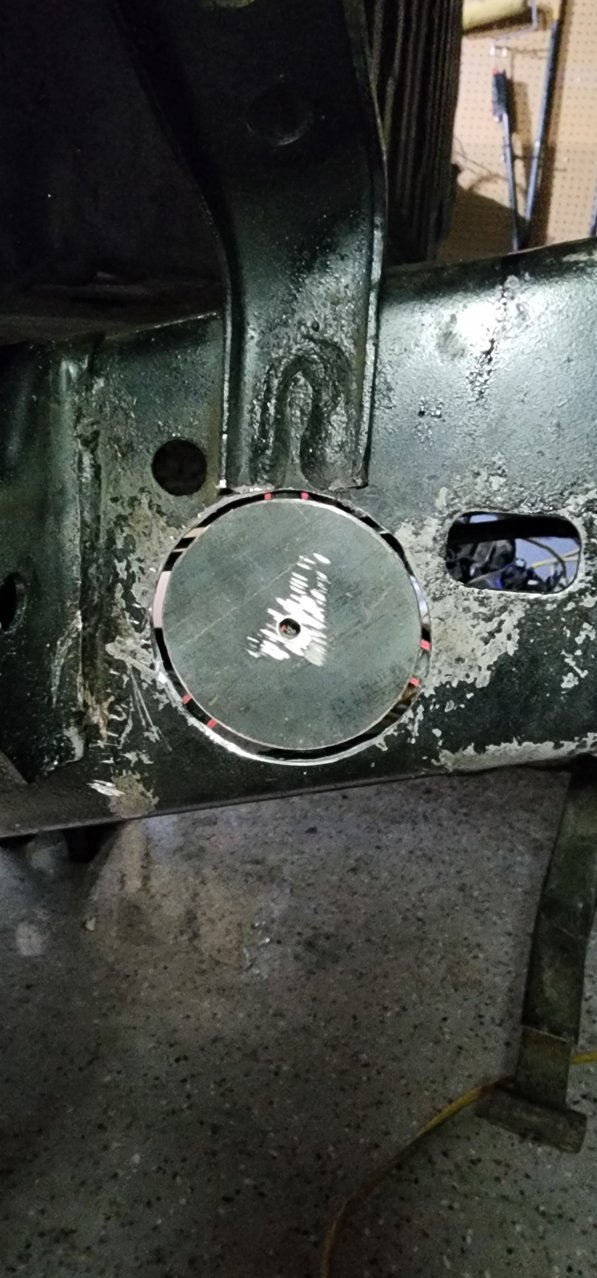

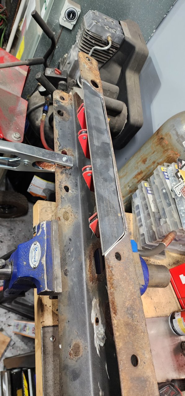

    2 wall sections on the frame replaced (in red). The circle was paper thin. One wall section and one floor section replaced on the mid frame reinforcements. Everything was de-scaled, wire wheeled and treated with acid. LOTS of cutting and welding today. Everything on the frame feels pretty solid now. The last picture shows the rotten pieces.

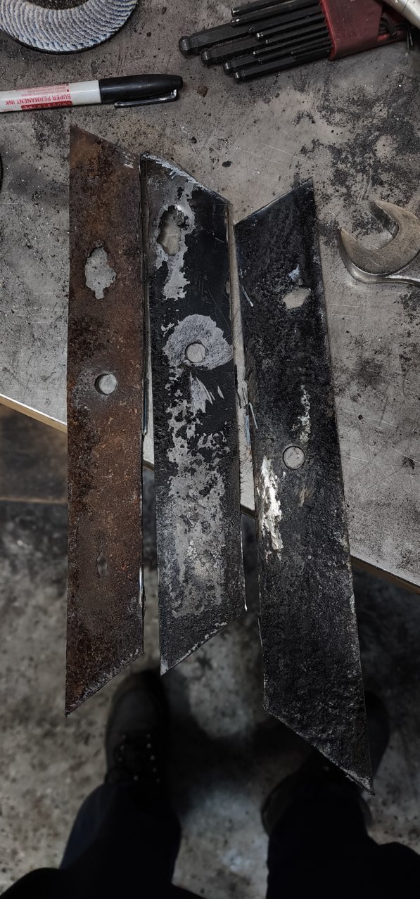

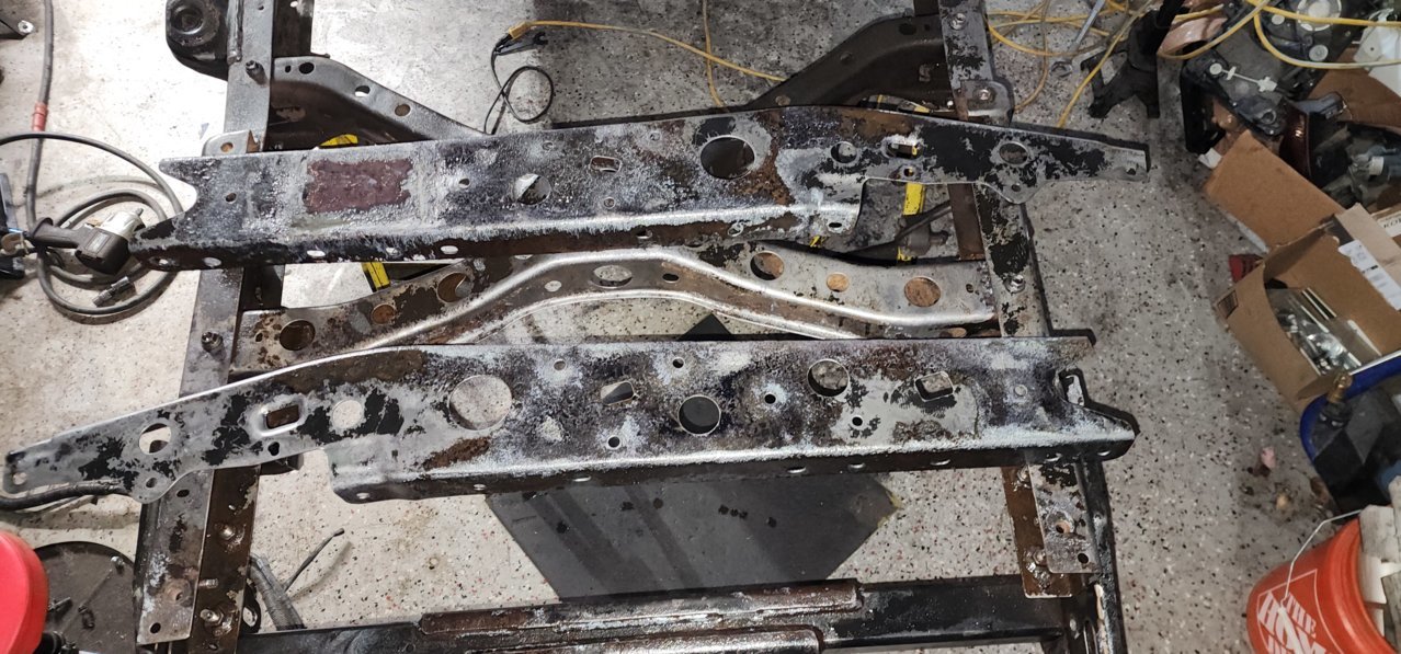

    Also I just wanted to add that the Ospho (phosphoric acid) product works pretty good. You can see the 2 rotten frame pieces are black after about 8 hours compared to the untreated reinforcement piece.

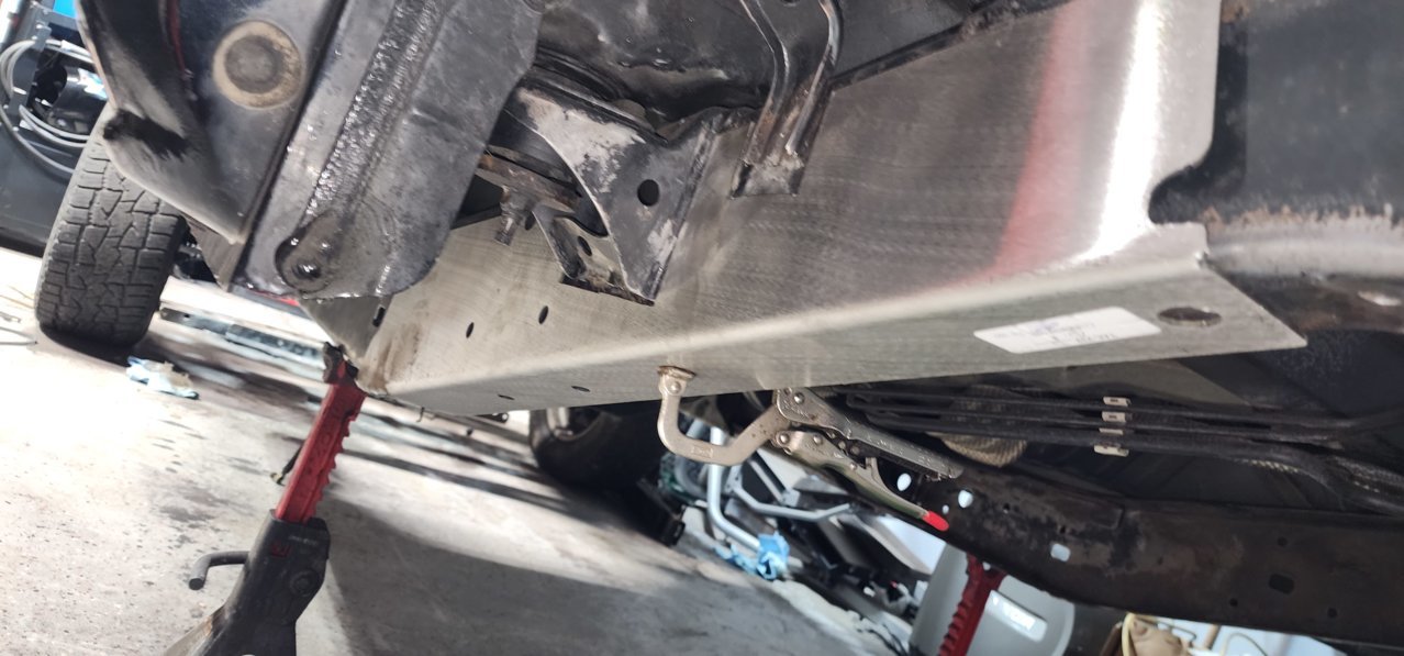

    Here is what the after market mid section reinforcement piece looks like. It fits pretty nicely.

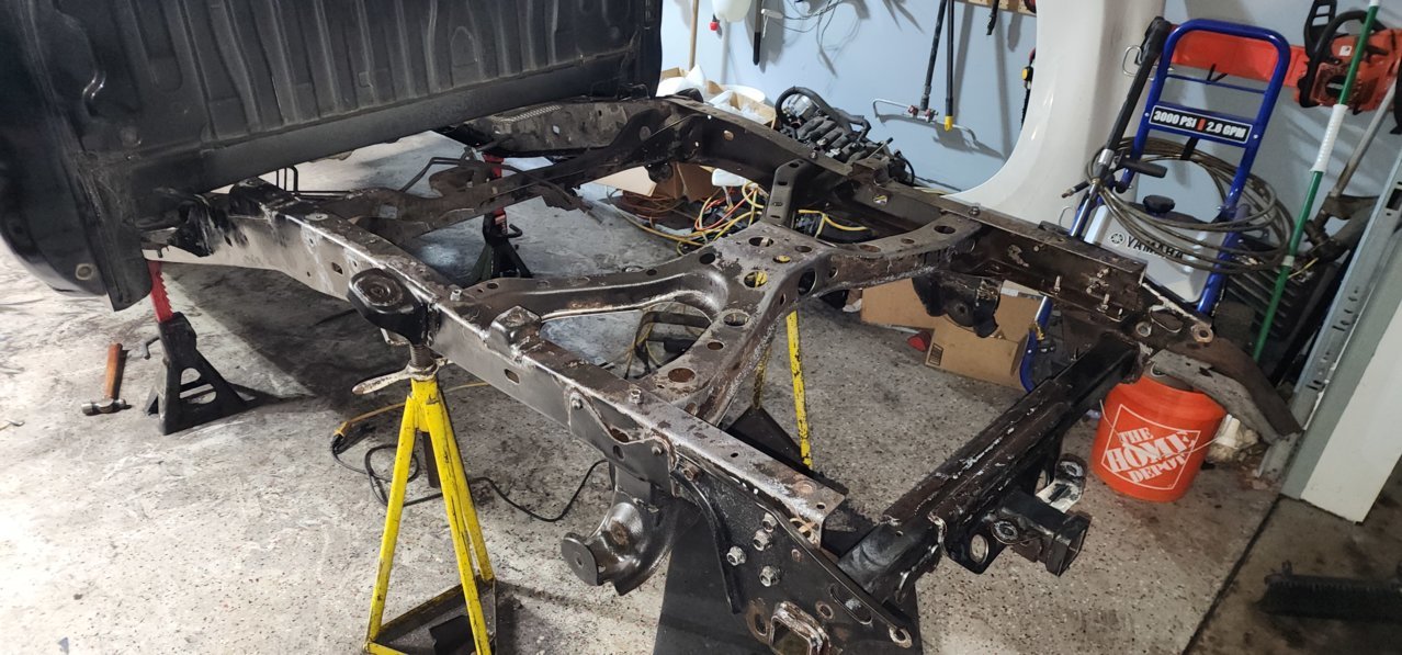

    I rubbed the patina rust down with the acid today and fully degreased with solvent on blue shop towels. It is ready for epoxy sealer.

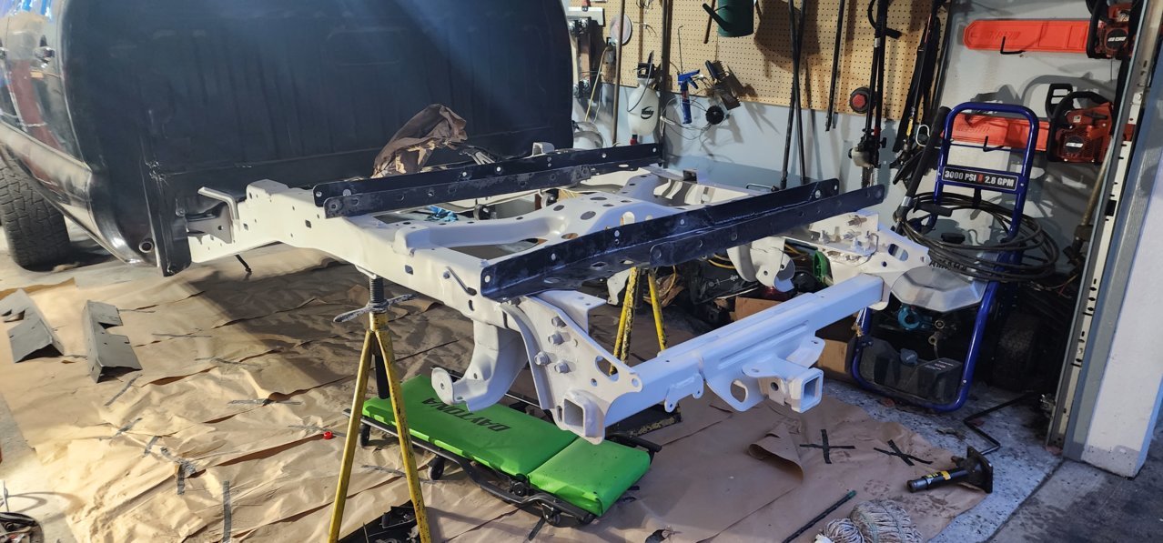

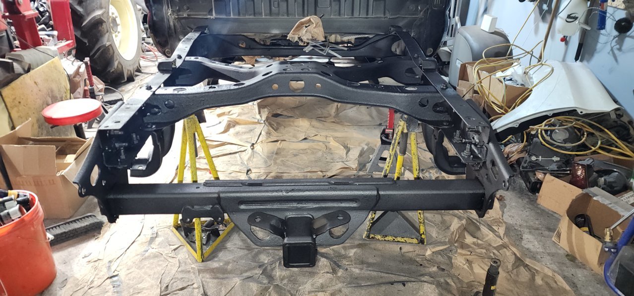

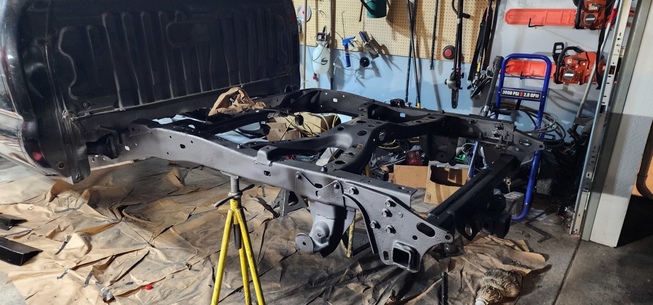

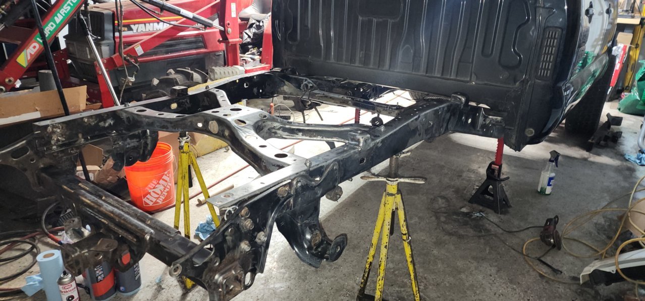

    The frame is primed and painted
