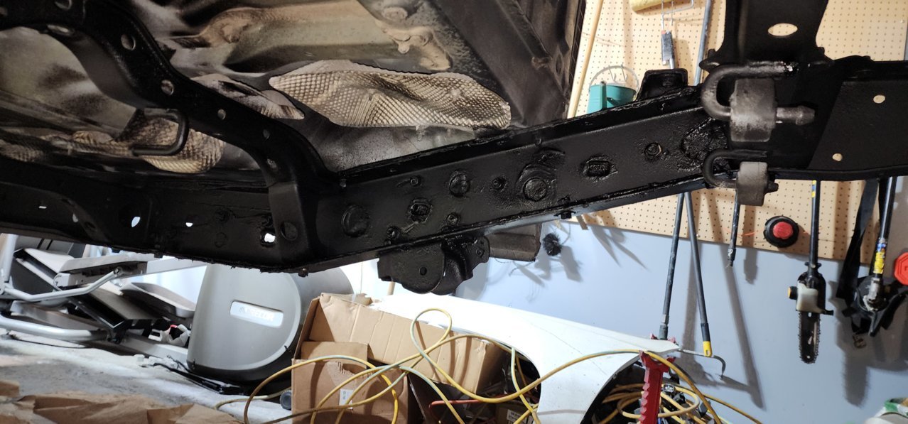

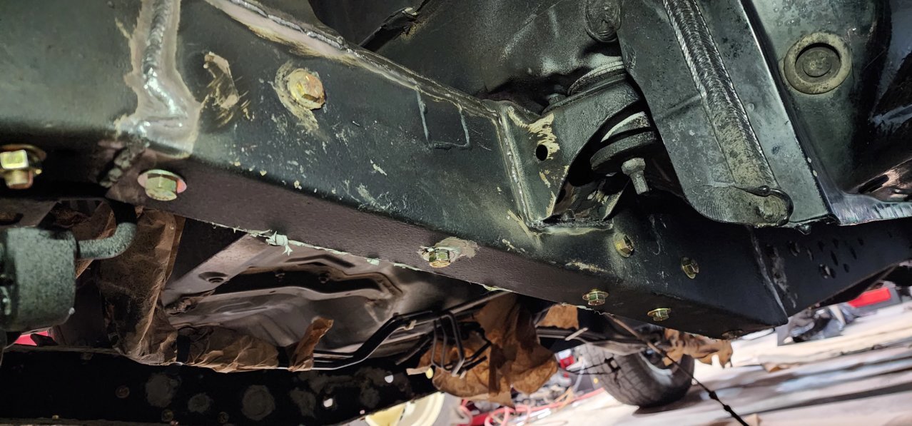

    Installed the inner and after market reinforcements. Went to town with the seam sealer. 38 freaking bolts. 20230106_202648.jpg 20230106_202706.jpg 20230106_202855.jpg

    I stand corrected, there was a total of 40 rivets removed and replaced with bolts. Once everything was in place I tightened them as hard as my electric 3/8 impact would go and welded the nut to the bolt. Still fully serviceable because I can just cut the weld off and remove the bolt. Although I doubt I will ever be taking this apart again. The front leaf hangers were a pain to mount the holes needed to be slotted due to the additional thickness of the reinforcement plate. I measured eye to eye on the leaf mounts to make sure the mounts weren't off location after I slotted the holes. Also I didn't want to take any chances and also welded the brackets to the frame once they were bolted in place. I started boxing in the frame also.

    I hope that you had an air chisel for all of your rivets. Sheesh, that is a lot. At the box section at the end of the frame that you posted, just a suggestion, I also wrapped my weld around the edge and back into it as far as the gun would easily reach.

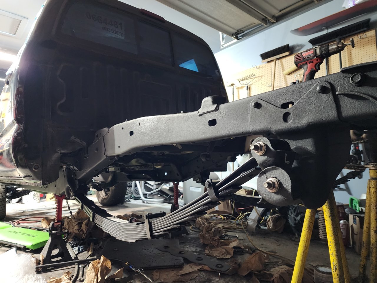

    I got the leafs mounted and a few more sections boxed in. These are all pro standard 3 inch leafs p/n: ap-306743
