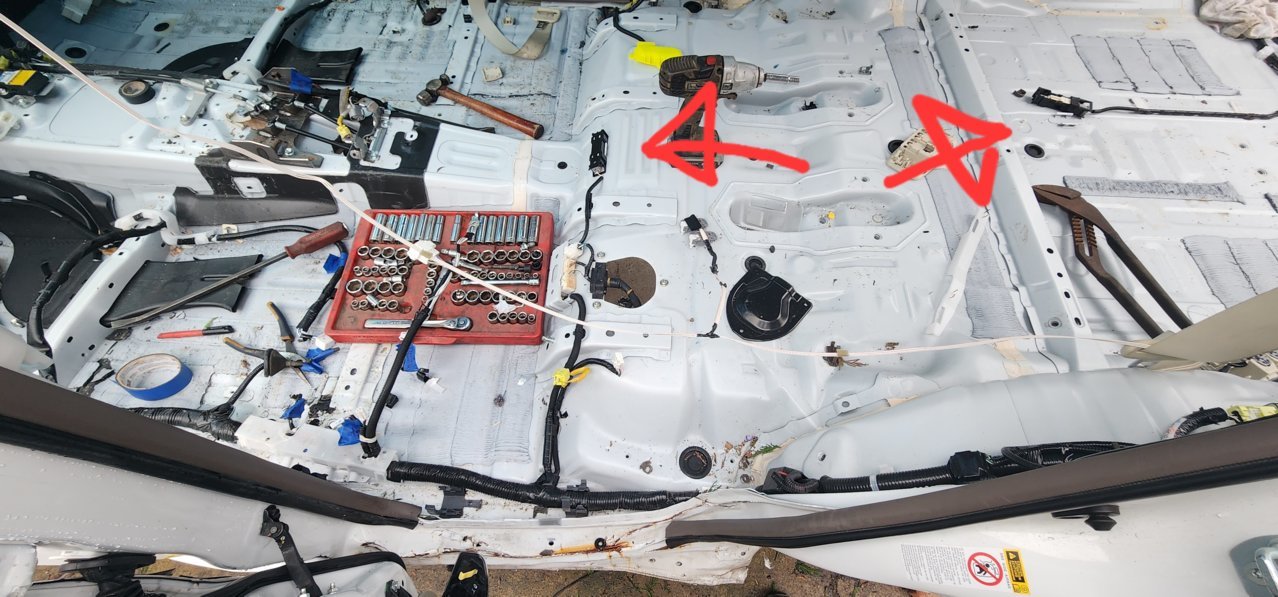

    What are the blue and pink lines? Rear HVAC?

    I think they are sunroof drains.

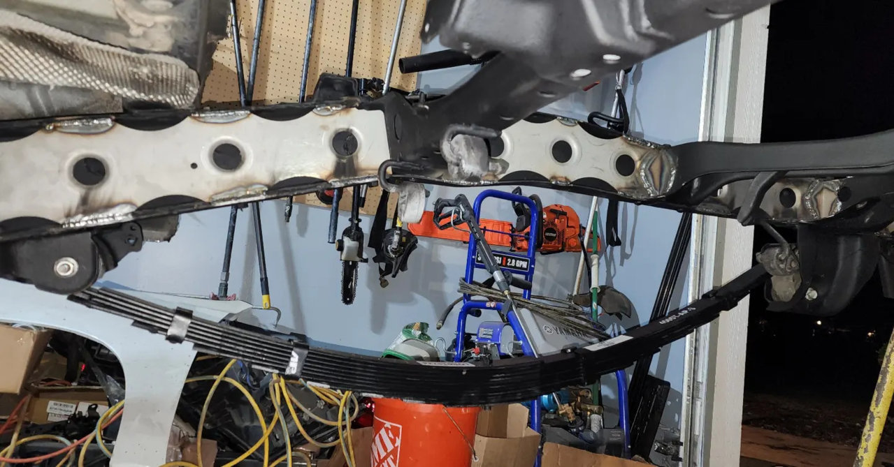

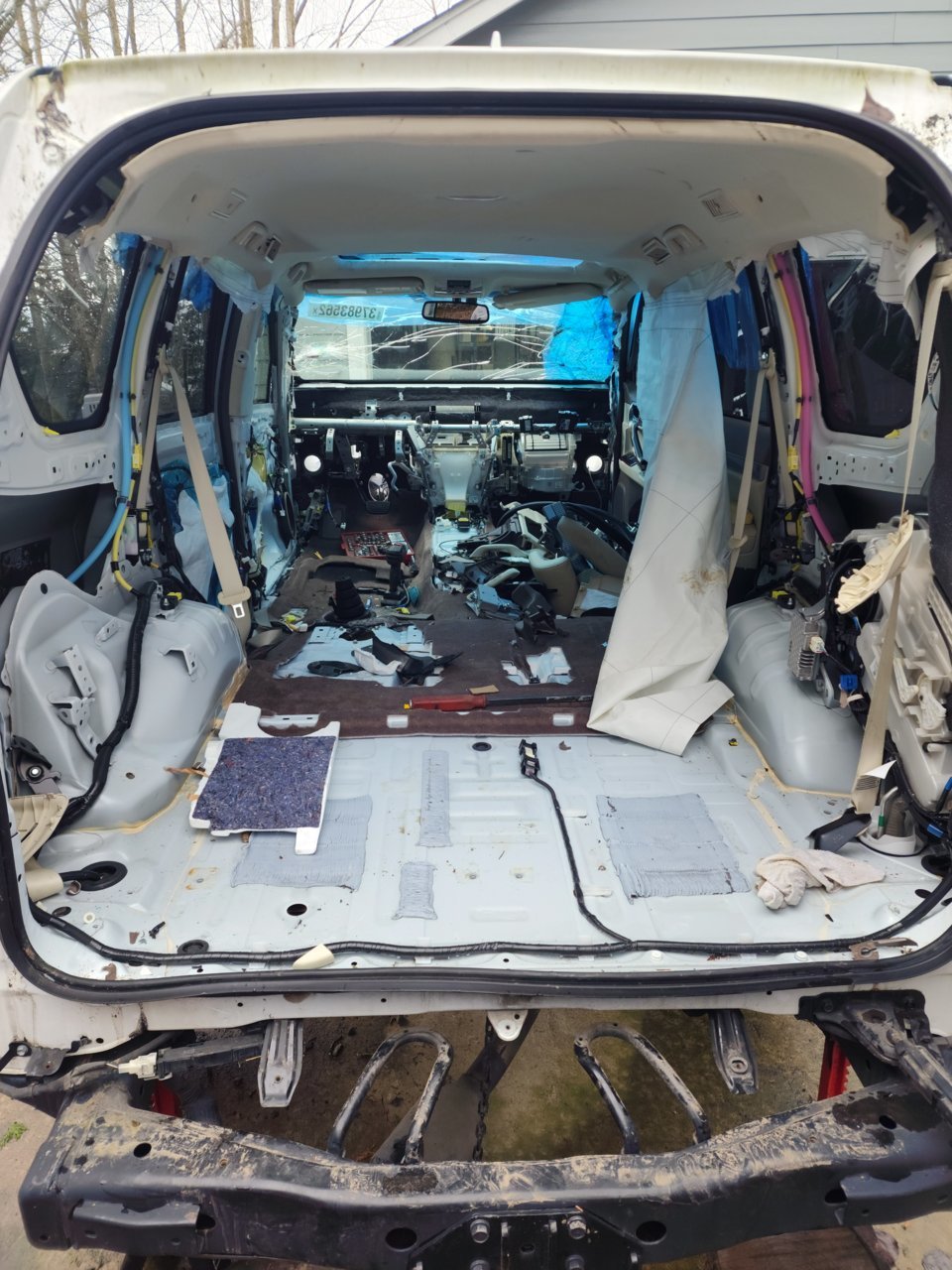

    Headliner and carpet are out. Heres where I stopped today.

    I was doing more wire removal on the lexus and I came across these two modules, per the factory manual these are the wireless key interior antennas. No antennas, no start lol. Also they put a floor mounted airbag sensor adjacent to the left antenna in this pic (yellow cover). I will have to also figure where to mount that, in similar orientation, in the Tacoma cab.

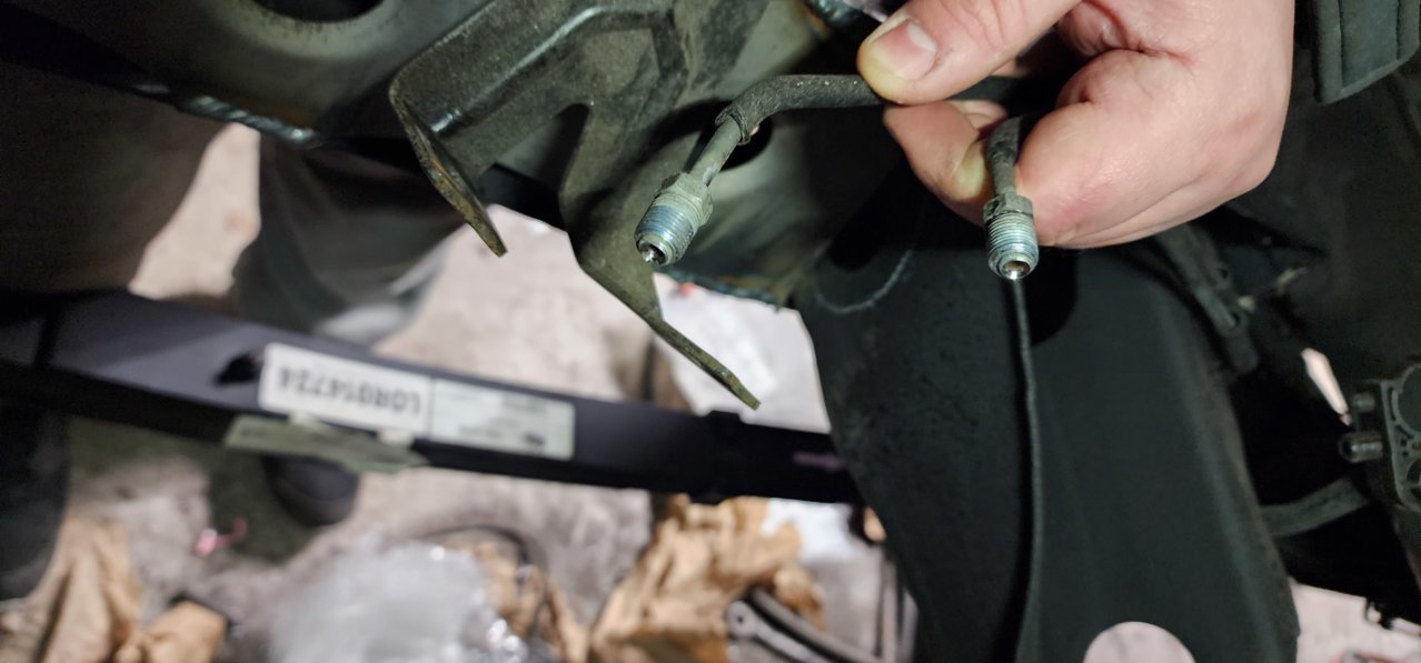

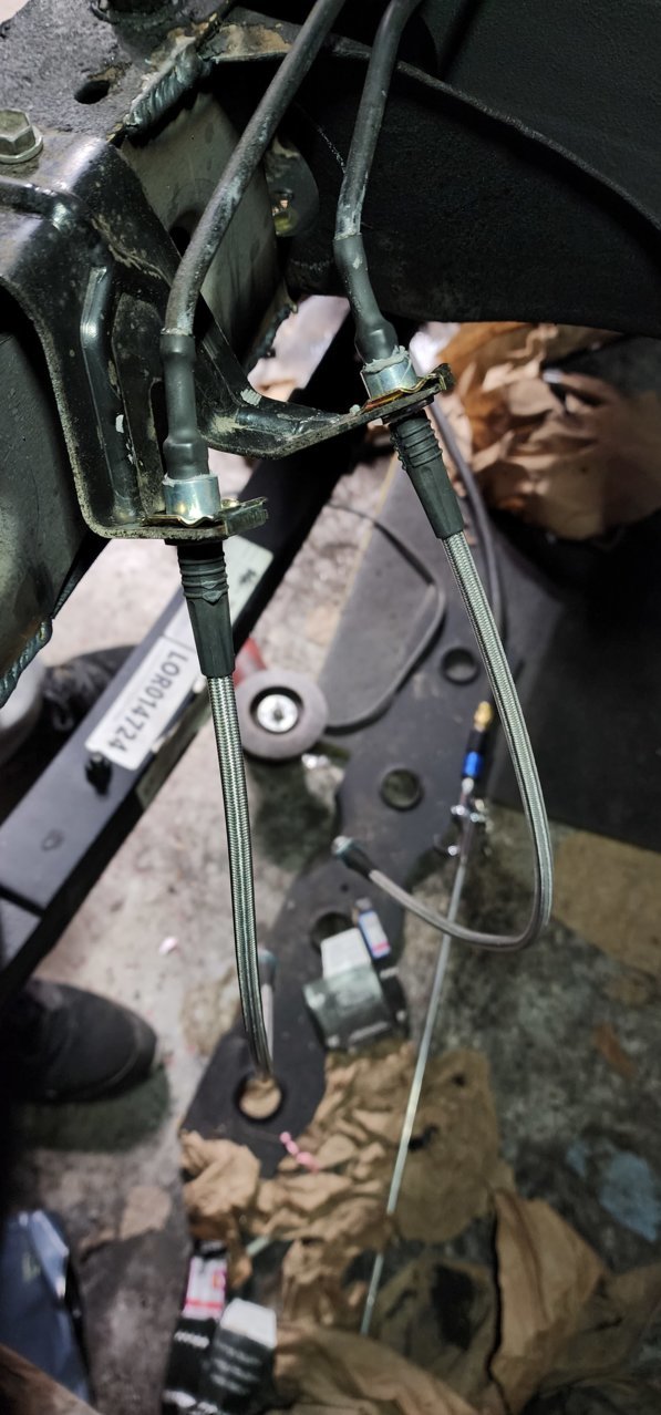

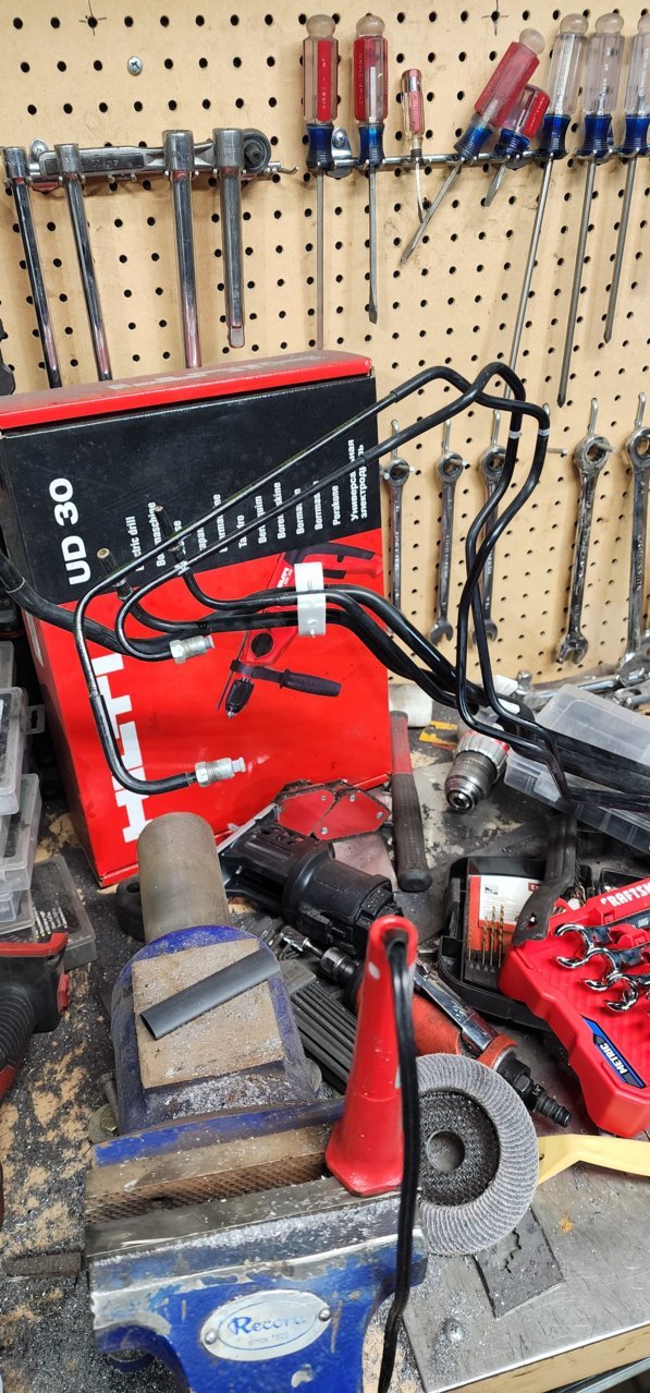

    Got some new fittings on the rear brake lines, the lines themselves are good, fittings were crusty. And got the extended stainless lines installed. I put some silicone and heat shrink over the fittings to prevent corrosion.

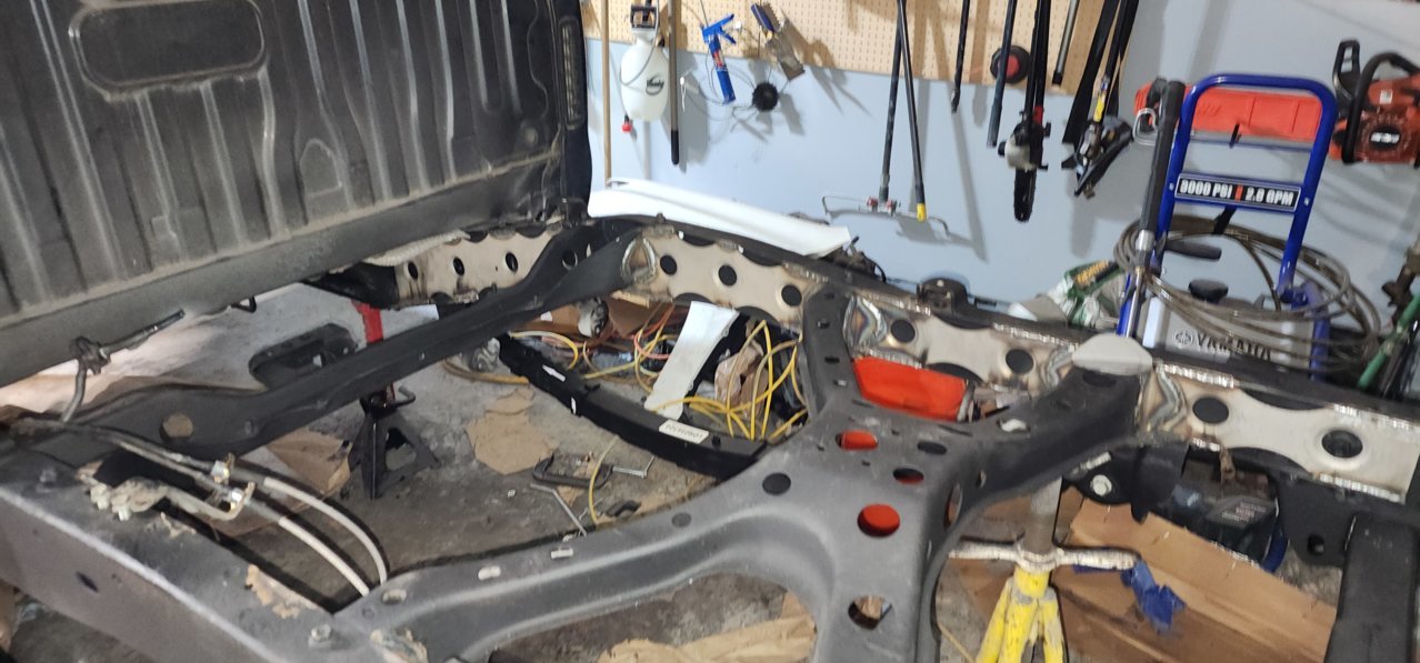

    I have a couple more sections to box in the frame. I ordered all oem new plastic brake line holders. Also I came up with a good idea about reusing the front brake lines off of the gx. Since the cross member has to be moved 3 inches back, I will need to use the GX460 brake lines. The tacoma brake lines has a sig sag bend right behind the cross member, so it would interfere with were I need to put the cross member. I will show you guys more once I get closer to having that fitted up. Also I will use the Tacoma Evap line but hook it up to the Lexus charcoal canister. It will be very nicely done.

    Got more welding done today. I am very happy with how dimensionally accurate the DMZ fab kit was. Highly recommend.

    They are sunroof drains.
