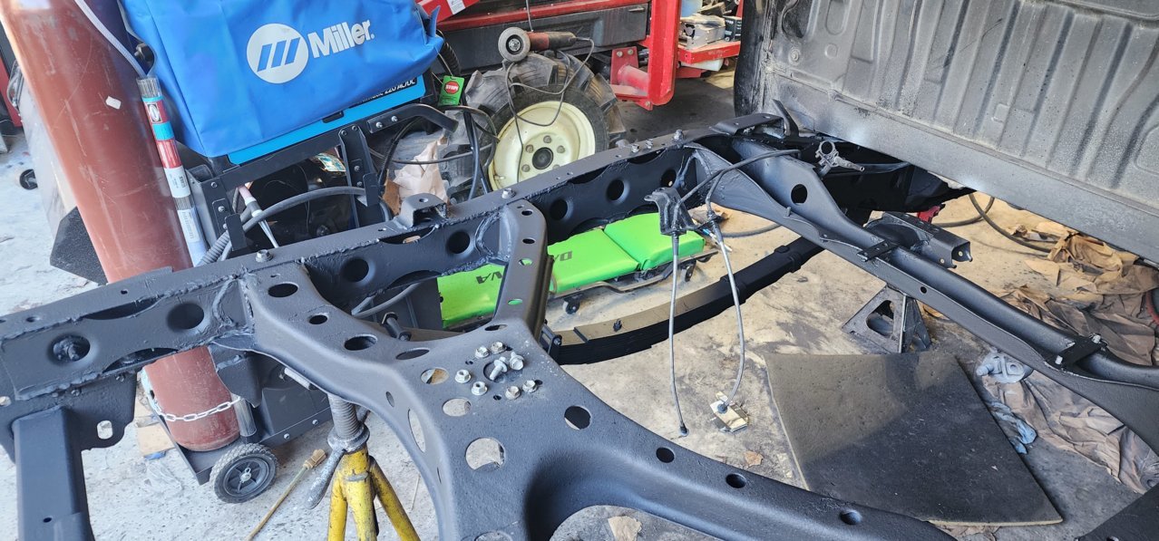

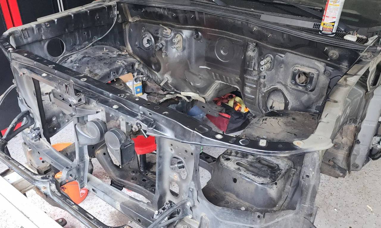

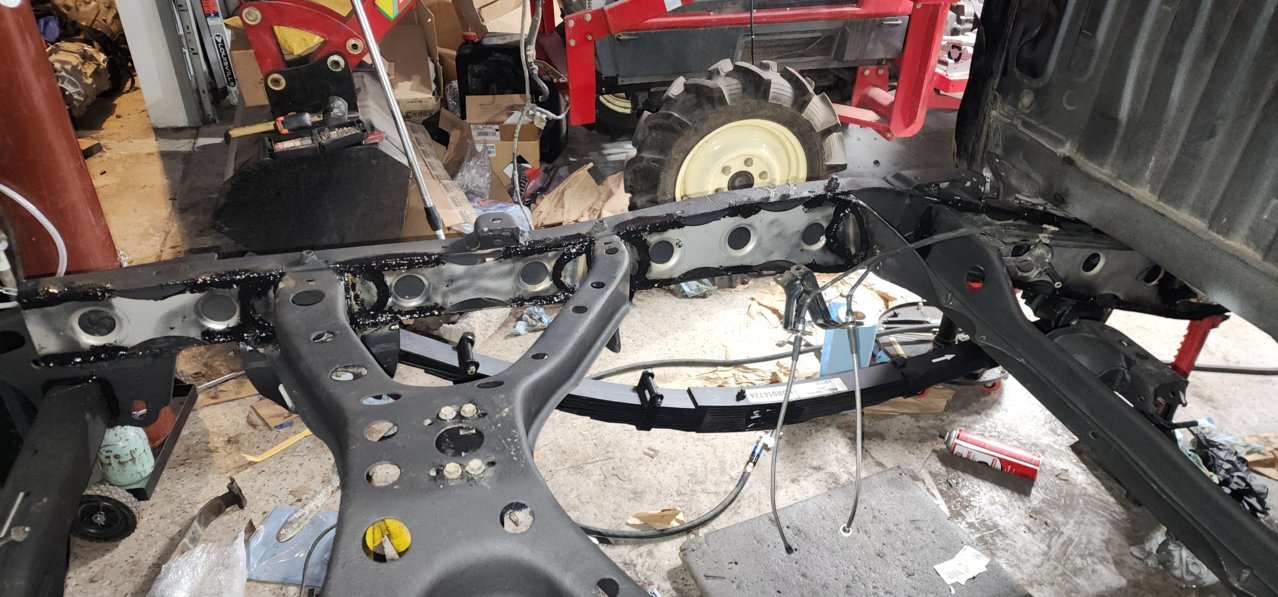

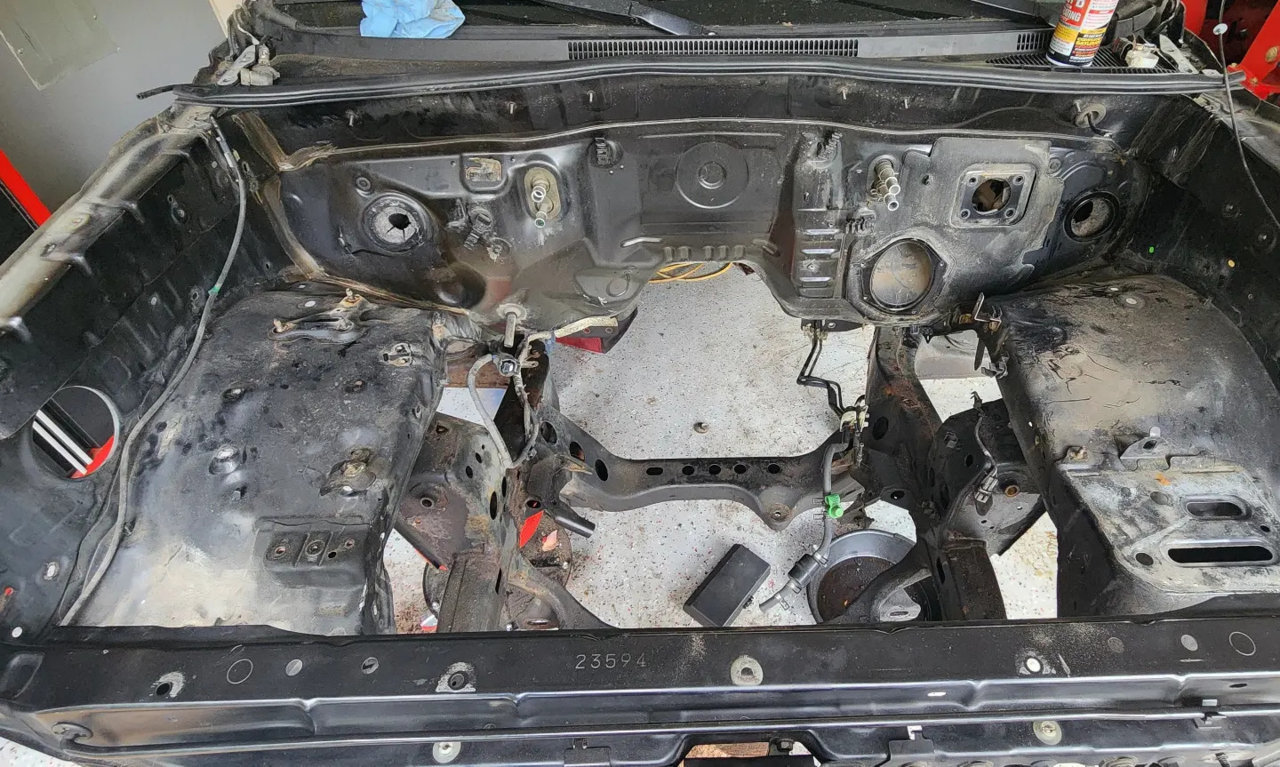

    I seam sealed all the areas I had to weld in today. I am hoping to have it painted this weekend.

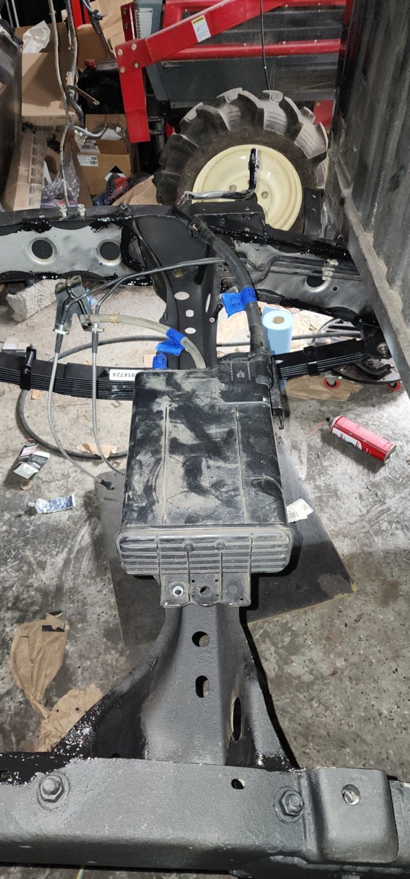

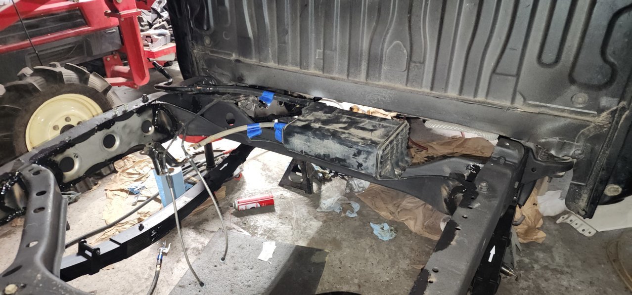

    Here is how I am planning on mounting the evap charcoal canister. It is thinner but a little wider which is good because it will clear the bed.

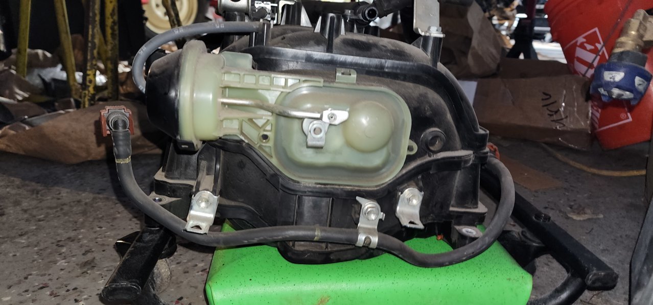

    Actually, the bung is already there! Here’s where the Tundra booster pulls vacuum from (not that it matters to your application):
    Also, what year is your GX? If it’s after 2013, take a look at this:

    Okay I got the charcoal canister fitted. Something to consider are the support ribs of the bed. There is a rib at the bed bolt location and the next one is 10.5 inches to the rear of the truck. I have modeled them using my crude "straight" edges lol.

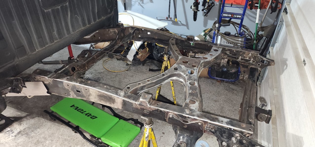

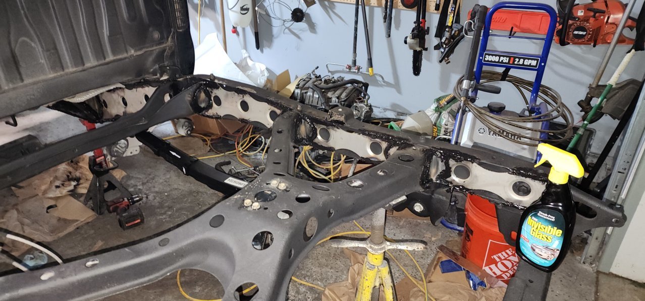

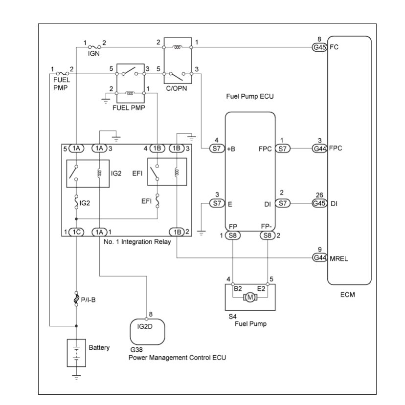

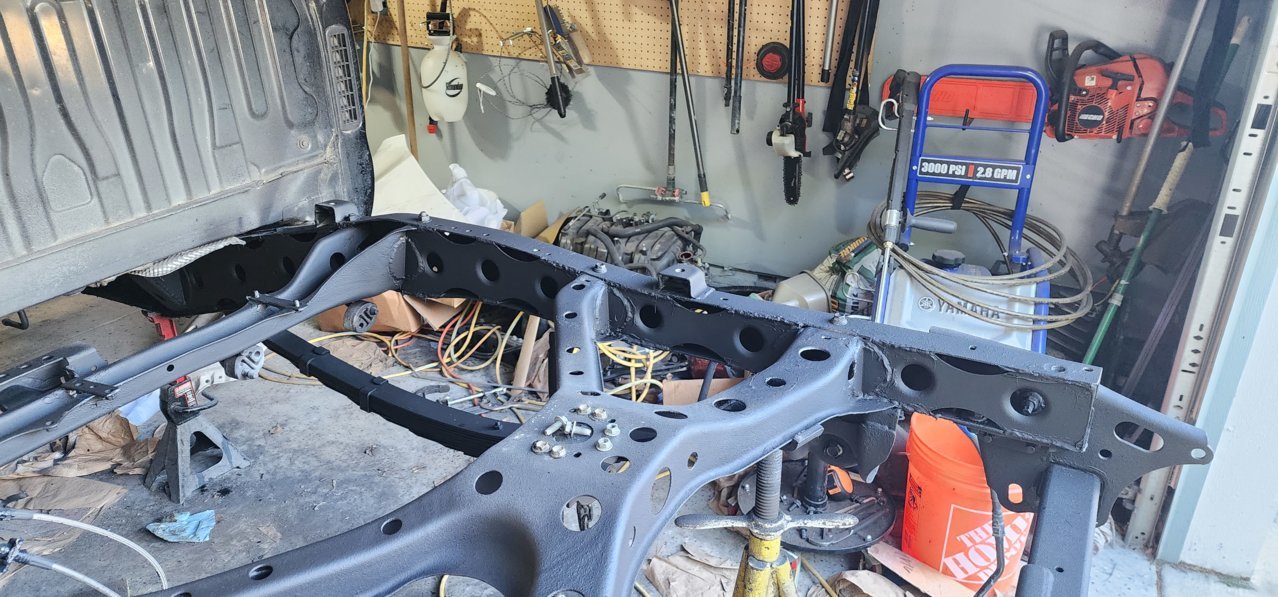

    I got the frame painted over the weekend. My goal this week is to finish taking out the gx460 body wires. I am 50% done with that now. What I found interesting is that the GX and Tundra both have a fuel pump ECU mounted above the rear axle on the driver's side. 20230130_133555.jpg 20230130_133530.jpg

    So no resistor in the engine bay? That’s how the Taco does it; either full power or half speed thru resistor

    I guess not.
