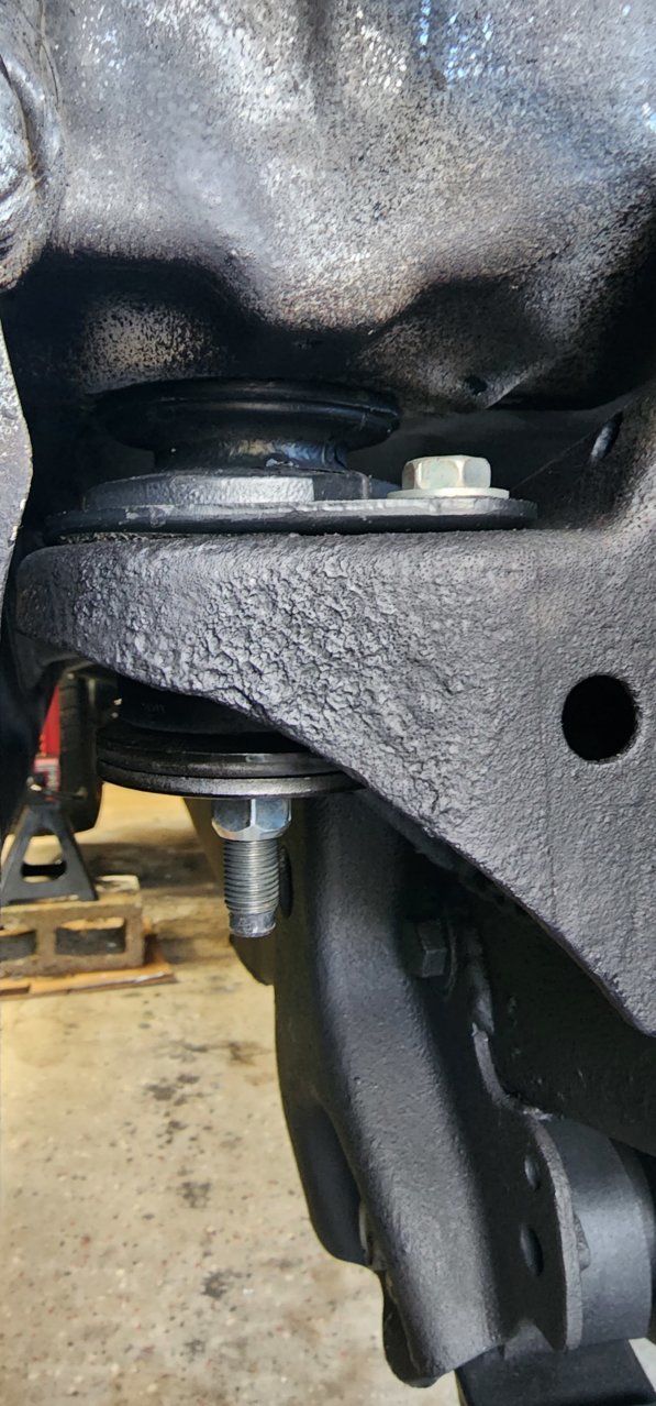

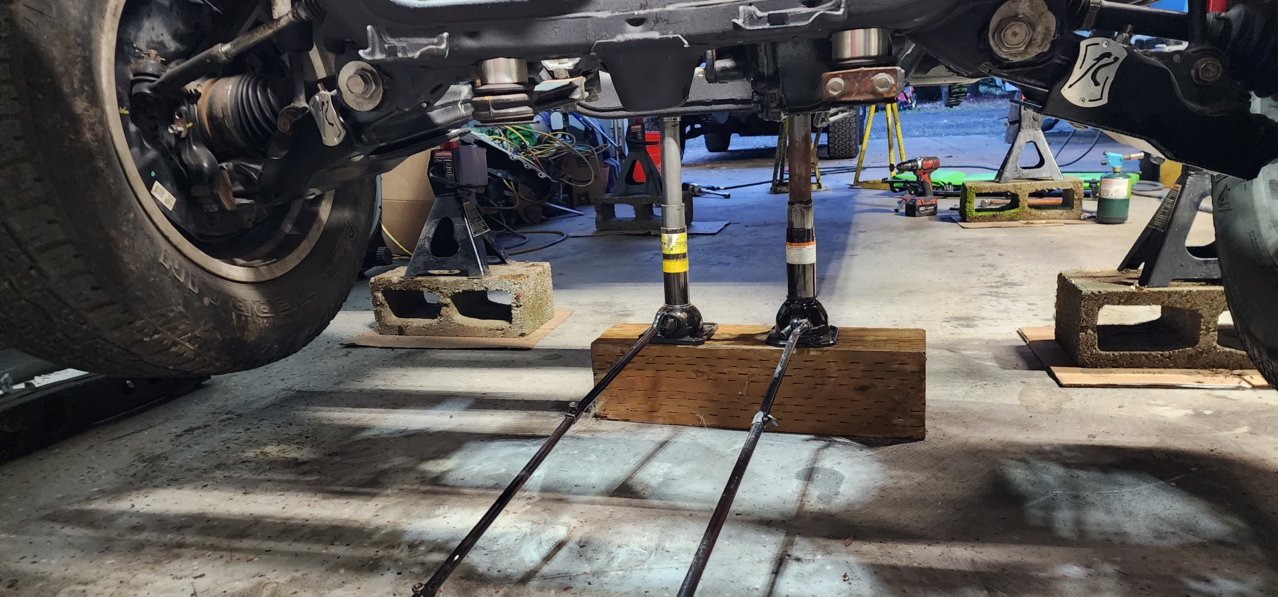

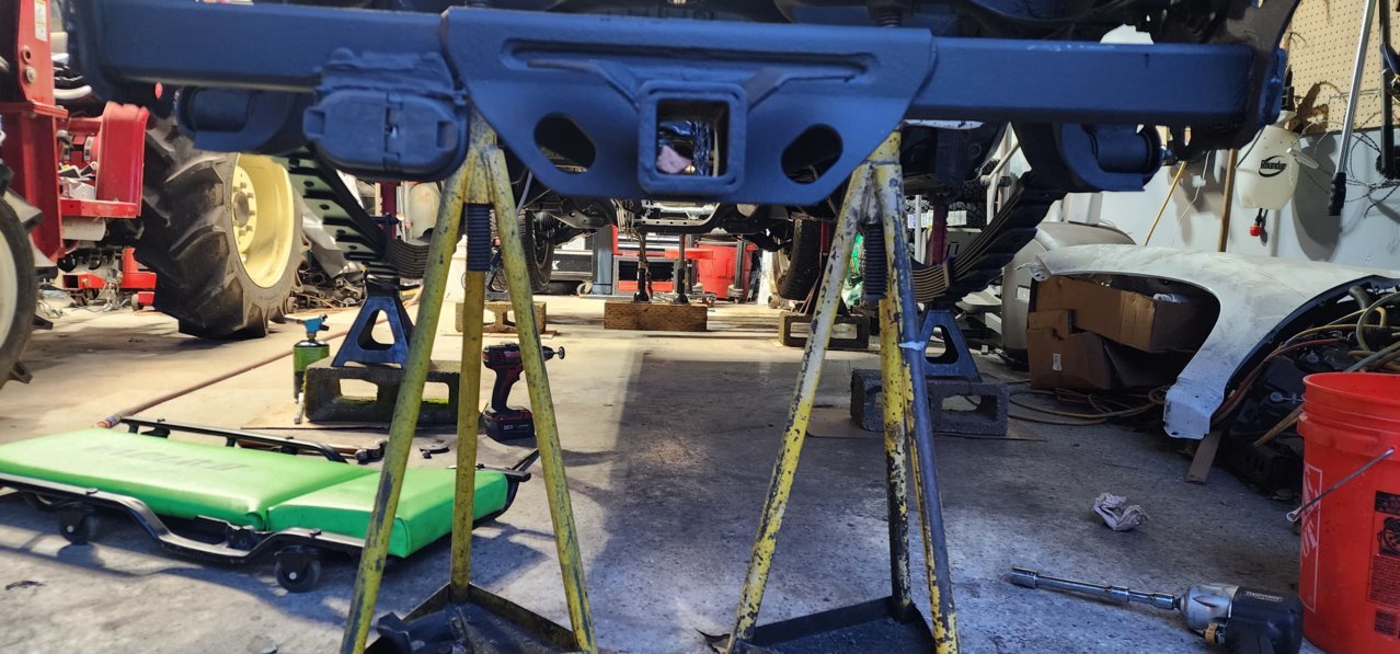

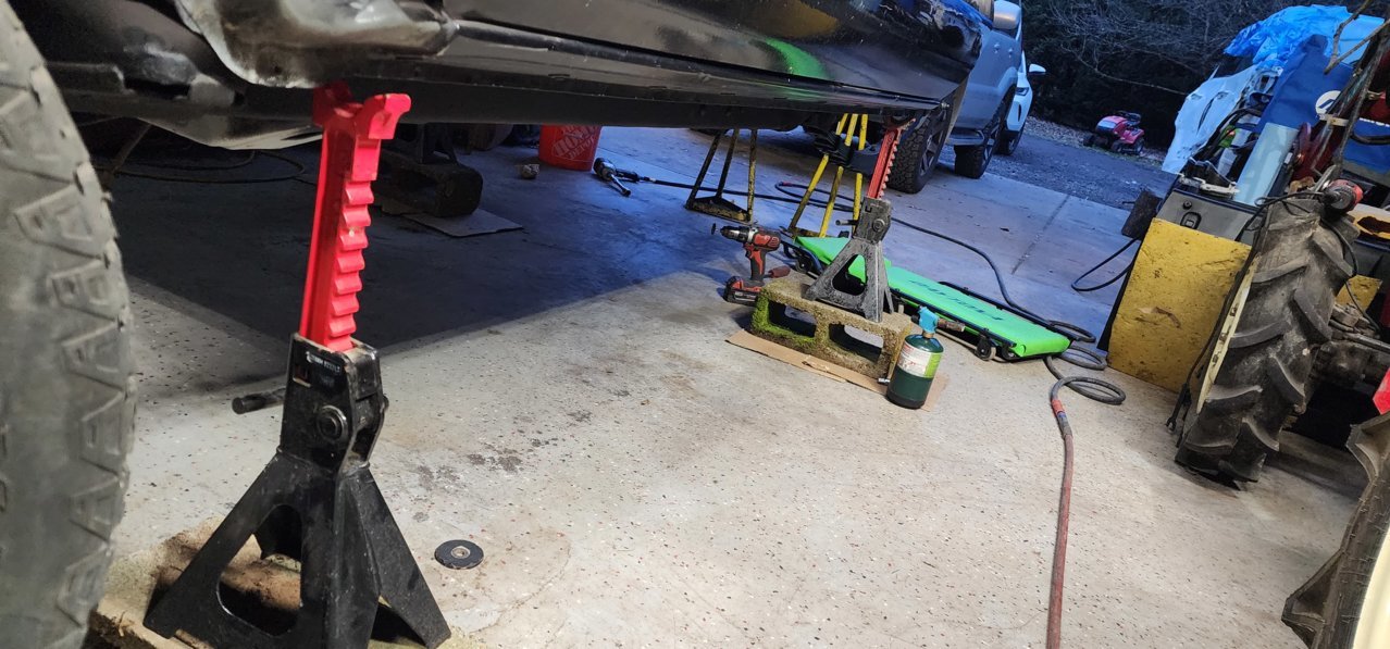

    Well guys where there's a will there is a way. I don't have a car lift but I do have 2 Toyota truck jacks along with the 2 lifting jacks I used to support the rear end. This is how I decided to change the cab mounts. I jacked up the truck, setup jack stands to support the cab and very slowly lowered all of the jacks about 1 turn per jack until I got the clearance I needed. Definitely one of the more sketchy things I've done in the garage but it seems to be working.

    find something other than the cinder blocks, on their sides. The cell walls are very easy to break. You are doing a great job, no sense having to take a break, just to heal up....

    Cinder blocks are fragile. I used to use one with the openings vertical, and a thick piece of wood between the jack/jack stand and the block, and on flat ground. Last time I used that setup, the ground wasn't perfectly flat, and my block cracked in half. Luckily the wood keep the load distributed to my setup didn't collapse.

    Hopefully they’re concrete blocks

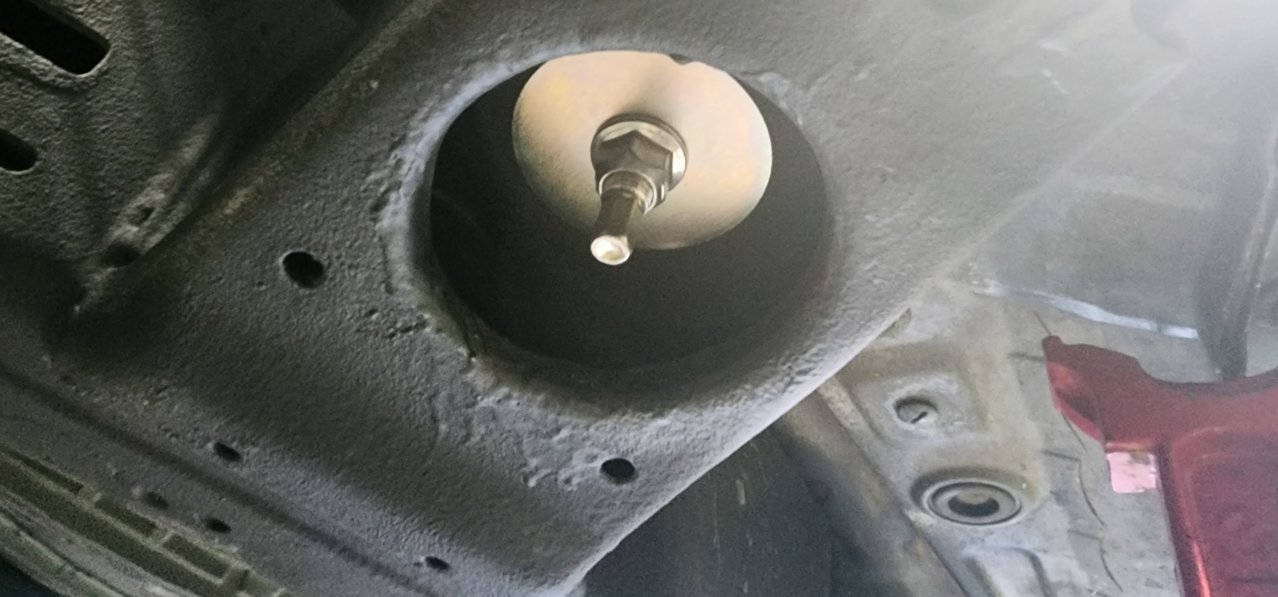

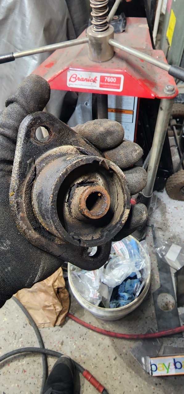

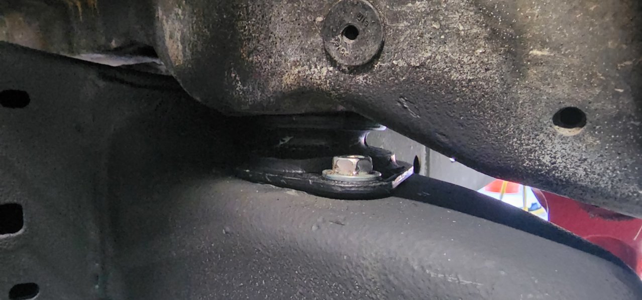

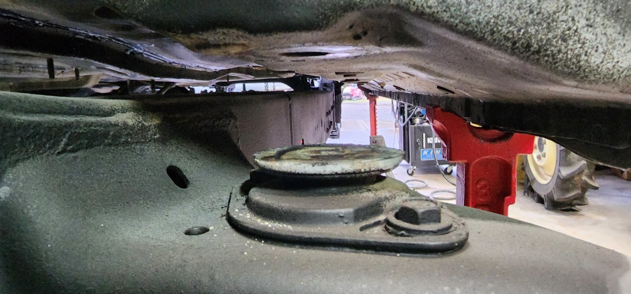

    New body mounts and hardware is installed successfully. I am glad someone on here recommended to have these replaced. My goal is to tear apart the interior by the end of this weekend. Then start wiring the next week after.

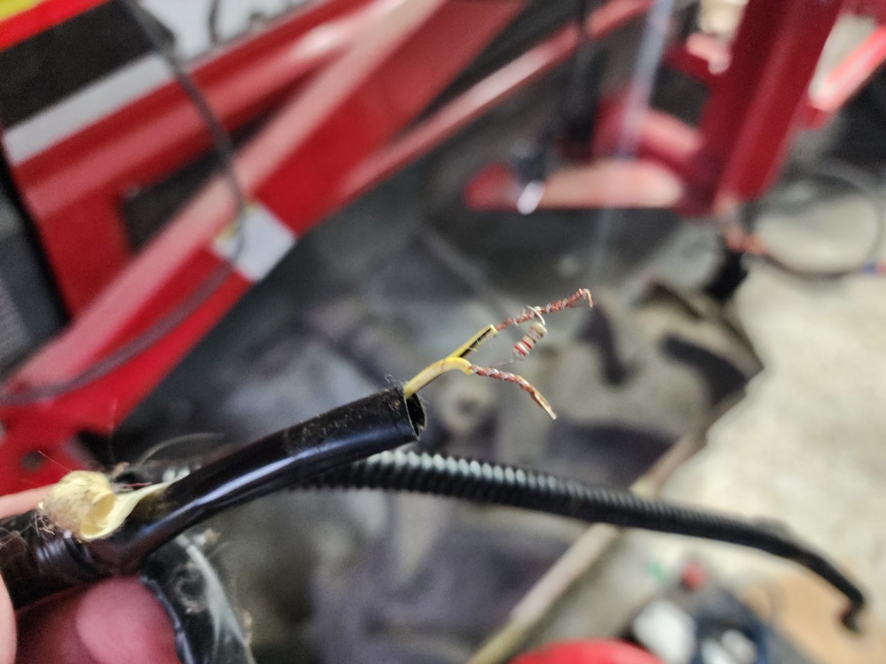

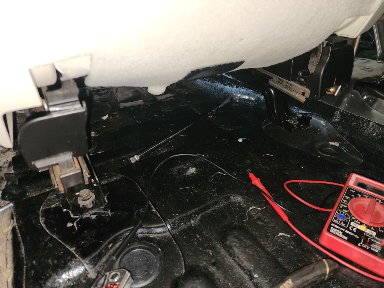

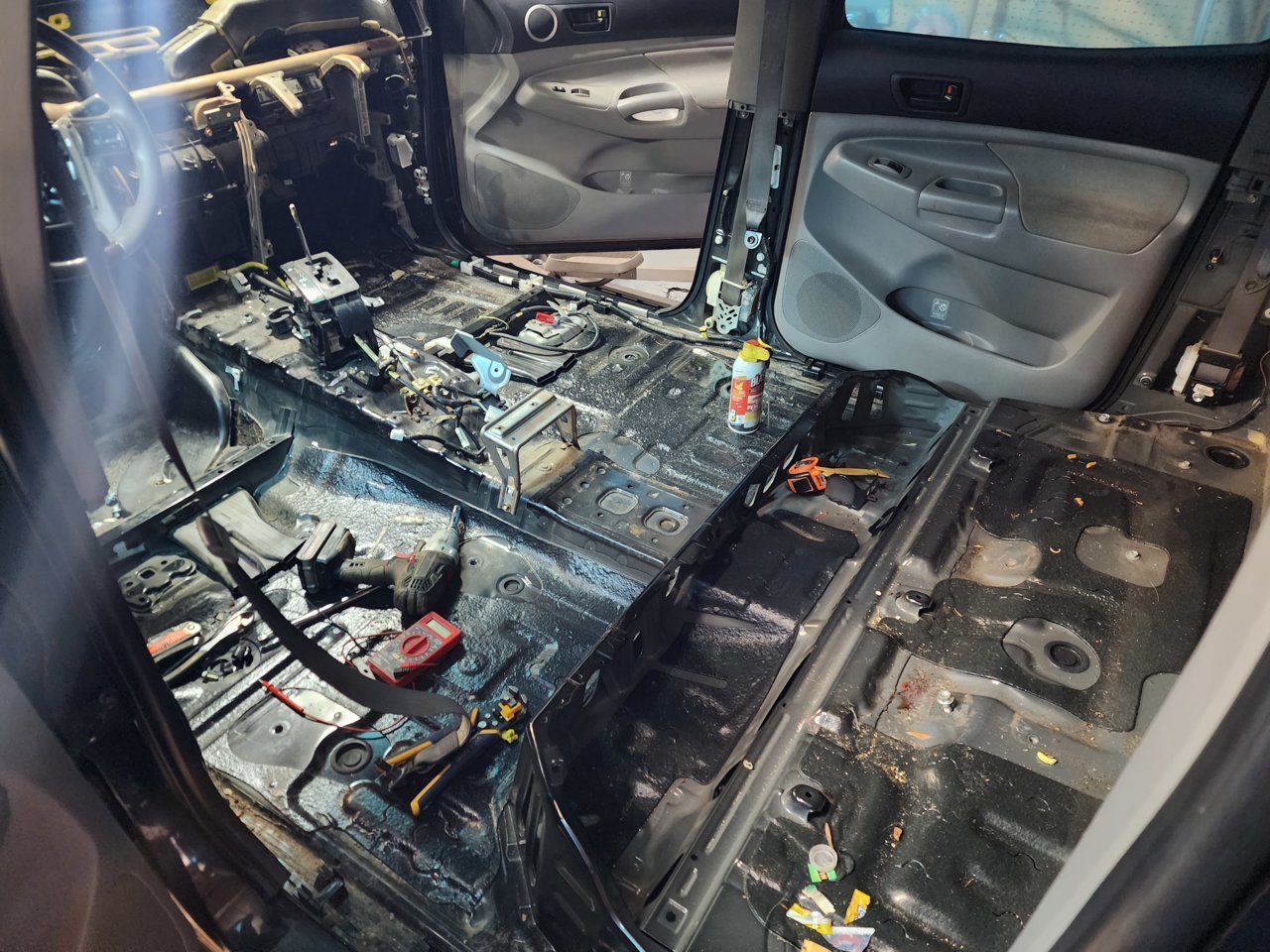

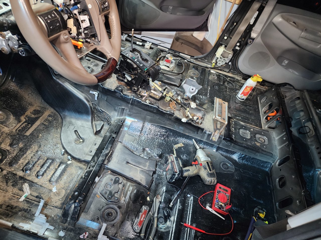

    Making some progress today. In the process of removing the left side body harnes I discovered a resistor around the drivers seat belt. Gotta love it when people don't fix things properly. Drivers side seat belt has low resistance, I am not sure why but I'll be looking for a replacement.

    No this is not the seat belt sensor under the seat. This is the pin that fires when a collision occurs to lock your seat belt.

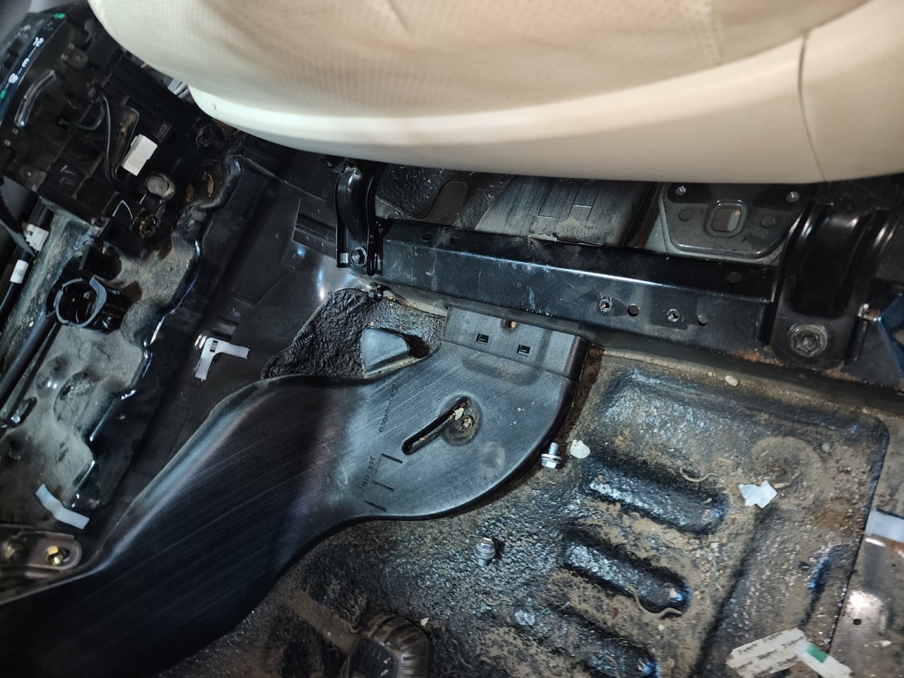

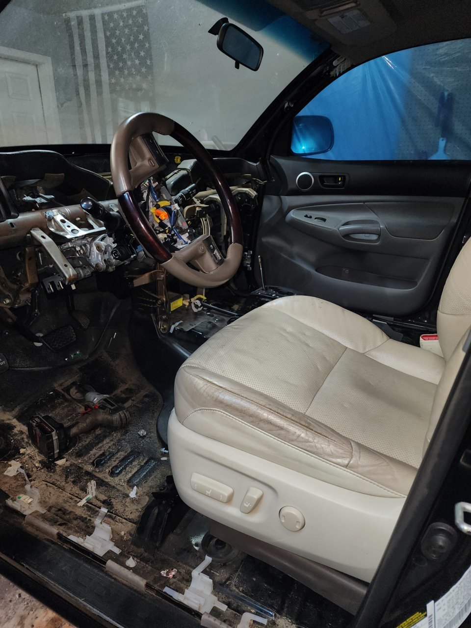

    Can confirm the seats bolt right in, however they are considerably taller. About 1.5" taller It seems to me that this might be a problem because I am not sure if this is the highest the steering wheel goes. I will cross that bridge when I get there, nothing a bit of cutting and tig can't solve. There will be plenty of room for the 5 channel amp thats for sure.

    265/75 Bridgestone Dueler ATs, 5100s all around, OME 883s front, EL095R Dakars rear (overload removed), custom sliders, Clazzio seat covers, Softopper, KB Voodoo URTC
    Those seats go up and down electronically, ya? Maybe they can go down once they are powered up.
