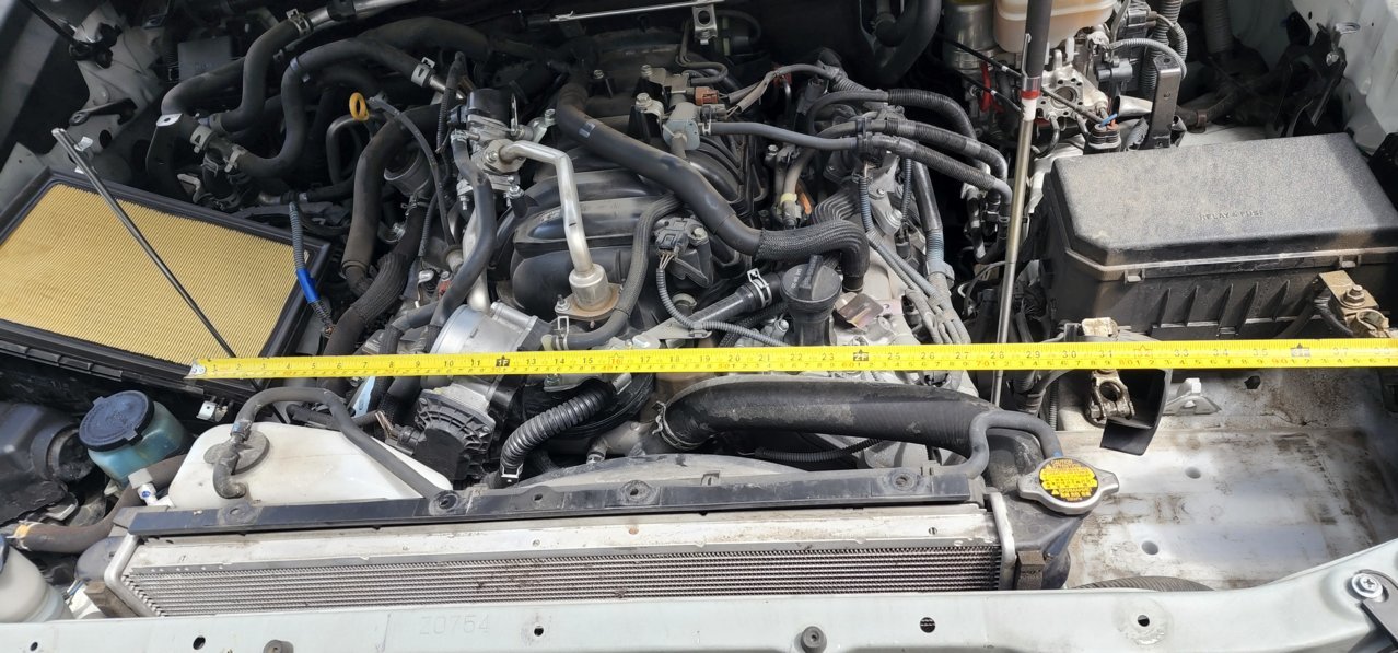

    Okay I took a measurement of the furthest points of the V on the engine today. Forgive my primitive method but the engine measures roughly 28 inches. I didn't take a measurement of the 1GR but eyeballing it, it looks to be about 3-4 less wide than the 1UR. That being said, there is plenty of room on each side of the 1GR20220523_114459.jpg

    The main concern I have now is the shock towers and headers. On the tacoma the shock tower is designed a litte different than the GX.
