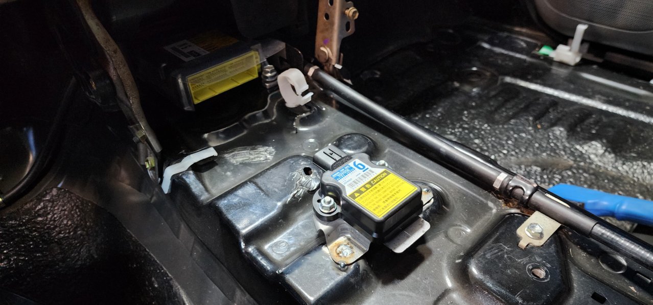

    Airbag computers have the same bolt pattern and can confirm it bolts in. 20230211_143501.jpg

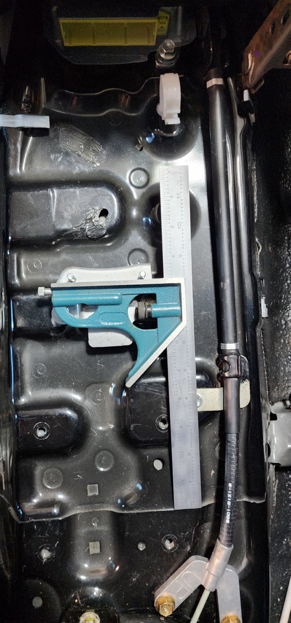

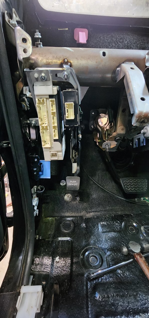

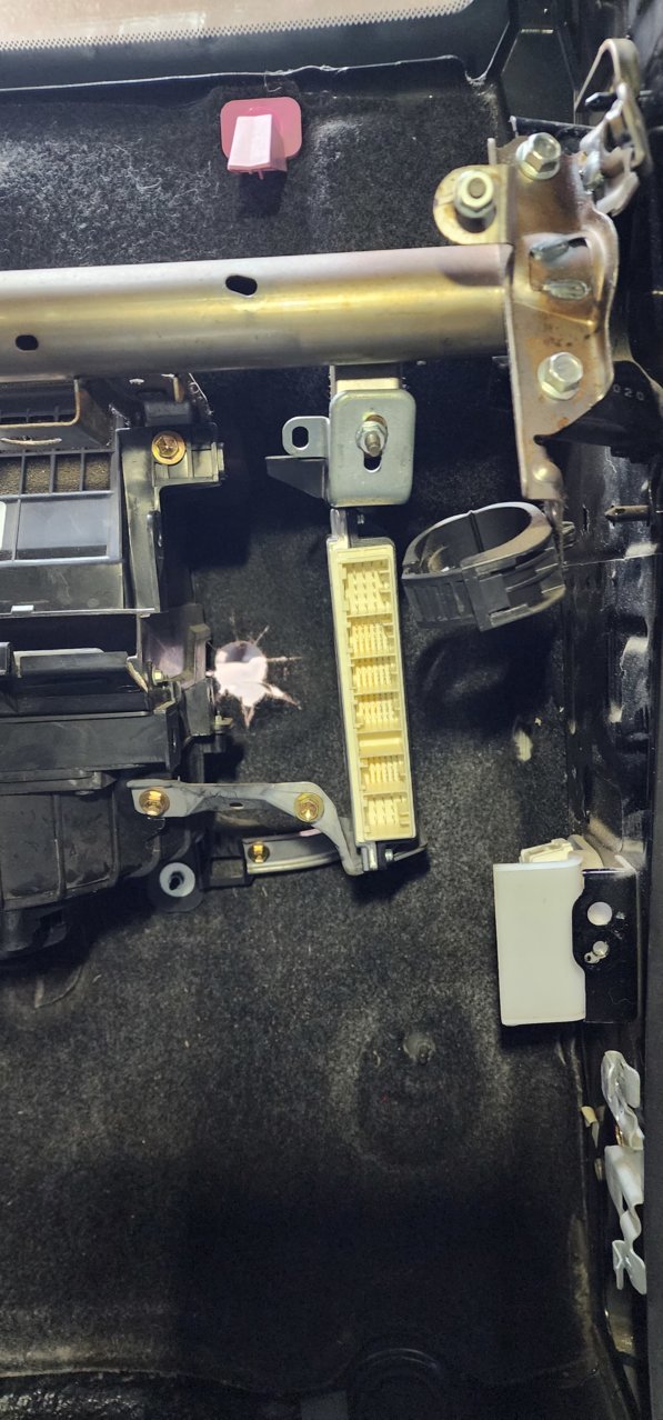

    Alright guys, I got the yaw rate sensor mounted best I could to be parallel to the truck. This was the only straight line datum that appeared to be perpendicular to the body. The cup holder wouldn't clear the sensor so I decided to ditch it. I will make a metal plate and put various other switches in there like butt warmers/coolers.

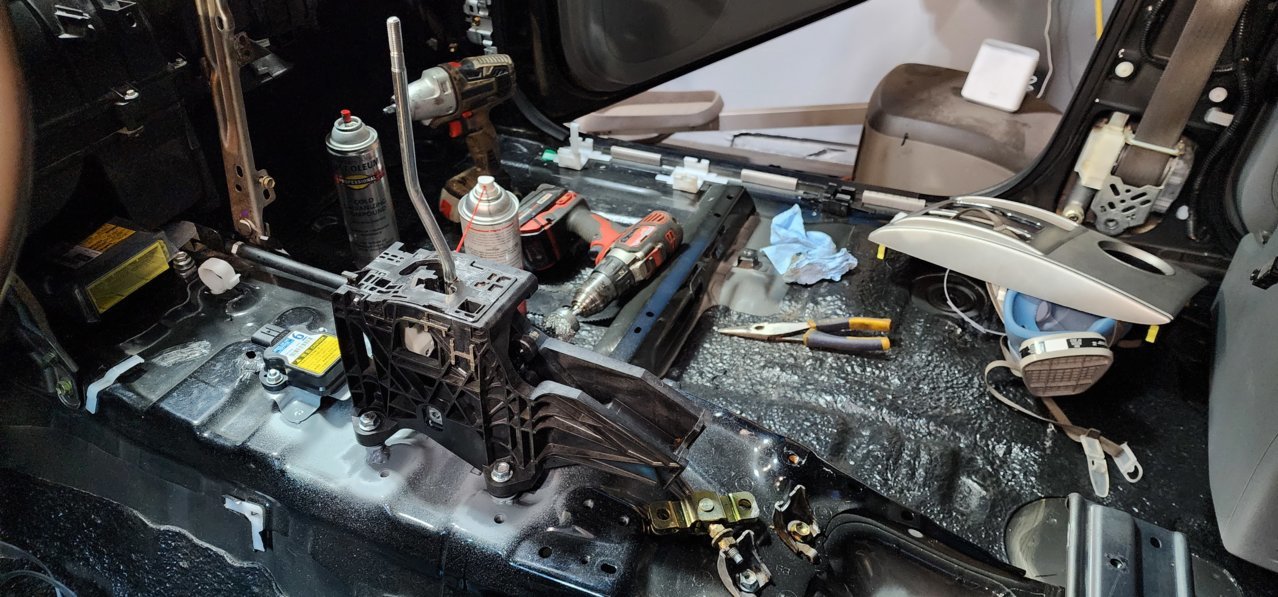

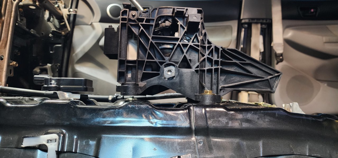

    Additionally I got the shifter mounted, that was a cluster to deal with. At first I dropped in the shifter and 2 of the bolts lined up. I got excited about that only to find out that those bolt hole locations would put the shifter too much to the left which would prevent the usaged of the sport shifting. Then I noticed the front mounting points are higher than the rear 2 lol. Anyway it was a PITA trying to figure out where the shifter would clear all of the plastics and clear the little gear indicator panel. The gear indicator panel is almost the same size as the tacoma so I filed the hole in the plastic to size. Also I had to cut off some tabs on the shifter to clearance it. Anyway, this is what I came up with, I think I will need to space the center console up about .5 inch to clear everything nicely.
