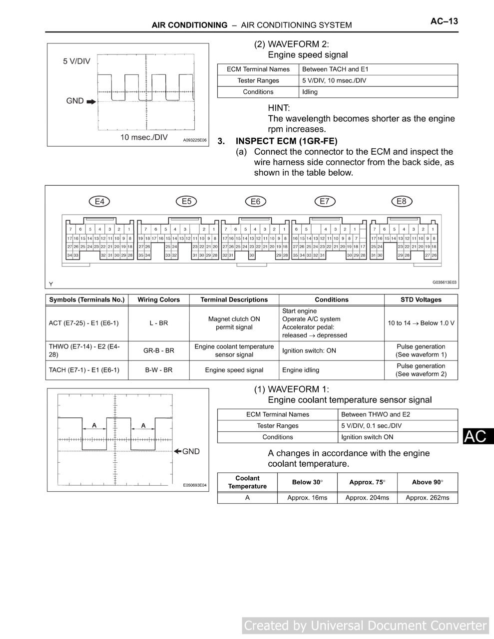

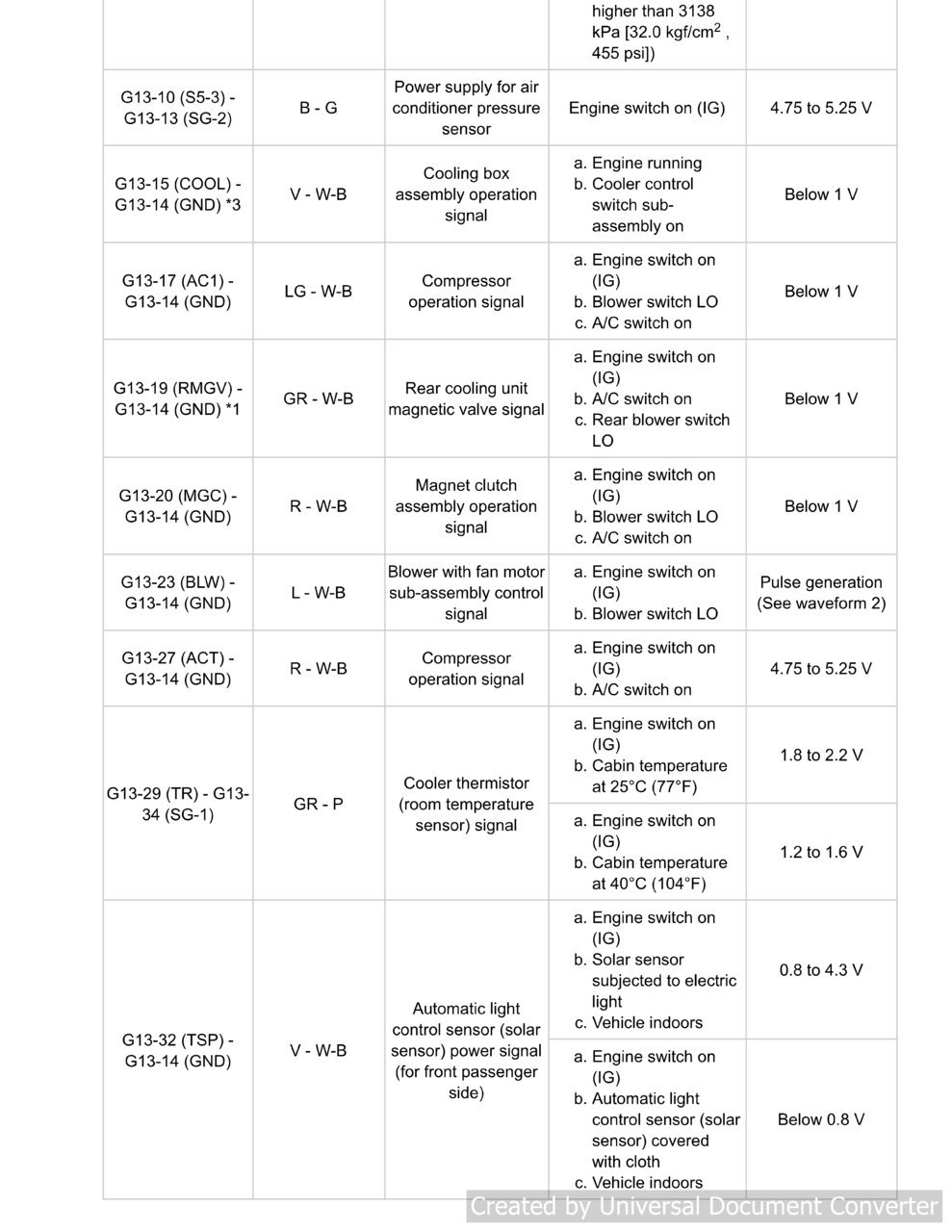

    Can you look up what the voltages are for AC1 on both vehicles? I don't seem to have access to these pin charts in the lexus tech doc that I am using.

    Not sure, on Mitchell it's under Air Conditioning System>Diagnostics-Introduction>Terminals of ECU.
    The Lexus one only shows under 1v with A/C on, it doesn't say what it is with A/C off. Tacoma is 12v with A/C clutch off and below 1v with A/C clutch on.

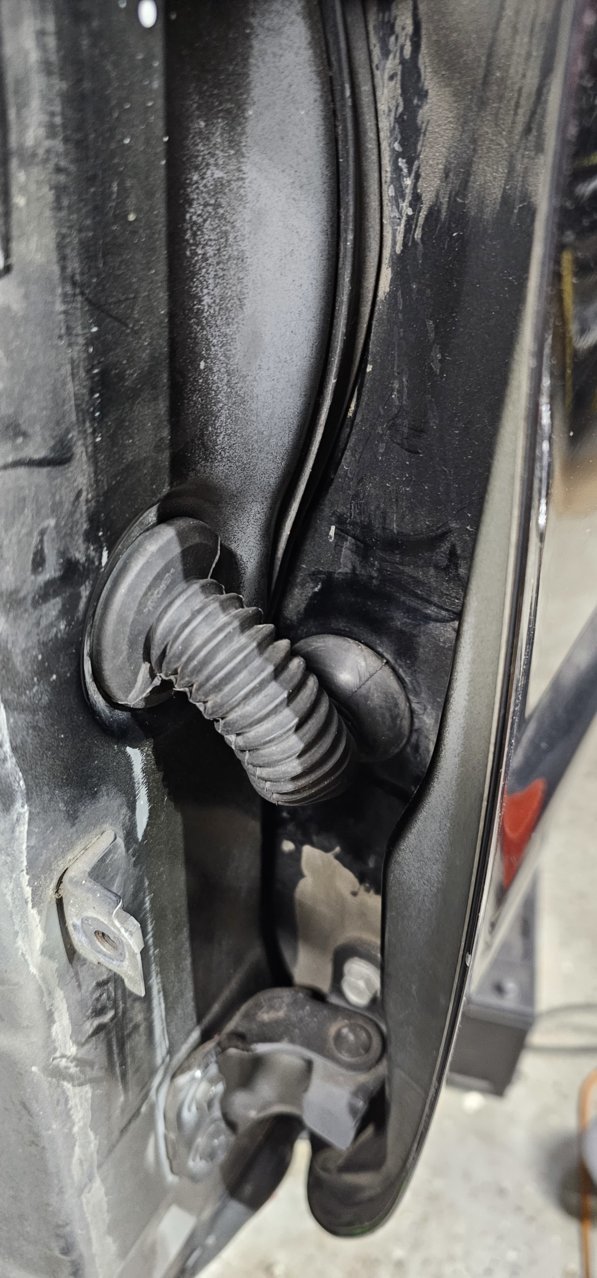

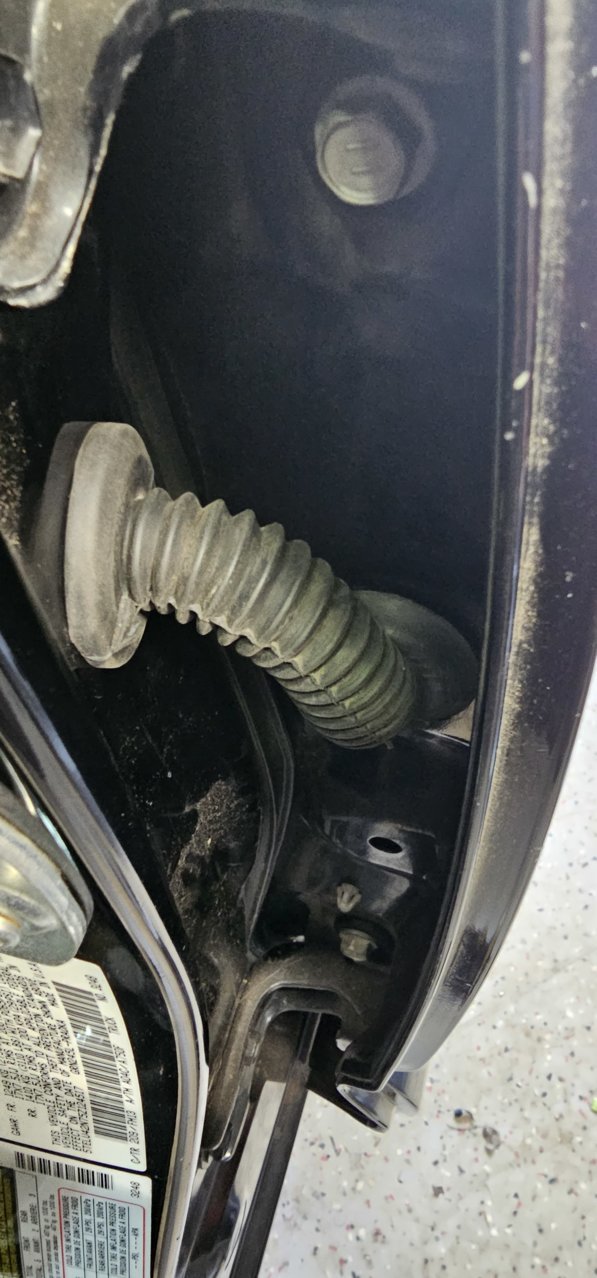

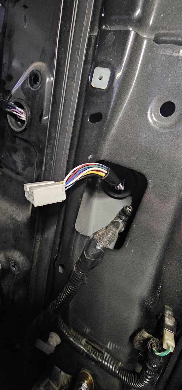

    I pulled the door wiring harness off of the GX today. The door lock uses the same plug as the tacoma, I will verify functions and might not need to solder anything on this one.

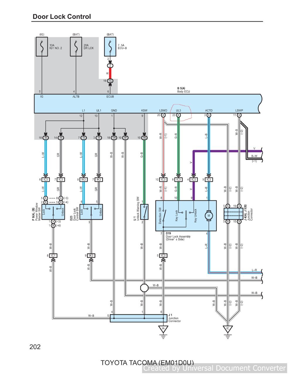

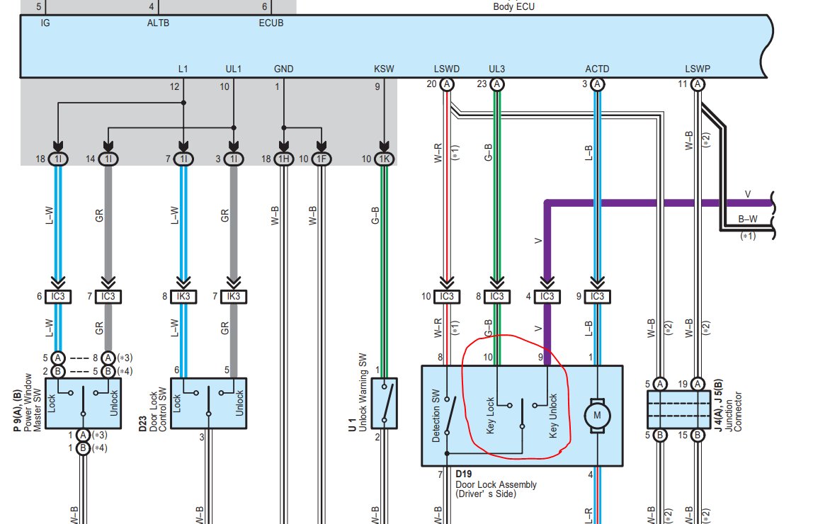

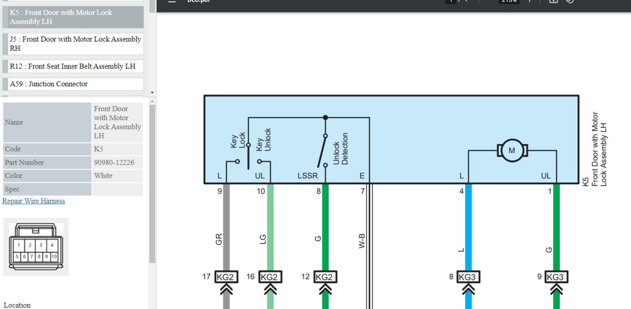

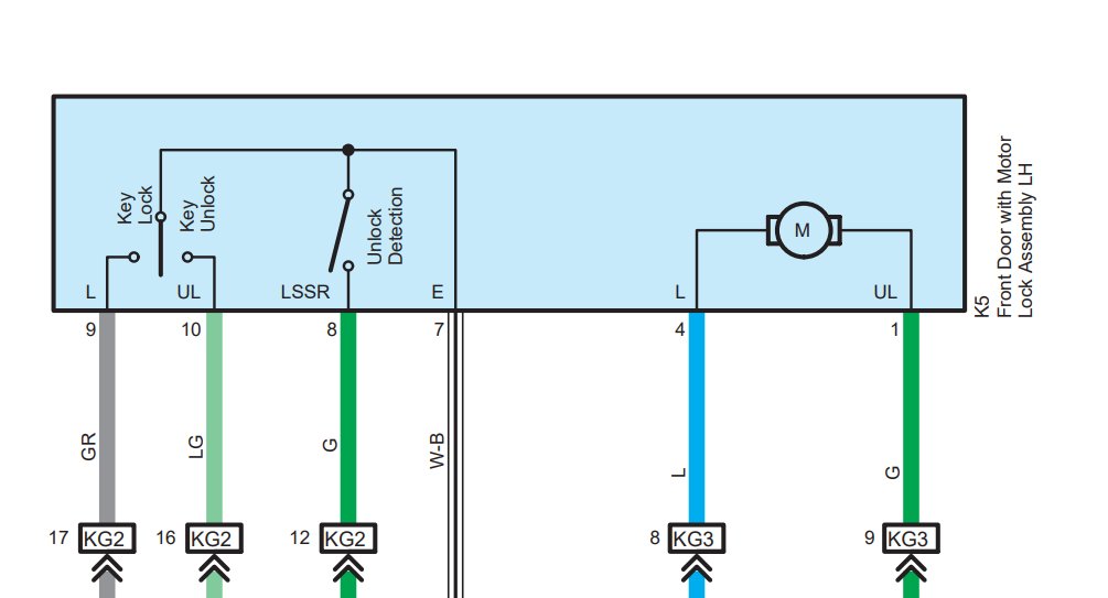

    Okay guys, everything on the door lock pins lined up except Key unlock Pin 10 and Key lock pin 9 on the gx460. On the Tacoma pin 9 is unlock and pin 10 is lock. If I understand this correctly, I think the gx system would lock the truck when you tried to unlock it with the key. I switched those two pins around and I think everything should be good. Let me know if I screwed something up.
    GX460:
    Tacoma:

    I'm pretty sure the labeling on the Tacoma diagram is incorrect, I'm currently working on a detailed connector pinout chart for the Tacoma and I ran into the discrepancy among others.
    As you can see Pin 10 goes to UL3 on the Body ECU, UL3 is labeled (Driver side door key-linked door unlock input) in the Body ECU Pin chart.
    Pin 9 goes to L2 which is labeled (Driver side door key-linked door lock input).

    Hmmm, so do you think I should switch the pins back?

    Well there is a discrepancy there, if the wiring and pin labels are correct (which I suspect they are) the labels on the switch diagram are swapped.

    Okay, it would also make sense as to why they are opposite on the gx. I was rather confused why they were opposite on the tacoma. I will switch it back.

    Worst case your key lock switch would be opposite but yea I'd trust the wiring diagram and pinout before the labeling on the switch.
    I've ran into several discrepancies in various charts and diagrams that I had to work through while doing pinouts of harness connectors, still got 18 more system diagrams to work through.

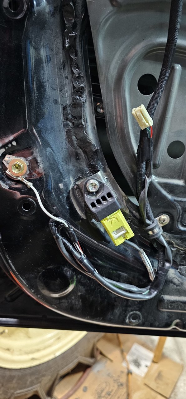

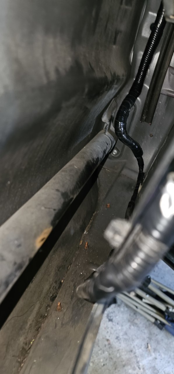

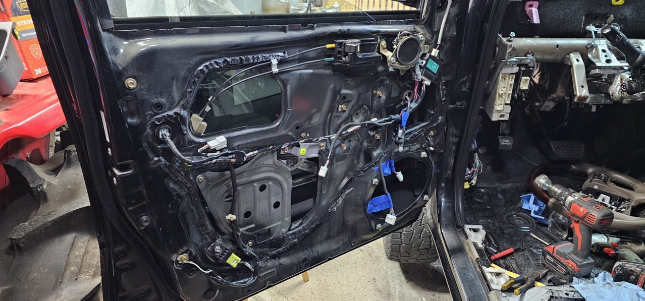

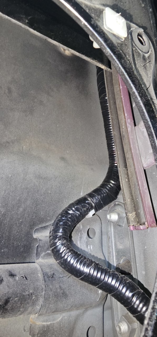

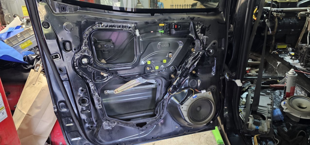

    Alright, driver door is wired. I carefully took off all the factory wire holders and put them in the correct locations relative to the tacoma door. I mocked it up to look like this. I used the factory bracket for the airbag sensor and welded it to the door. I kinda threw on the door panel and it looks like it will clear in this spot. The rubber door grommet was a TOTAL PITA. There is no way you are sticking those plugs through it. I thought about taking the pins out but I would risk pinning them wrong. There are like 5 of the same color greens on one plug. Additionally I would risk damaging the plugs taking the pins out. I was able to re pin the airbag sensor. Everything else was; cut, strip, solder and heat shrink. The nice thing is the doors are pre wired for courtesy lights. In the furture I can add something to the bottom of the door panel. 20230223_194907.jpg 20230223_194938.jpg 20230223_195053.jpg 20230223_195045.jpg 20230223_195036.jpg 20230223_195013.jpg

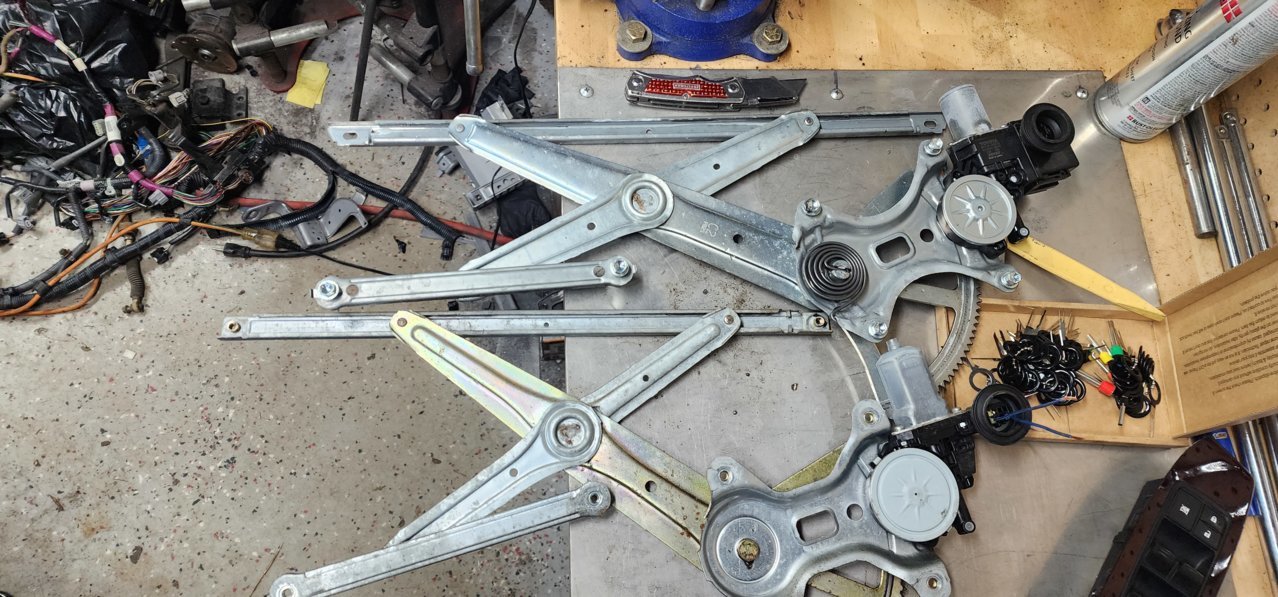

    As I was working on wiring up the rear left door I realized the door lock has two more pins than the taco so I swapped it over. I checked the wiring diagrams and the additional wires go to the body control module. The Door lock cable needed to be swapped over and the lead ball on the door lock needed to be filed down a bit to fit into the tacoma door latch handle. Aside from that it bolted right in, even the child lock lined up.

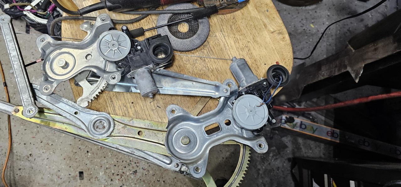

    The window regulator stumped me for a sec until I realized they used the opposite hand regulator motors on the gx460. See the pics below. All the pins on the rear regulators are the same and I am pretty sure they need to be programmed to use if it's the same as it is on my gx470.
    1 left rear tacoma regulator and 1 left rear gx460 regulator pictured below.

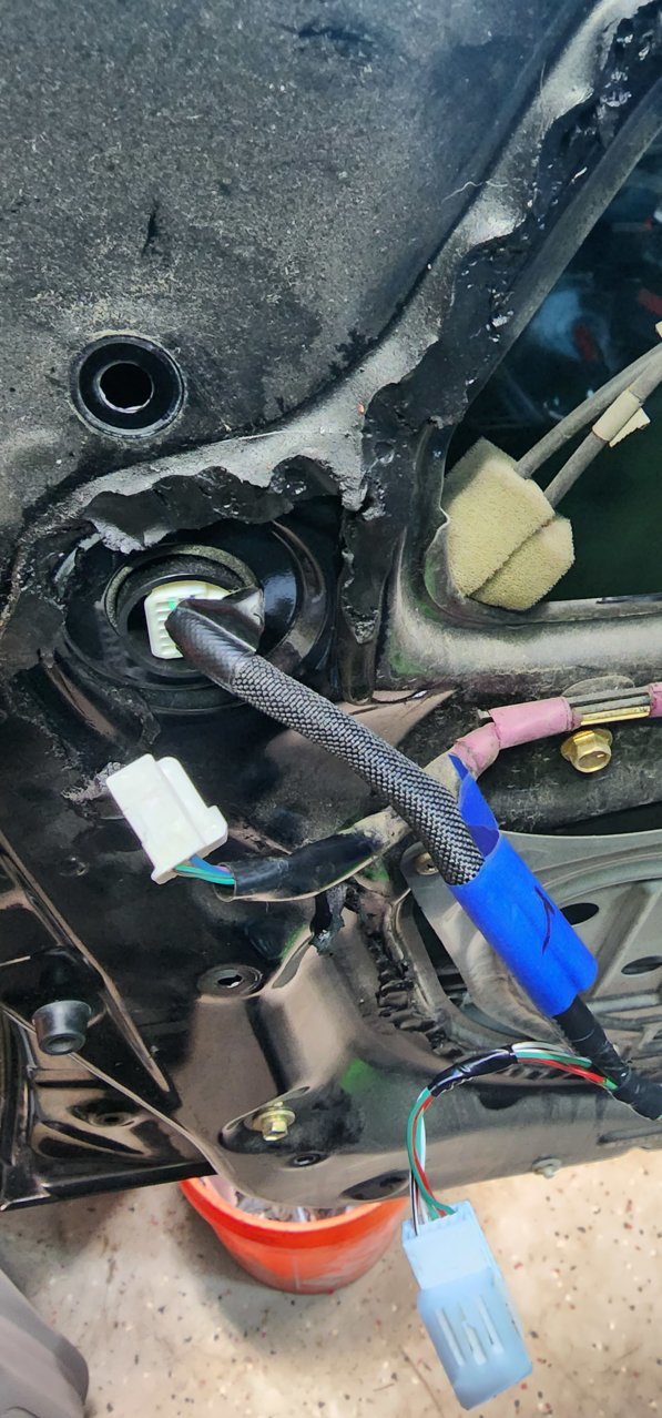

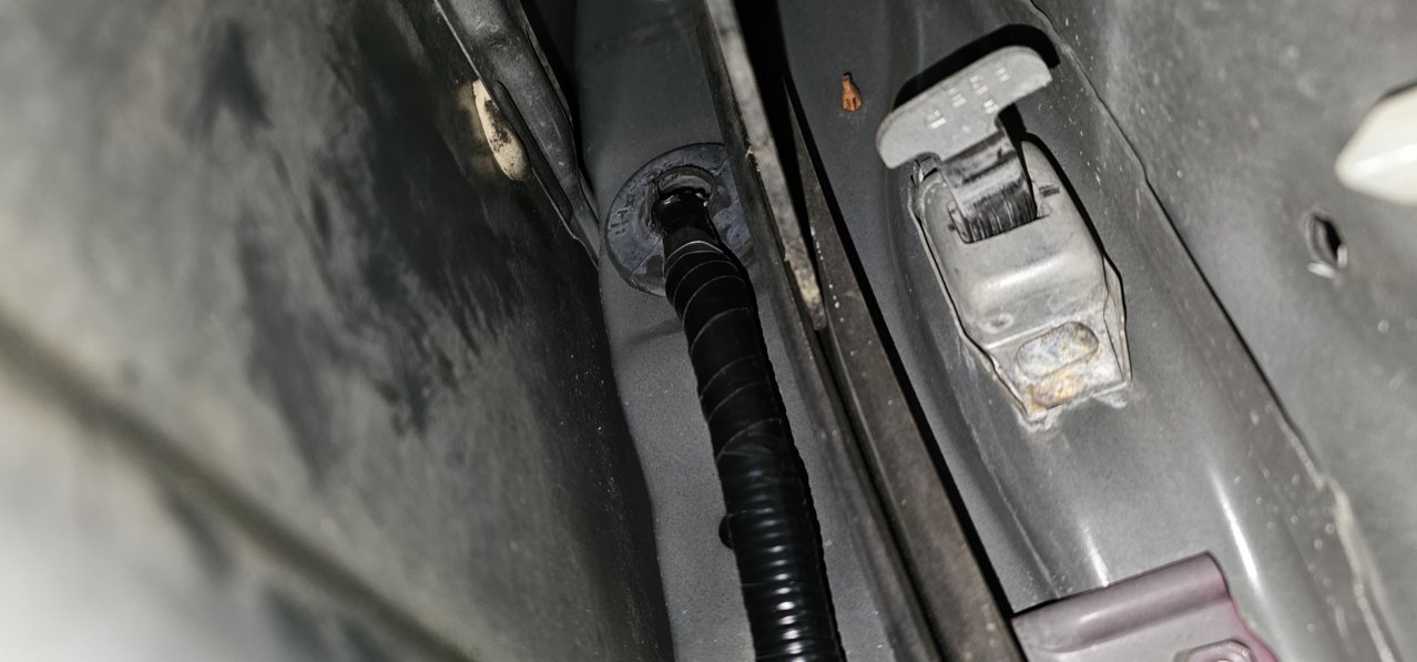

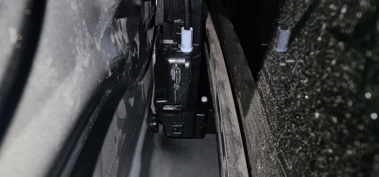

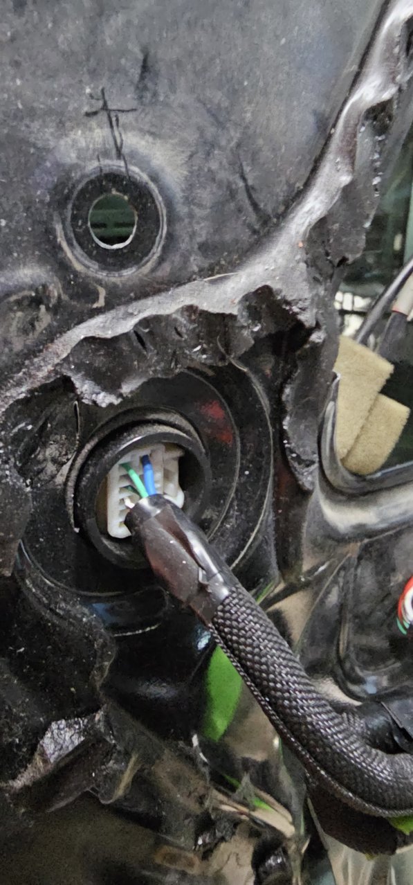

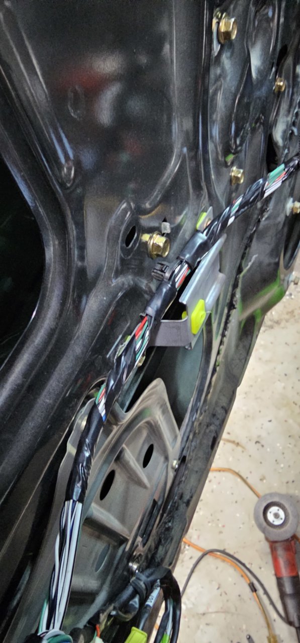

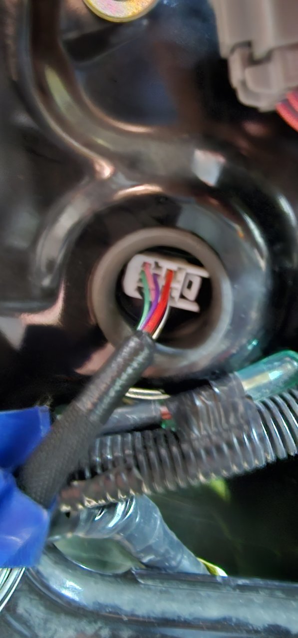

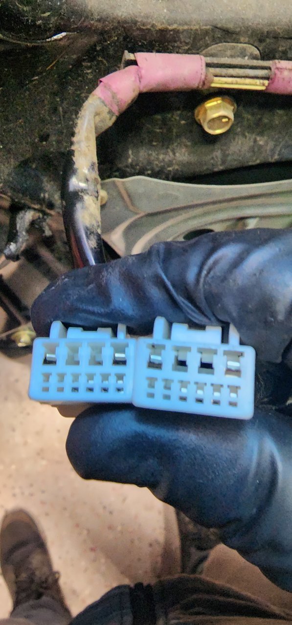

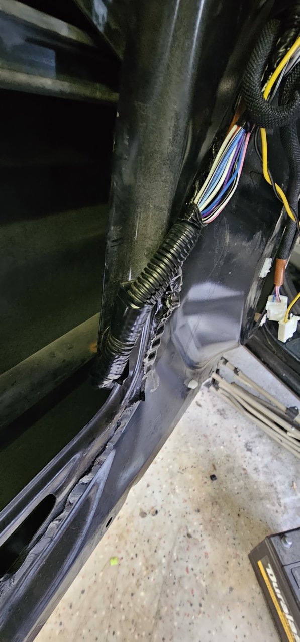

    Back door is wired up, 1 more to go. Window clears the gx lock. Also I had to extend the wires to the window motor.
    20230301_152603.jpg 20230301_152615.jpg 20230301_152623.jpg 20230301_152636.jpg 20230301_152647.jpg 20230301_152654.jpg 20230301_152732.jpg 20230301_150315.jpg
