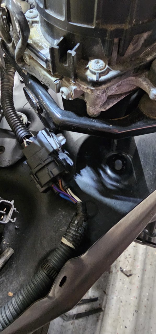

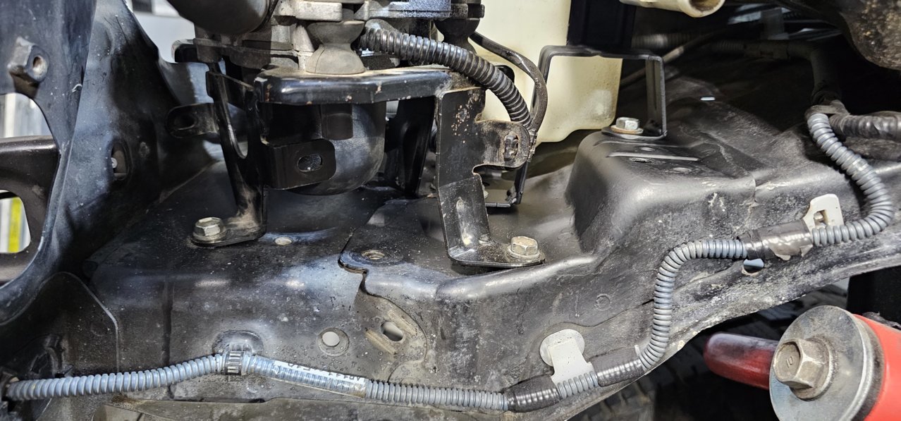

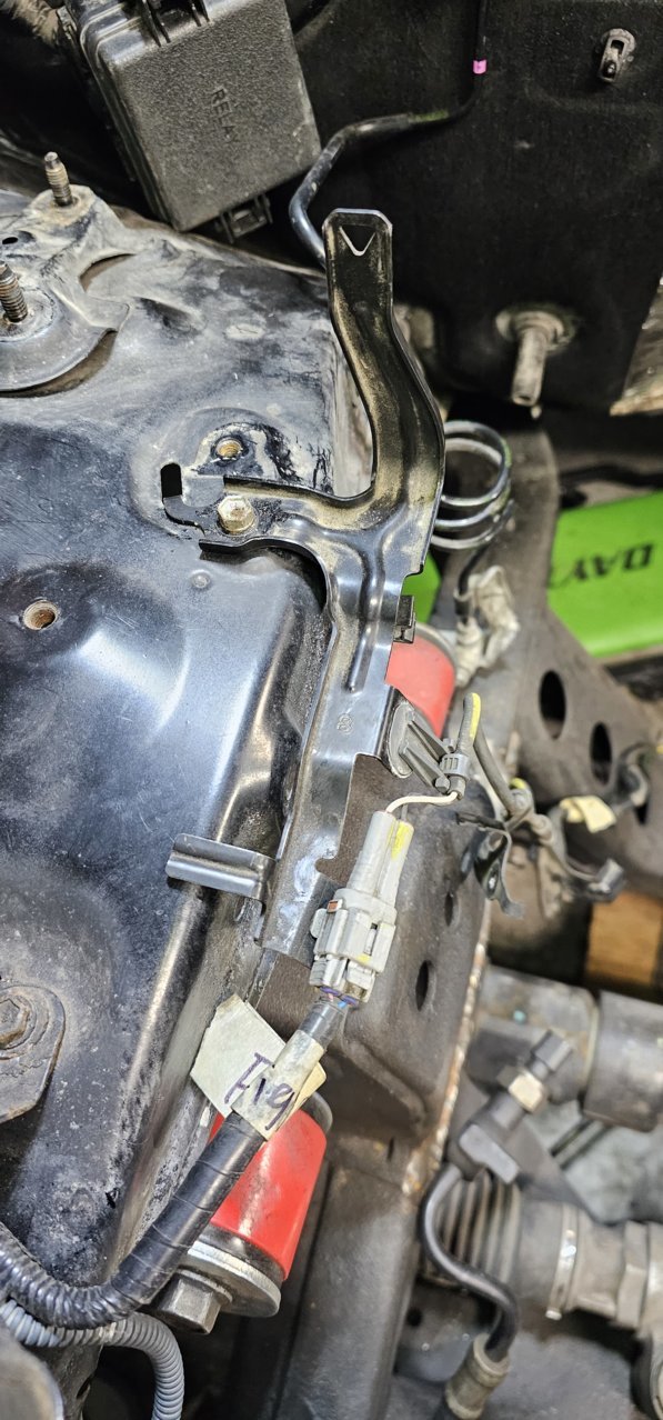

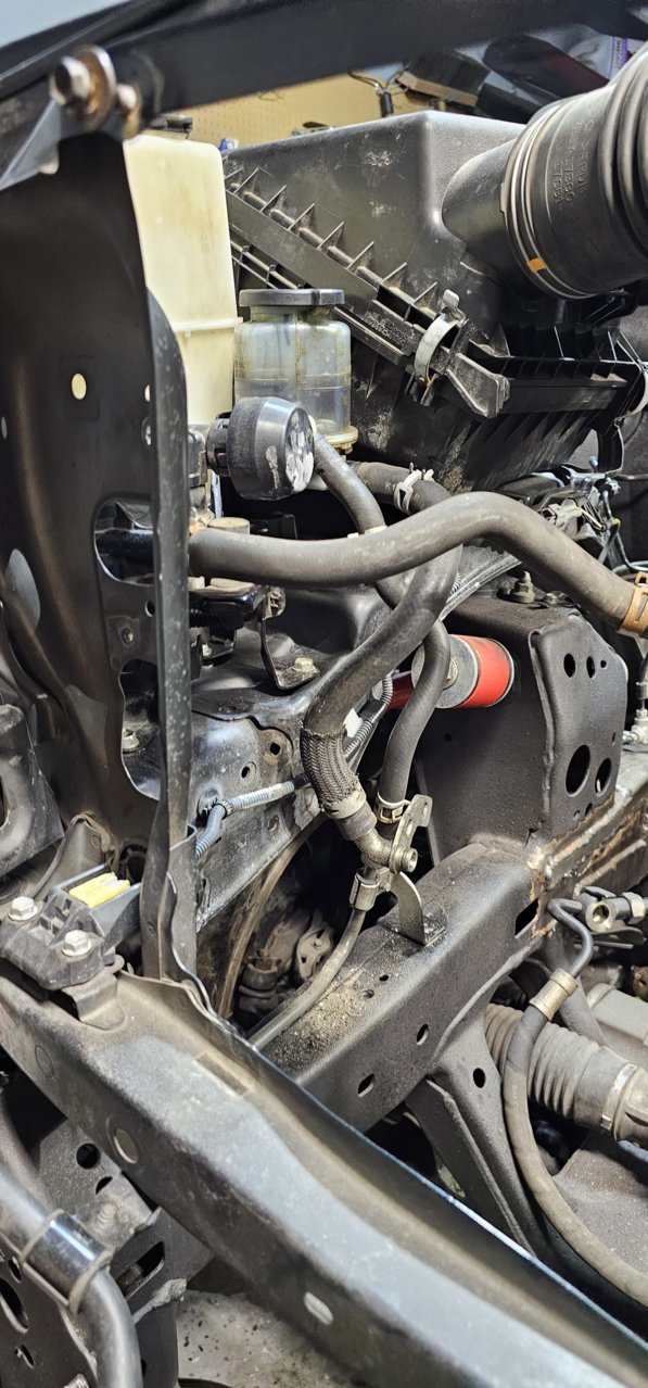

    Also I got the front brake lines fitted and I am thoroughly impressed how well everything just bolted in. Check it out.

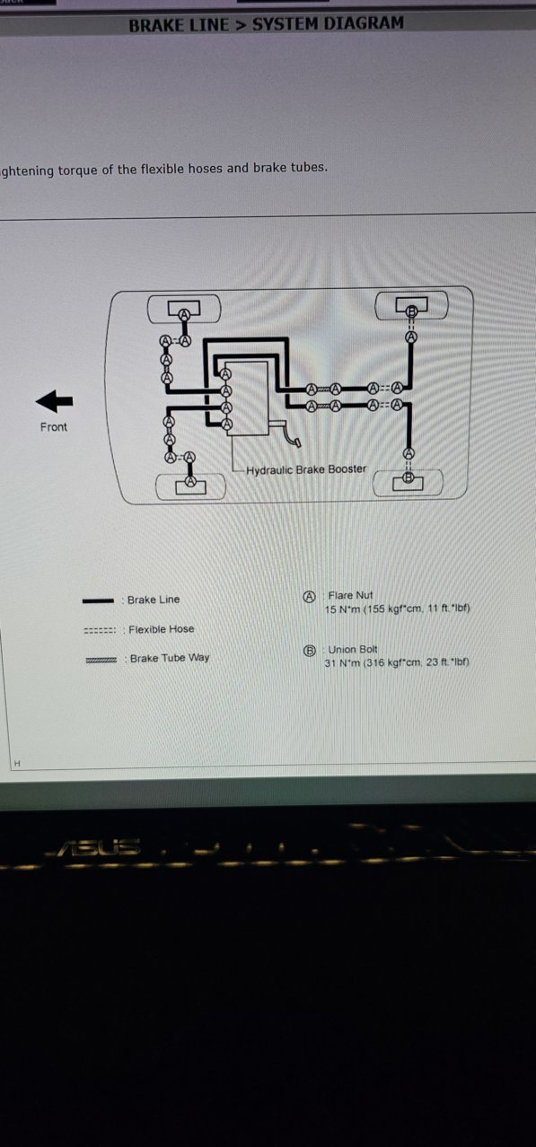

    By the way, here is the brake line diagram.

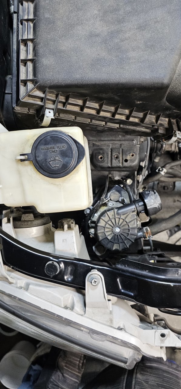

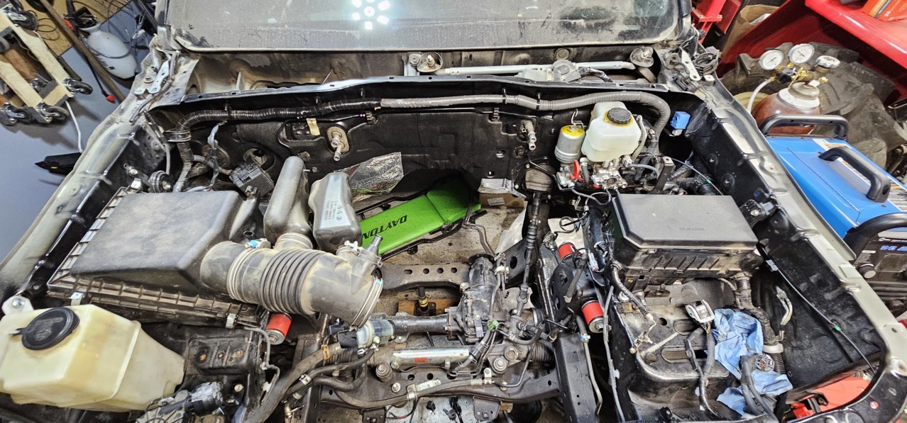

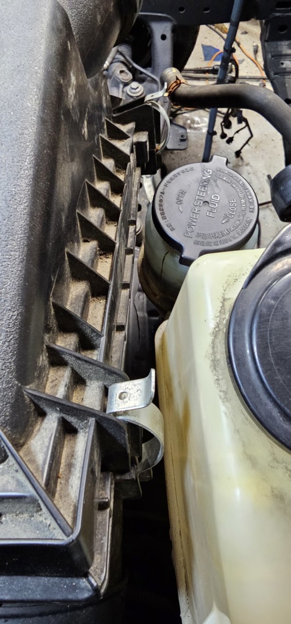

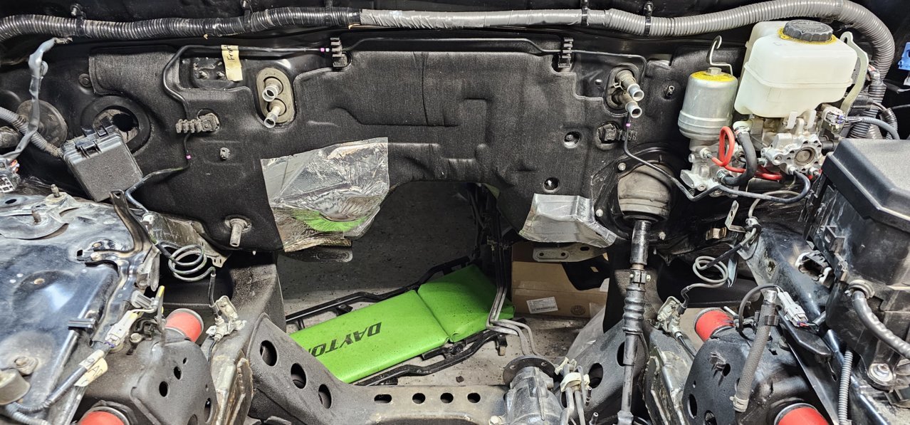

    2 bolts of the air intake lined right up, I had to drill and weld a nut for the 3rd bolt. I have to lean the window washer fluid reservoir forward a bit to clear the intake box since it is pretty massive. I had to drill all 3 holes for the SAI pump. I will put the power steering reservoir behind the secondary air injection pump. Looks awesome, I can almost see the engine in there boys!!

    Holley also makes a relocation mount for the SAI that fits there unless the GX one was really different but looks similar.

    Not sure any of those kits would work on my 05 since there was no sais on these to begin with. 3 nuts, my welder and some touch up paint relocated it for basically free so I am happy going that route.

    Makes sense the relocate though used the existing ones that the power steering and windshield fluid are so figured it would. You’re already golden but another option potentially for anyone else thinking of giving this a go.

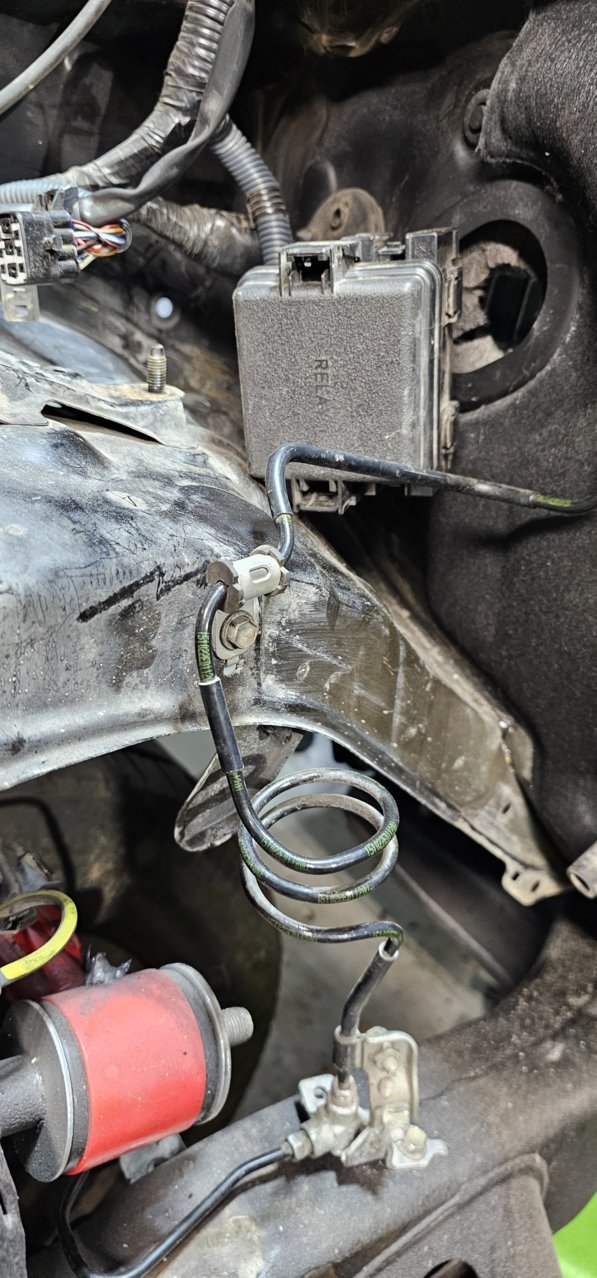

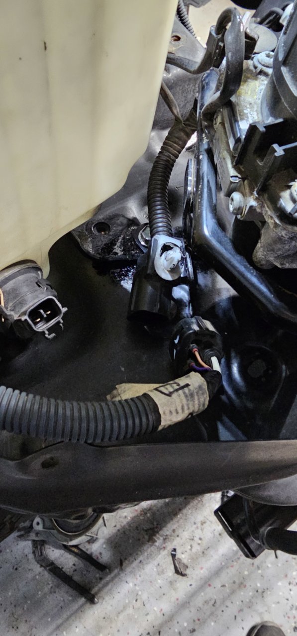

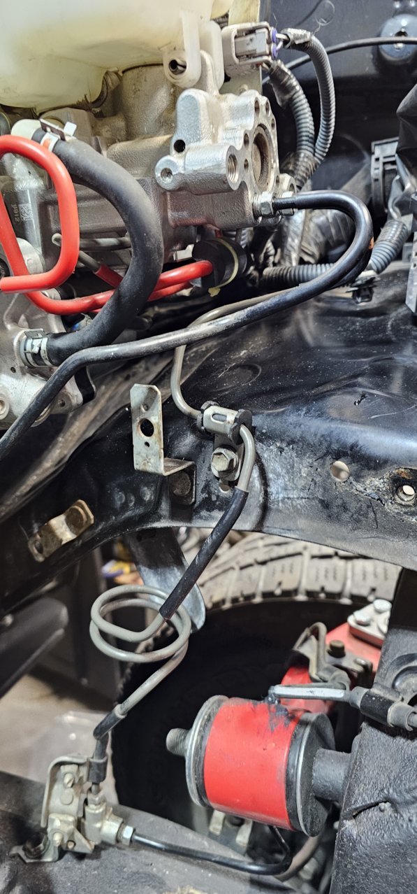

    Boom SAI Pump and power steering resi mounted! I had to modify the power steering resi bracket to mount it on one existing threaded hole. I had to drill hole and weld a nut for the second hole. Also check out that airbag sensor wire routing, what a beauty. I am hoping the AC lines will cooperate nicely also.

    Delete the SAI!

    Airbag looms are grey instead of yellow on Lexus vehicles?

    They are yellow on the inside, grey in the engine bay with yellow plugs.
