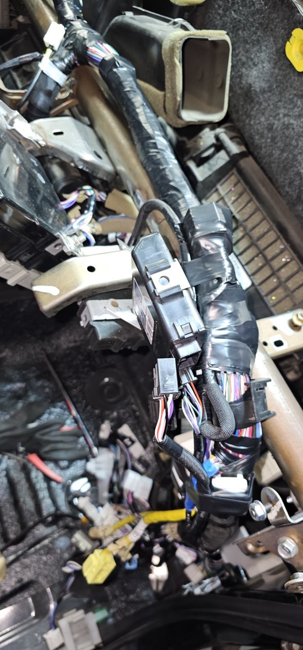

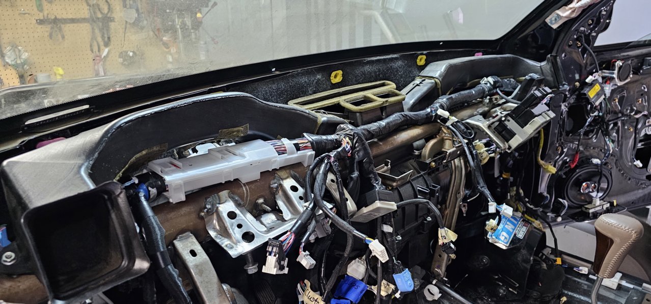

    Started wiring up the dash, I relocated the junction box by simply taping it into the harness.

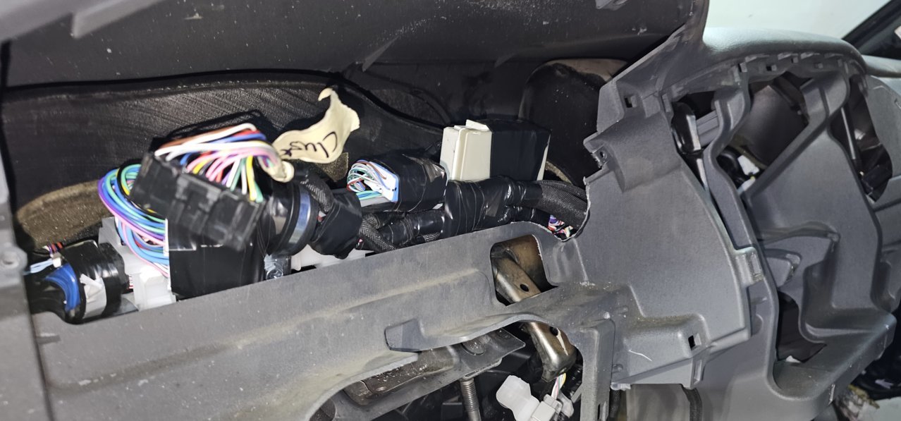

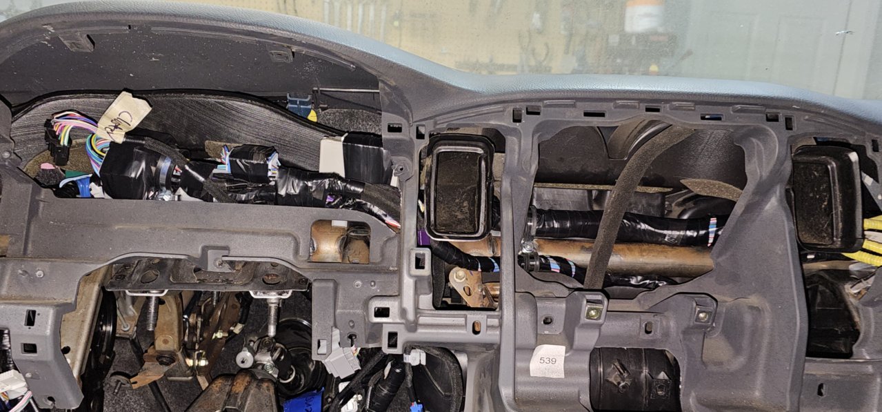

    Okay here is how I got the vents to clear the junction boxes. I also started clamping down the main loom to the crash bar.
    20230323_130844.jpg 20230323_130943.jpg 20230323_125933.jpg 20230323_130826.jpg

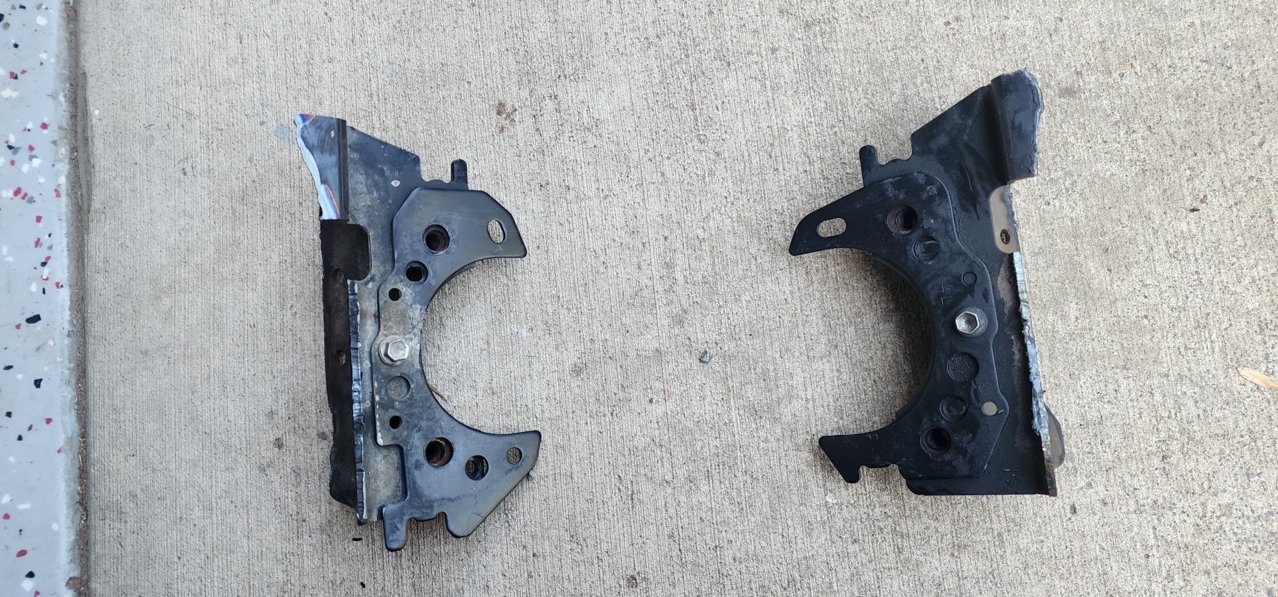

    I need to get better at cutting brackets off. I mean I get them off alright, but usually not very re-usable after.

    I cut the mounts off the gx frame. I have not yet relocated the crossmember because I need to put in the tranny first, then I can locate where the crossmember needs to be.

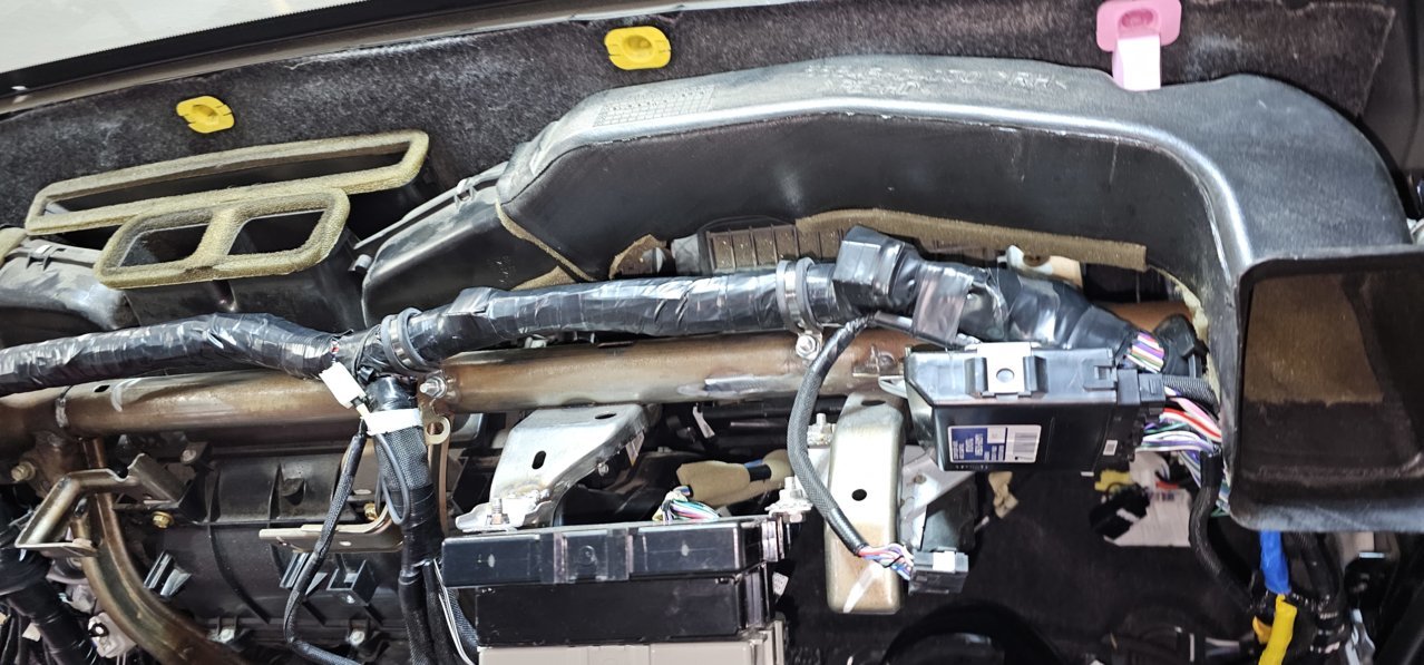

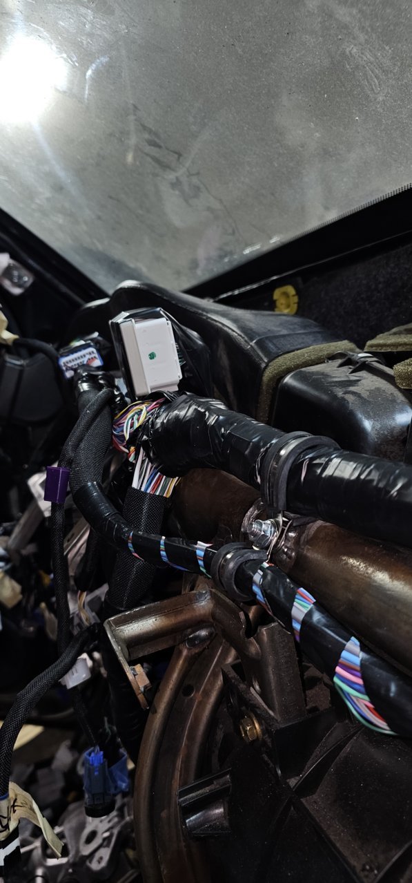

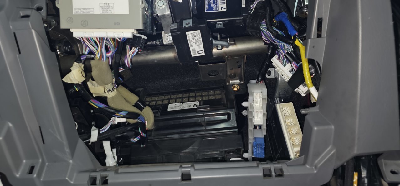

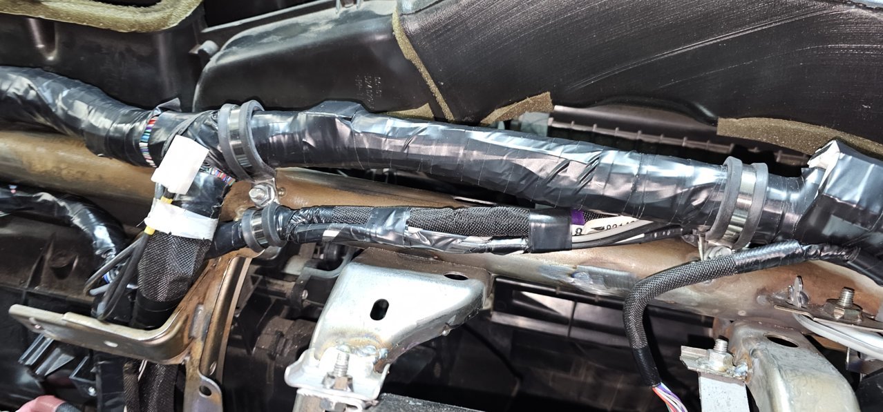

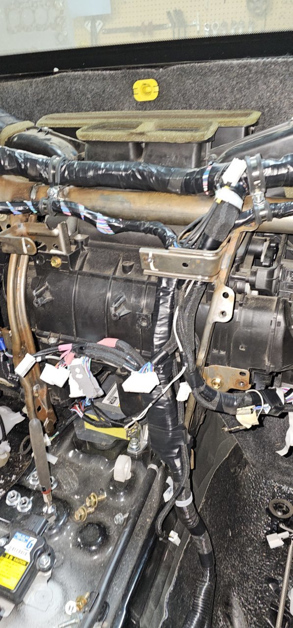

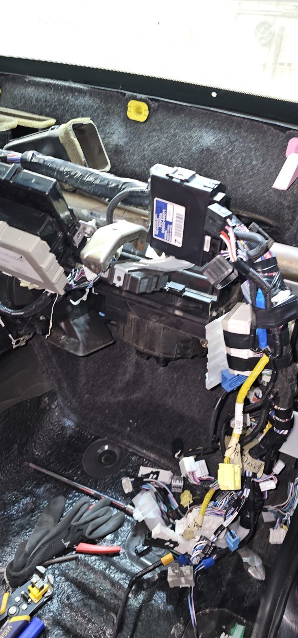

    Okay guys, Saturday update! I worked on clearing all wiring harness from the dash. Additionally I relocated the junction box behind the cluster for a third time. I had to relocate it because the center vent that is mounted on the dash was interfering with the junction box harness about 1/4 inch. I installed the secondary dash wiring harness which hooks up behind the cluster and powers the stereo. It also has all the speaker wires that run to the amp under the front passenger seat. I had to clearance the dash a bit by the cluster. And I still need to fasten the harness sections that are vertical on the dash. I threw the cluster in there to check if it clears, it looks so sick!
    20230325_194036.jpg 20230325_200217.jpg 20230325_200207.jpg 20230325_195958.jpg 20230325_195943.jpg 20230325_200006.jpg
