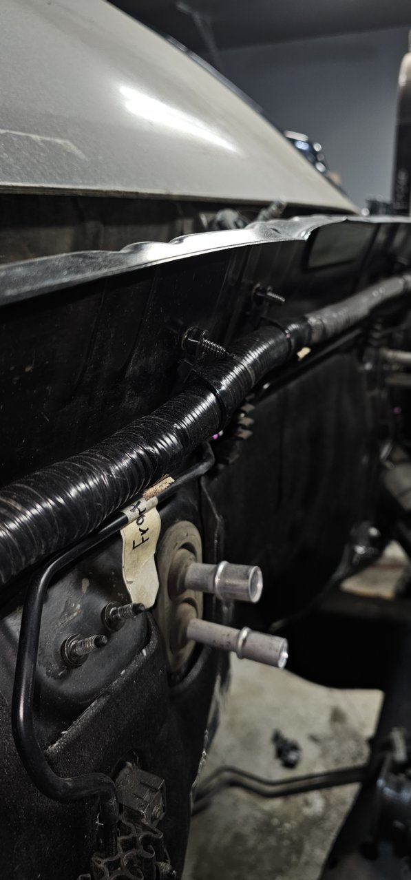

    Thanks I definitely need some of those, trying to stuff so many wires behind the tacoma dash has definitely been a challenge. I like the clamps I am using now because I can weld a bolt on anywhere and make a solid mount point. What I really need is some oem style engine bay harness stud mount clamps. I called toyota and they said they don't sell them without the harness. The ones I got don't hold the harness above the studs very well so the harness is hanging below the studs.

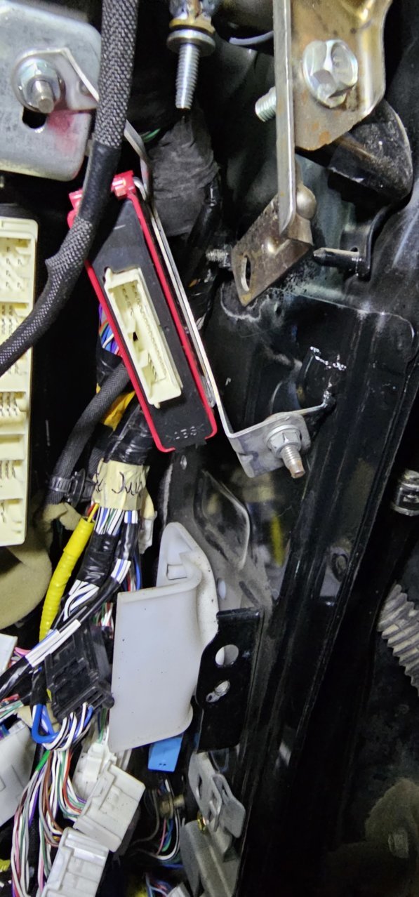

    The stuffing continues... I decided to send this loom behind and under the vent to push the plugs back. They were interfering with the glove box. It appears I might have to clearance the glove box a bit on the top left corner to clear the 3 computers (and their plugs) that I stuffed up into the dash. Also I relocated the sonar (the red one) computer more towards the rear because there are wires now where it used to be.
