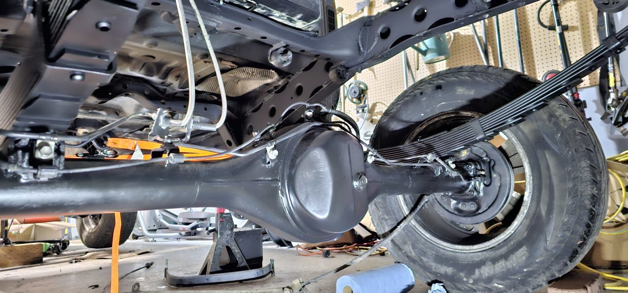

    Waiting on the Total chaos bump stop kit but wheeled the axle under the leafs and reattached all the accessories. Took the bolts and brake line clamps off of the lexus because mine were all rotten.

    All the fresh paint on the axle housing and frame is so satisfying! Stoked on this build.:cheers:

    Will be better than new when complete !!

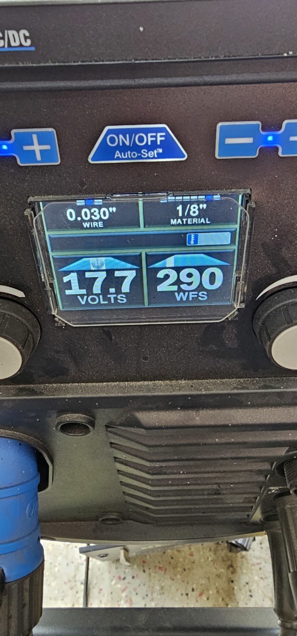

    Sorry for the long reply, I actually had to double check. My Miller Multimatic 220 auto sets based on thickness of metal, wire and type of metal. You can fine tune it from there. This is what I ran for welding the .120" plates.

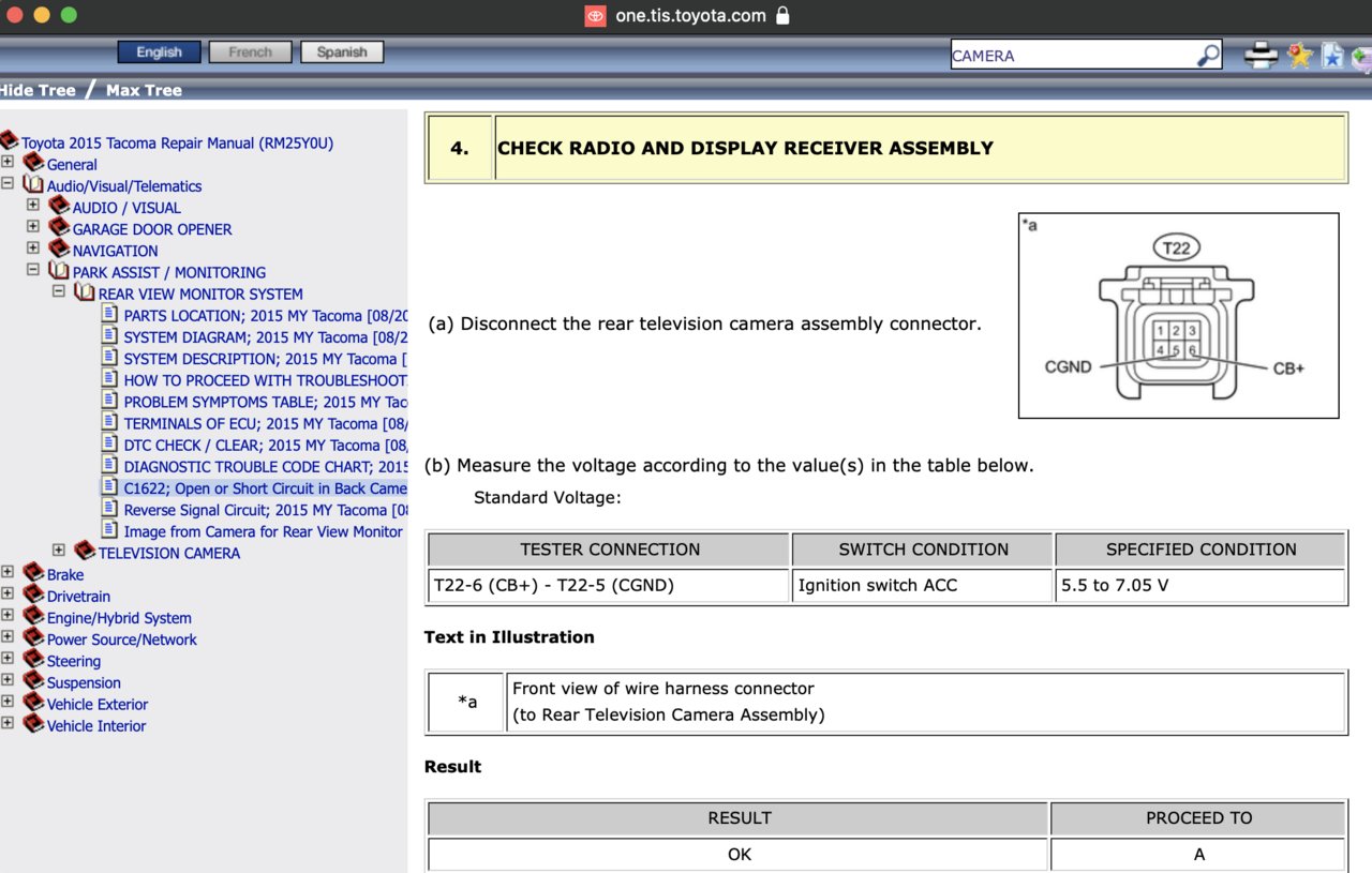

    @Dm93 can you look up the voltage requirements to make the oem rear view camera work on a 2012-2015 Tacoma? I don't have that info in my 05 tacoma fsm.

    I'll see what I can find but it will probably be later tonight before I get time.

    Thanks
